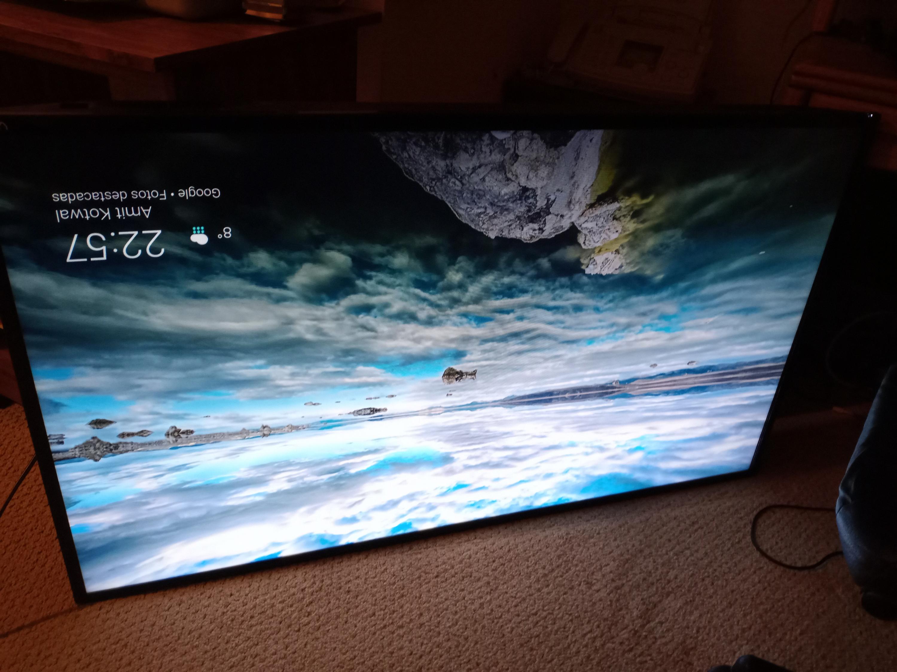

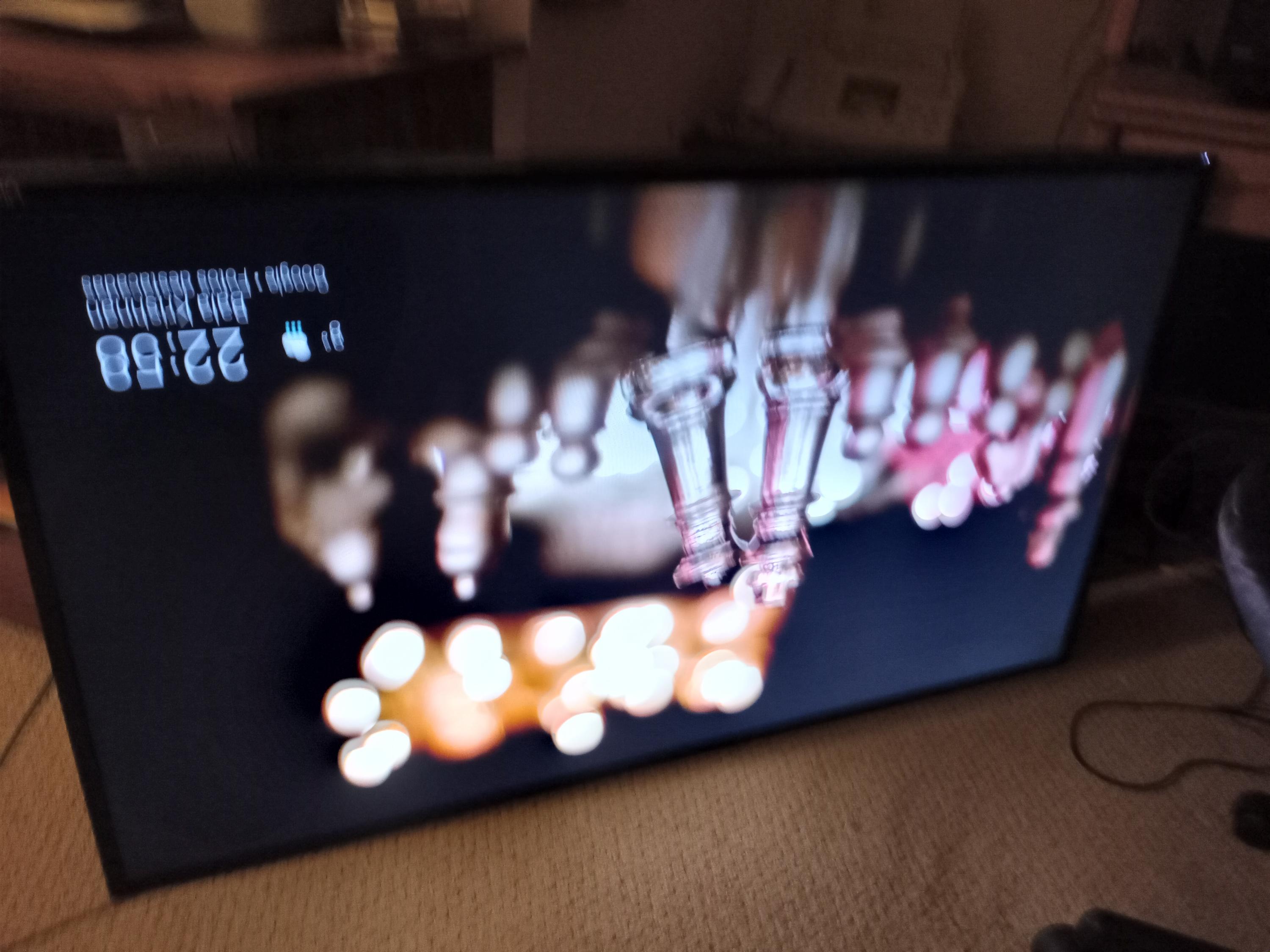

                  Re: Vizio E55-DO firmware corrupted?
                  Here's a couple of screen pics. If the firmware is corrupted like i think it is then why am I able to see google pics?
                    new main board fixed it.
