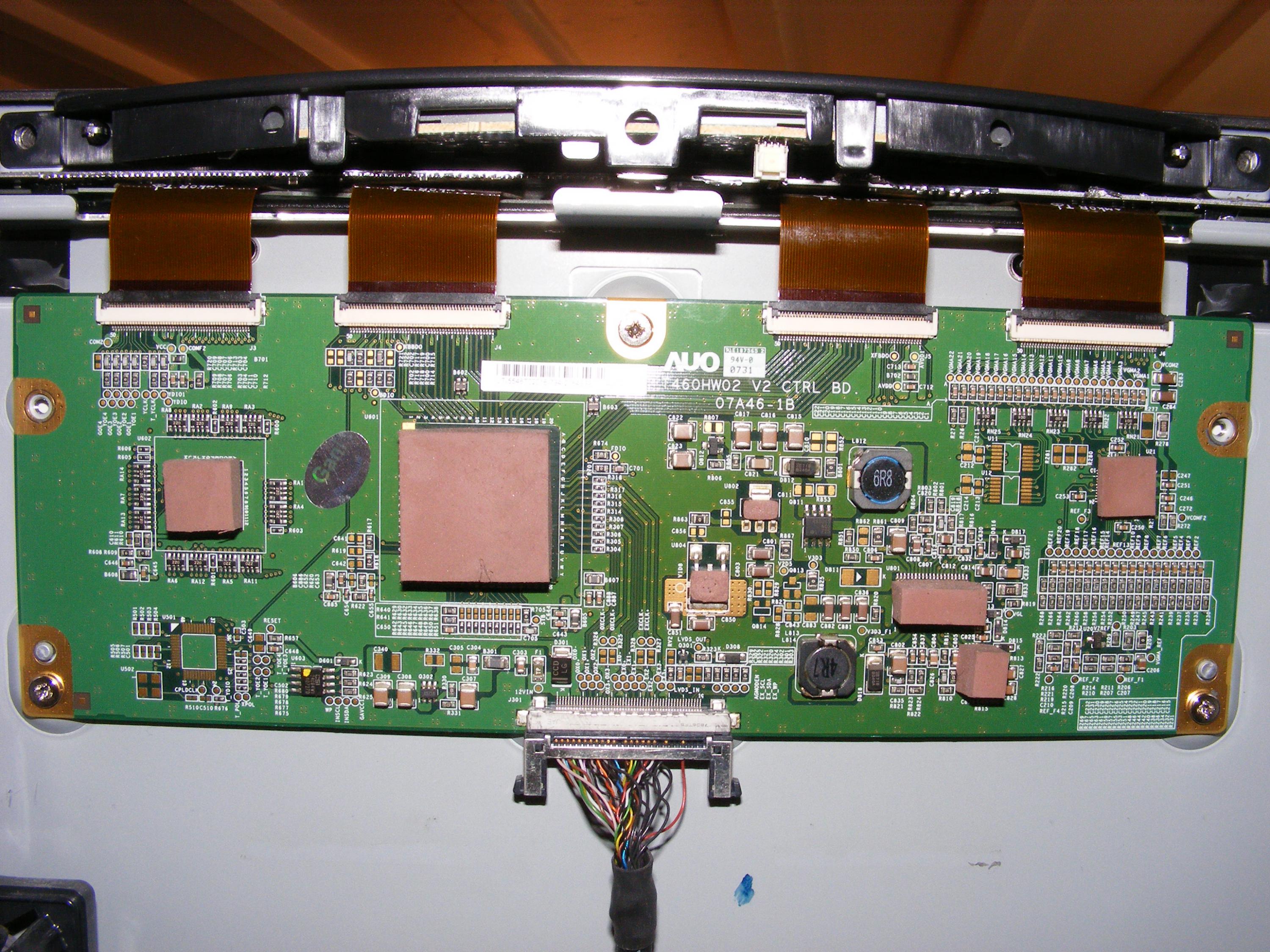

    I've been waiting ages for a replacement t-con to appear for sale, have so far bought two faulty boards and sent them back. Now I figure I might as well see if I can repair the one I've got - for a fun project if nothing else.
    It's an AUO T460HW02 V2. The problem happened when I messed up replacing the AS15 chip, probably introduced a short, and a transistor Q812 went up in smoke. I know there's a good chance other stuff might be dead too, but figure it's worth a try replacing the transitor and re-doing the AS15 and seeing if I can get it going.
    The problem is identifying the transistor and choosing a replacement, which I'm hoping you guys might be able to help with.
    The part-no is 25727 which I read off one of the boards I sent back (first pic). The same part no was mentioned on a different t-con in this thread (last post):
    https://www.badcaps.net/forum/showthread.php?t=24237

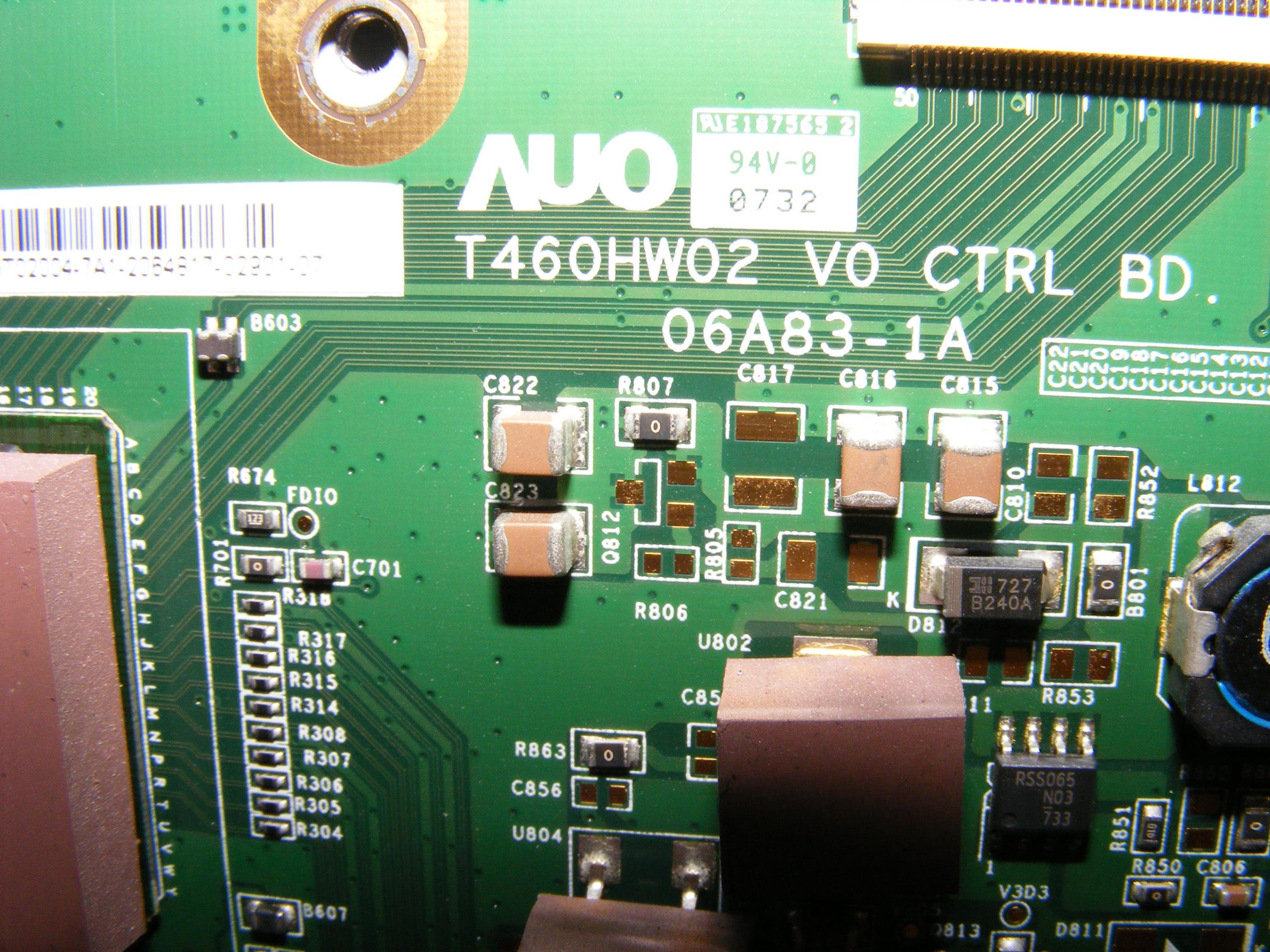

    Pictures attached. Interestingly the V0 version of this board doesn't have this transistor and associated resistors and caps, and that's the only difference I can see between the versions. The last pic is the same area on the V0 board.
    Any ideas what it could be or how to find out?

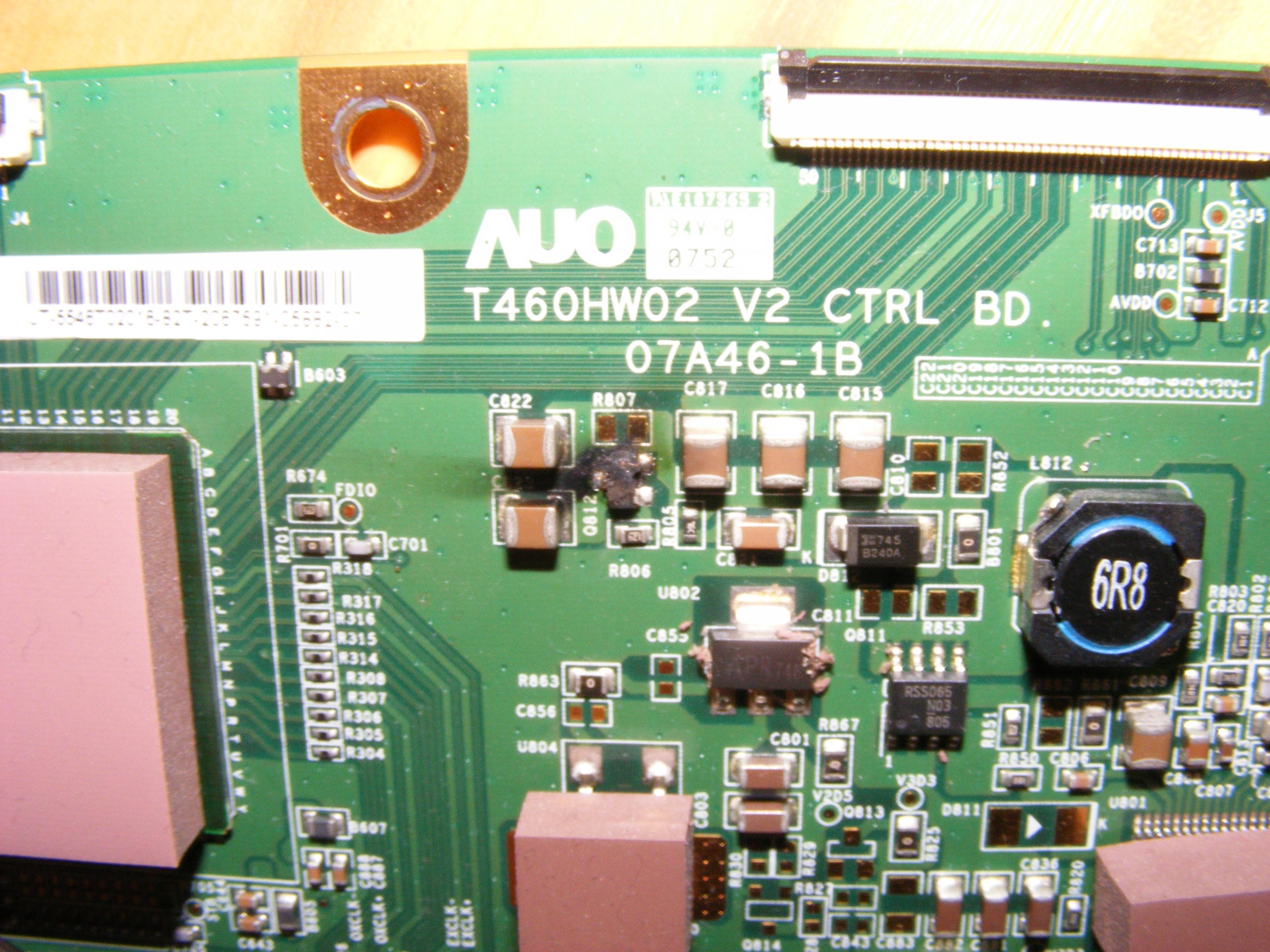

      I would say it probably PNP transistor due to the Emitter is connected to the B+ switching power supply to the right of it, it looks to be some kind of switch for B+. Should check between Collector (middle pin) and ground to see if it shows low Ohms.

              Ok, so I figured out you meant that the short to ground is what caused the transistor to burn. I've removed and refitted the AS15. There were a couple of pads underneath that were bridged - only visible once the ic was removed. Guess I was sloppy with the solder paste.
              Re-doing the ic has cleared the short between Q812 collector and ground, so I guess if I can replace the transistor there's a good chance of getting it working.
              So any suggestions how to choose a likely substitute?

                Do you have any PNP in your stock? It can be TO-92 case style such as 2N3906. I use lots of TO-92 for repair if the board has enough room, for example: http://s807.photobucket.com/user/bud...tml?sort=3&o=1

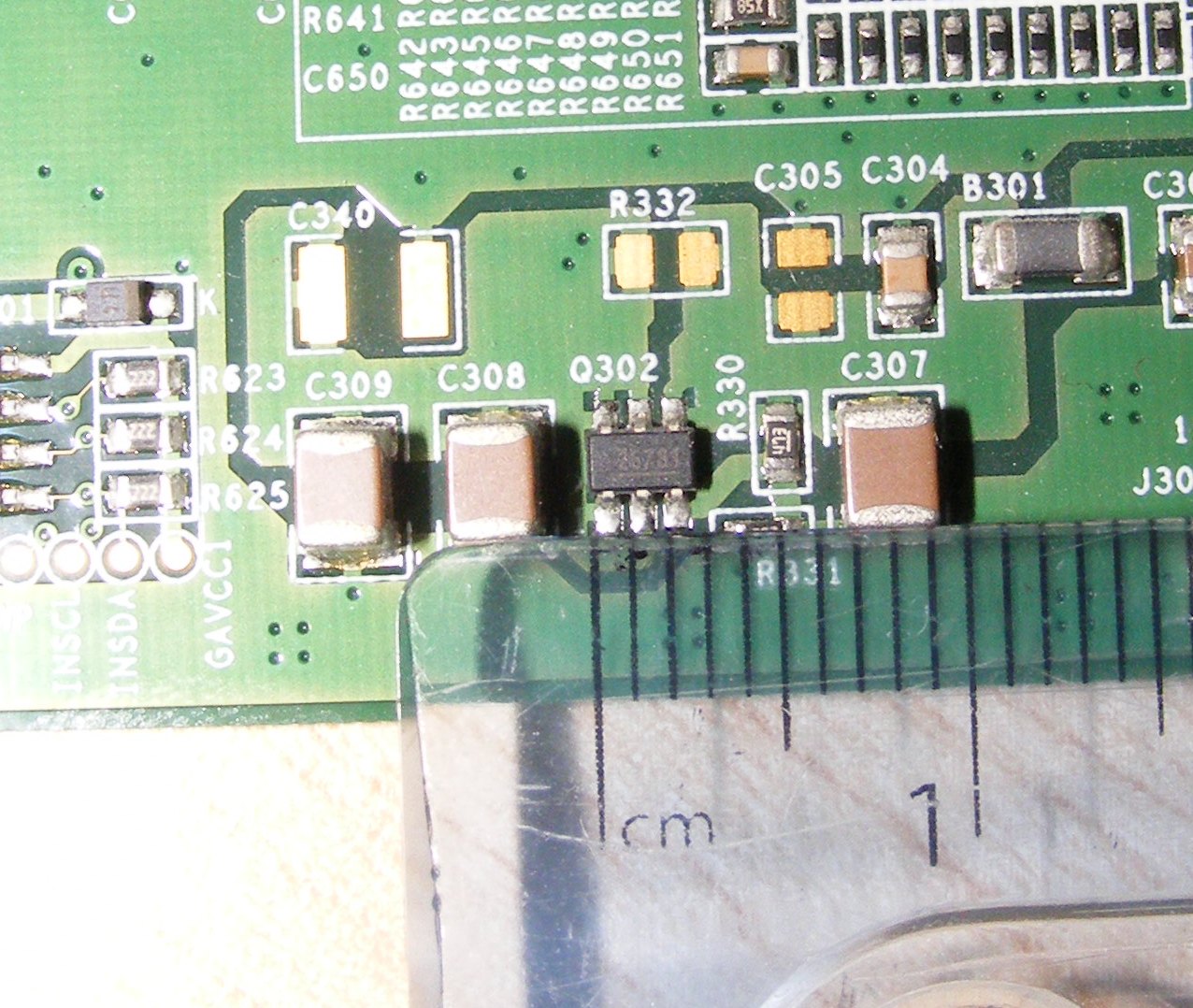

                    So I installed a new pnp transistor, which thankfully didn't explode, but.. there seem to be other things wrong with this board.
                    I have 12V at either end of F1, but Vcc, VGL, VGHC are all 0V. There are other voltages present around the board though. Gamma Vs are there, AVDD=11.6V, VGMA_REF=11.5V to take a few points at random. Both big voltage regulators on board have 0V on all pins.

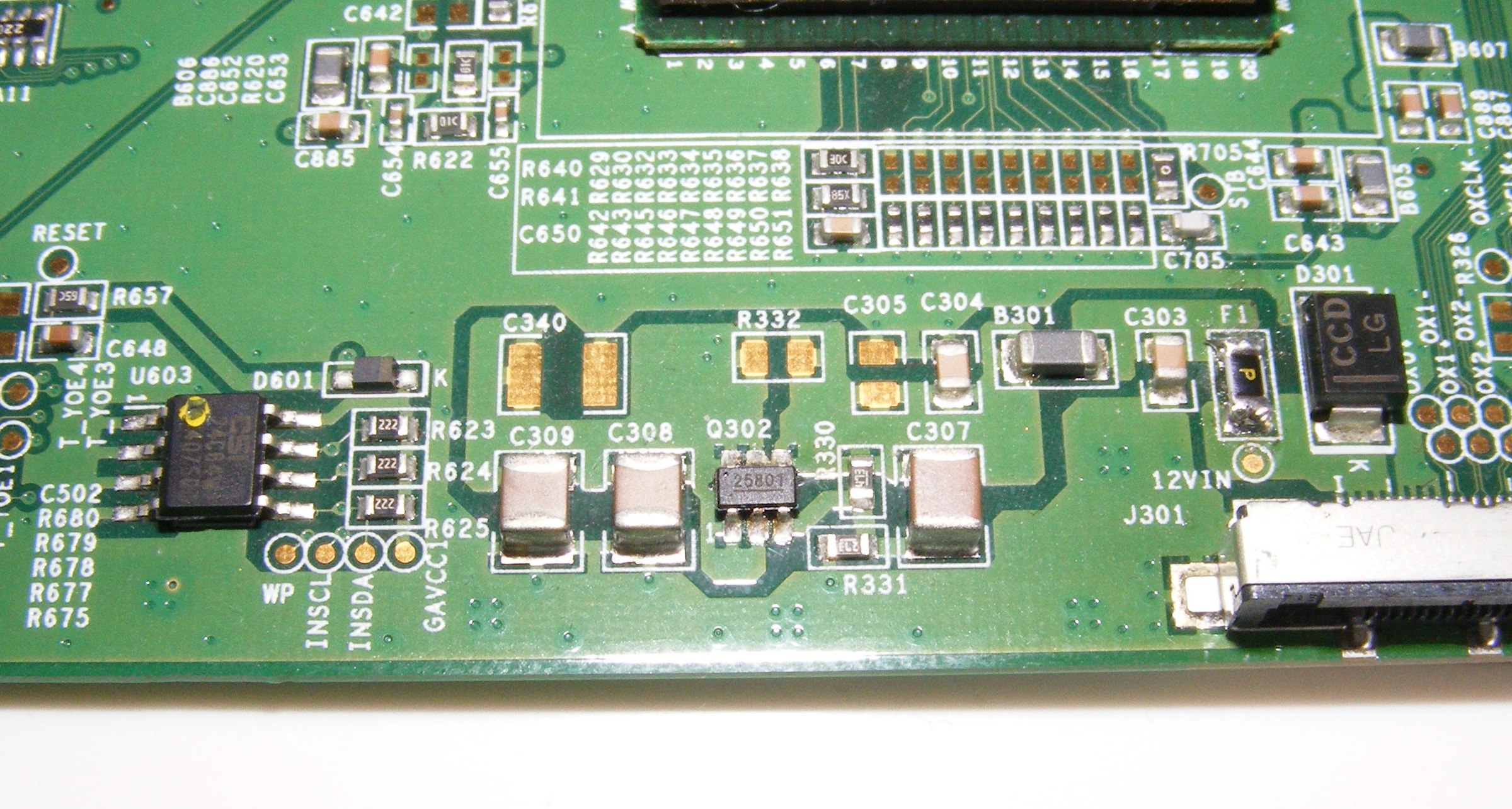

                    I found one part shorted. Q302 (centre of attached pic) - a six pin package. A MOSFET I guess?? Marking is 25801, but I think again an in-house number - on the other board I have, the same part is marked 25731. It has about 4 ohms pin 3-4 and to the other 4 pins which are all connected together on the PCB. On the working board it's 47k pin 3-4 as expected with R330 in parallel.
                    Any ideas of a good substitute? As I said I have a working but slightly different version of this board to make comparisons with.
                    Thanks for any help!

                      The Toshiba SSM6J212FE which is a P-channel MOSFET appears to have the correct pin-out for this application. I don't know the physical size of Q302 or it's electrical specifications so I can't say for sure this would work.

                            Thanks T30M1. Q302 seems a little larger than the SSM6J212FE. It's just under 3mm long while the SSM6J212FE is 1.6mm. See attached.
                            lookimback, thanks for the tips. It is helpful. This was the first AS15 I did. I've since done others that have gone much better and worked first time. Replacing my worn out soldering iron tip helped a lot, but so did some of the techniques you mentioned. Getting better all the time.
                            tom66. Thanks! And Q302 being short would cause that right? Would you go along with it being a P-channel mosfet in this application?

                                    TN245, it looks like a P-channel MOSFET would work as a high side switch the way Q302 is connected on this board. Q302 appears to be in an SOT26 case and I have found 2 possible replacements. Links to both are include below and you can check physical dimensions using the data sheets provided on the Farnell website.
                                    I don't know if Q302 is related to the missing voltages you referred to in your last post but the difference in resistance between Q302 pins 3 and 4 for the good and bad boards does indicate a problem around Q302. The lower resistance could be due to R330 or C307 but I think Q302 is most likely the problem.
                                    http://uk.farnell.com/diodes-inc/dmp...t26/dp/2061420
                                    http://uk.farnell.com/taiwan-semicon...t26/dp/1864596

                                      Awesome T30M31! Thanks so much for taking the time to look those up. I found someone selling the DMP3056LDM on ebay for £1.57 free postage, so not much to lose there if it doesn't work. Have ordered one.
                                      Still very interested in others' opinions about the other missing voltages and if it's related to Q302 or something else.
