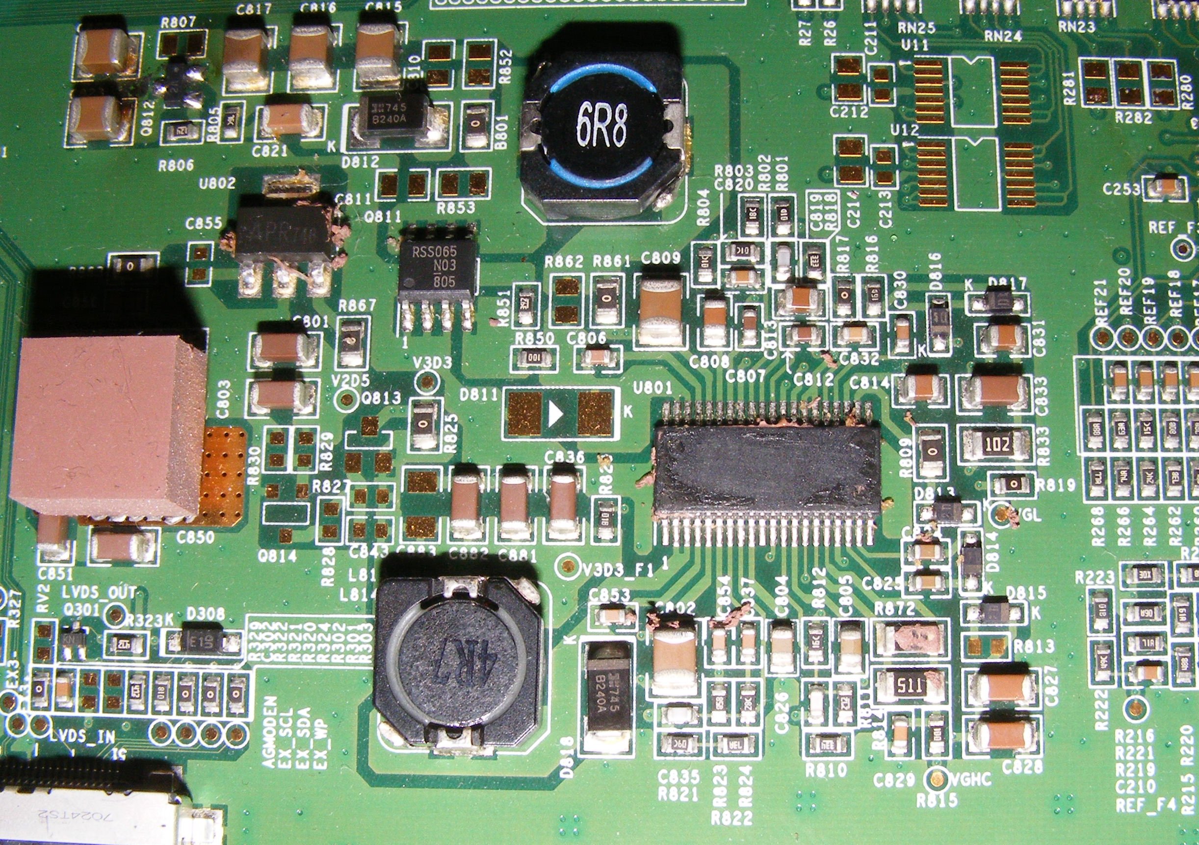

      Re: AUO t-con - Help me identify and replace transistor please!
      So tom66 after your hint about the boost converter not switching I figured maybe MOSFET Q811 wasn't getting the switching signal to it's base. I traced that back to U801 (see pic) which had been hiding under a thermal pad and I'm starting to suspect it may well be faulty. It is a BD8156EFV (datasheet attached).
      I'm not sure how exactly to test if it's faulty but it is getting 12V to VCC power supply input pins. Can anyone guide me on fault-finding for this IC? It's cheap enough to buy though will probably have to wait for delivery from China.

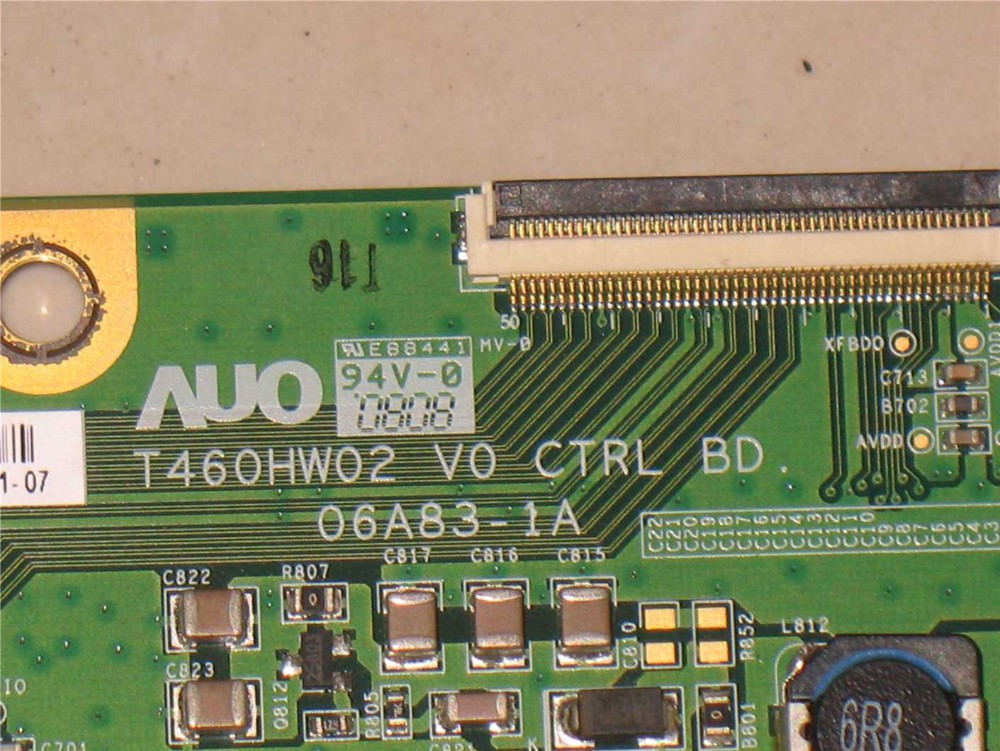

        A progress report.
        I put in the mosfet as suggested by T30M31, and replaced the BD8156EFV.
        Connected up the board without the panel connected and all voltages check out ok. Great!!
        But when I connect up the panel, I get no picture and the voltages change.
        Voltages without/with panel connected:
        AVDD 15.4V / 3.4V
        VGHC 24V / 28.3V
        VGMA_REF / 15.3V / 3.4V
        VGL -6V / -6V
        Without panel the pnp transistor I put in at the start of the thread has 15.5V, 14.8V, 15.4V (E/B/C). With panel connected collector drops to 3.3V while other pins stay the same.
        The panel is fine. It works with the other t-con I have, so there's still something wrong on this board.
        I will be testing more later, but any ideas would be greatly appreciated.
            Does the PNP transistor get hot with the panel connected?
            Have you checked R805, R806, C817, and C821? These all look like they are part of the Q812 circuit. It would probably be helpful to compare voltage readings on these components with the good TCON.
            The PNP transistor that you substituted may not have enough gain but that is only a guess since I don't know the specs on the original.
            The V0 boards looks like it used a zero ohm resistor/jumper at R807 in place of Q812. The Q812 circuit looks like it configured as a time delay circuit to sequence power.
                Thanks for the replies guys.
                The PNP transistor is getting quite hot yes. Nothing else is particularly hot. The new ic is a little warm, but it had thermal pads top and bottom before which I haven't replaced yet so I think that is normal.
                T30M31, as the good board is the V0 board without that transistor, it's not possible to compare readings on those components as they are not present on the V0.
                Measuring resistance to ground from AVDD (collector of the PNP) it is actually just slightly lower on the good board.
                If the transistor doesn't have enough gain, would that be consistent with it getting hot?
                I'm tempted to try jumpering across R807 to cut out the transistor entirely and replicate what the V0 board is doing, just to rule out the transistor as the problem. Good idea or not?

                      #30
                      Transistor gain would not be an issue with it getting hot. It must be something down stream of the transistor that is overloading it.
                      Probably not a good idea to jump around the transistor if it is overloaded. I would stick with resistance measurements of all that is fed by the collector of this transistor.
                      After thinking on it a bit more, the gain could be an issue. If the transistor is used as an on/off switch it may not be conducting enough to supply the load and this would cause excess power dissipation. If that is the case the jumper might be an OK test. Before trying the jumper I would compare the resistance from collector to ground on both TCON boards. Since the V0 board does not have the transistor measure from the pad where the collector would be connected.
                      If the V2 board has a lower resistance it is probably an overload condition. And as lookimback mentioned the TCON needs to be connected and power off when making this resistance check.
                                It might be that Q812 is a P-Channel Power MOSFET instead of a general purpose PNP transistor. Something like an Si2369DS might work since it is designed for load switching.
                                I don't think there would be a great deal of risk in trying the jumper. You may want to remove the PNP transistor first. Anyone else have an opinion about this?

                                    #37
                                    T30M31, thanks. So maybe I'll order some P-channel MOSFETs along with some higher gain PNPs to try out.
                                    Would any of these work for the MOSFET do you think? Since it'll be a lot cheaper and easier for me to order from cpc and they don't stock the one you suggested:
                                    http://goo.gl/dXR6F4
                                    The package body of the original part was a little chunkier than bipolars I've seen in SOT-23 and other transistors on the same board. Don't know if that means anything.
                                    lookimback. Wow, that's interesting. On that board there's the transistor AND the jumper effectively bypassing the transistor no? That seems odd. The part numbers don't seem to be very useful. I've seen the same parts on the same board versions with different numbers on them.
