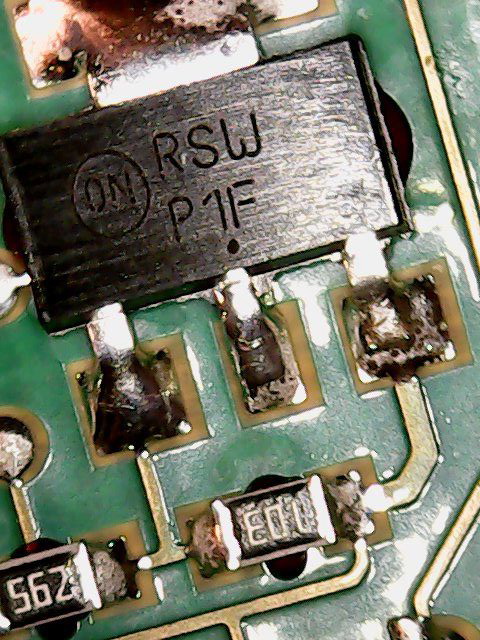

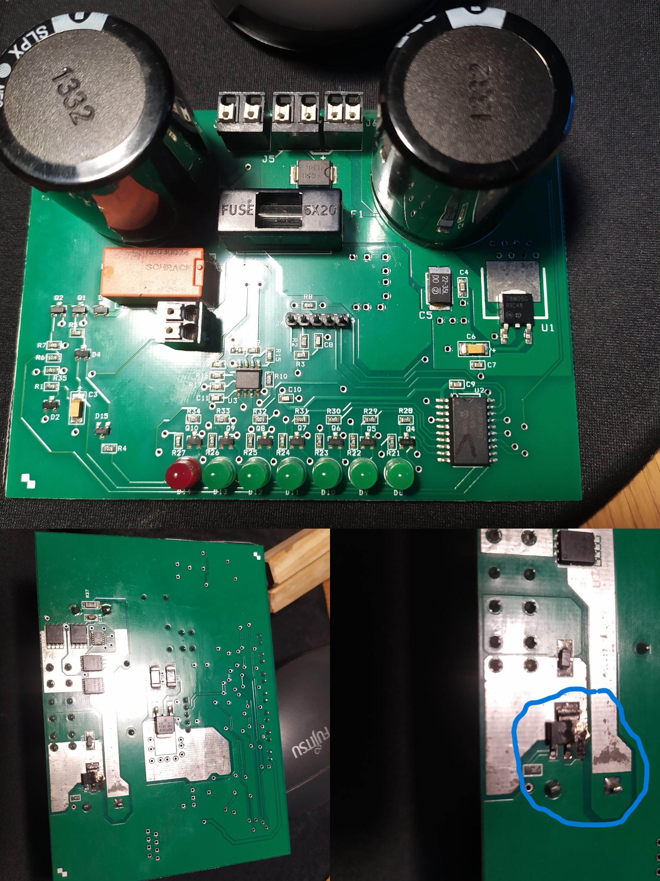

    Hi guys,
    Trying to repair a pcb from a power supply's pool's robot ( KWADOO v.2), i can't identify the burned transistor Q3.
    Could you help me ?
    Thks a lot
    Jean

    Re: Help to identify destroyed transistor from a power supply's pool's robot KWADOO v
    Looks like an LDO regulator to me.
    Pin 1 GND, pin2 and tab Vout, pin 3 Vin?
    Maybe something similar like an AMS1117
    Or:
    Pin 1 Vss/adj. pin2 and tab Vout and pin 3 Vin.
    Pics aren’t that great to see where the pins go and what these resistors are. See where the pads connect to.
      It looks like a SOT-223 transistor to me, emitter connects to ground, collector to clamp diode and the load, base to that resistor and then a via to somewhere else. Like BCE or GDS.
      I would follow the base trace pin 1 to determine what it is; N-ch mosfet (goes directly to PIC MCU) or NPN transistor (through another resistor to PIC) BCP56.
      The PC board is a bad design - the transistor copper-fill area for heatsinking has a cut or island around it, so the heat stays local.
      The transistor burned up because it was overloaded, so fix that first.
        Thks you both for your answers.
        I think it was a transistor because of the inscription Q3. Under the microscope i could read the brand ON on the piece of the recto.After some researches, i found that it was perhaps a transistor P1F, but i'm not confident.If i follow the trace from the resistor (10 ohms), it goes to the negative of the two condensators ( ground ?)
        If i found the type of this transistor, is it possible to replace it by one with three legs ?
        Thanks a lot for your help.
        Jean
          On p1f (sot-223) - pzt2222a
            Thks a lot, i'm going to search one in my junk.
