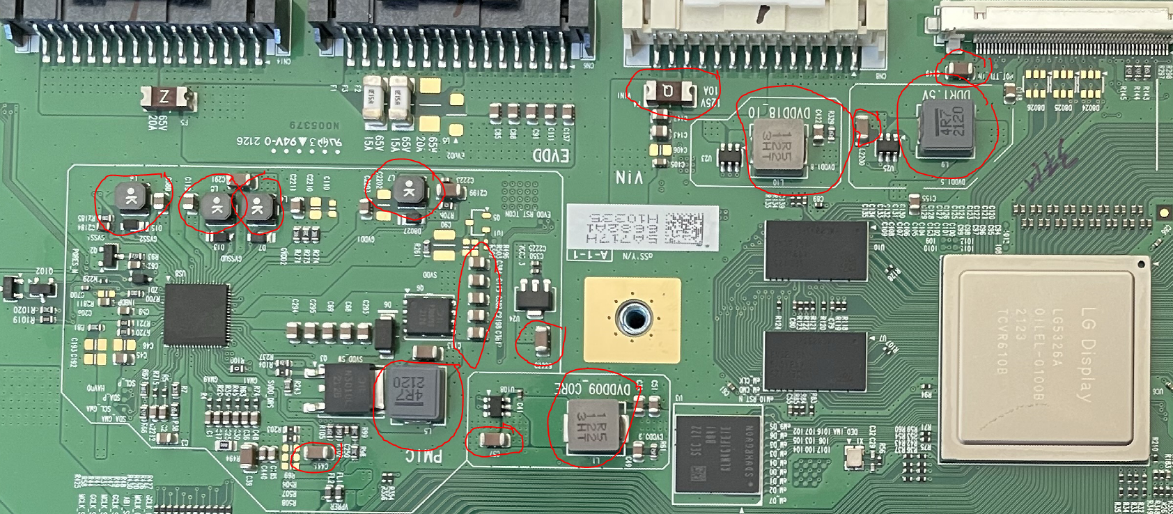

    Here are the voltages:
    The fuses on the top left (F1, F3 and F5) all measure 21.6V on both sides.
    FL2 and FL1 (below the fuses) both measure 2.24V on both sides.
    R77 measures 12.7V on both sides.
    R76 measures 0V on both sides.
    I'm hoping that 0V at R76 tells us something...
        disconnect the screen ribbon close to R76 and test again​

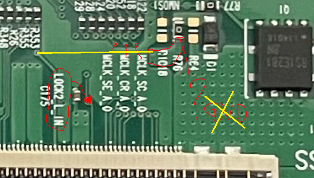

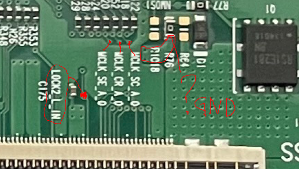

              Sorry... I'm not exactly sure what you're asking (or how to compare the value of R76 with R77). I unplugged the TV and measured resistance of R76 and R77. Both measured 0 ohms, I assume because of the circuit they're in. The diode measured 1.63 in one direction and .146 in the other direction. Does this answer the question?

                R76 - if this jumper sits on the ground, then there will be no voltage on it.

                  lotas
                  R76 are the LOCK2 lune connect via the sandwich boards

                    #29
                    That jumper doesn't appear to sit on ground, and even if it did, wouldn't we still expect to see non-zero voltage on the other side of R76? I measured resistance from the bottom of R76 to ground and it measured 3.7K. Then I reversed the polarity and it measured 8.2K. Interestingly, I got the same values when testing from the top of R76. As stated earlier, resistance is 0 across the resistor (in either polarity).
                    As you know, I'm no expert. But is it possible that the resistor is bad? (I'm not used to seeing bad resistors. I've seen lots of bad transistors, diodes and capacitors, but I can't remember seeing a bad resistor.) It would be nice to have proof of a bad TCON.. Is this it?

                        #31
                        Originally posted by Diah
                        lotas
                        What does LOCK2 lune connect have to do with it?

                                Where does this confidence come from? You don’t know how control points are marked.

                                  don't be rude and funny over here.. by playing corrector man.. if you have some things help the owner of the threat welcome.
                                  no place to explain how are LOCK work .. it had IN and OUT for adjusting the currents....... you wrote GND and i said NO. and the ownet give you the measurement with GND.. so could you stop.--?

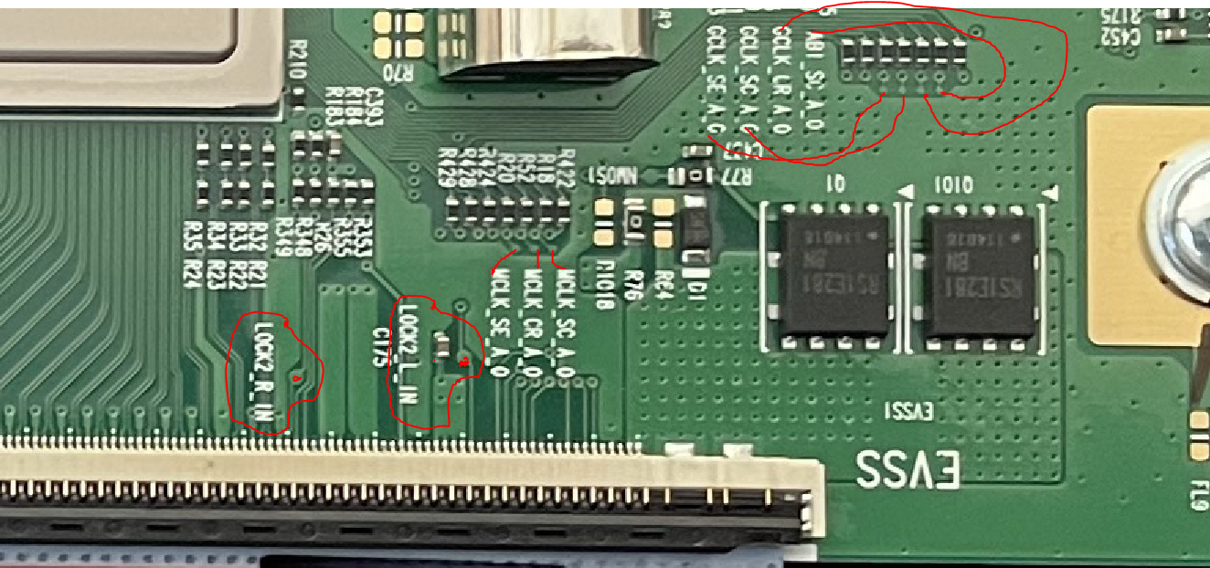

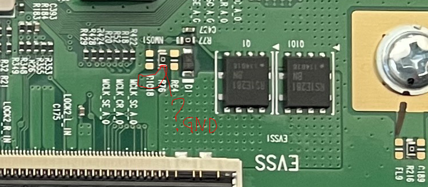

                                          from yours both photos of the screen..the panel module look fine to me... but in case as you wrote it could be pull or drop currents... you can use Car filament lamp ( Lamp for trucks with one Filament 24V) or ( one with 2 Filament 12V ) we connect the lamp direct on the EVVD line and chassis ... any drop or pull over currents the lamp will show us by remain on or turn off.
                                          one things more from my side as last comment .. i marked for you the line of SOS signal. at the lower LVDS socket.. if we take it out from circuit and let the line which come from MB connect via 1KR to chassis the TV will remain ON. so you can see if the screen had bad cells.
