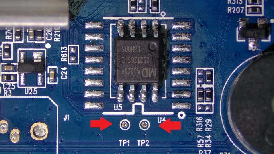

    Hello all just wondering if anyone knows how to do a hard reset on this model, XVR58C-21D-8CH-V1.1 ?
    There are videos on youtube for every other model but this one, I do not have the switch on the board or reset jumpers.
    https://www.youtube.com/watch?v=Ao7EwIMDx_c
    I do have 2 little pads right next to the firmware chip, I have shorted these and powered the system on and waited a wile
    with no luck. I will add picture of these 2 pads.
    I do have the bin file from the firmware if its any good to anyone maybe able to edit out the pass I am not sure.
    I will not upload unless its asked for to save space on the site.
    Any help on resetting this password please. Thanks.

    Pin 7 are the HOLD/RSET , which need to be low for short time or longer to reset the Flash. check this pins to the tips point you mentioned.. if not related then do it direct on PIN7

      Thanks mate for giving it a go, it didn't work I done it 4 or 5 times it says to connect it for about 20 seconds on all the videos I have seen.
      I took the battery out before I started. I will give this another go tomorrow mate. Thank you.
