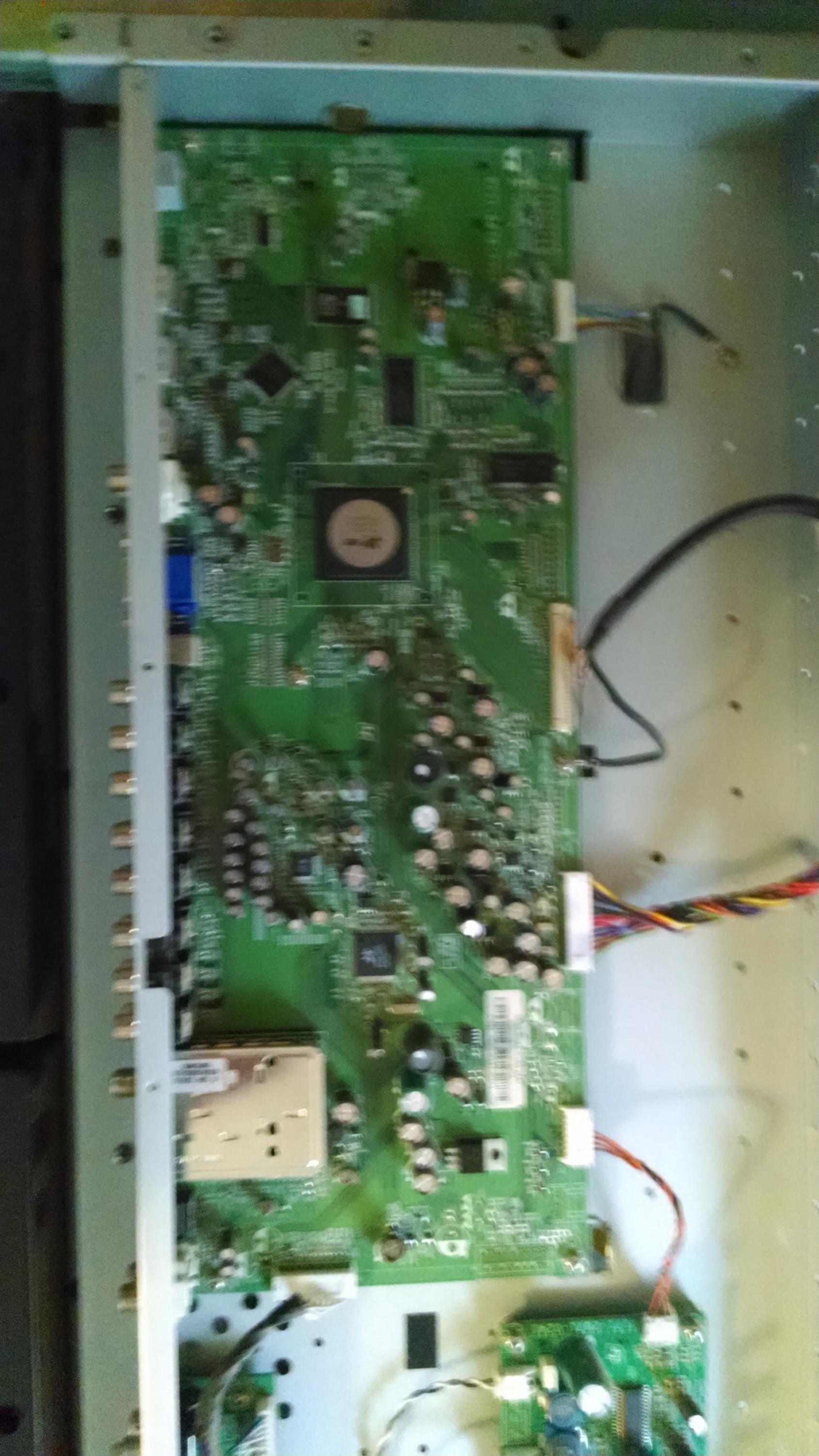

    Vizio P50 HDTV20A
    Okay this is a 50" Plasma Television. The TV powers on I have sound on all inputs. The Picture though is terrible and transitionally fades into existence only after considerable warm up. The picture when it finally comes up ends up patchy with a fuzzy appearance and sometimes patches are missing other times they are not. The picture is always darker than it should be.

      Re: Vizio P50 HDTV20A
      This is a pretty typical state for the t.v to be in. Caps look okay.

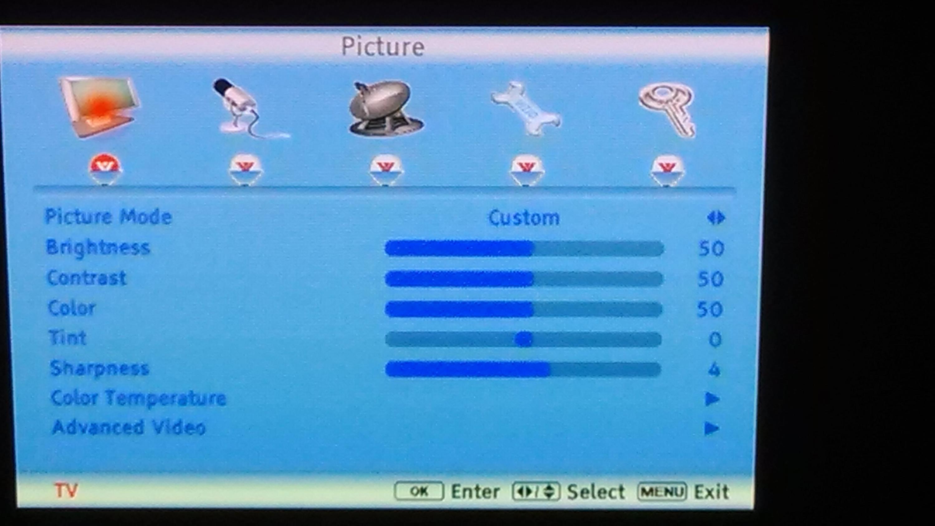

            Is it my eyes or does the menu look ok ?

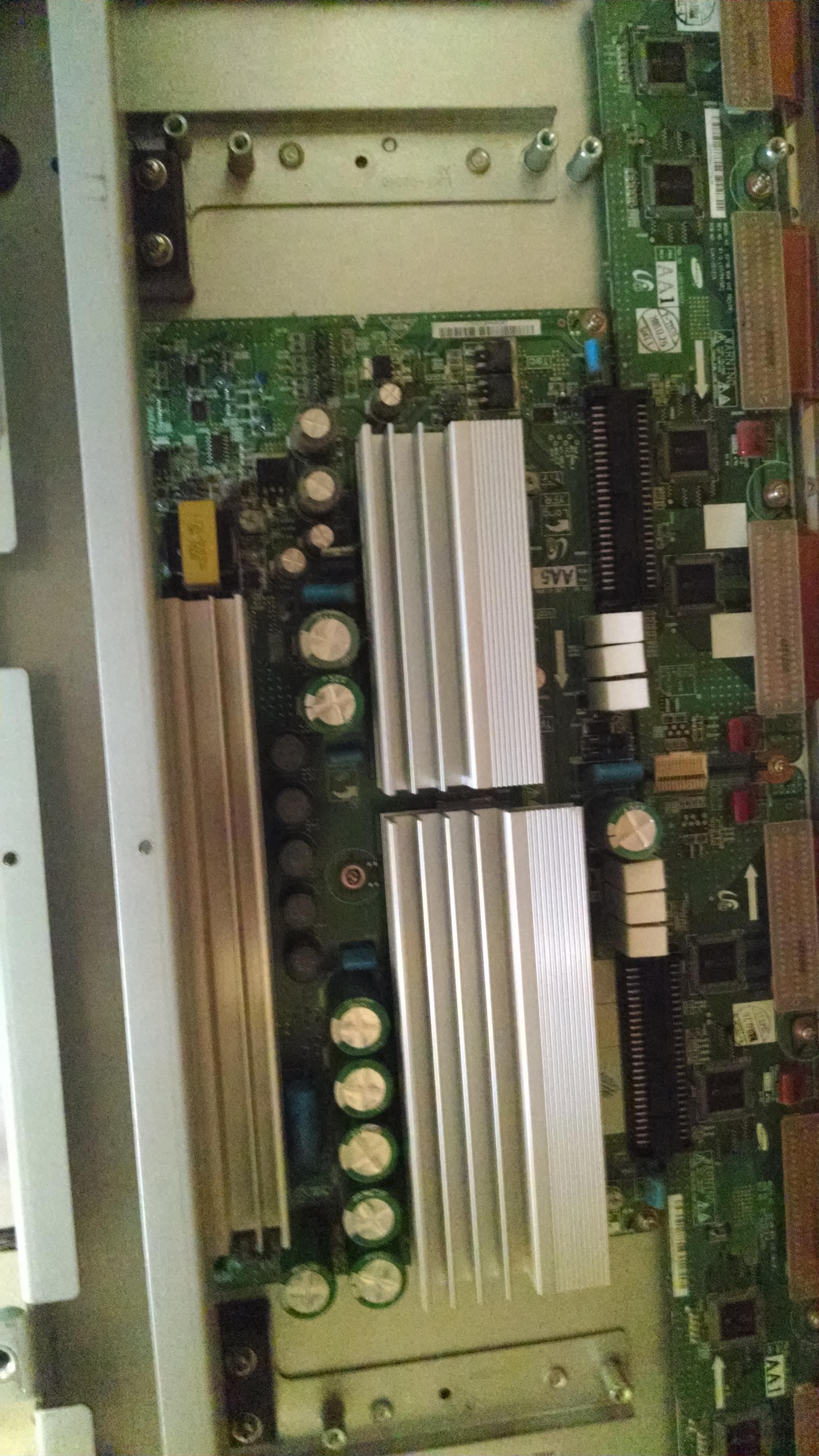

              Looks like failed ZSUS assuming it's LG based panel or xmain if samsung but I'm expecting this is LG.
                okay the tv is in fact Samsung based. No caps appear to be bad as I can tell here are some more photos.
                  I did find one bad cap on the xmain a smaller one. I replaced it but it did not fix the problem. I have noted a high pitch noise coming from the powersupply right where another cap is. I guess I am going to start taking some readings to see what my voltage is. Any suggestions?
                    Check the power to the Xmain and the fuses (1 ceramic, 3 green pico) on that board. There's a Vs and Ve test point on the PCB next to CN4701 where power enters.
                      X-main fault, IMHO.
                                        This is what the menu is supposed to look like compare to the first photo I submitted on this post.
