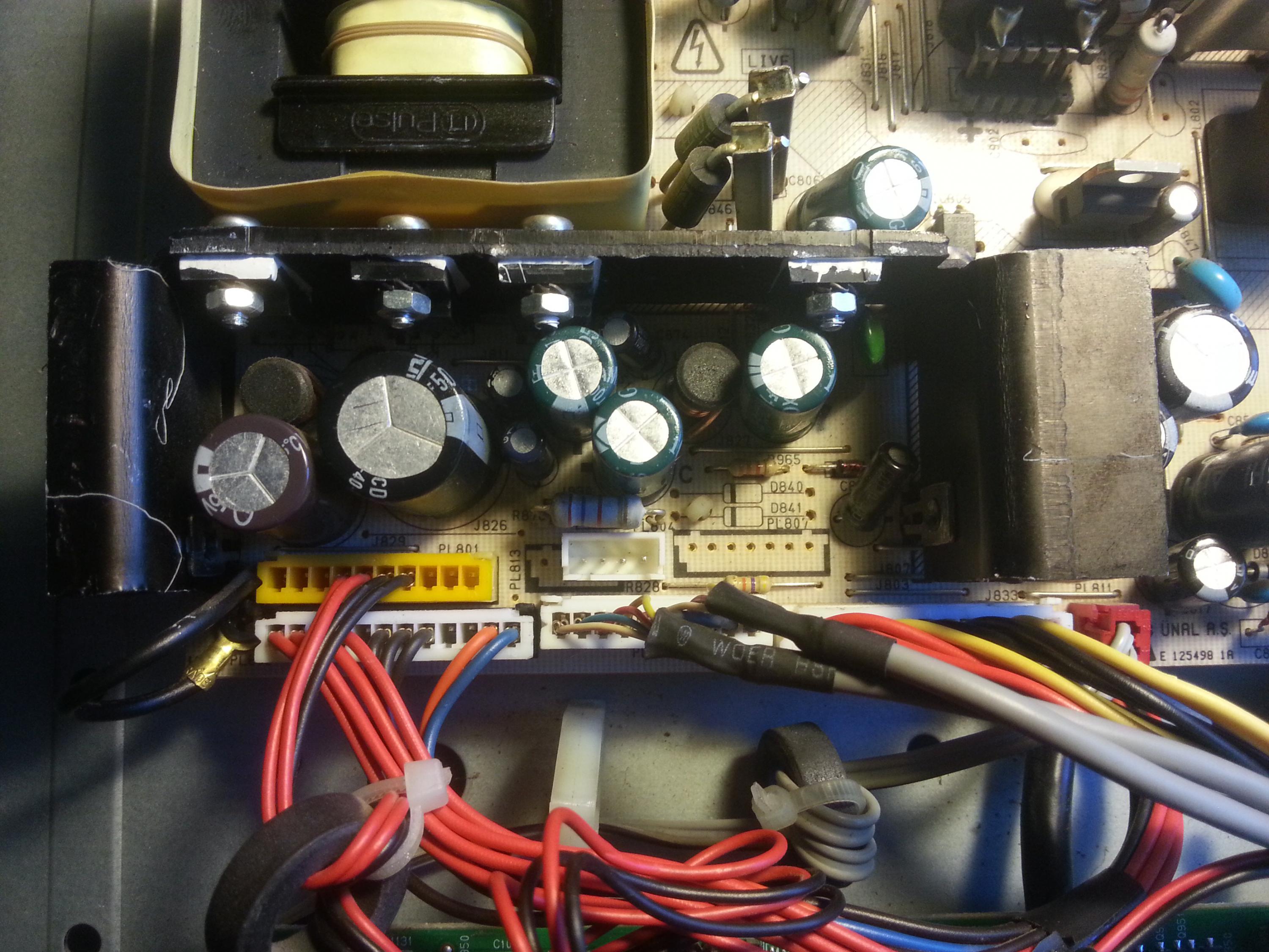

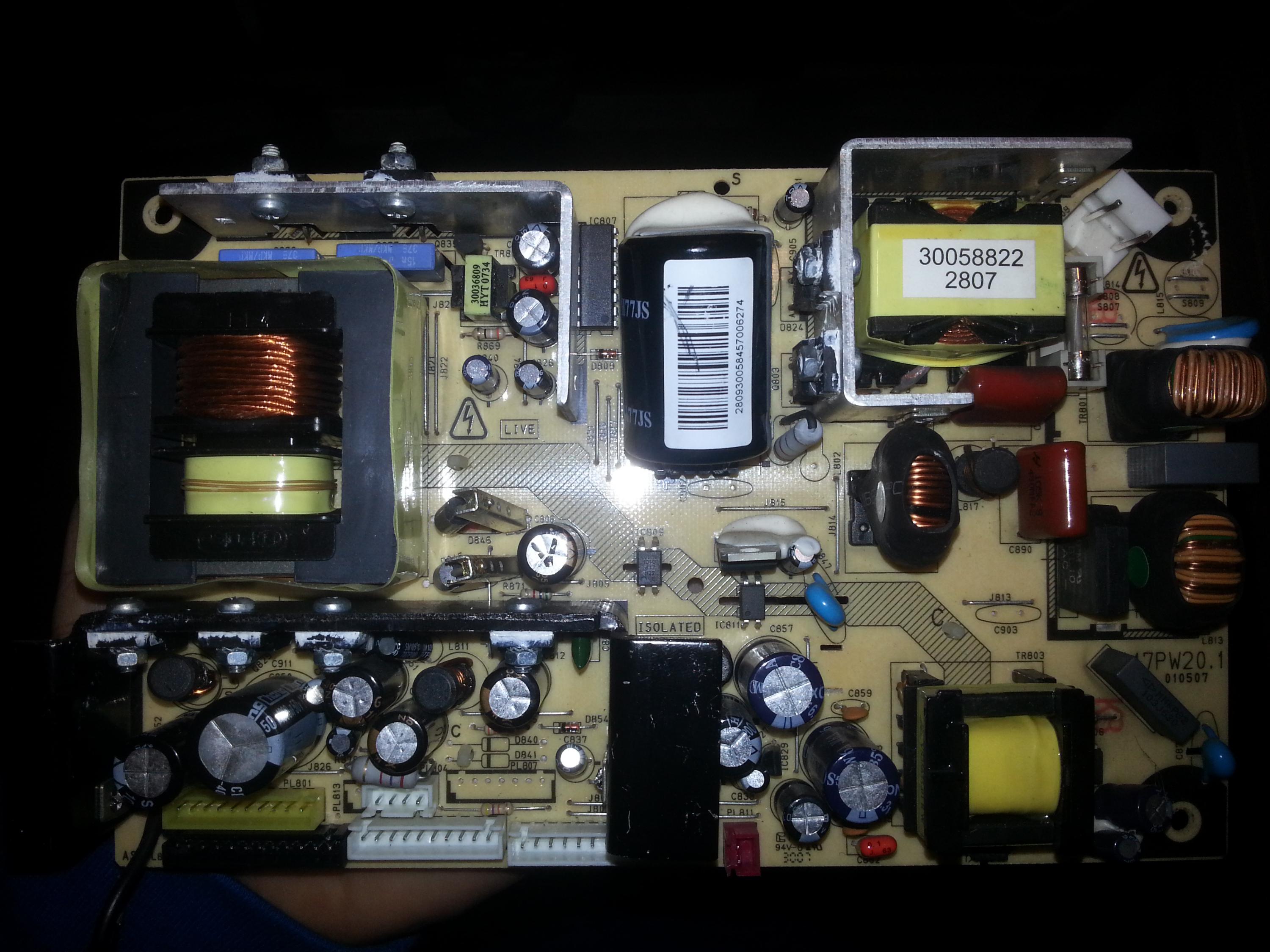

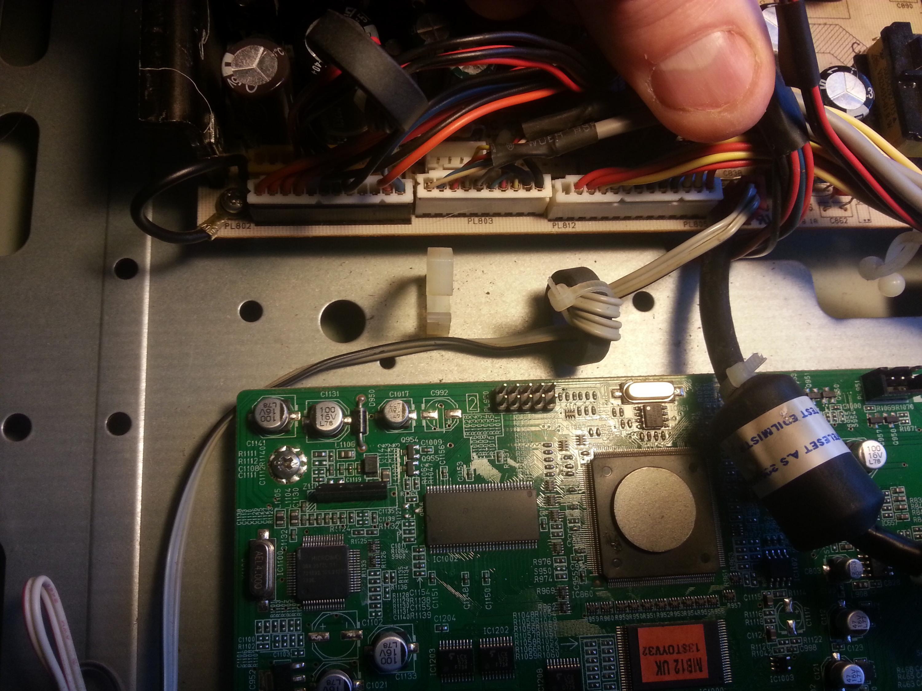

    I would concentrate on getting a decent picture of your power supply and posting it using manage attachments so it can be expanded. Around 2mb and you need to get the lighting right.
    What I find odd is that I cant see any normal testing being done- perhaps you have done it and just not reported it. Usual thing is to check the secondary
    voltages at the connector to the main board. If there are none or they test shakey then go back to testing the primary voltage.

      Re: Logik LOG32lw782
      just found this
      https://www.badcaps.net/forum/showthread.php?t=15313
      according to this i have voltage at pin 1 on pl803
          i was unsure of pin layout as none had voltage readings on.

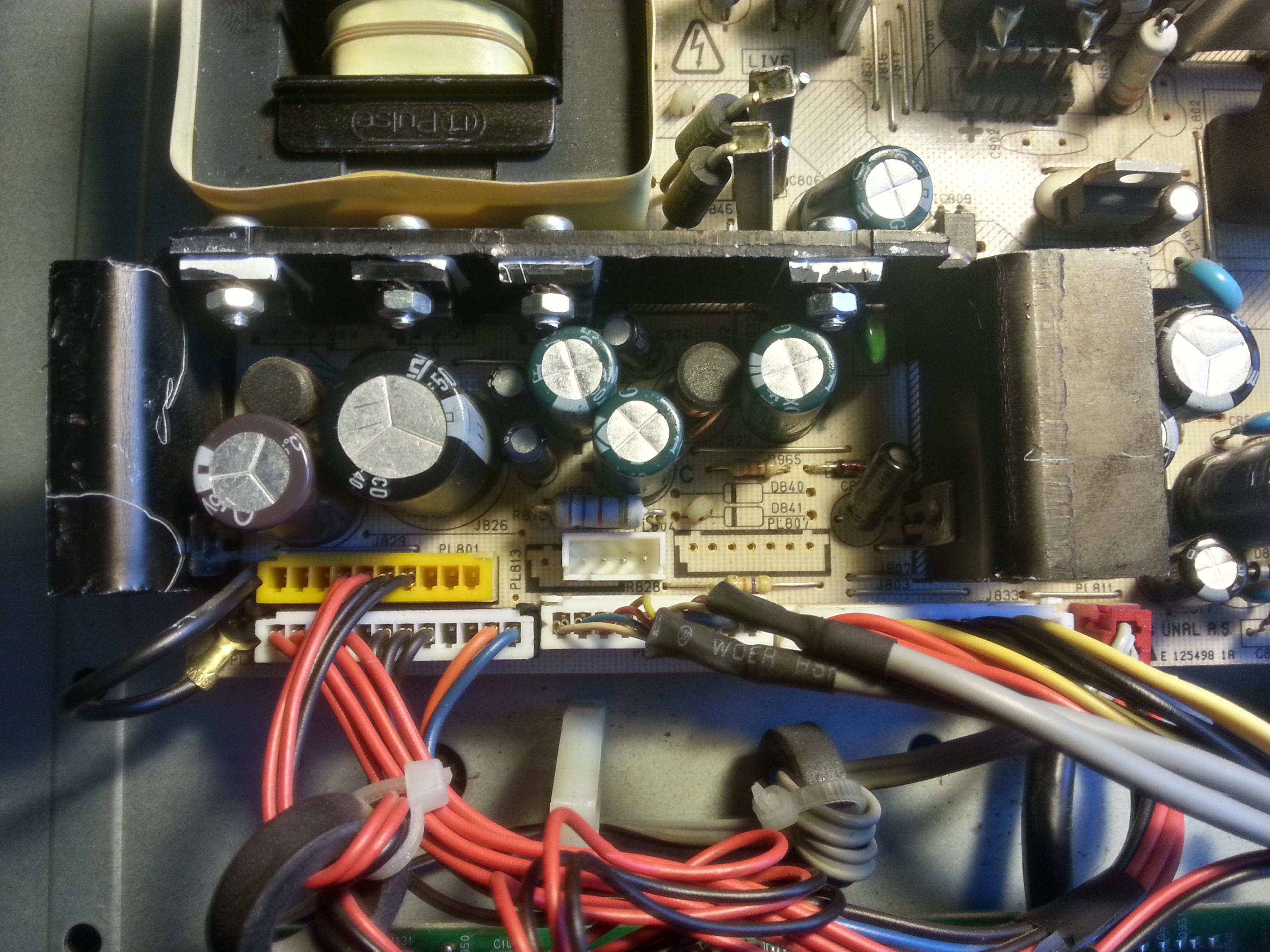

              PL803 when ON:
              #1: 3.46V
              #2: 0.003V
              #3: rises then drops a bit all over the place V - 0.150V (climbs slowly)
              #4: 0.00V
              #5: 0.010V
              #6: 3.010V
              #7: 00.03V (for tuner?)
              #8: 00.00V
              #9: -0.000V
              #10: -0.000V
              could this be duff psu then

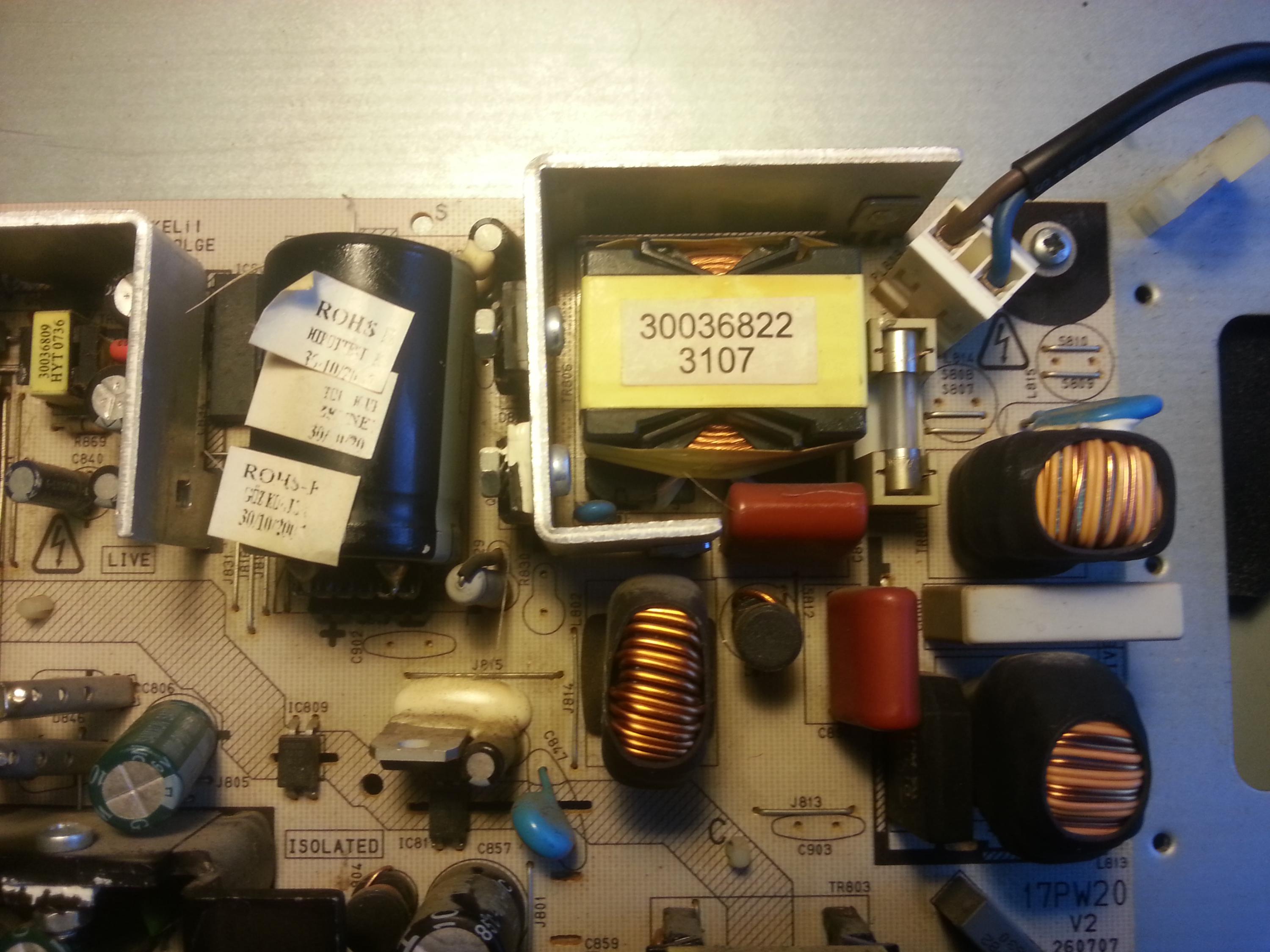

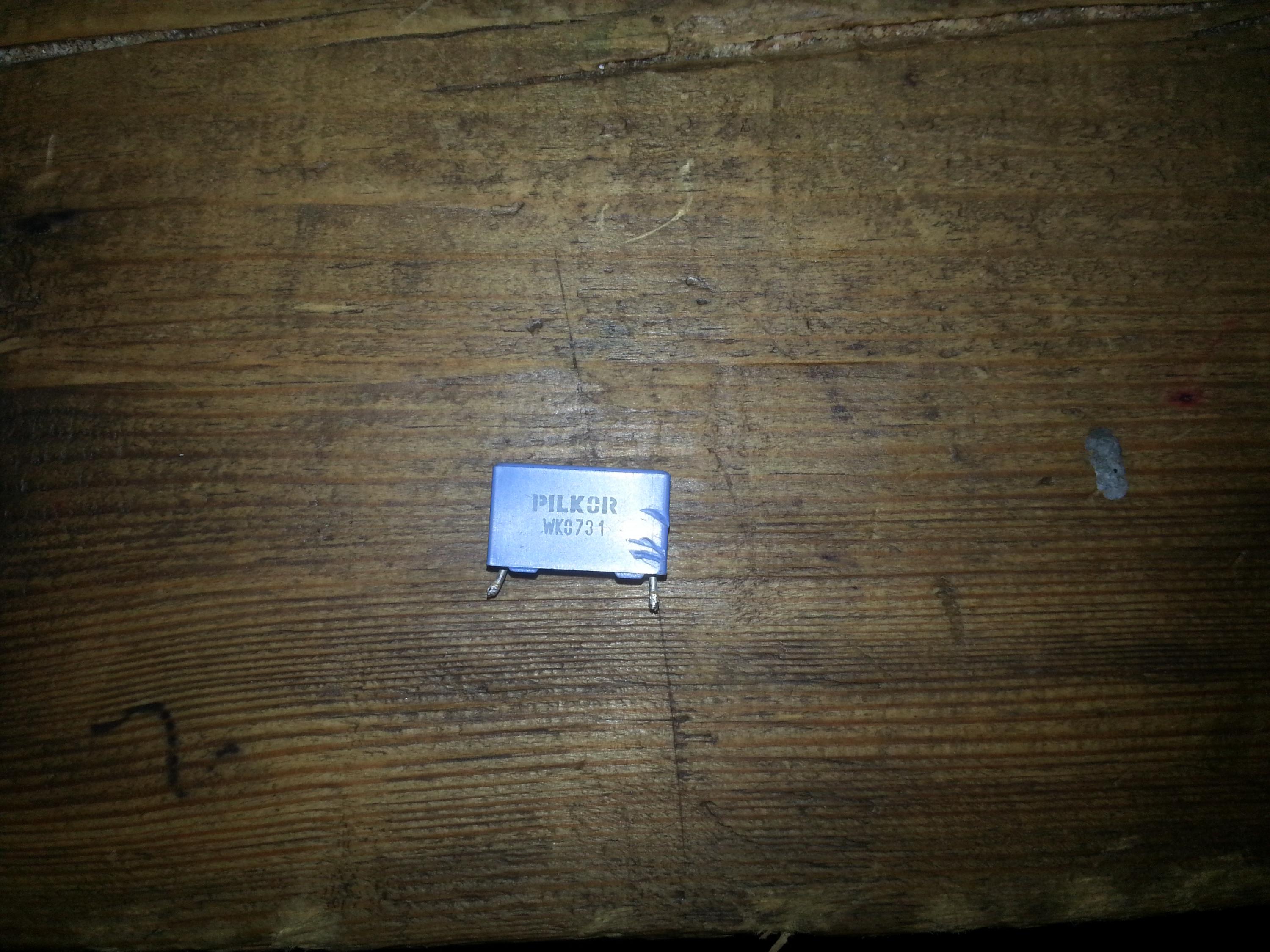

                  Originally posted by joehezzer
                  just found a pdf file with all the right values. will have a mess in the week. i have also found one of these in the pic with a bulge in it not sure if i am right but is it a capacitor!! it reads 15n j 600v 373 mkp/mkp
                  15nf 600v plastic film cap is that right
                  • multimeter
                    • Jan 2011
                    • 739
                    • united kingdom
                    #29
                    yes,these are a common failiure in samsung bn*** power supplys also.
                    fixed so far...376 lg lcd tv's,24 onn tv;s,24 panasonic lcd,16 jvc lcd,12 marshall jcm800 amps,refurb of various disco equipment lighting,old style disco decks ,and a flymo!
                    please let us know if everything works ok if your tv gets fixed, as it will be and aid for anyone else having the same problem and wishing to fix it.it would save people clogging up this site with topics that are duplicated,and can be found easily using the search function.,and taking up valuable space.enjoy your fixed tv!,hopefully!

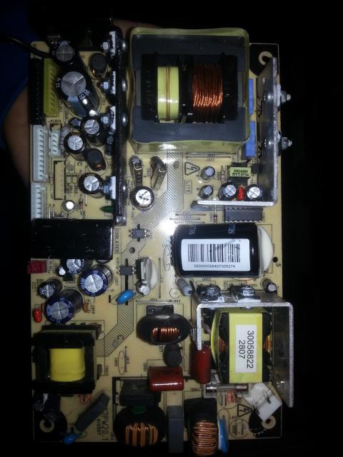

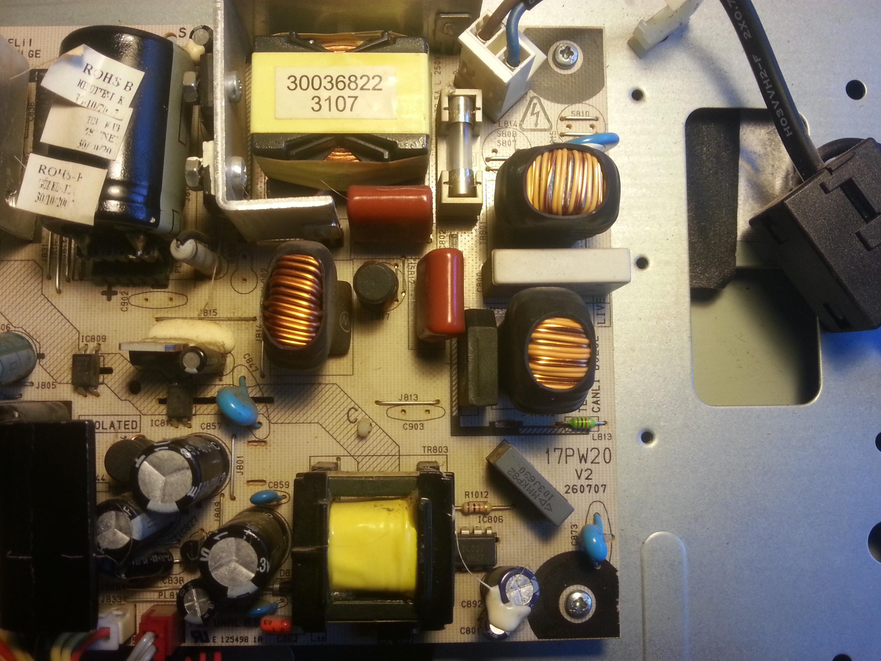

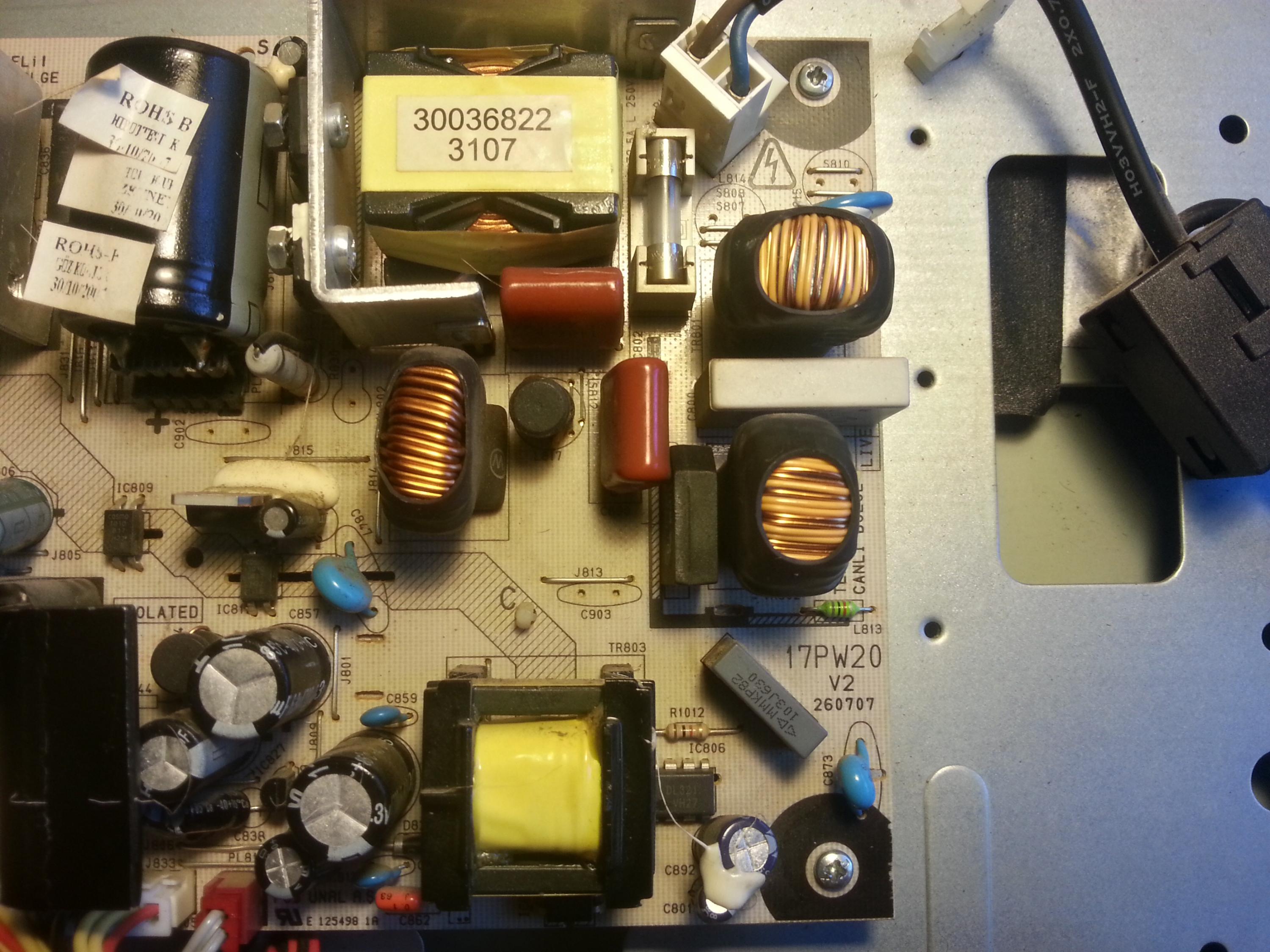

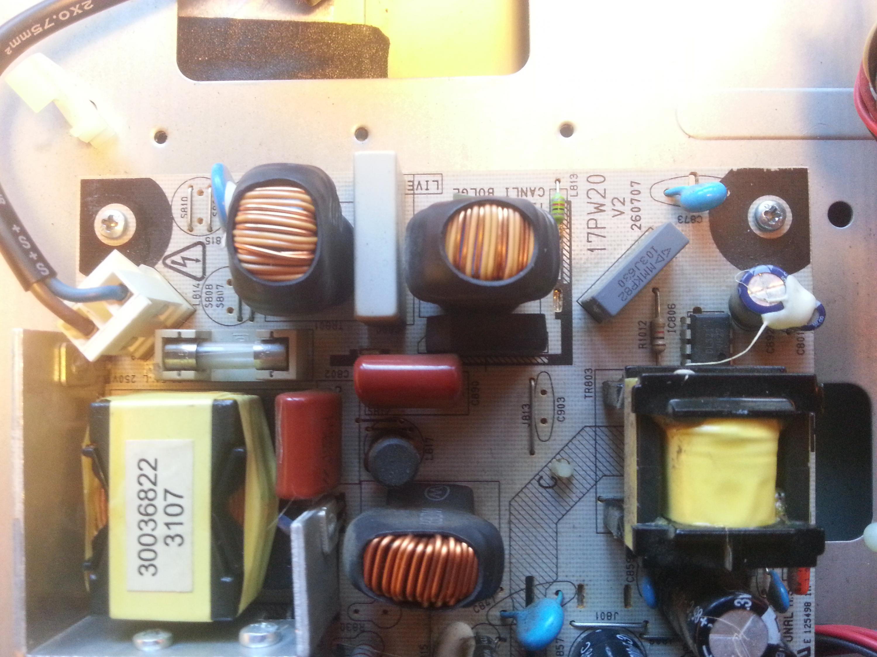

                                #35

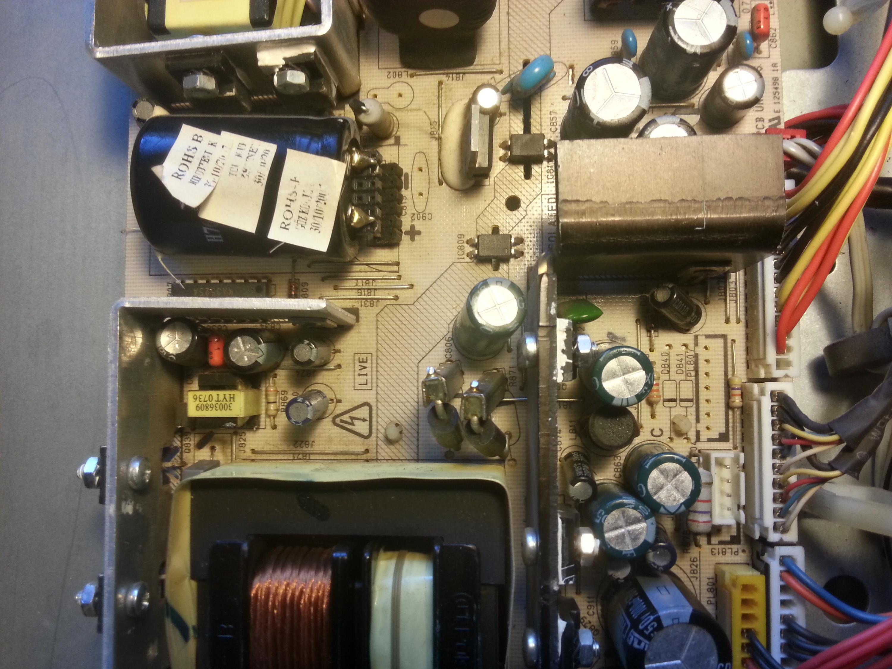

                                It is a nice bright day up here - if its same in Devon take the boards outside
                                and try for some better pictures. They are just not big enough or bright enough for troubleshooting. You have got the connector to the main board connected whilst testing?
                                • selldoor
                                  Slow Learner
                                  • Dec 2010
                                  • 7870

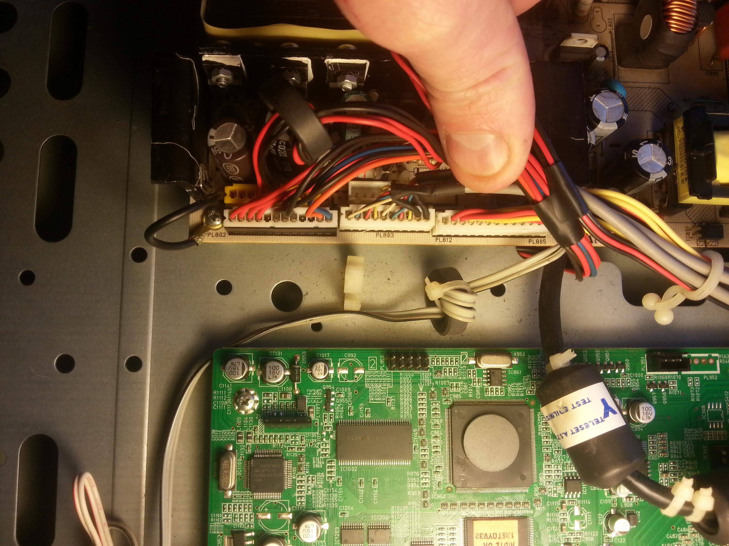

                                    #37

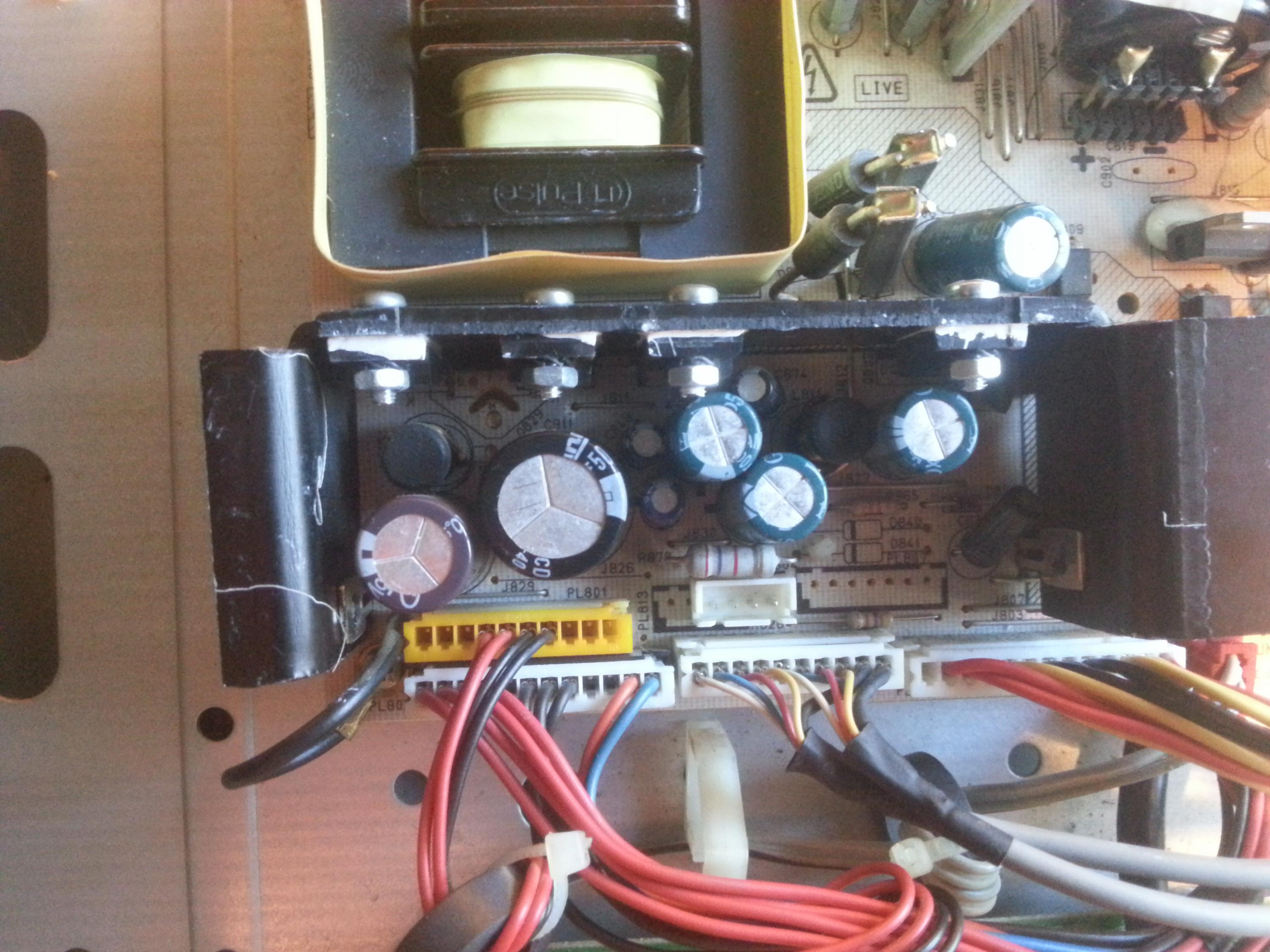

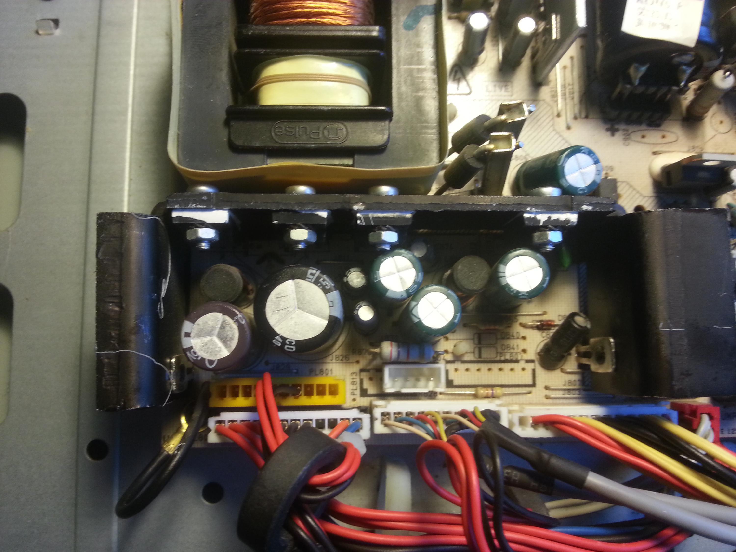

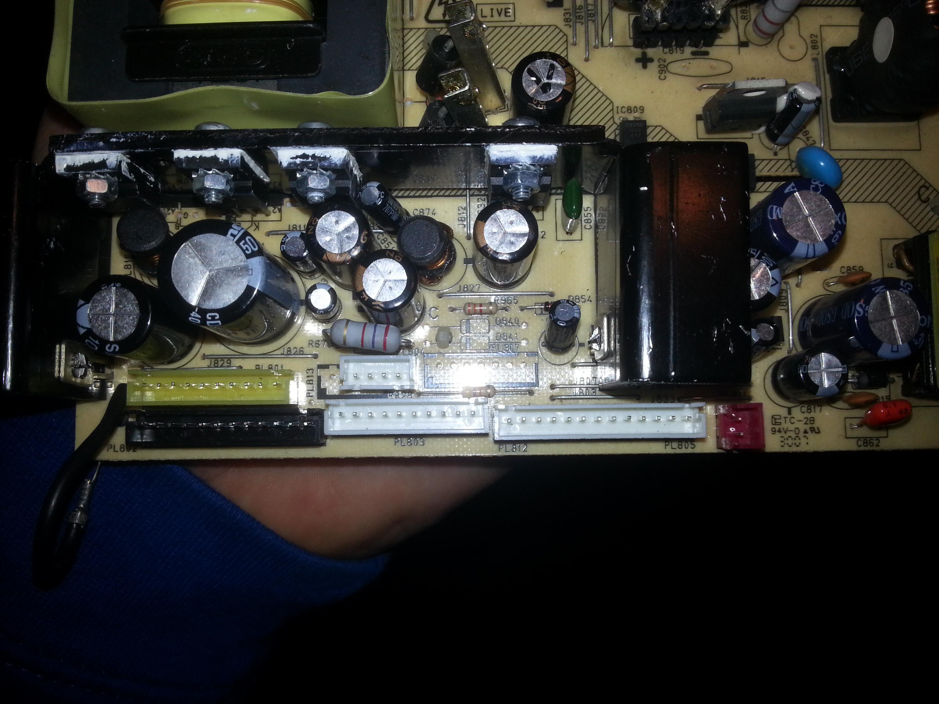

                                    will get some pics now
                                    • joehezzer
                                      • Jul 2012
                                      • 251
                                      • England
                                      #38

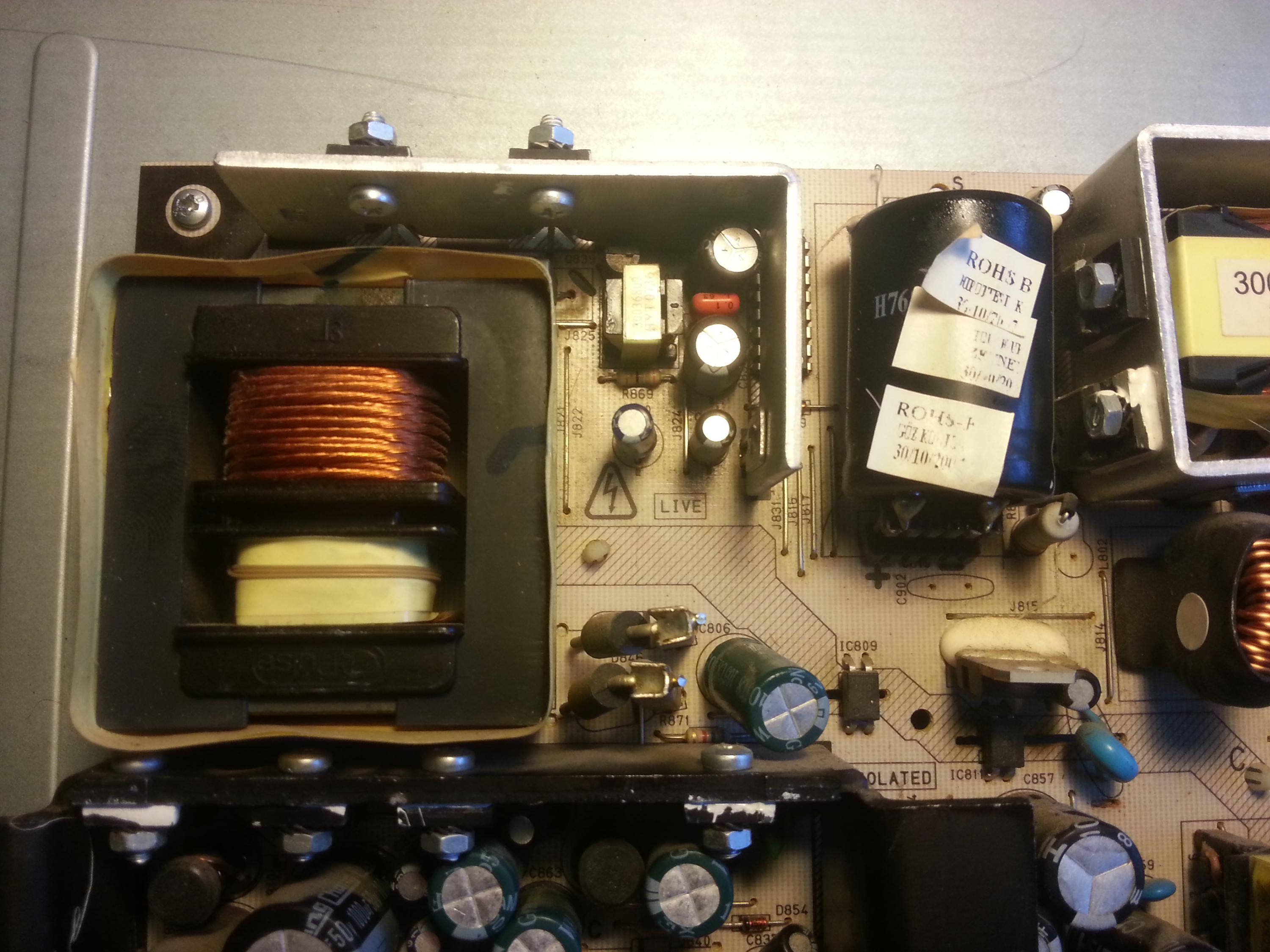

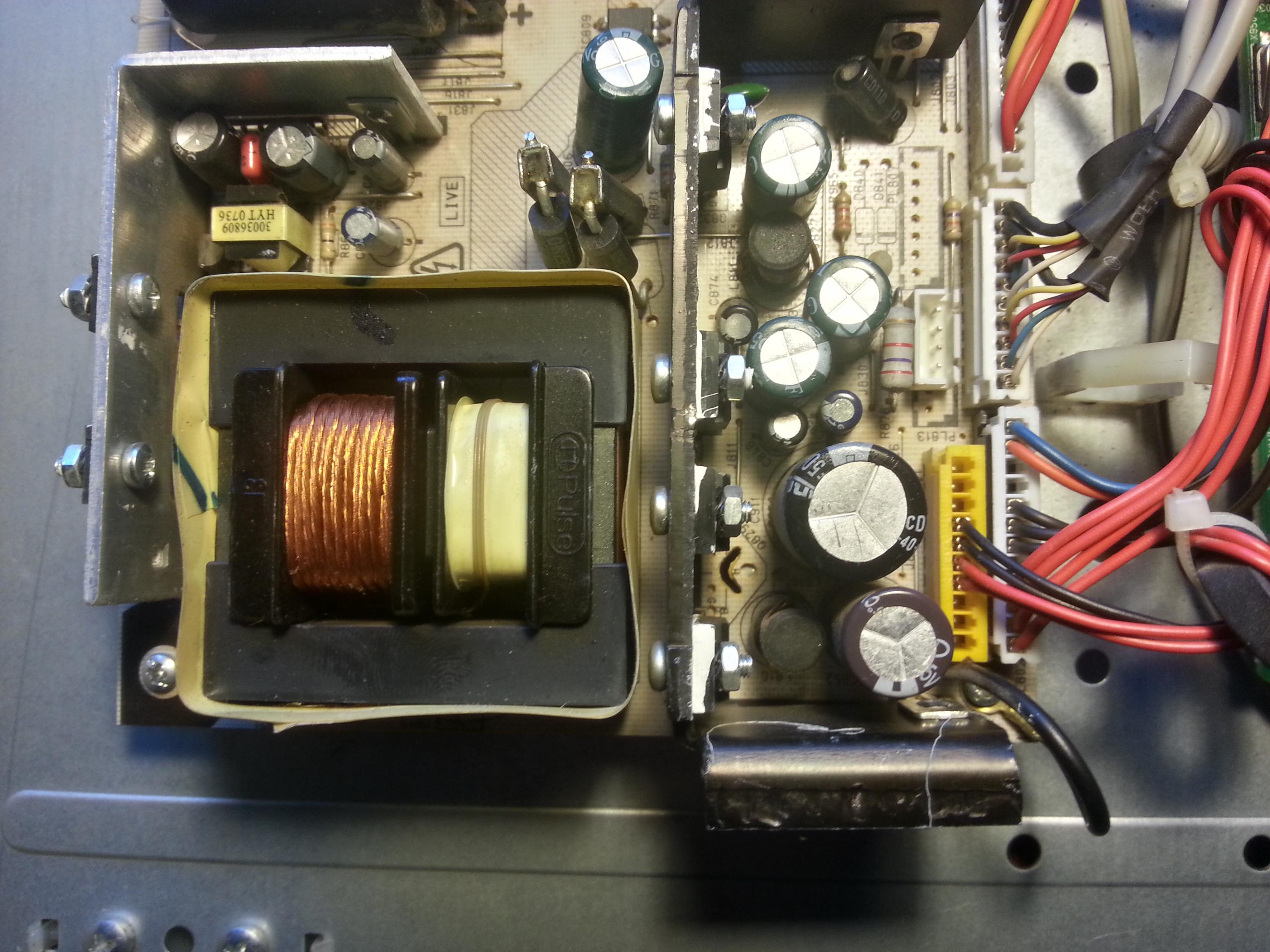

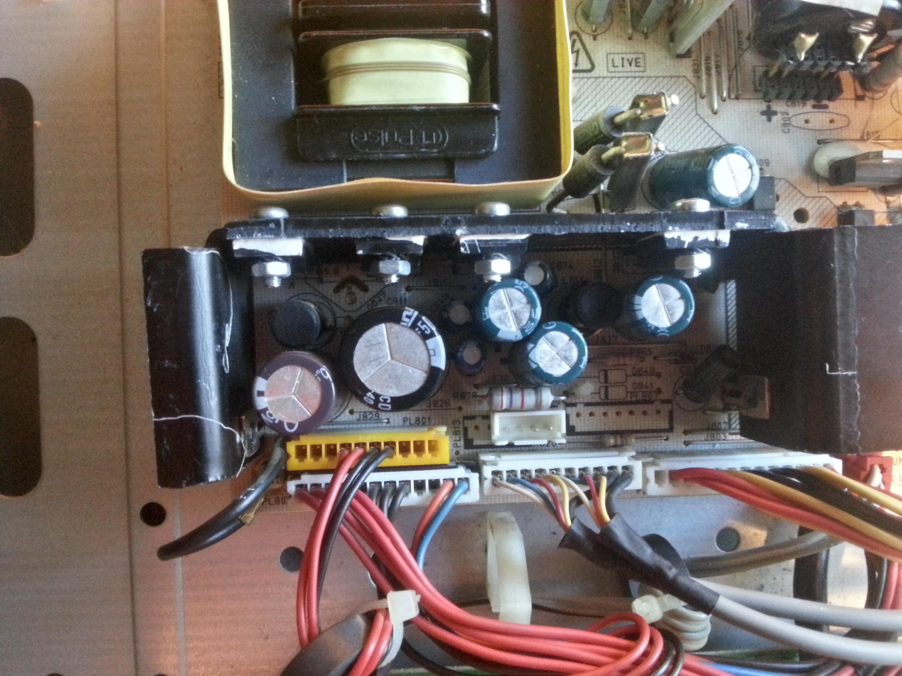

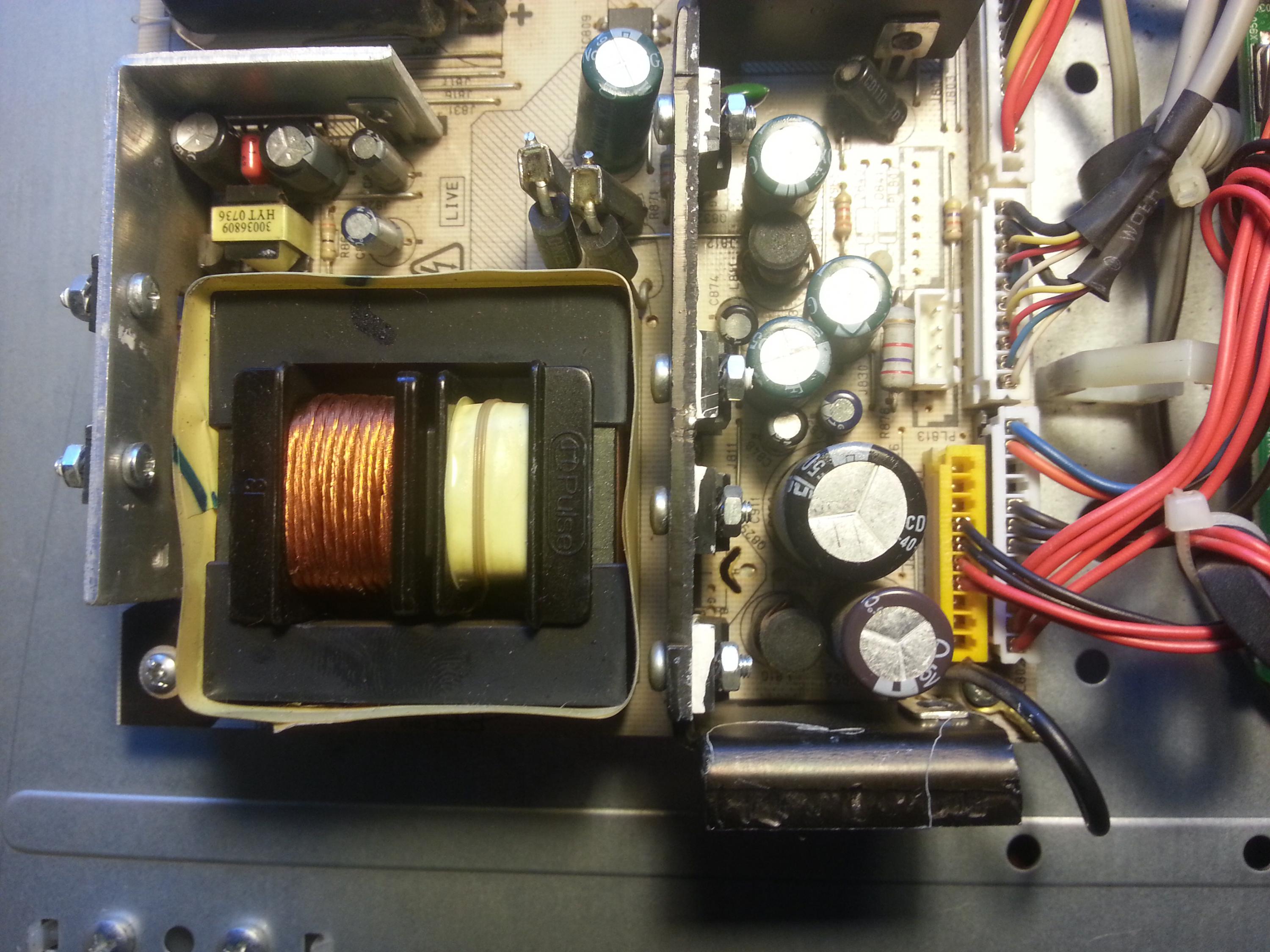

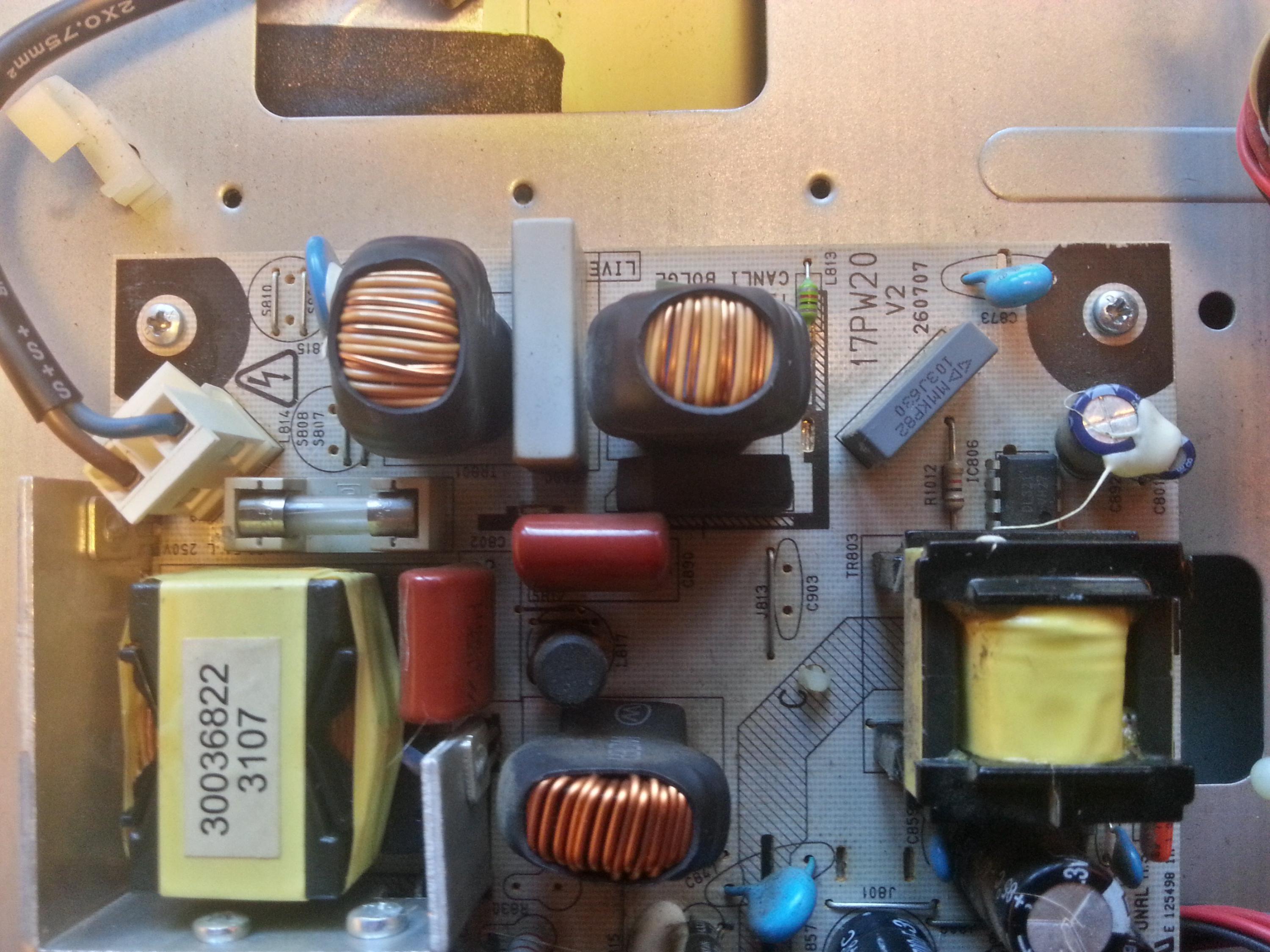

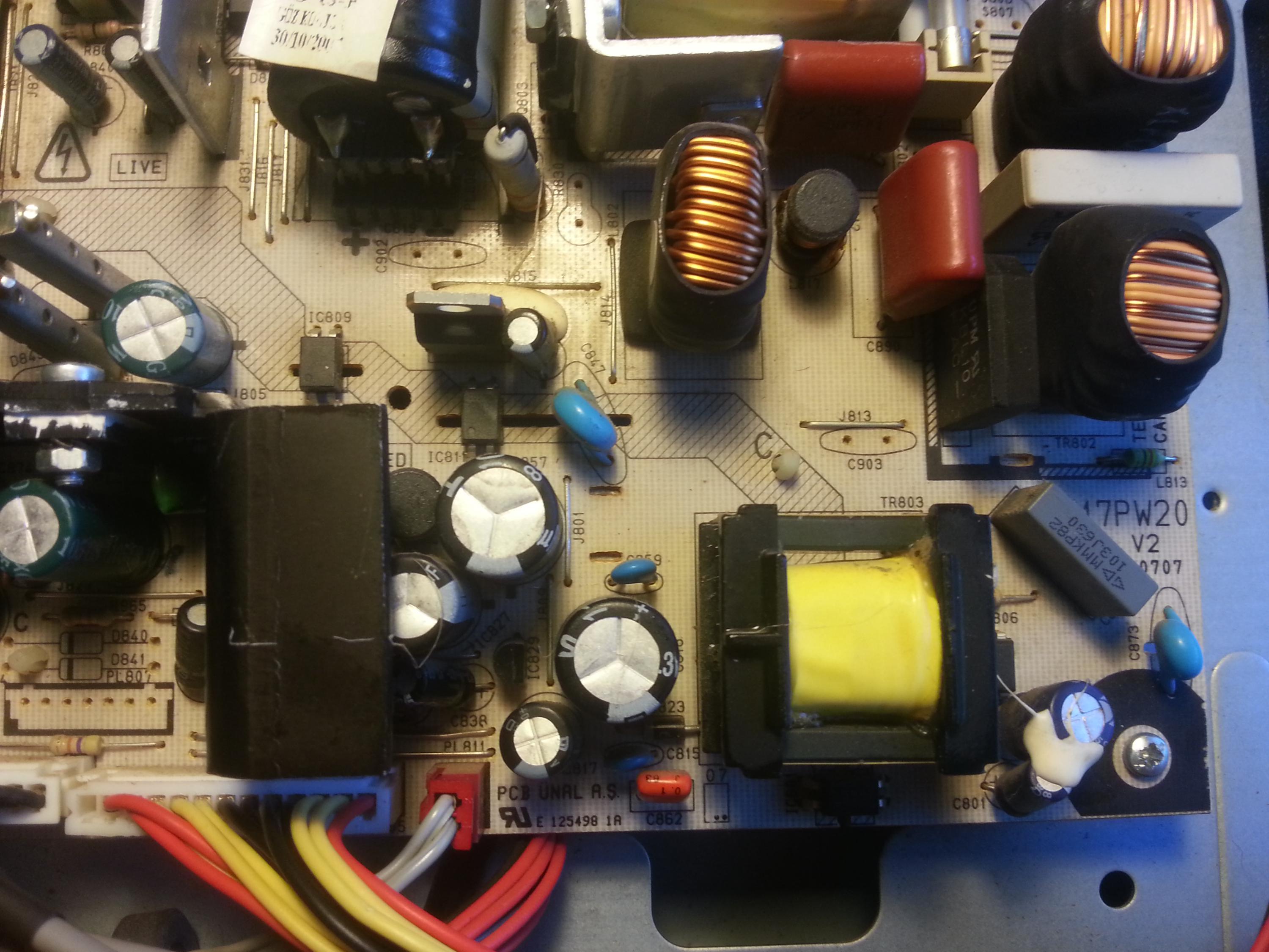

                                        #39

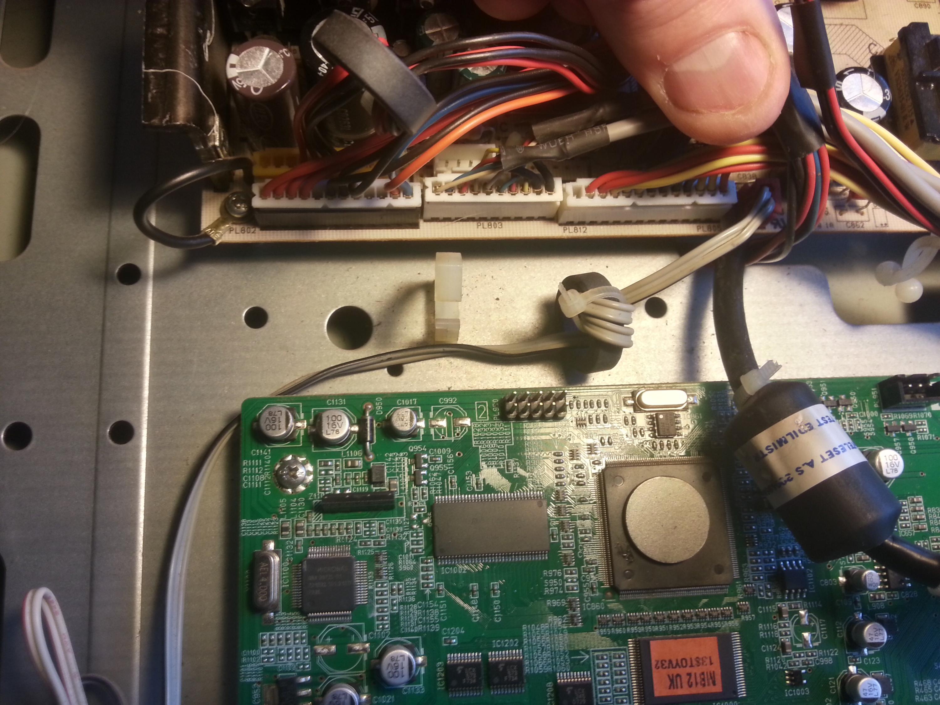

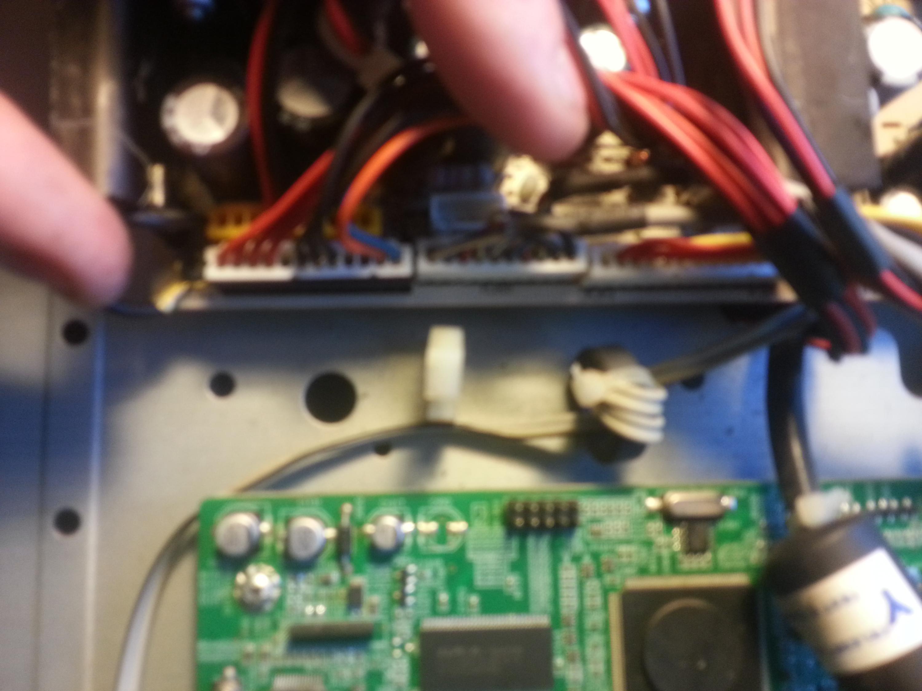

                                        more
                                        • joehezzer
                                          • Jul 2012
                                          • 251
                                          • England
                                          #40
                                          yes main board is connected
