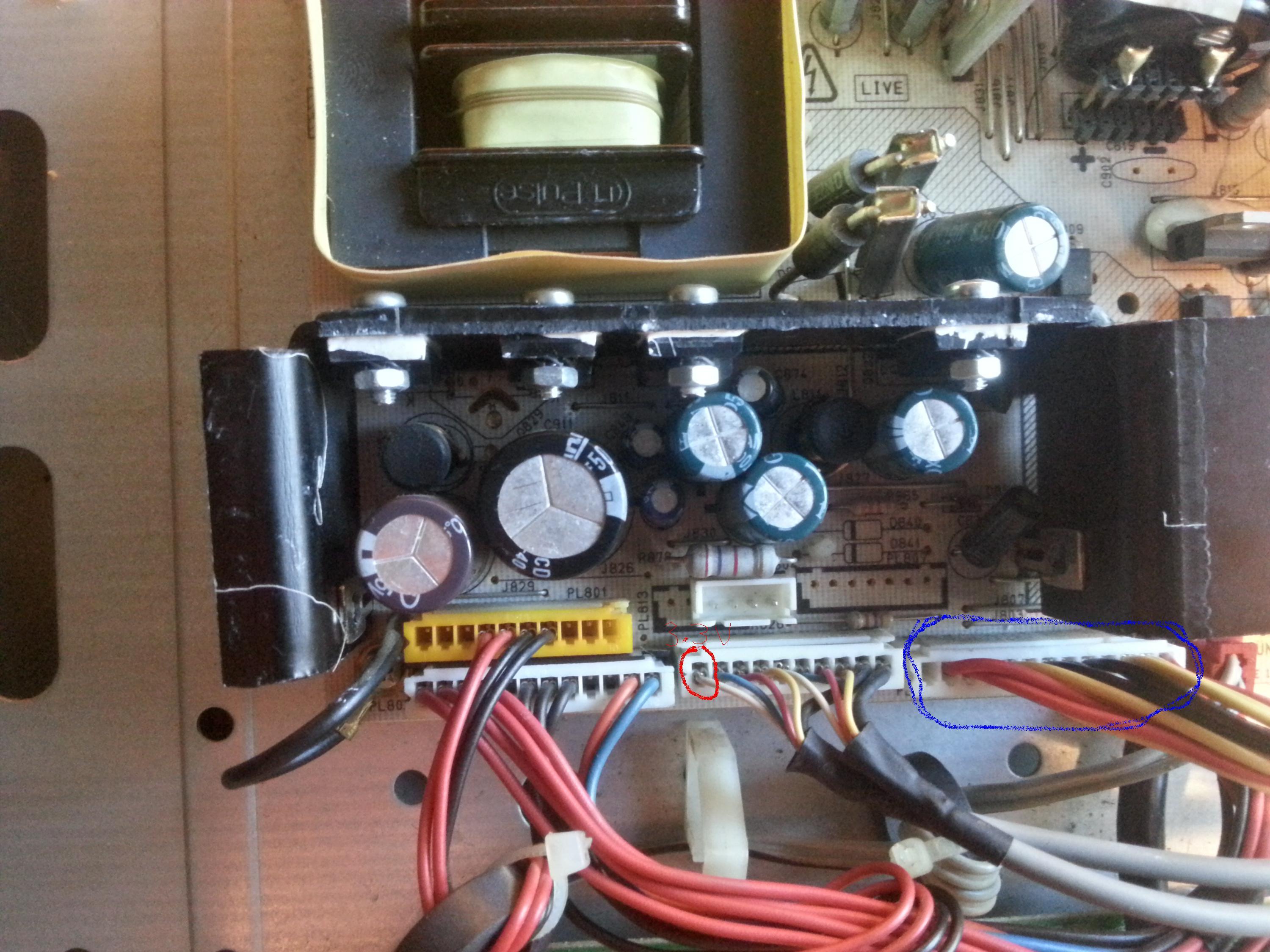

    pin 12 +5v
    pin 10,11 +3.3v
    pin 1,2,3 +5v
    are you seeing any voltage on those?
    pin 12 +5v yes 5.2v
    pin 10,11 +3.3v yes 3.3v
    pin 1,2,3 +5v nothing this is on pl805 the one marked in blue

      check all your +v pins to cold ground,you want to be seeing hundreds of kohm,a few ohms will indicate a short on that rail.
      ive had those 2 diodes just to the right on that big yellow transformer(the ones with the metal support upstands) fail a couple of times,maybee worth a check,just pull one leg and diode test them
          will diodes now and report back

              ok just checked diodes on ohm the readings danced around the on the one just said 1
                #87
                Re: Logik LOG32lw782
                did you pull one leg of each diode and test and read both ways??part number of the diodes?

                    did you pull one leg of each diode and test?part number of the diodes?
                    yes disconnected from circuit board. diode stps sl60 chn729. changes leads around and got 1.97ohms
                      #90
                      use the diode test on yr dmm,forward voltage should be around 0.19v thats at 5.26ma test voltage
                      and they are shottky diodes,so you will have a little reverse when testing

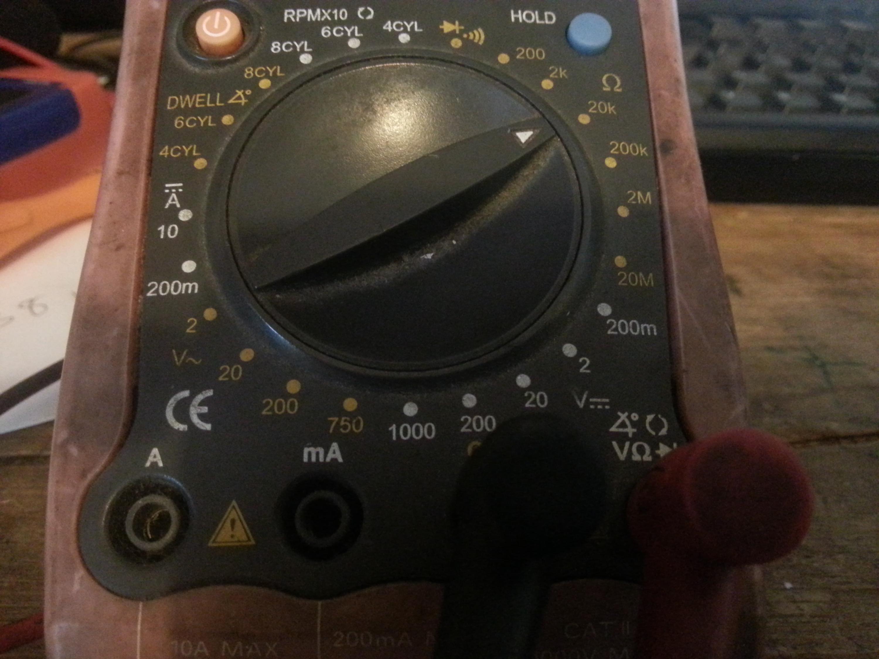

                          can you post a picture of your multimeter so we can make sure you have it on the right settings etc.
                            #93
                            yep
                              #94
                              diode is the one before 200 ohms try testing them on that setting
                                #95
                                yep tried that got nothing just stays on 1 rather than 00.0 when both probes are connected
                                  #96
                                  if your getting that when reversing probes,your diodes are open,00.0 on ohm setting will indicate a dead short
                                  fixed so far...376 lg lcd tv's,24 onn tv;s,24 panasonic lcd,16 jvc lcd,12 marshall jcm800 amps,refurb of various disco equipment lighting,old style disco decks ,and a flymo!
                                  please let us know if everything works ok if your tv gets fixed, as it will be and aid for anyone else having the same problem and wishing to fix it.it would save people clogging up this site with topics that are duplicated,and can be found easily using the search function.,and taking up valuable space.enjoy your fixed tv!,hopefully!
                                    #97
                                    ok reversed it and got 160 on diode setting.
                                    when i try on ohms i get 1 reverse it and get 1.98ohms
                                      ok reversed it and got 160 ohms
                                      right,so dmm set to diode test one way your getting a reading reverse your not?
                                        #99
                                        getting a reading on reverse and nothing when i put red lead on the cathode end
                                          sorry my fault again been reading diode wrong lol dmm set on diode i get 164, reverse it i get 1. sorry guys my mistake
