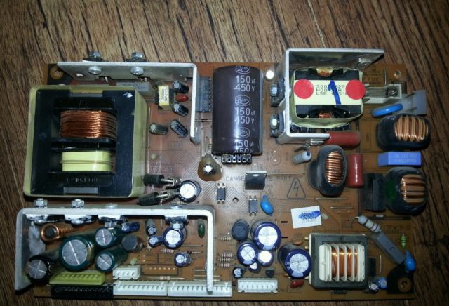

that indicates "open circuit" which means no short on that rail.
do this same test on all the rails(pins) except ground pins,with nothing connected ,take the psu out and away.
you want to be seeing "1"on your meter or a high kohm reading,i suggest you do this twice,,once set to 200, the next set to k hohm on your meter,just so you get my drift of what i mean.fixed so far...376 lg lcd tv's,24 onn tv;s,24 panasonic lcd,16 jvc lcd,12 marshall jcm800 amps,refurb of various disco equipment lighting,old style disco decks ,and a flymo!
all red wires are showing 1Comment

esr test all the caps around those connectors,and there are 2 also by the black heatsink,just to the right,known these to fail.fixed so far...376 lg lcd tv's,24 onn tv;s,24 panasonic lcd,16 jvc lcd,12 marshall jcm800 amps,refurb of various disco equipment lighting,old style disco decks ,and a flymo!

try it,you never know.
also,try heating the output caps,and the 2 i showed you earlier with a hairdrier,this will reduce ESR and get them working on a temp basis,if they are faulty,and not too far gone.fixed so far...376 lg lcd tv's,24 onn tv;s,24 panasonic lcd,16 jvc lcd,12 marshall jcm800 amps,refurb of various disco equipment lighting,old style disco decks ,and a flymo!

SD cd263b 16v 1000uf caps. that psu will not fit missing a connection block
http://www.ebay.co.uk/itm/1000uf-16v...item43c106e37e
these i thinkLast edited by joehezzer; 01-19-2014, 08:27 AM.Comment

thats good fr series caps,but have you replaced all of the output caps?SD cd263b 16v 1000uf caps. that psu will not fit missing a connection block
these i thinkfixed so far...376 lg lcd tv's,24 onn tv;s,24 panasonic lcd,16 jvc lcd,12 marshall jcm800 amps,refurb of various disco equipment lighting,old style disco decks ,and a flymo!
