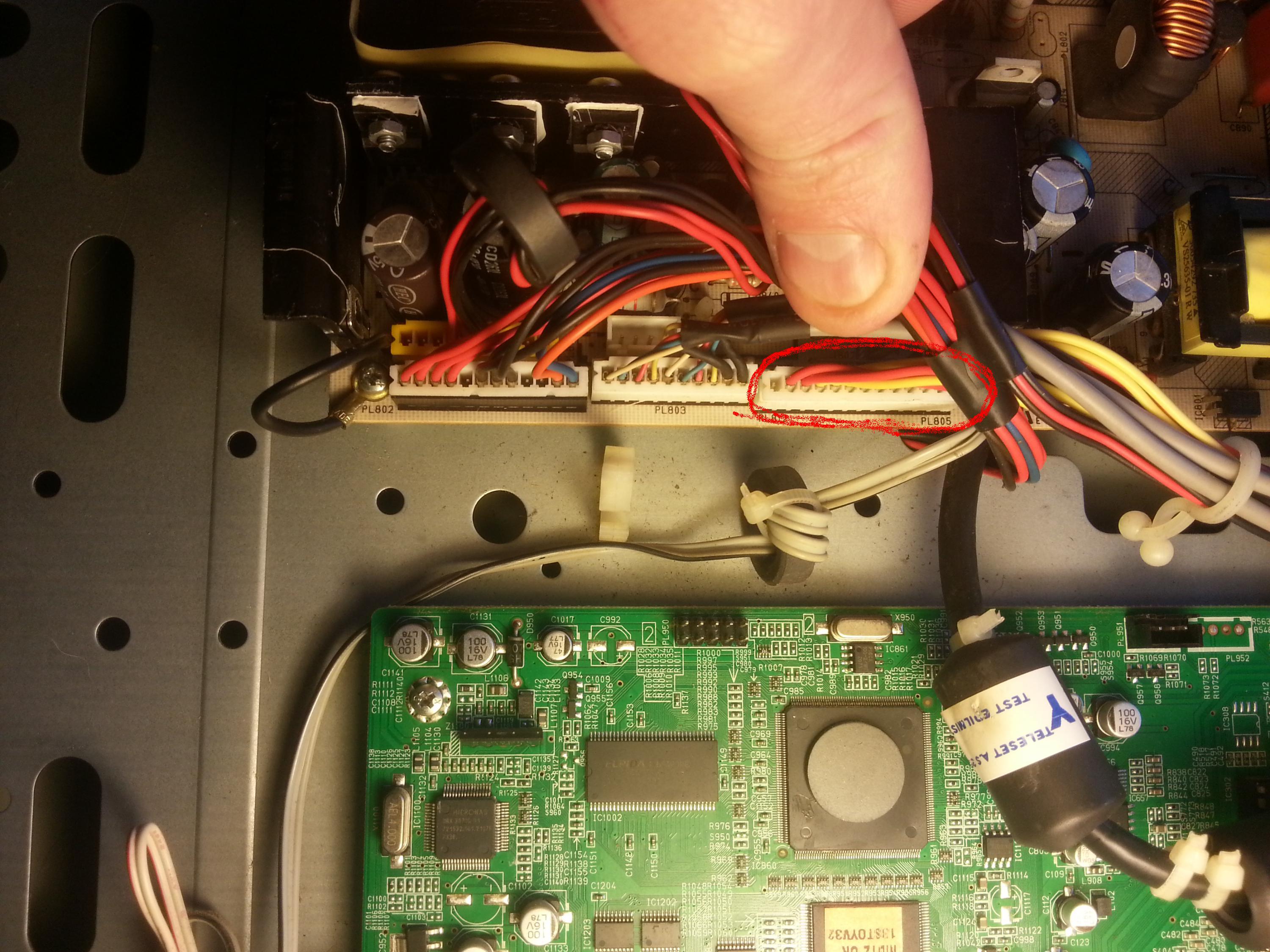

            #105
            Re: Logik LOG32lw782
            pl801 both red wires read about 0.60/0.70 ohms the two black ones 00.0 on yellow block with set turned off.
            pl802 all red wires read wire 1.03 and rising all black ones on this block 0.00, slightly orange wire 1.24, blue wire 3.41.

              #106
              pl805 first two red wires 1.73, 3 yellow wires 0.73, 4 black wires 0.00, two yellow wires 0.30, last red wire 0.56. is that right

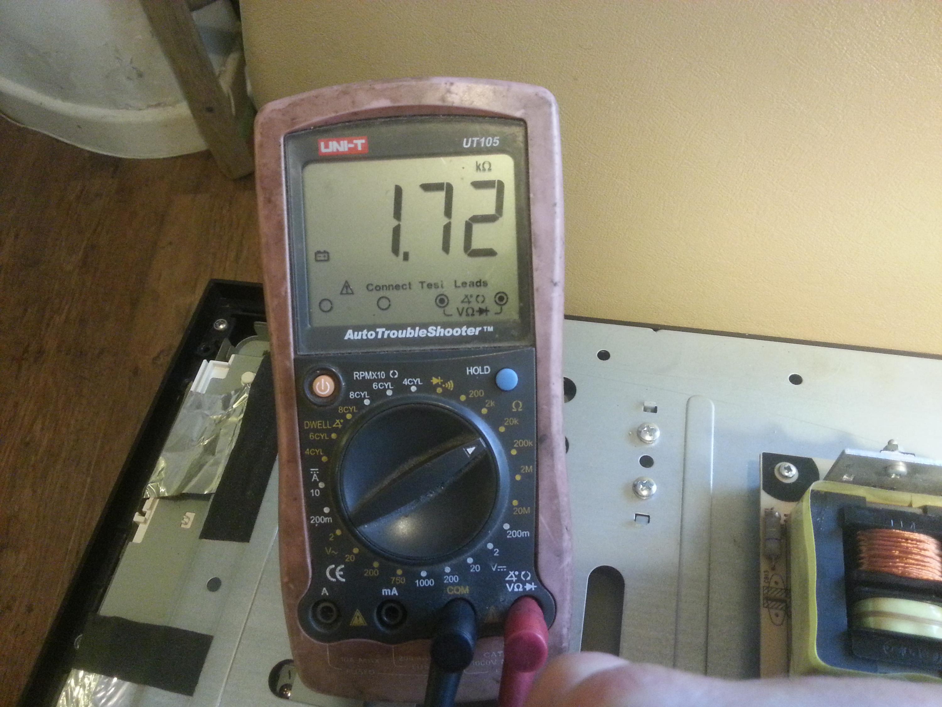

                • joehezzer
                  • Jul 2012
                  • 251
                  • England
                  #108
                  Originally posted by multimeter
                  your getting 1.73 reading on the red wires?,is that ohm reading?,with psu out of tv and on your bench,nothing connected to it?
                  yes 1.73 on pl805 block the first two red wires 1.73 ohms. psu is connected all wires except mains plug

                    #109
                    disconnect that connector with the red wires,and test that again,as it stands that is showing a short

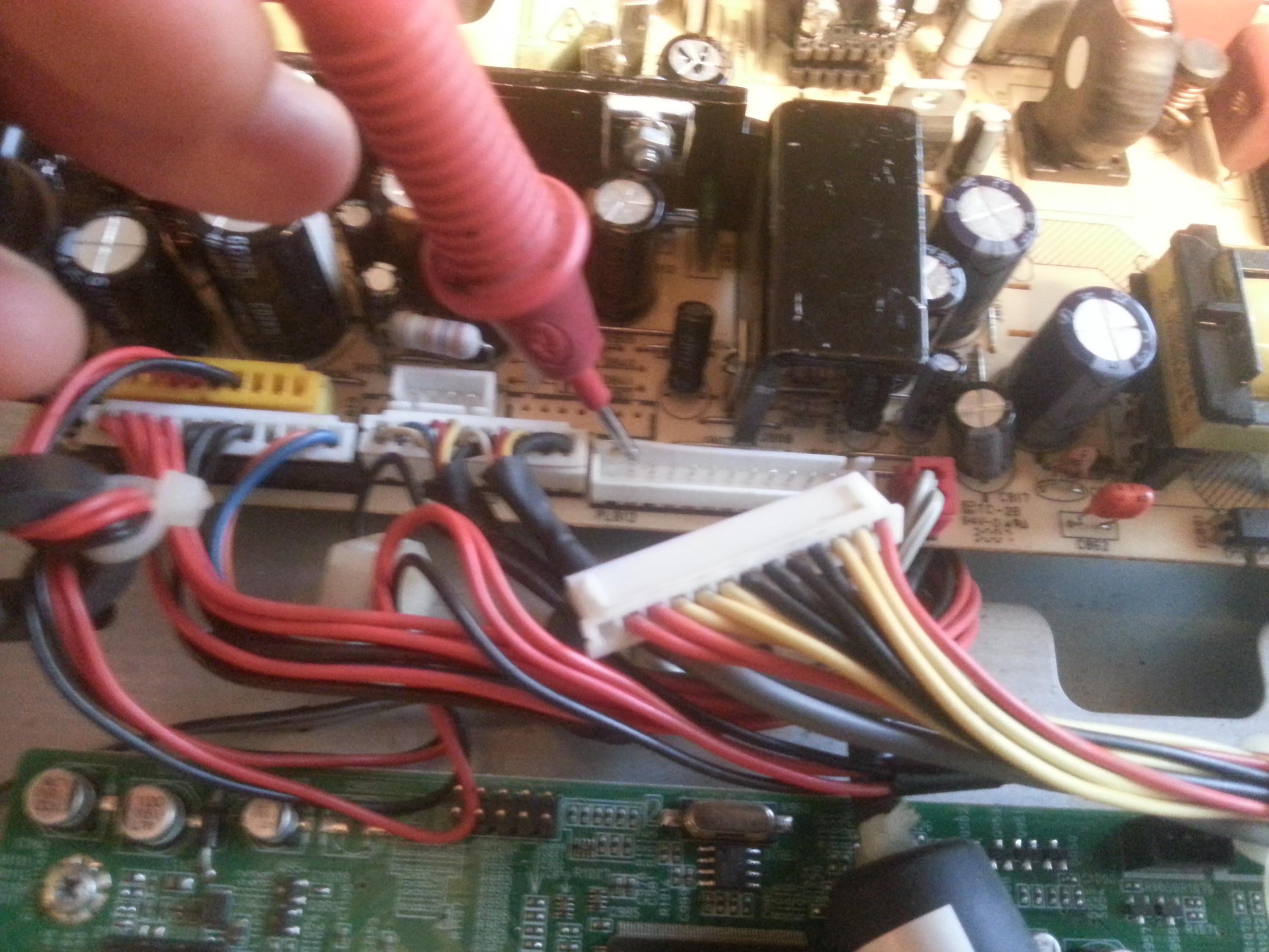

                      #110
                      ok disconnected block in pic and tested pin on psu was still getting 1.73ohm

                        #111
                        so are you testing with the connector disconnected and touching the red probe meter pin on to the psu pin direct and still getting that reading i have a 17pw15-9 psu sat in front of me as we spaek same connections on mine as yours and i get no reading on those pins at all.

                                  #116
                                  is that meter supposed to be just on 200 and not 20k
                                  yes 200.
                                  you have a short on that rail,you need to trace back ,and test those components,that is quire nearly a dead short there,there could be a diode along the way,mosfet ,you need to check them

                                    #117
                                    yes 200.
                                    ok just wondered ok changing dmm to 200ohm not 20k, i am getting 1 is that a better reading

                                        #119
                                        shorting your probes together gives you what? a "1" or "0.00" ?

                                          #120
                                          shorting your probes together gives you what? A "1" or "0.00" ?
                                          0.03 connecting probes together, connecting to board i get a 1
