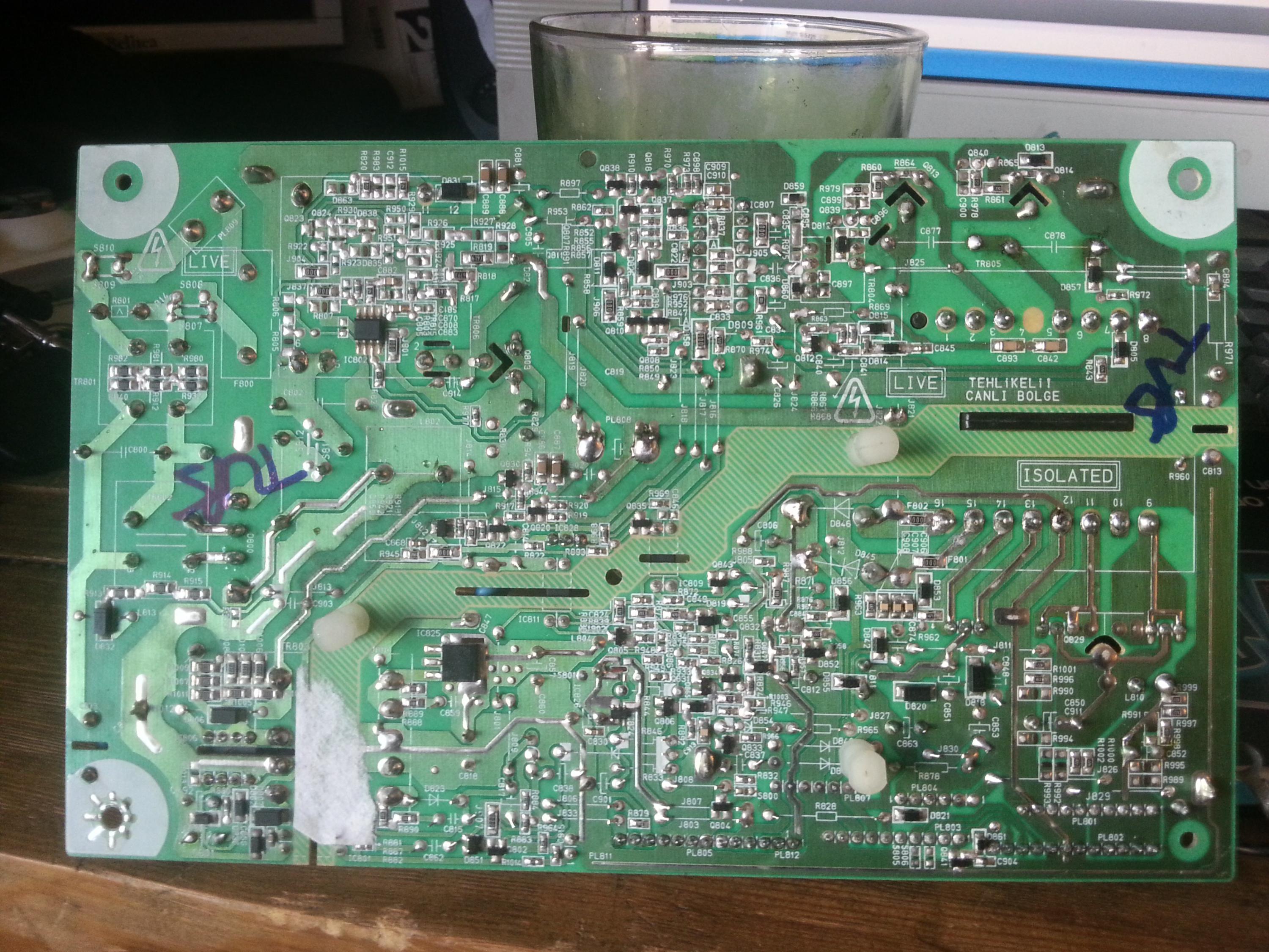

    Pictures are great - should have done the backs as well.

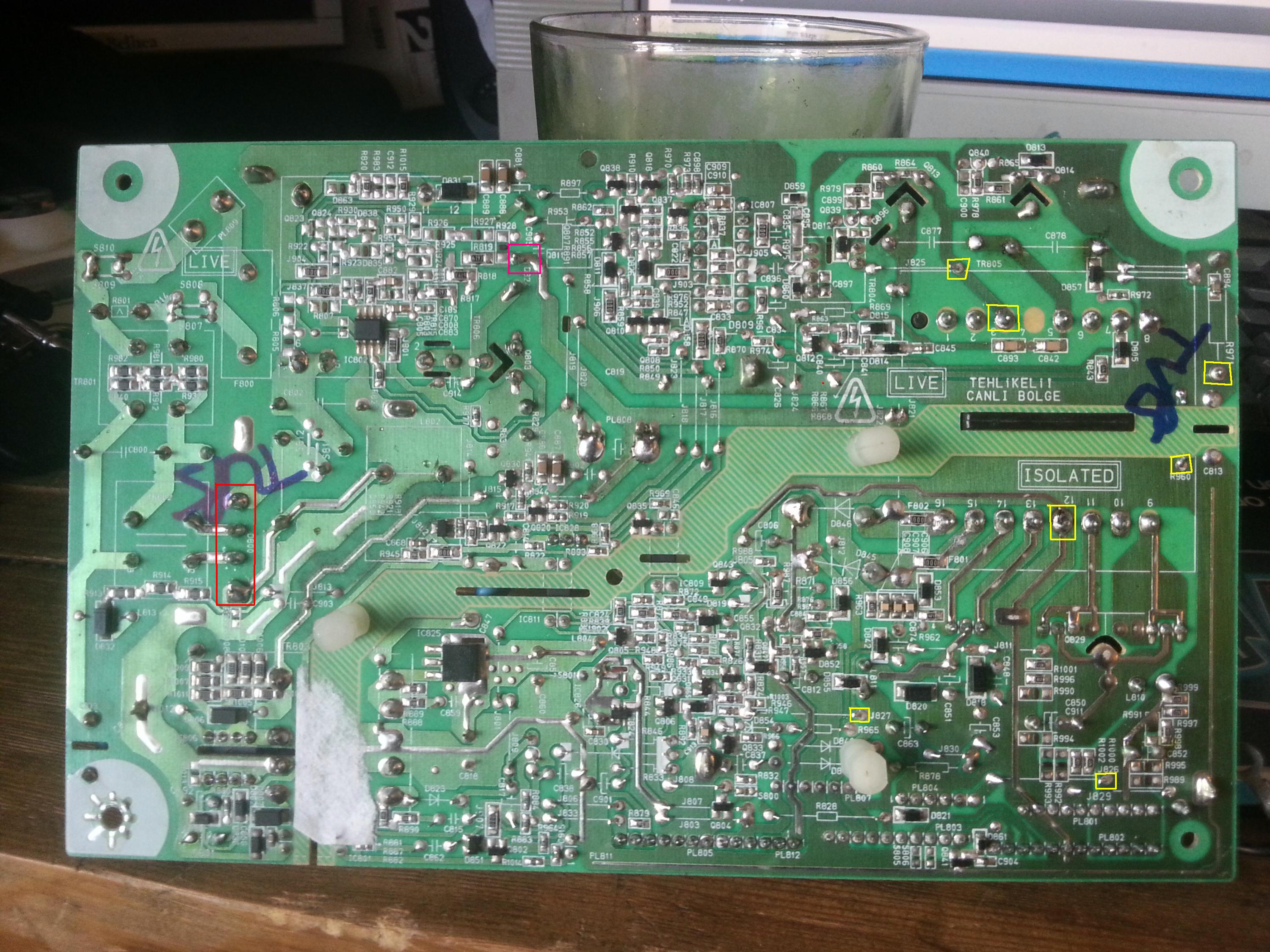

                    • selldoor
                      Slow Learner
                      • Dec 2010
                      • 7870
                      #50
                      Re: Logik LOG32lw782
                      No I attach a pic showing what I think is the bridge from the underside on top it should be a dark grey thin rectangle has a slope at one end of the top.
                      Also on the pic I have marked in pink something I would like you to look at
                      it just looks odd!! In yellow I have marked some joints to look at - they may well be ok but again they look a bit odd on the picture.

                        #51
                        ok cheers, just found rectifier for some strange reason i just did not see there lol

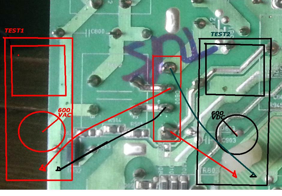

                          • selldoor
                            Slow Learner
                            • Dec 2010
                            • 7870
                            #53
                            Sorry - should have explained the test better. You need the meter on vAC600 and test the two inner pins one probe on each pin - they should be same as mains 230VAC.
                            Then put the meter on vDC600 and put a probe on each of the outer pins - should be 325 vDC

                                #55
                                ok first pin 003 VDC second 128 VAC third 140 VAC fourth 234 VDC think thats right

                                  #56
                                  We seem to have a communication problem - I will do a picture and attach here in 5 mins or so
                                    ok cool inners reading about 250 outters about 345/50
                                    • joehezzer
