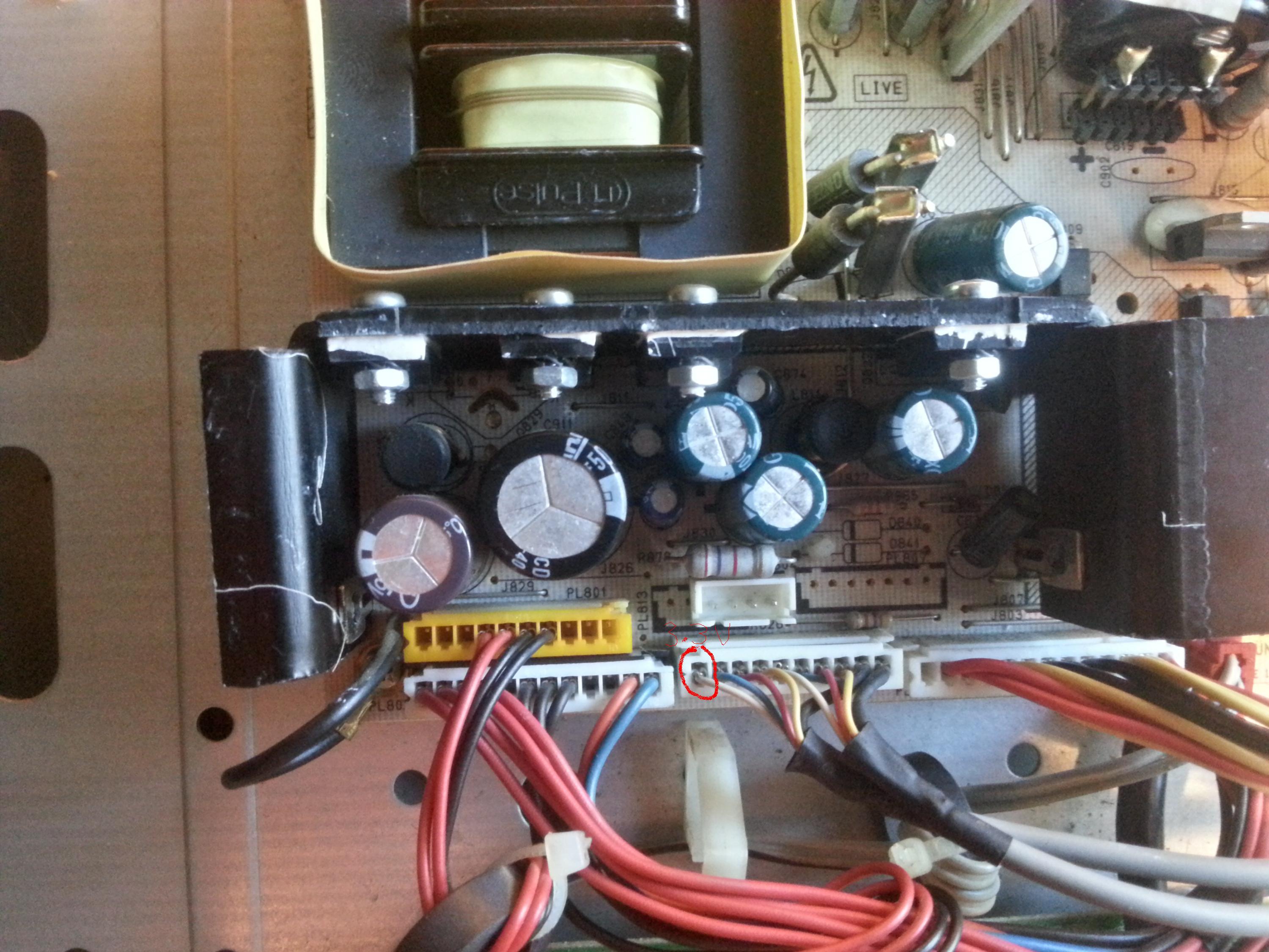

                                  #76
                                  Re: Logik LOG32lw782
                                  pl803 pin the white one in the pics i have 3.3v marked in red

                                    #77
                                    is there a 5v stb pin?,that will have to be there ,this will supply voltage and give you power to the front led standby light,even if nothing else is working,if it isnt ,we need to find out why...,your 3.3v will maybee be for inverter on signal.
                                    fixed so far...376 lg lcd tv's,24 onn tv;s,24 panasonic lcd,16 jvc lcd,12 marshall jcm800 amps,refurb of various disco equipment lighting,old style disco decks ,and a flymo!
                                    please let us know if everything works ok if your tv gets fixed, as it will be and aid for anyone else having the same problem and wishing to fix it.it would save people clogging up this site with topics that are duplicated,and can be found easily using the search function.,and taking up valuable space.enjoy your fixed tv!,hopefully!
                                    • joehezzer
                                      • Jul 2012
                                      • 251
                                      • England
                                      #78
                                      just looking at schematic of psu think its the right one, pin 6 on pl803 standby

                                          #80
                                          pin 12 +5v
                                          pin 10,11 +3.3v
                                          pin 1,2,3 +5v
                                          are you seeing any voltage on those?
