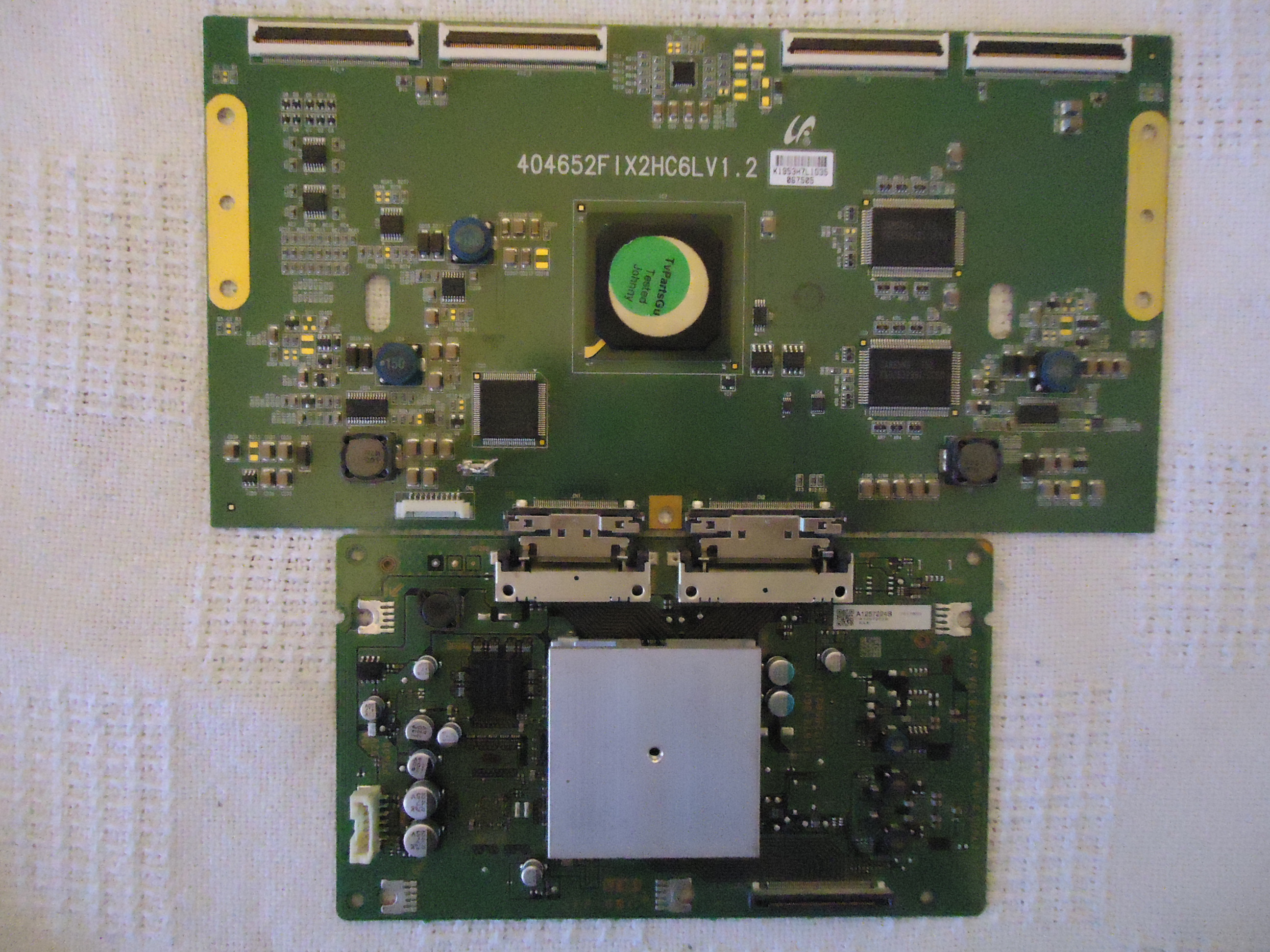

    Hi There All!
    I am currently waiting for my Main board to arrive to see if it can solve the issue I have been having with my Sony Bravia KDL-46XBR4. I am preparing for the worst and want to find out my options in the even that this component does not fix my issue. The issue I am having is the TV sometimes turns on and when it does there are no issues at all. Other times (and most of the time) I will push the power button and the Sony light and the green light will turn on and there is no sound, screen, or backlight. After waiting for about 5 to 10 seconds the Sony light turns off and the green light turns into a red light that flashed 5 times (T-Con error). The reason I chose to replace the AU main board was because I could see visual areas of corrosion from some type of liquid damage. This only appeared on the main board though. I very thoroughly inspected all other components on in the tv and the only area that appeared to be damaged was the main-board. I replaced the capacitors in the area of corrosion and there was no change. In fact, the thing no longer turns on but hasnt really turned on the last couple days before I swapped the capacitors.
    Now my question turns to the t-con, which is what the most obvious answer is for this televison. My TV has the following product numbers:
    T-Con Board- 404652HHC8LV1.8 / LJ94-01954F

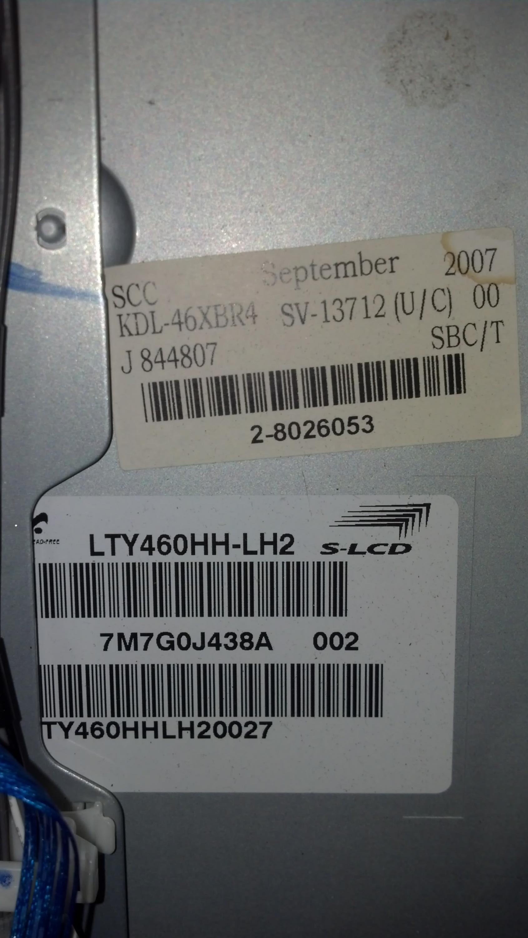

    Panel Number- LTY460HH-LH2
    Serial # 2-8026053
    I know that Sony did not sell these t-cons separate from the panel, which makes it very difficult to find a reasonably priced one. I have come across them very occasionally but have been wanting to wait until i try the new main board which I got for really cheap from Shop Jimmy. What I need to know is if I could use the following:
    - 404652FIX2HC6LV1.2 / LJ94-01953H T-Con Board (See Link http://www.shopjimmy.com/samsung-lj9...-con-board.htm )
    I noticed on their website that both of these items list the same panel number and model number. I have also read in an old forum that these two products are interchangable electronically, but not mechanically (the heat sinks are different), but have received different answers from two different Shop jimmy employees(Click here for link to forum). One said yes and one said there is no substitute. My two questions are:
    -can I use this other part since there are tons of them for sale?
    -If not, does anyone have access to one that is reasonably priced?
    I may not need it if the main board fixes the issue, but I want to be thoroughly prepared since it kind of sux not having our living room tv operating :-)
    Thanks for all you help and knowledge I truly appreciate it!
    Tony

          Did you check the fuse on the T-CON ?

            I have a t-con for a kdl-46xbr5 same set different color. If you run into trouble finding one let me know and you can have it for postage and it is a good one.

                    Is this the t-con you need.
                    • splitcrete
                      • Dec 2012
                      • 387
                      • usa
                      Re: Sony Bravia KDL-46XBR4 T-Con Compatability
                      It needs a new fuse I tested it with a jumper of solder. TV Parts guy sent it to me with the bad fuse.

                        I noticed the fuse in your t-con didn't look blown is this a common thing? Also how can I test my fuse in my t-con?
                        The pic looks different from mine, but yours is the one I was thinking could be used as a replacement :-) If someone can tell me how to test my fuse then I can let you know :-)

                                    You need a t-con that is compatible with your panel number.
                                    • bigtony5858
                                      • Jan 2014
                                      • 31
                                      My Panel Number is LTY460HH-LH2. So if I find that the t-con LJ94-01953H is compatable with this panel number, but is not the same as the one that is currently in my unit it should work? I am not sure if the reason others are telling me that there are no substitutes for my t-con board are doing so because Sony was selling this as part of the panel and not seperately.

                                        This is a picture of the labels on my panel if this can help anyone
