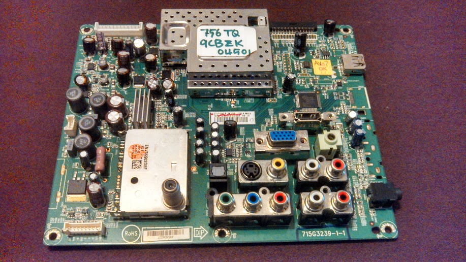

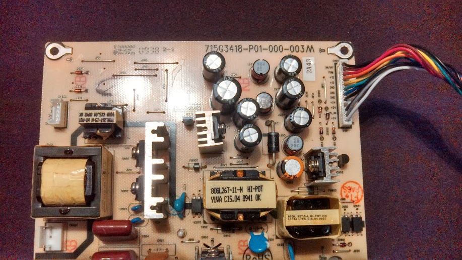

    My Insignia NS-L26Q-10A TV will not turn on. The front LED never turns on.
    ----Things Tested----
    1) The power supply (715G3418-P01-000-003M) produces 5VDC, but there is never 12VDC or 24VDC produced.
    2) I tried to replace the mother board (715G3239-M02-000-005F) with a similar mother board (715G3239-1-1). The connection to the LCD is different, so I didn't connect the LCD, but everything else is the same. When I pressed the power button with this mother board in nothing happened.
    3) Nothing on the boards looks damaged.
    4) I checked to make sure the power button (on/off switch) is switching properly. I performed a connectivity check and was able to see the connections being made and disconnected when the power button was pressed.
    5) The voltage going to the power button is .5VDC.
    ----Question----
    Is the mother board bad? Why won't the 715G3239-1-1 mother board work? Is there anything on the mother board I should be checking?

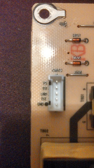

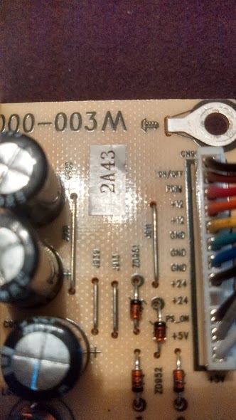

    Re: Insignia NS-L26Q-10A no power
    can you post good pictures of the two top connectors on the psu so we can see what the printing is by the connectors may be we can use a resistor to test the psu outputs.
    • BurghMan
      • Jan 2014
      • 15

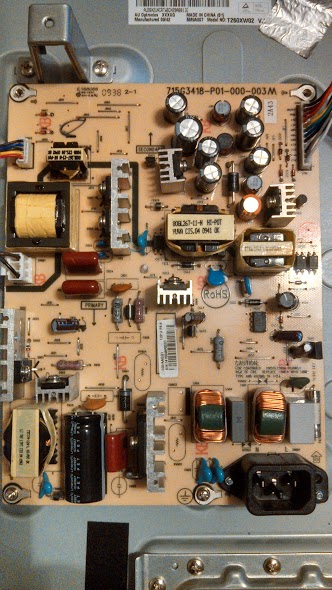

      The 2 connectors on the power supply are pictured below. The connections are labeled as follows….
      Connector to the Mother Board (top to bottom):
      On/Off
      PDIM
      +12
      +12
      GND
      GND
      +24
      +24
      PS_ON
      +5V
      +5V
      Connector to 715G3631-P02-000-003S - I'm not sure what this board is:
      VS
      IS1
      GNS
      IS2

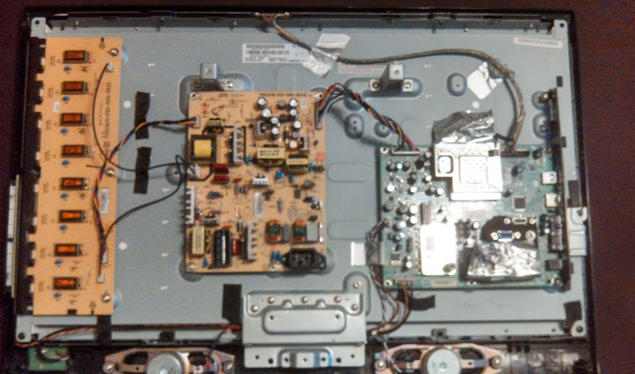

        have you got your original man board in the set so we can start trouble shooting from the start?
        • BurghMan
          • Jan 2014
          • 15
          Yes all original boards are in.

              Report the DC voltage readings on all those pins when TV is OFF, and when power switch is activated. Black probe of the meter on the chasssis.
              • BurghMan
                • Jan 2014
                • 15
                I have a 1kohm resistor and I did not find any other fuses besides the main fuse on the Power Supply board, which has been checked and is not blown.
                I tested the voltages of each pin with the black probe on the chassis. Here are the readings I got, they were the exact same when the power button was pressed in:
                On/Off = OVDC
                PDIM = -0.1VDC
                +12 = 0.002VDC
                +12 = 0.002VDC
                GND = 0VDC
                GND = 0VDC
                +24 = 0VDC
                +24 = 0VDC
                PS_ON = 0.412VDC
                +5V = 5.017VDC
                +5V = 5.017VDC

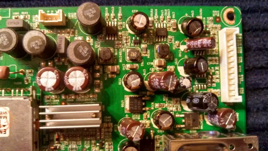

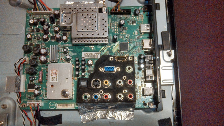

                  We could do with a bigger picture of the boards and also the back.
                  but if it is all connected wait and see if budm comes back on later.
                  I did see some grey looking resistors - these could be fusible resistors and act as fuses
                  so please check them for continuity as you would a fuse.
                    I will work on getting bigger pictures for you of both boards.

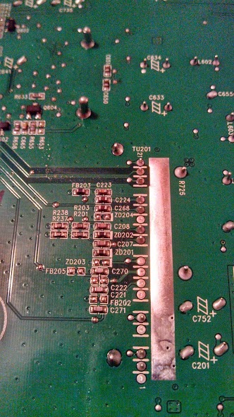

                    I didn't realize the fuses could be as small as the resistors. I started checking everything labeled FBXXX and came across three instances shown on the picture. It looks as if FB205 and FB202 don't have fuses soldered in. When I check for a connection, the meter reads OL (open loop). Should this be a concern or where these fuses intentionally left off?

                      "fb" designations will be ferrite beads,should show very low ohm reading or even dead short when tested

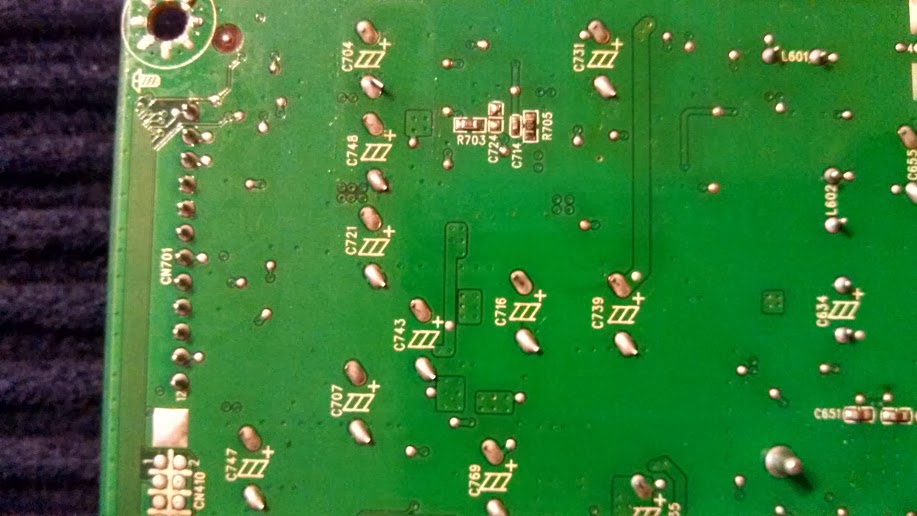

                        The main board is the problem, it is not sending out PS_ON signal.

                            there still could be stuff that can be fixed on your mainboard,dont give up yet!
                            caps,voltage regulators...etc
                            look for your ps_on rail,trace it back,what components are along the line?
                            what resistance reading do you get if you red probe to ps_on to black probe chassis ground?

                                  im thinking problem lies in the main board(motherboard) from what ive read and concluded
                                  check semi's,and passives backwards along ps_on rail for shorts.
                                  but see if you have a short 1st by checking that rail to cold ground(chassis)
                                    I checked PS_ON to ground and got 2.12kohms. Does this seem right?
                                    I've been trying to trace out this circuit but its very difficult. There are very little visible traces on this board (see pictures), so I've been using my conductivity meter to see what is connected to what, but I don't know what is supposed to be connected to each other.
                                    So far I can see resistors, capacitors, and ferrite beads. It also looks like there are so inductors, diodes, and integrated chips, but I haven't traced the circuit to those elements yet.
                                      There are 2 voltage regulators in your pic u708 is one - perhaps test those and check the voltage on the caps connected to them.
                                        Beside the main board not sending out the PS_ON signal, it is also not sending out the INV-ON-OFF signal, you have multiple problems on the main board.
