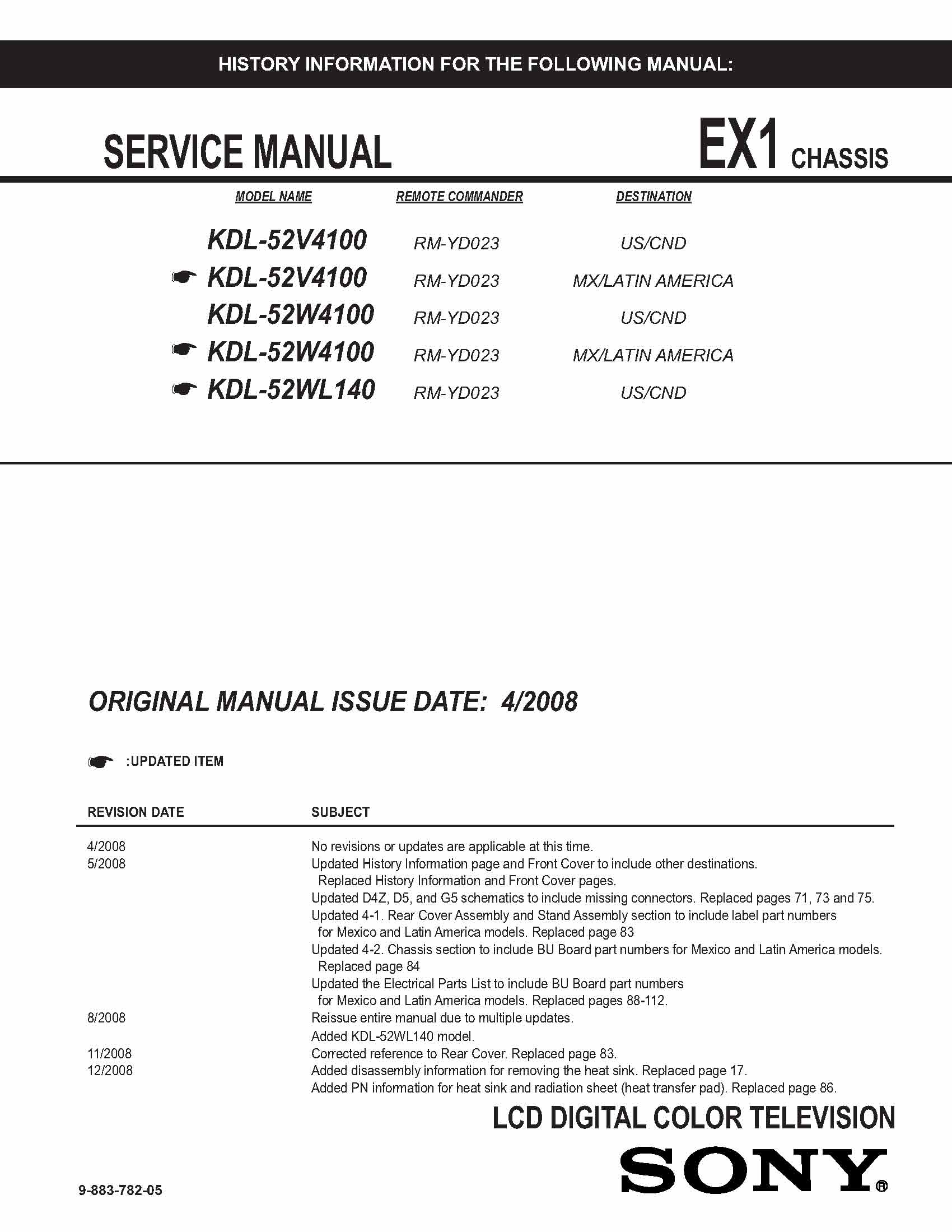

                          Re: Sony KDL-52V4100 13 blink code
                          OK, I just download the service manual for KDL-52W4100:
                          http://elektrotanya.com/sony_kdl52w4.../download.html
                          It covers KDL-52V4100 also.
