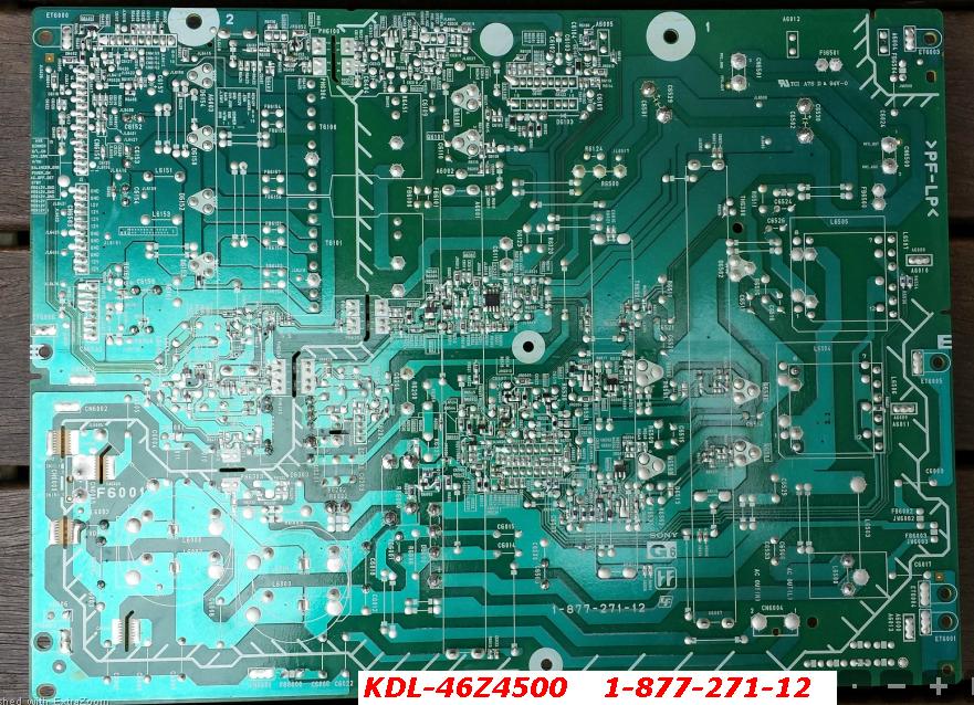

                    Which reminds me can we have a straight on picture of the Top side of your actual board.
                    Budm has said the voltage should be at the caps as soon as you switch on so if it is not then go back to the bridge.
                    First ,Meter on vAC600 test the inner pins for mains voltage
                    If that is not there then we need to find put why.
                    If it is there then meter on vDC600 test across the outer pins
                    (( I am not sure why you would be testing the output voltage using AC as the output is DC unless you were looking for high ripple? ))
                    I have posted a picture here of the bottom of your board. to help others when your links disappear not as sharp as the html but better than nothing

                      The board is now working and the TV turns on!! After being frustrated with the board and leaving it for some time I went back to it a few hours ago for a final look at it. If you read back you will see I accidentally put mains power to the PFC Out Pin instead of the 240 Input (Oops) leaving me in an even worse situation than before. Previously the board would give a very small voltage to the 450v Caps but after putting mains to the PFC out I wasn't getting anything even at the bridge rectifier. I found that a 6.8 Ohm Ceramic Resistor had blown which I replaced, which then blew again. I probed the DC Side of the bridge rectifier and was getting about 8.75 k Ohms which I though was unusual. I traced the short back to a pair of K3561 Field effect transistors which I replaced with K3563's from another faulty board, I then replaced the 6.8 Ohm Ceramic resister which this time did not blow and I was now getting 330v DC at the 450v Caps. I connected the board to the TV and it came on but it only stays on for about 30 seconds before shutting off and blinking 6 times which according the service manual indicates a backlight error. Could this be because I have used different field effect transistors? I will be working more on the TV later but wanted to hear any suggestions.
