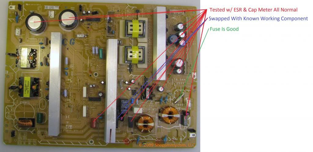

    I've got a KDL-46Z4500 with what I believe to be a faulty power supply board. Part No. 1-877-271-12 I am getting no standby codes and no standby voltage and the pin on the main output connector. However when I unplug the T-Con board connector I get a very small reading less than a volt but I don't believe the T-con is faulty I just think it's trying to draw current but It can't.
    I have some experience repairing TV's and really want to repair this board instead of just buying a new one. There are a few components I have tested or replaced from another working Sony board, which include:
    - Main 150uf 450 Caps
    - Bridge Rectifier
    - Main Relay
    - Standby Transformer
    - 0.22uf and 10K Cap right beside the mains input
    plus the other 0.22uf and 10K cap after the coil/choke things
    I have also tested with my ESR meter all the caps beside the main output connector all measuring fine. The fuse is also fine.

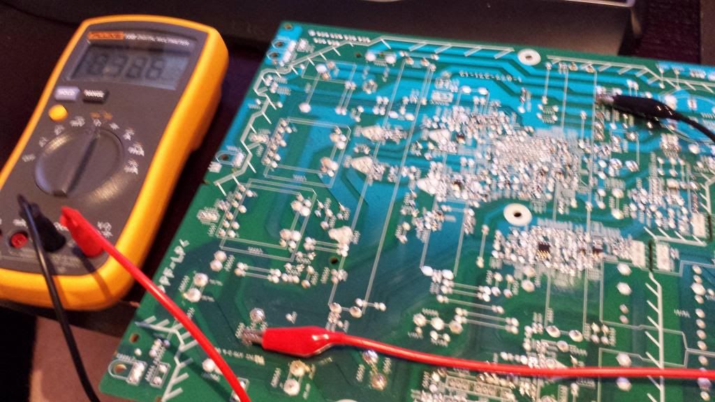

                  This is what I'm measuring, negative from the rectifier to the two main 450v caps gives zero ohms, see images:
                  http://i1208.photobucket.com/albums/...ps3429774f.jpg
                  http://i1208.photobucket.com/albums/...ps77b72e3a.jpg

                    Check for cracked solder joints, blown fuses, etc.

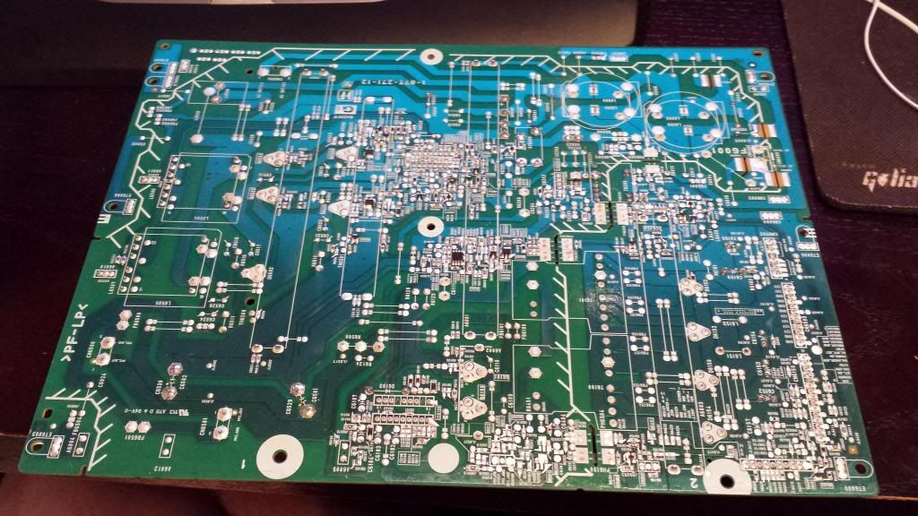

                            Board pc is too fuzzy for troubleshooting please repost just the board both sides.
                            It is useful if you can post using manage attachment then in future the thread makes sense

                              Re: Sony KDL-46Z4500 Completly Dead
                              Hi-Res Top Image Here:
                              http://assets.shopjimmy.com/media/ca.../a1552100a.jpg
                              Hi-Res Bottom Image Here:
                              http://i1208.photobucket.com/albums/...ps67d2fe37.jpg
                              Sorry what do you mean 'manage attachment'? I'm new here.

                                  This is also what I've looked at so far:
                                  http://i1208.photobucket.com/albums/...psabf24181.jpg

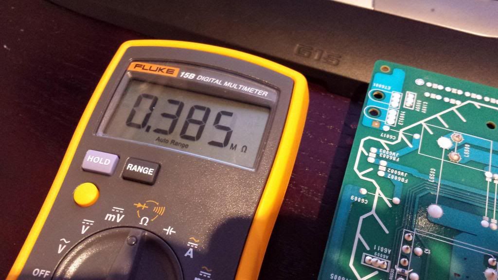

                                      What resistance do you measure across the terminals of the relay? It looks like it bypasses an NTC resistor.
                                        On the side with the leg that sits slightly back I get about 5 M Ohms, it takes some time to settle to that though. On the other side I get0 .493 k Ohms.
