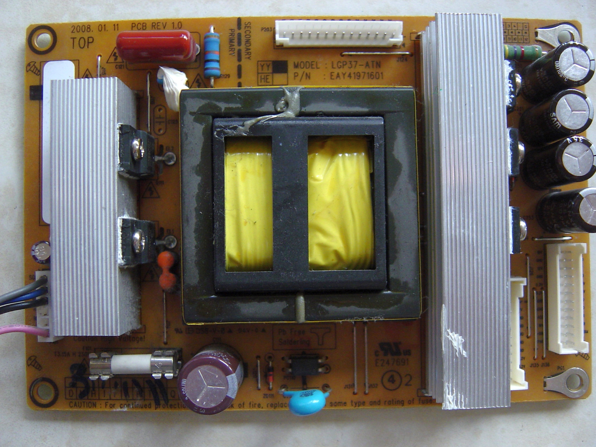

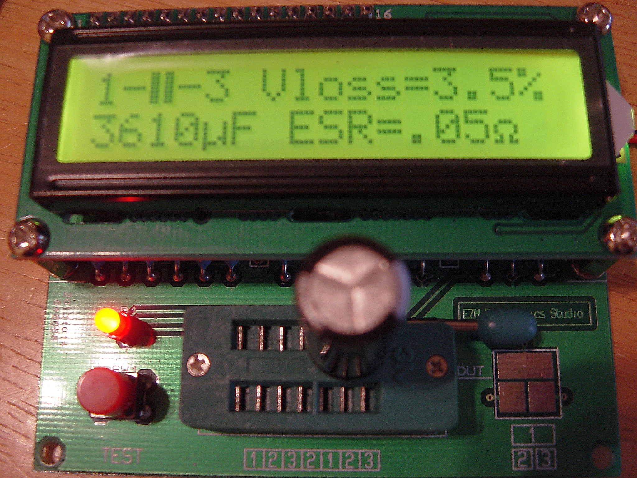

    TV reported as taking longer and longer to turn on, over the course of about a year. TV power light now shows red, turning to white, and repeats, but no picture or sound.
    Initial inspection showed no obvious blown caps, but looking with a magnifying glass, one or two show the slightest possibility of bulging [unless it's my eyes].

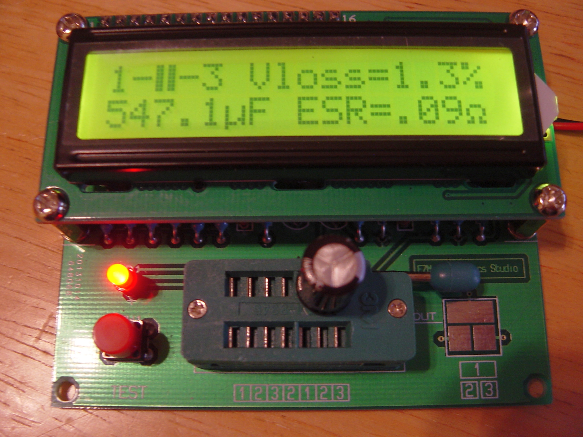

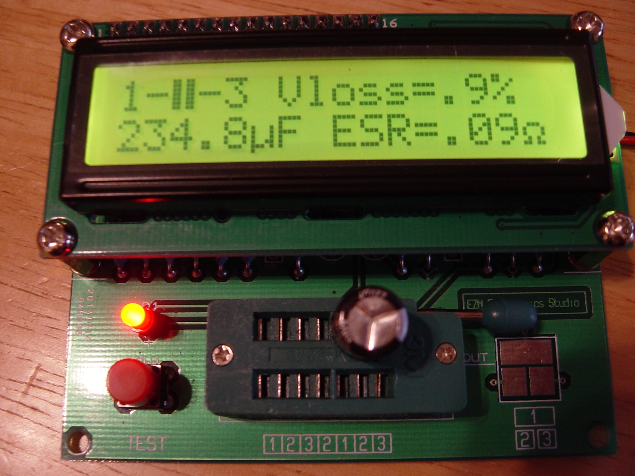

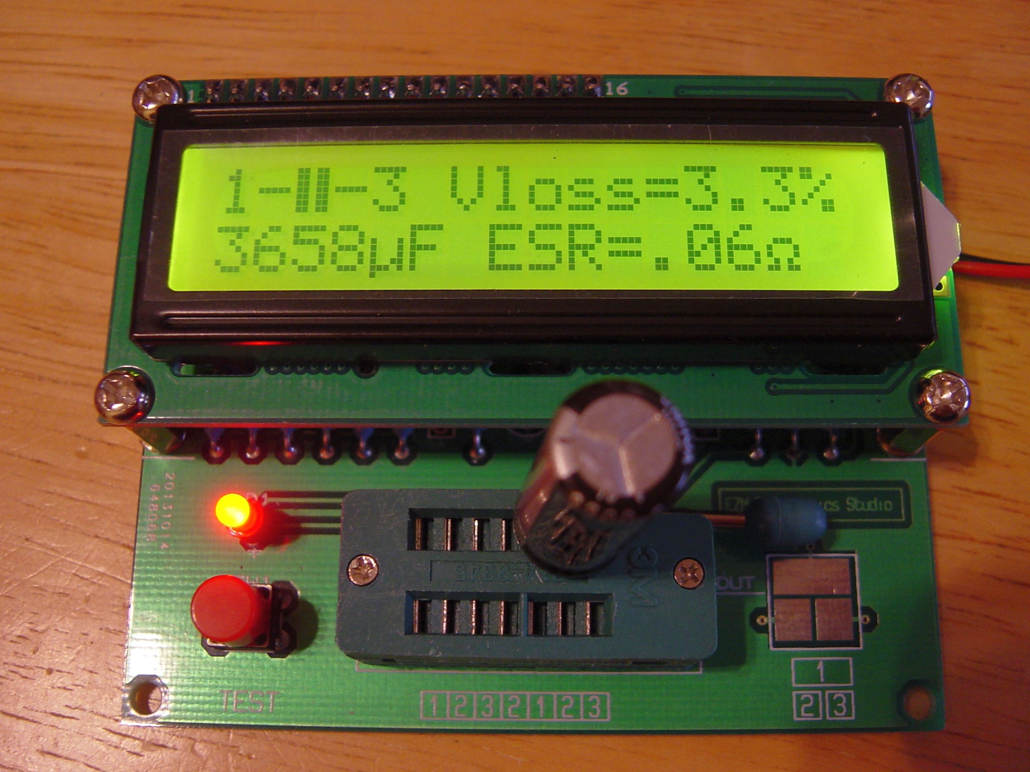

    I've removed 4 SamYoung NXB 105C caps for testing...
    C202 3300uf 10v
    C203 3300uf 10v
    C204 470uf 10v
    C213 220uf 25v
    ...results below. They appear to be OK, though?

    Is the voltage loss within tolerance?
    • oddbodd
      • Mar 2013
      • 121
      Re: Lg 37LG6000 lcd tv
      Do the above caps look OK?
      Should I be looking elsewhere?
        They look OK. I've never heard of "voltage loss" being a capacitor parameter.

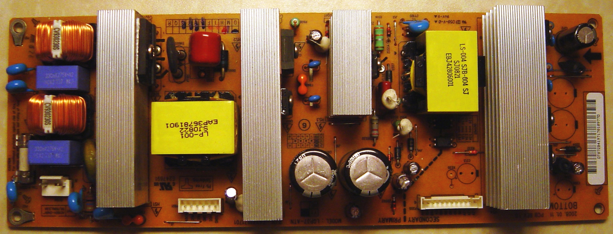

            These sets have two power boards I believe, split in half. Not sure why.

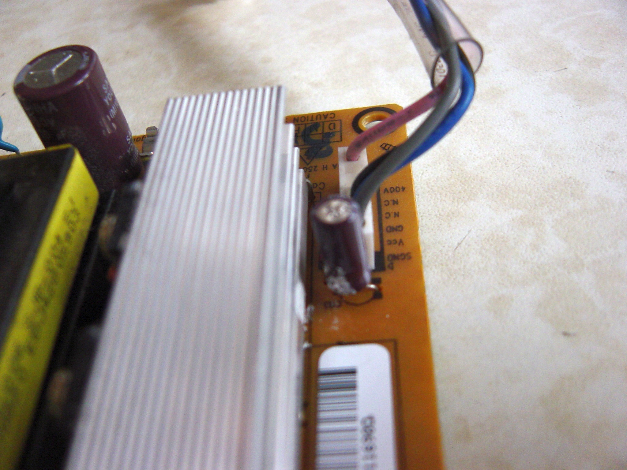

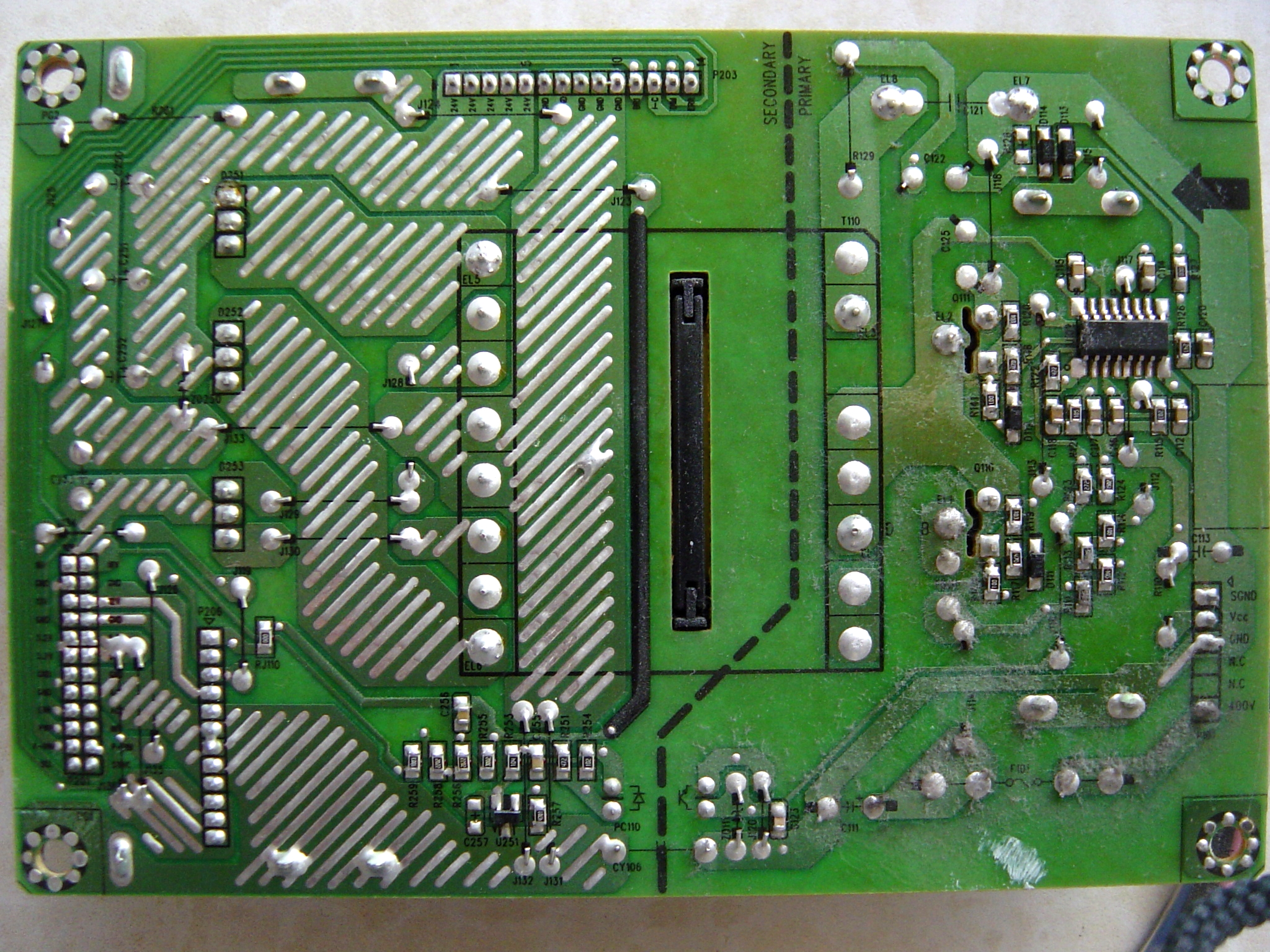

                Perhaps try and locate the start up cap - usually a small one often 50v on the primary side
                There are a lot on these two boards so couldnt even guess - perhaps Tom knows?

                  There are six 50v caps on this board.
                  C206 10uf
                  C501 10uf
                  C512 47uf
                  C510 22uf
                  C511 22uf
                  C508 10uf
                  I'll have a look at the other board later.

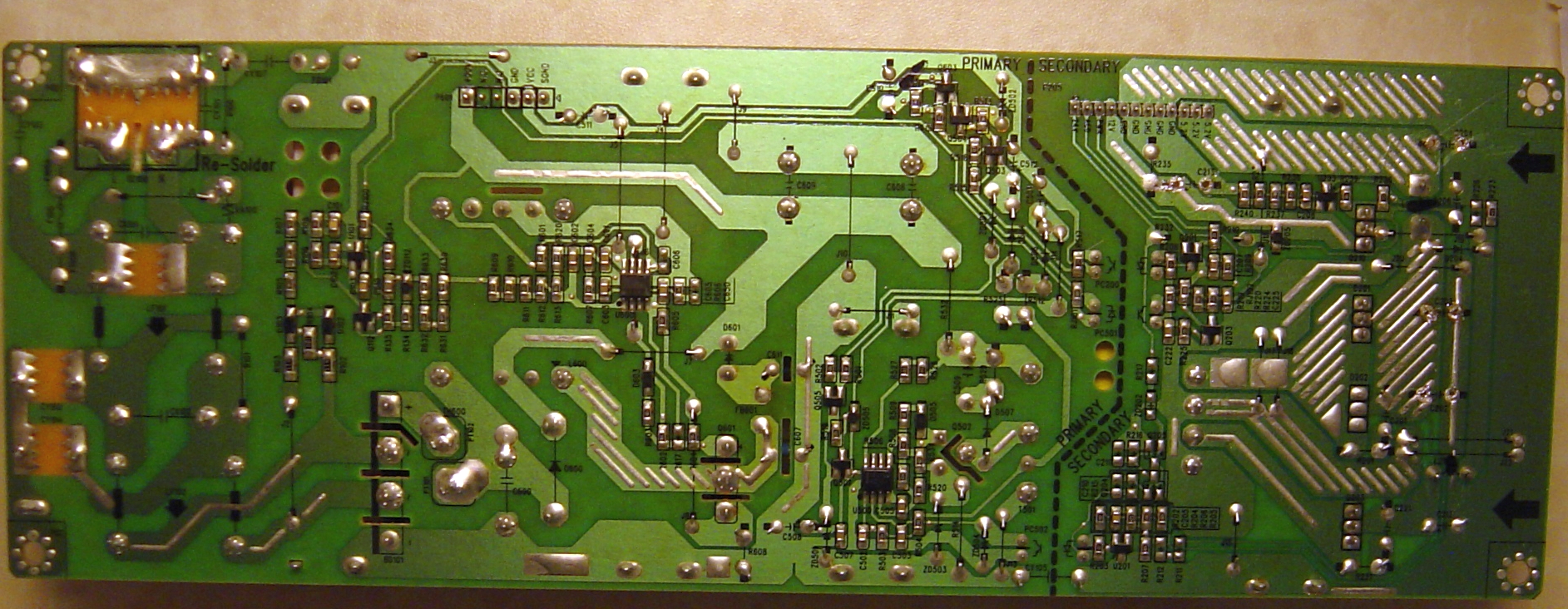

                    Could be any 47uf is a common value for it - I cant tell which is which - pictures are quite good but as you say not enough light - I have the same problem here.
                    The startup usually connects to a pin on the controller chip - usually 8legs cant see one on top so underneath?.
                    It also has to be in the primary section of the board - that at least is marked on these boards
                      what makes it worse these use 2 psu s is the main one picture 5 or 7 seven would be my guess and i would start with the small caps by the heat sinks remove and test or just replace them.

                              You already try heating the caps with hair dryer to see if the TV start up faster and normal?
                              • oddbodd
                                • Mar 2013
                                • 121
                                No, I've not heard of the hair dryer trick. Another use for that gadget, apart from drying paint quickly!
                                OK, some more pics.

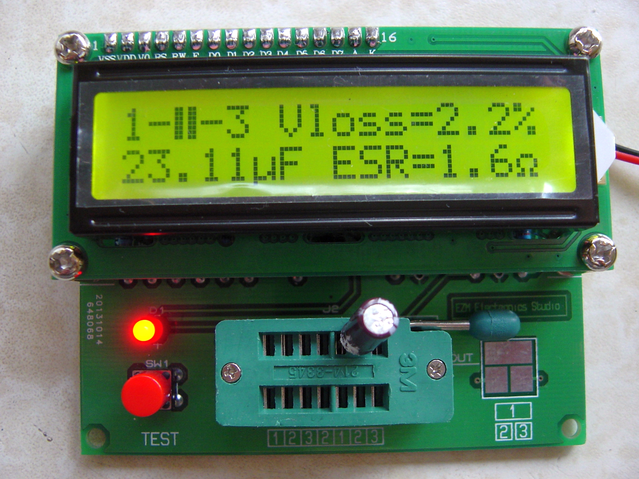

                                The top board, where I've located a 50v 20uf cap at C113. It's quite close to a heat sink on the primary section, with white gloop on it.
                                Removed and tested. ESR = 1.6.
                                Bad?
                                  Probably OK.

                                      Told somebody off the other day for not dusting their boards - how can you check for cold solder joints if you dont? It also makes a nice blanket preventing air from cooling components.

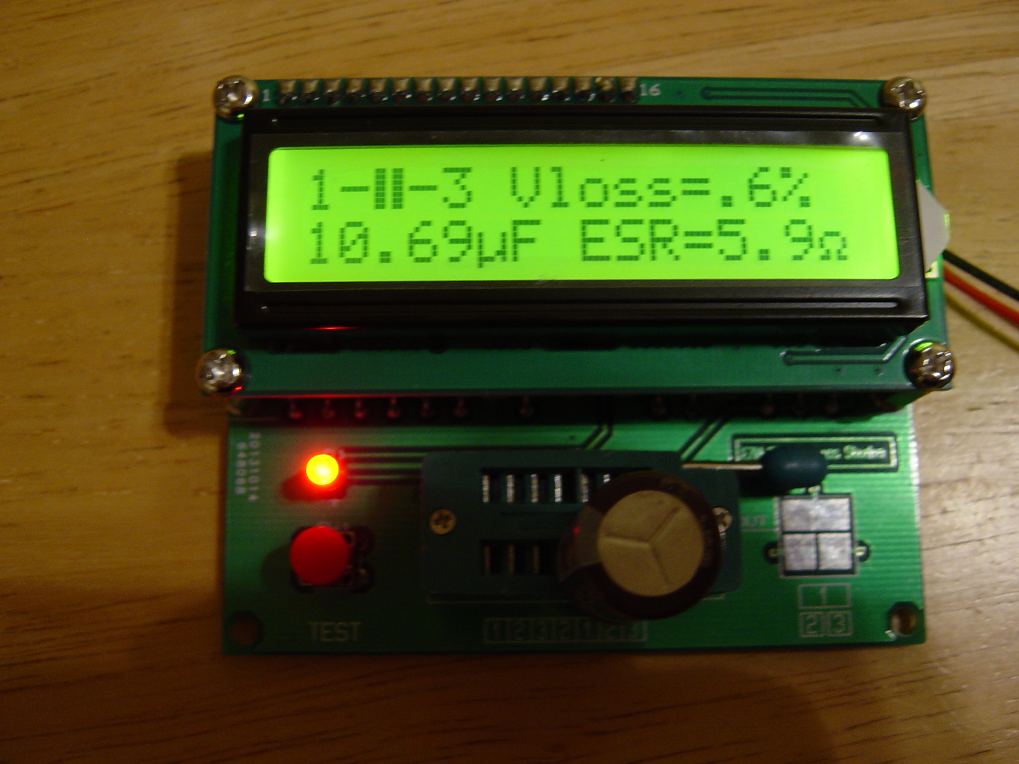

                                        So... I've now tested all the caps on the top board. The 25v and 35v caps seem OK.
                                        C111 is a Sam Young 105C NHA 450v 10uF cap. I tested it after desoldering and it was reading 11.01uF and ESR = 1.6.
                                        But as it's cooled, it now reads 10.69uF and ESR = 5.9.
                                        There aren't any values for ESR in the NHA datasheet.
