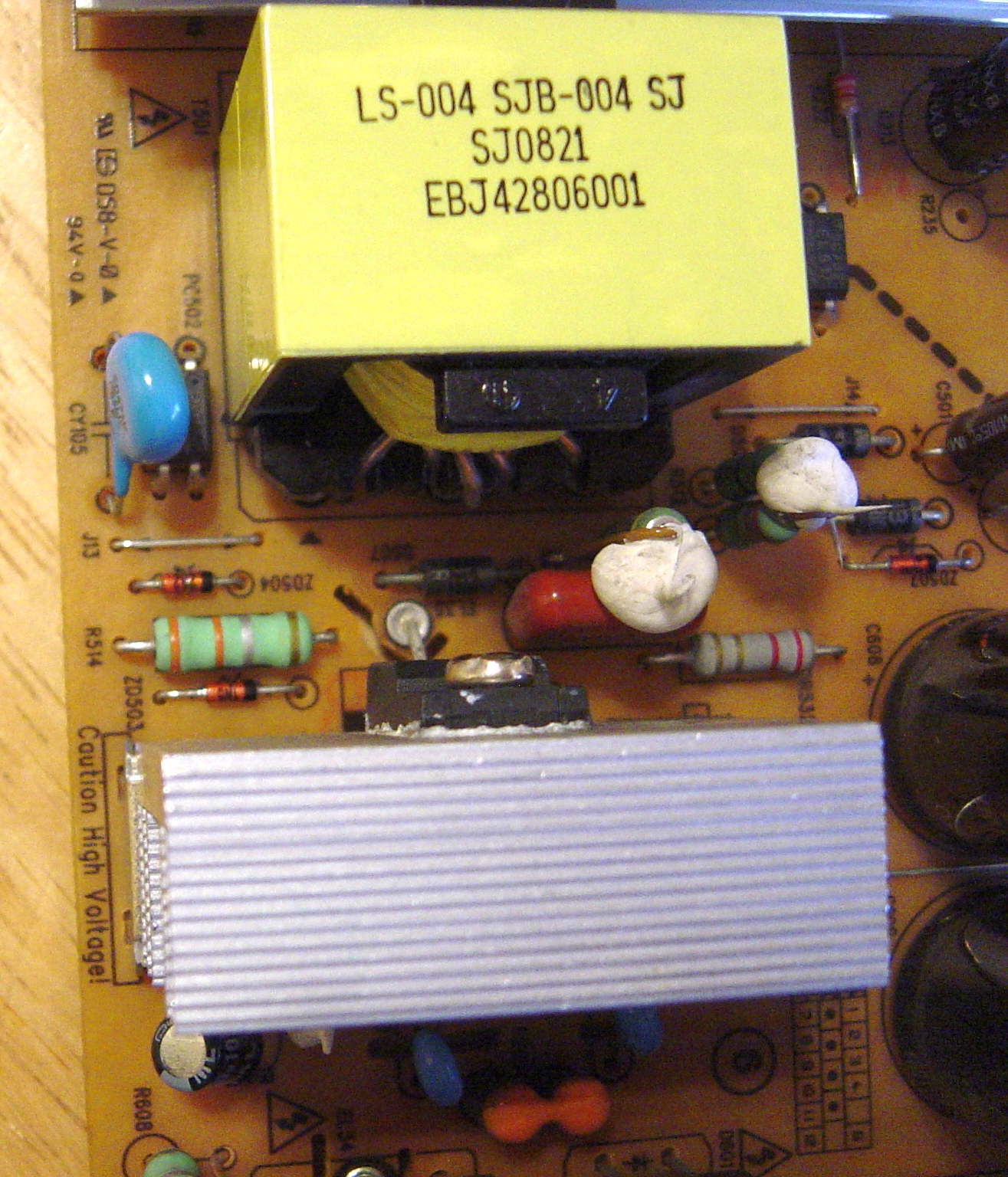

    Originally posted by oddbodd
    ZD503 [1N5 223 B] was testing zero both ways in circuit, but on removal seemed OK. On replacing, it tested zero both ways again. Three identical ones on the board test OK in circuit. Also see pic.
    Typo, sorry, that should be 1N5 232 B.

      Re: Lg 37LG6000 lcd tv
      What else is that zener across?

          #44
          I'm not really sure. Does the pic help?

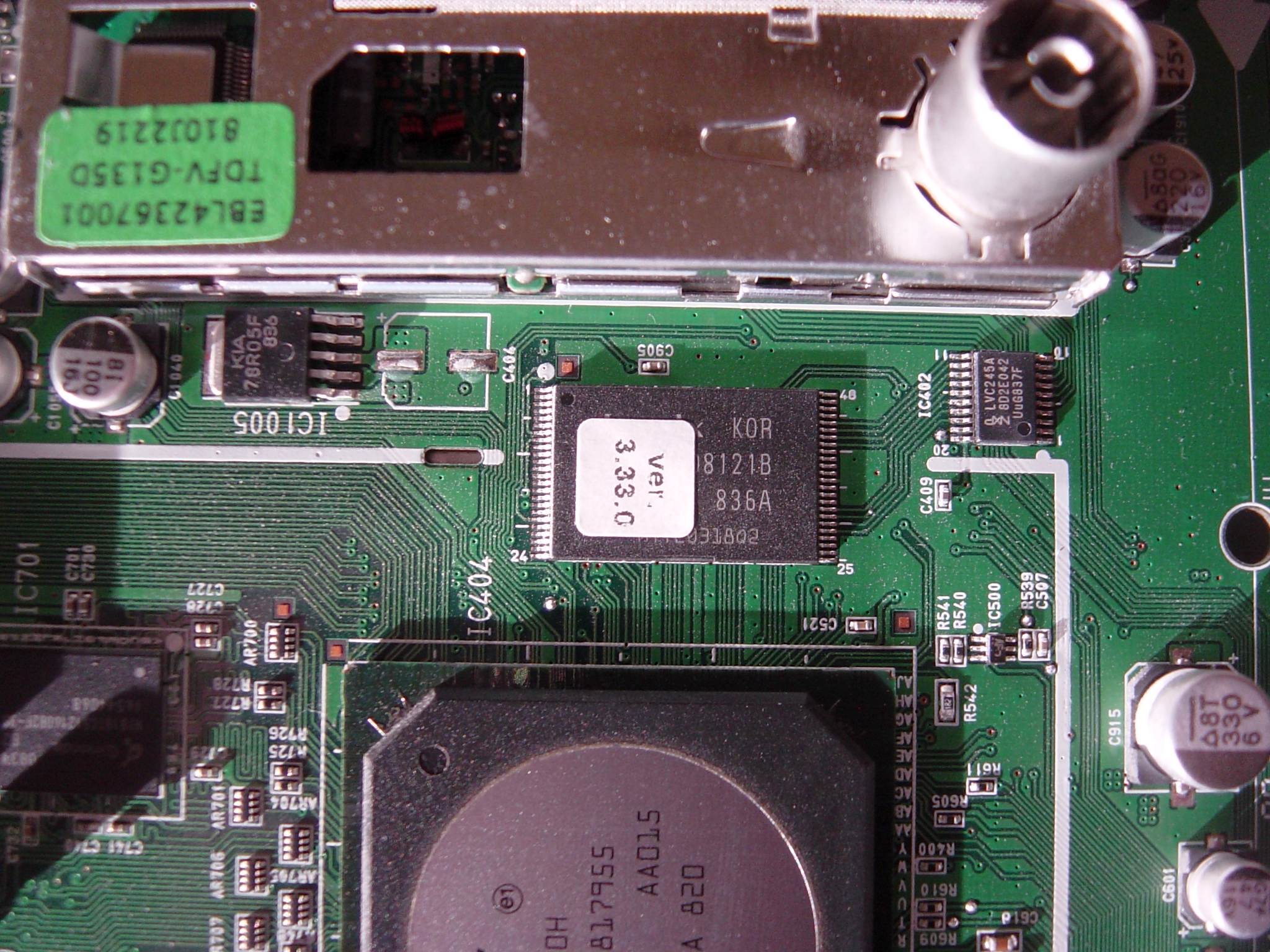

                    New to this site but with regards to the lg,you will most likely find that freezing IC404 will cure the problem.Its a Hynix nand device,It's possible to cheat if no freezer spray is available by using an inverted tin of deodorant...Handy tip i learnt.
                    best wishes,
                    steve
                            There is no IC404 on this board.
                            The set just powered on first time, as it's very cold at the moment. Not the second try, though.
                            I've now brought the set into a warm room, and left the bottom board in the cold for a while, to try again later.

                              #54
                              It sits just to the left of the tuner on the pcb I have here,
                              which is a eax391 001(14)

                                  #56
                                  I think it is on the Main board the one with the inputs near the aerial socket (Tuner box)

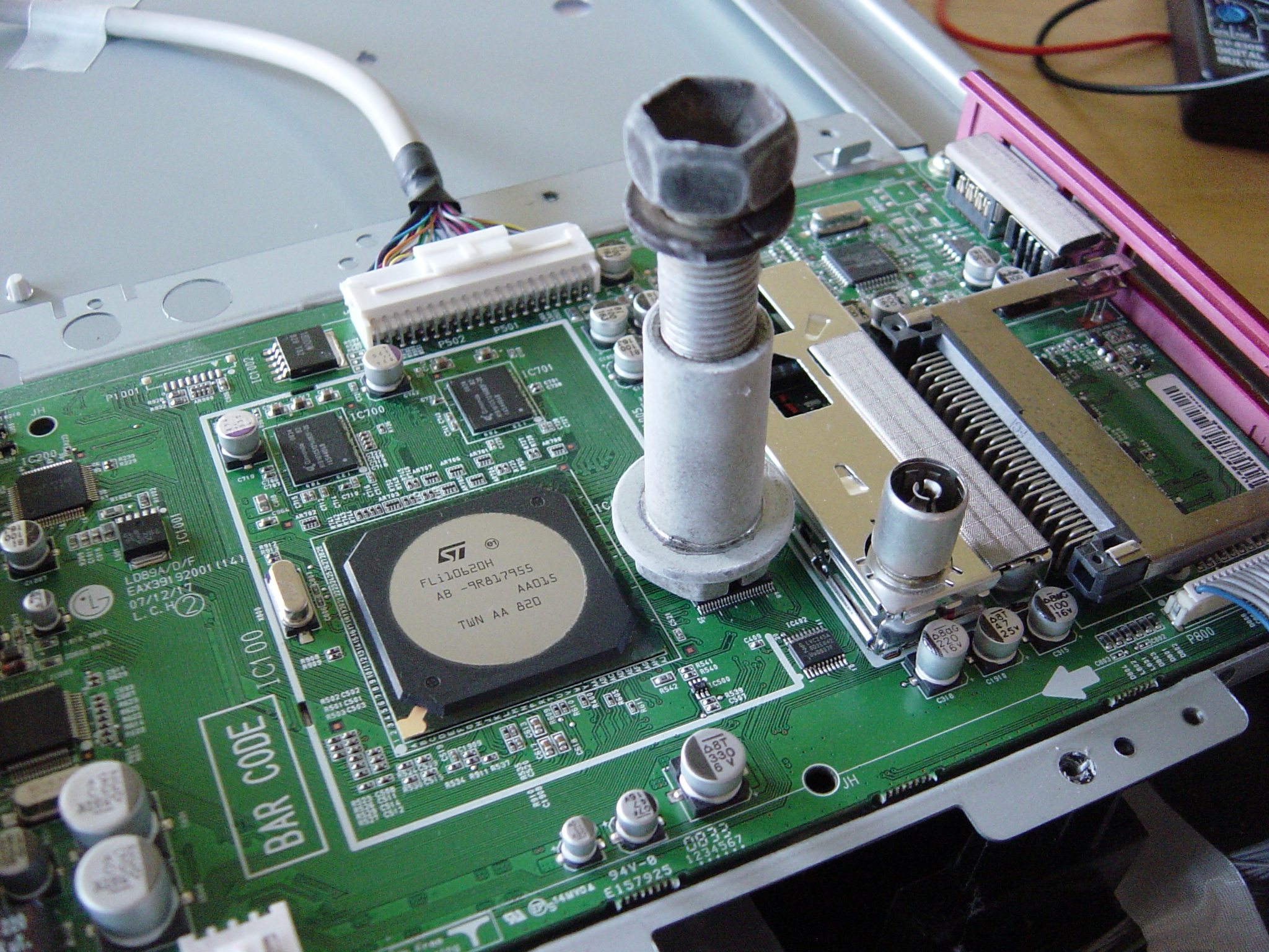

                                        #59
                                        ... and indeed it is.
                                        If this IC is the problem, I don't think I shall be able to replace it... All those tiny solder connections...
                                        Edit: I tried a couple of starts in the warm, and no go.
                                        Meanwhile, I'd found a suitably sized large flat headed bolt in the garage, which I placed in the freezer for about an hour. I then placed the bolt on top of IC404 for a minute or two, to suck the heat out. Powered on, and the set started up.
                                        So it appears that IC404 could well be the culprit.
