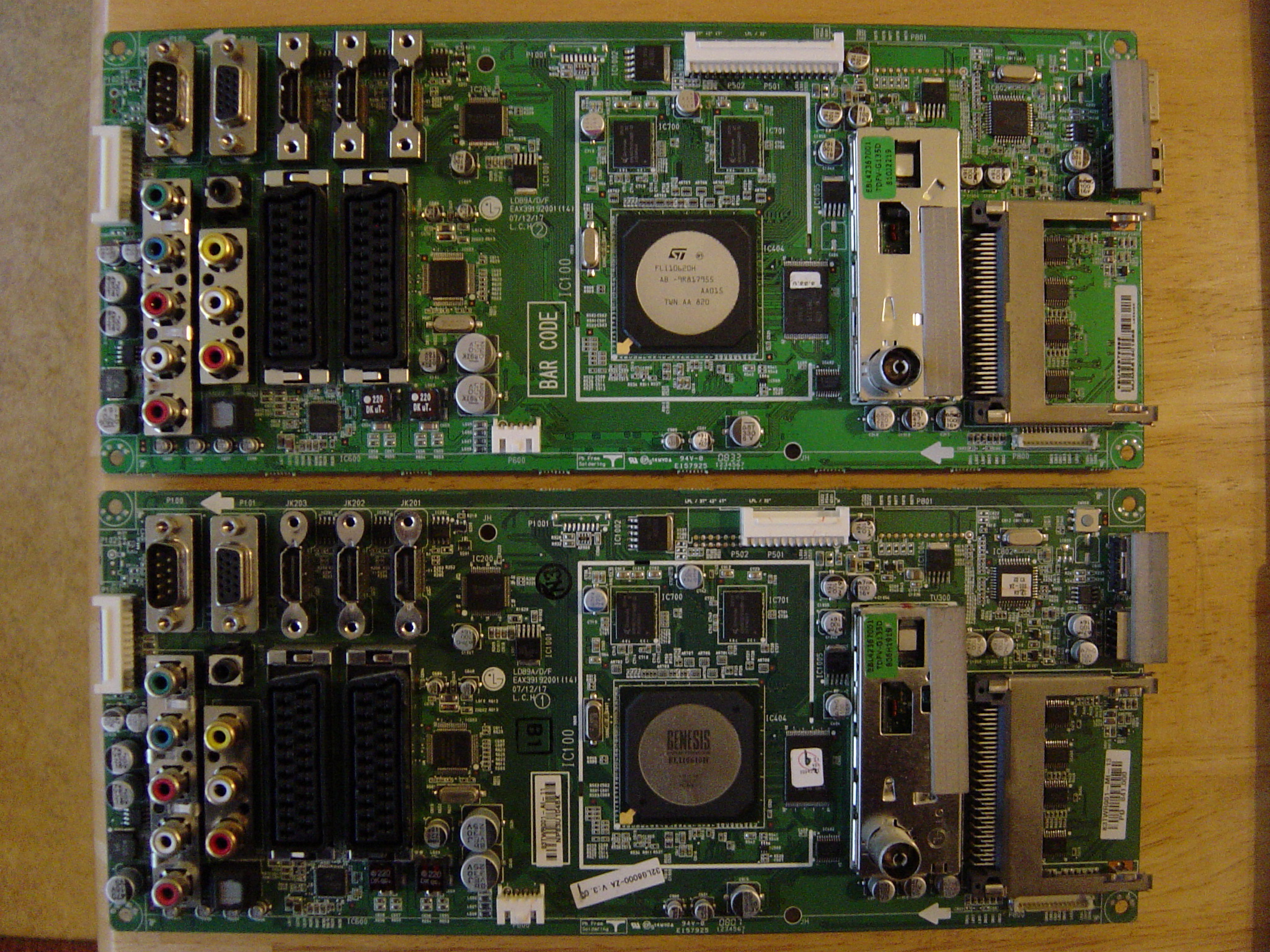

                  After a lot of searching, it seemed to me that the mainboards on the 32/37/42/47 inch LG6000 models were the same part number.
                  I managed to find a cheap one from a 32in model on ebay. However, it's just arrived, and it appears that the 32in one has one small difference. Socket P501 has less connectors than the 37/42/47 inch versions.
                  Pic of the 2 boards below. Spot the difference...
                  So, I have a set of 5 boards for the 32LG6000, which are no good to me, and will probably end up back on ebay. I might well ebay the TV as well, as I could do with it out of the way, now.
                    #69
                    Re: Lg 37LG6000 lcd tv
                    32LG6000 is probably 720p whereas the others are 1080p, hence connector difference.
