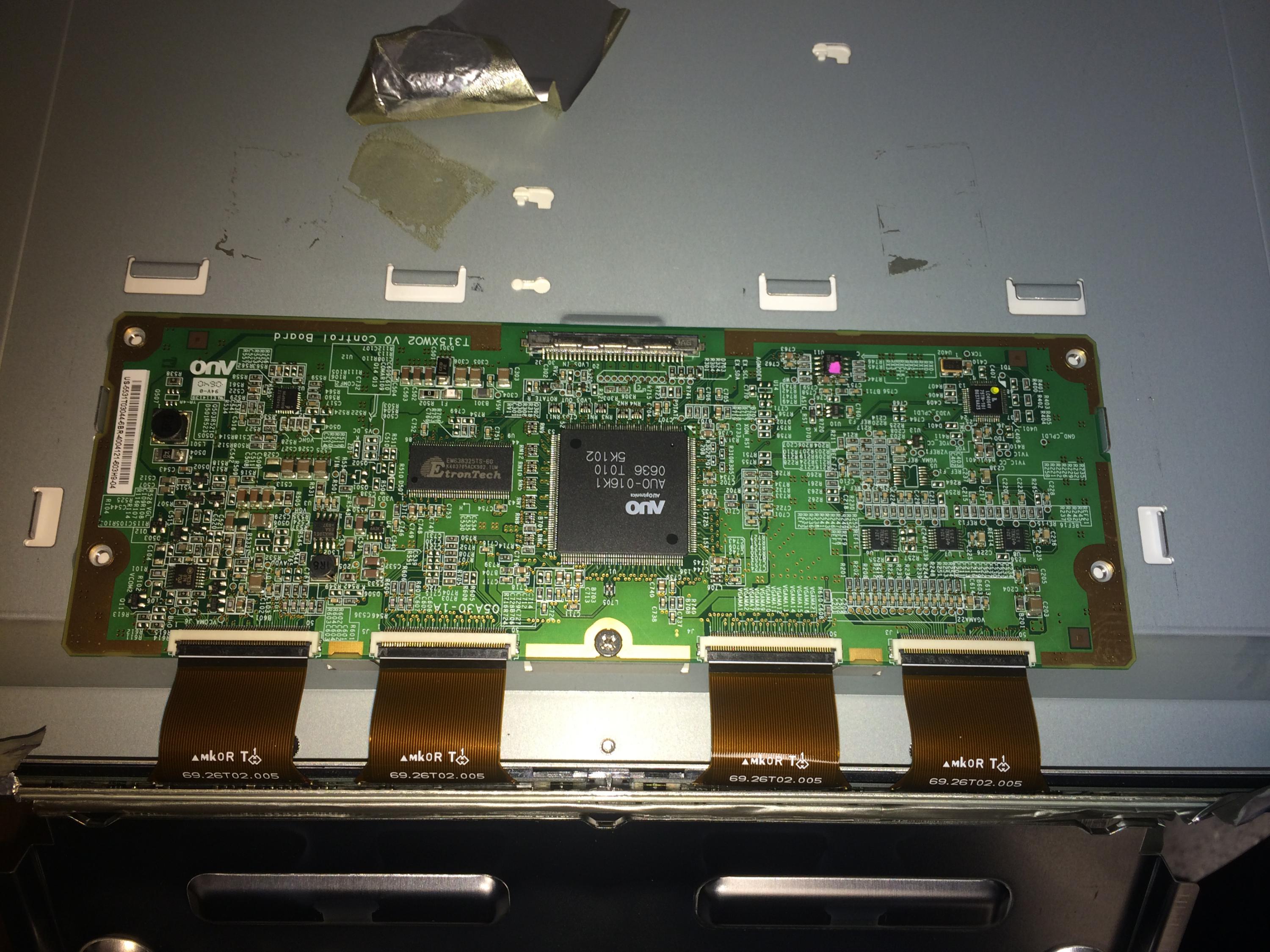

          pictures of the boards will help maybe test the voltage to each side of the tcon fuse.

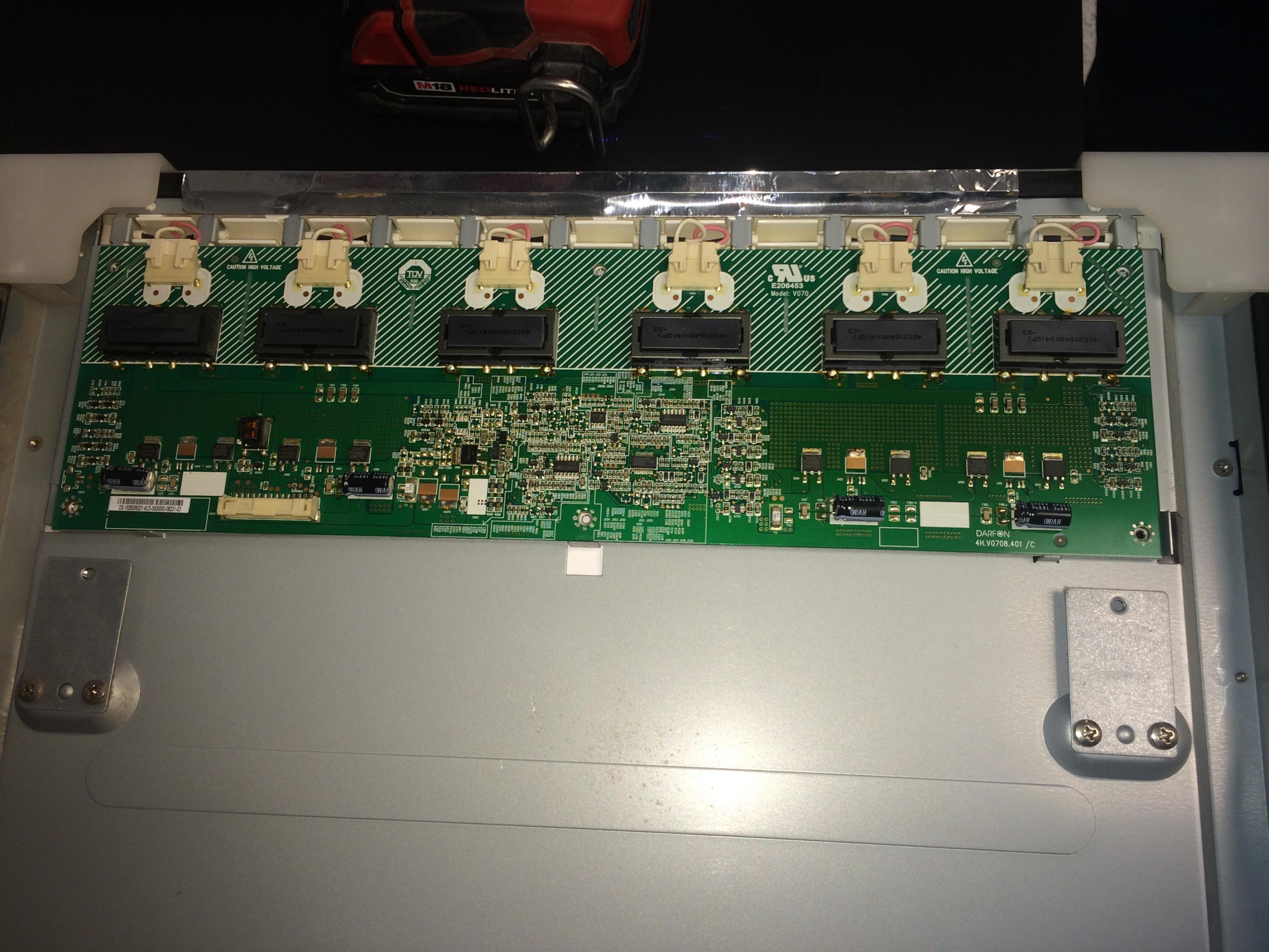

            here are some pictures of the tcon and inverter boards. i checked the 3 fuses on the inverter board as well as the 1 on the tcon with a meter and all have continuity.
            i suspect it may be the inverter board, but am not 100% sure. if i shine a flash light on the panel, i can see a picture as well as hear audio. when i unplug the tv for a minute and plug it back in, the backlight comes on when i turn it on for a second amd then goes out. if i unplug the wires going to the backlights is there a way to test to see if it is a bad ballast? how can i test the ballasts?

              check both of the white fuses on the invertor board whats the part numbers on the transformers maybe able to get the details for them to test each winding etc i always test fuses where possible with a voltage reading on each end i have had false readings on continuity mode with my meter.
                T-con fuse isn't suspect as their is an image

                              when i got this tv, there were a few caps on the power supply that were bulged. i ordered a cap kit and replaced all the caps on the power supply. now when i turn the tv on, i get all the voltages i am supposed to on the power supply. i checked both of the connectors and am getting the 24 volts to the inverter as well as the 3 volts to the inverter. i am also getting 5, 12, and 15 volts to the main board.
                              Vinceroger69, the numbers on the top of the transformers are 4002y648004(cp)-03

                                      Re: rca l32wd22 problem
                                      Viceroger69,
                                      Here are the results of my testing:
                                      LDO #1 Pin1 no voltage Pin2 3.30v pin3 5.04v
                                      LDO #2 Pin1 no voltage Pin2 3.30v pin3 5.04v
                                      LDO #3 Pin1 no voltage Pin2 3.30v pin3 5.04v
                                      On the inverter board, all 3 of the fuses read 24.04v on both sides.
                                      The voltages at the cable plugged into the inverter board are:
                                      Pins 1-5 (VDD) 24.04v
                                      pins 6-10 (GND)
                                      pin 11 -not used-
                                      pin 12 (BL ON) 3.27v
                                      pin 13 (VDIM) 3.27v
                                      The fuse on the tcon board reads 4.85v on both sides.
                                      I found specs for the transformer here: http://lcdparts.net/TransformerDetai...ProductID=3502
                                      The secondary resistance should be about 1.2K between S1 and S2 (or S3 and S4) and the primary resistance should be about 0.5 ohm between P1 and P2.
                                      I checked all my transformers and found all primary resistances to be .4 ohms.
                                      I also checked both secondary coils on each of the 6 transformers and all were between 1.19k - 1.20k except one. one of the secondary coils was 1.20k and the other was 2.48k.
                                      Do you think this is my problem?
