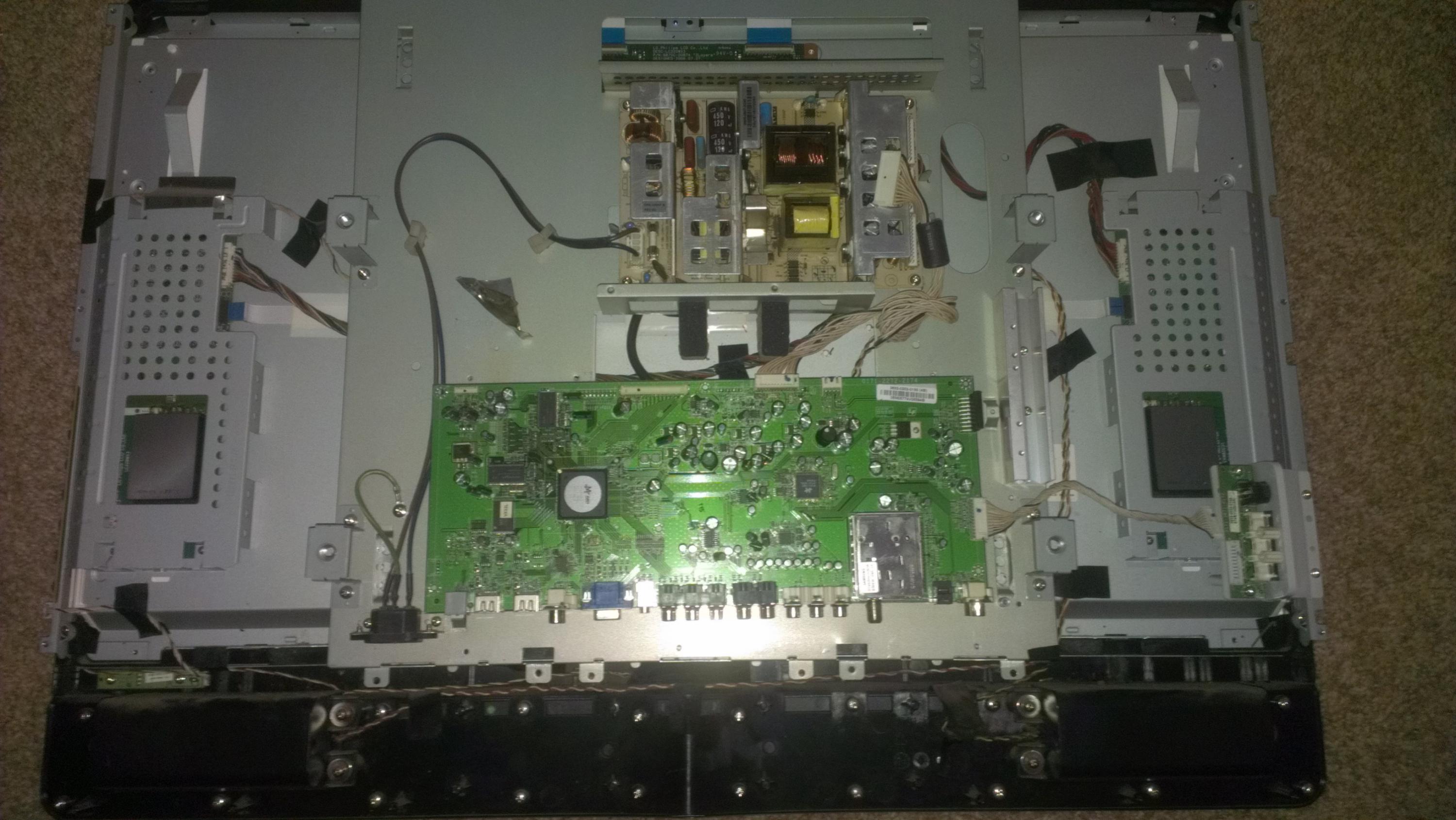

    So its the vx32l model to be exact, I've been trying to read what I could, but most everything I've read has been on just answer with techs giving pointless advice to guys who don't understand it, and can't follow through
    Whats happening is I plug it in, the orange light comes on, hit the power, vizio logo turns white for about 3 secs then back orange, no flicker, back light or noise, the relay never even clicks on which makes me think the problem could be there but I've also read it could be a software update.. well I've got my multimeter on the ready, where and what should I be looking for?

    Oh and I have no bulging caps anywhere or anything that looks fried
      Re: vizio turns on and off in matter of sec
      Pictures of the boards and the whole back side of the TV?

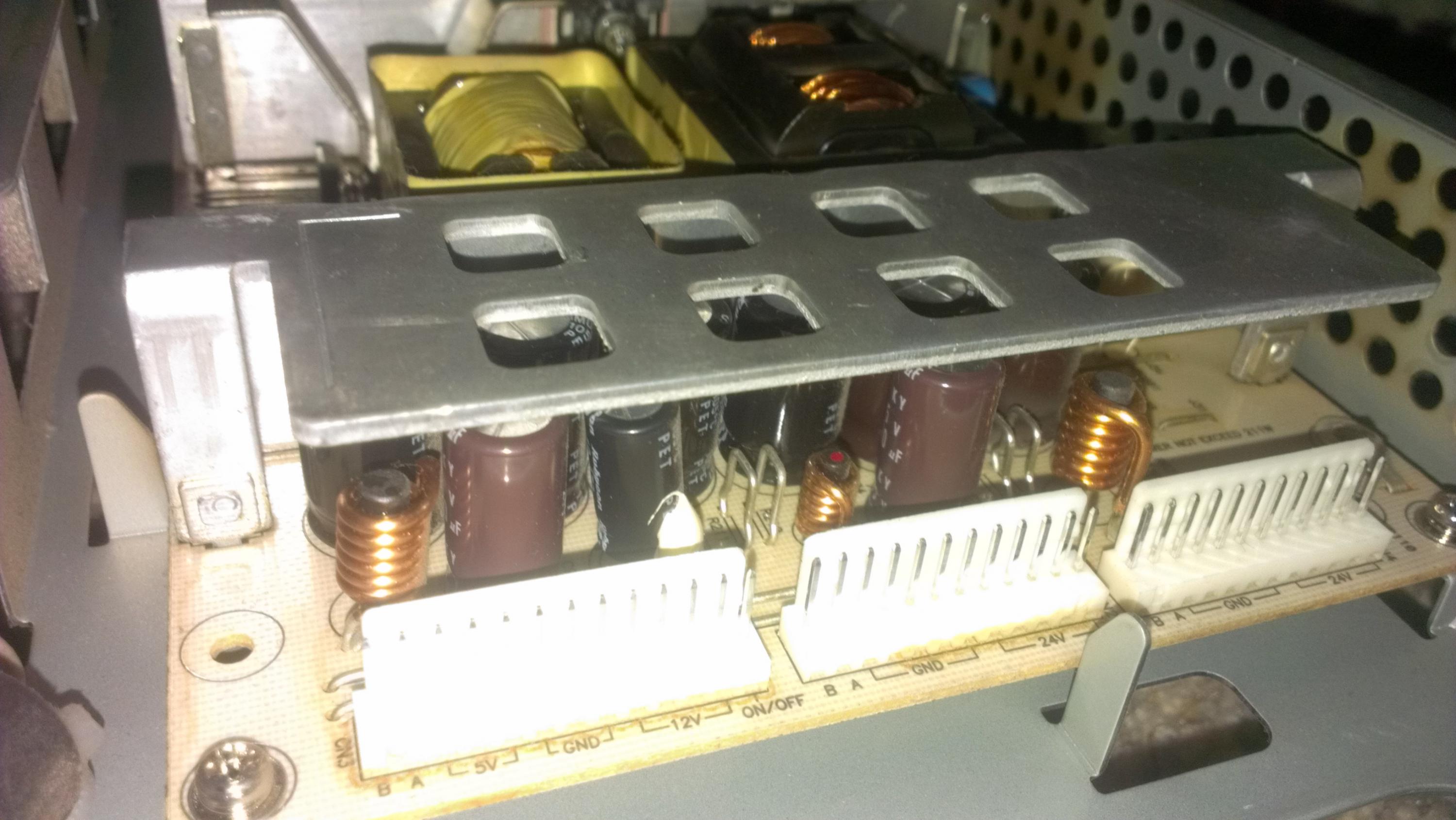

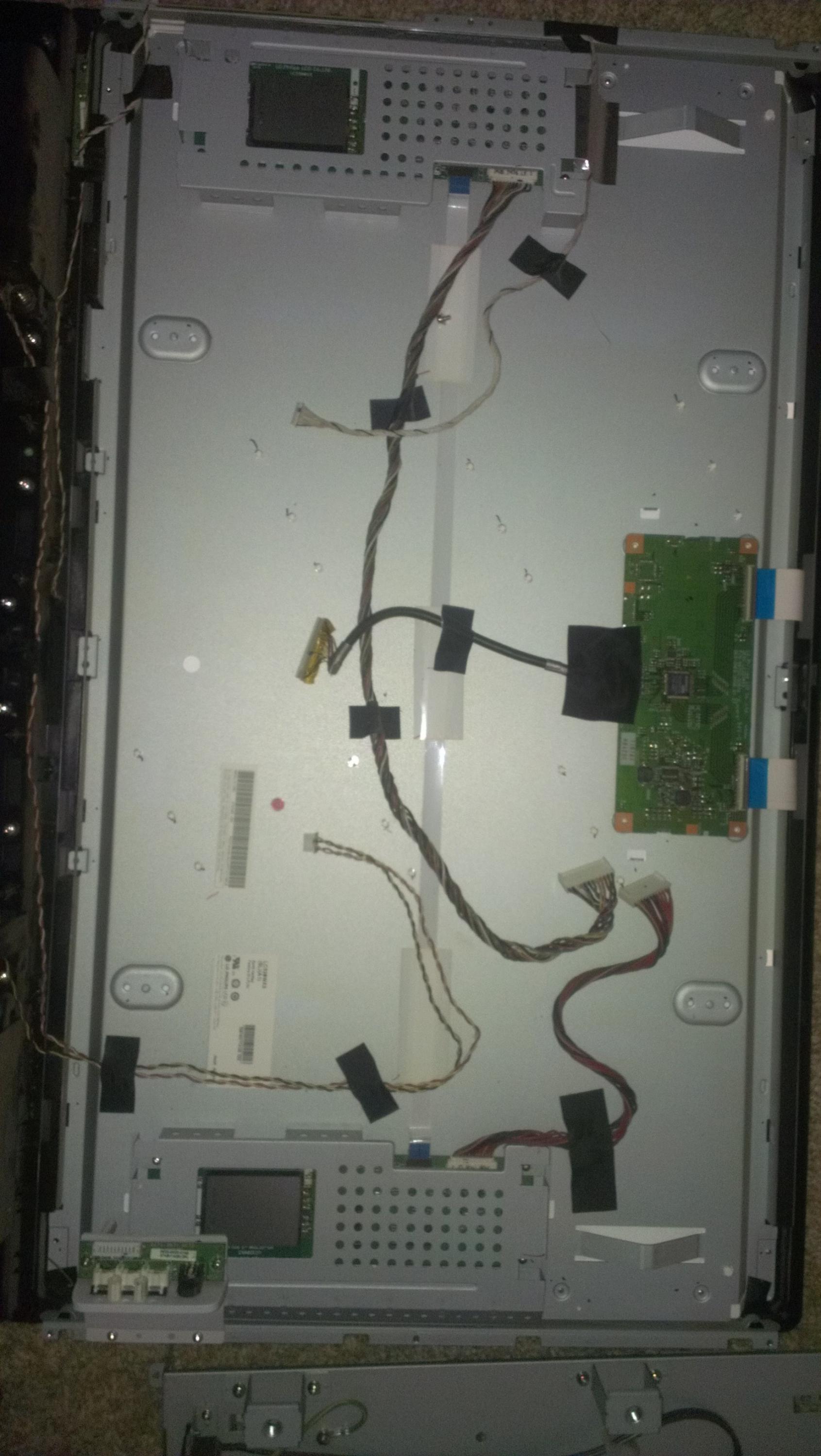

        Are these good enough? It was pretty hard to get a good pic of the caps as they are covered, but they're aren't bulging out the top at all
            Let's start with checking the power supply output voltages at the 3 connectors when the TV is OFF, and when TV is ON.
            List the voltages of each connector.
              Going down the rows the top two sections both split off to each side of the tv and mirror each other
              Power off they all vary between 0.00v to >1v
              Power on the top 4 pins show 24v and the rest are >1v
              The bottom 3rd outlet read, well I can't remember, the top pin power off read <1v, power on read 3v, the next few ones I can't remember, some said 0v power on or off, and some of the pins close to the bottom said 5v power on or off.. problem is, is while I was testing these, it all of a sudden lost power, the vizio logo on the front no longer lights up orange at all and I'm not really getting any power ratings at all anymore, i don't know if I contaced two pins at once and shorted something out or if something was going out and just finally went completly out

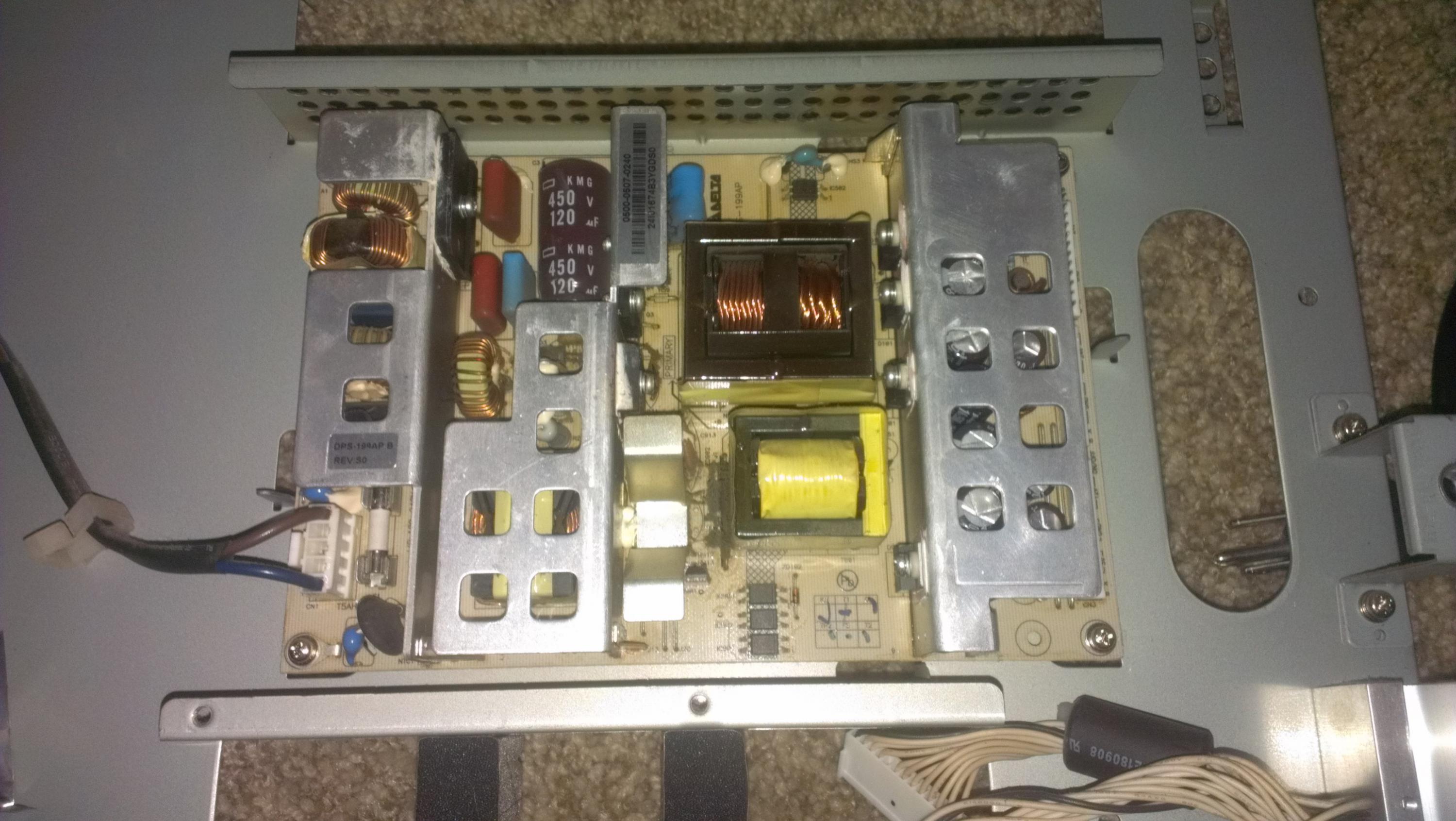

                • truep
                  • Aug 2010
                  • 373
                  From your fourth picture, There looks to be at least one bad cap under the heat sink.
                  Are all of them perfectly flat on top? It's the brown one on the left.
                    Ok unplug the set and plug it back in after a few minutes... still no life?
                    Are there any signs off life at all?... LED or anything?
                      No its flat, ill see if I can get a better pic of it, but ya no life at all, no leds or anything, I unplugged it and let it sit, I tried different outlets and still nothing, is there something specific I could check on the power supply to see if it failed, to rule out the possibility of it being that other big board below the powersupply where the on and off signal comes from, I know when that board was unplugged the tv would show no signs if life like it is now
                        DMM set to dc 600v ... probe to each leg of the big 450v cap on the PSU... Careful!!.. Deadly Hot Side!

                              • Shane711
                                • Dec 2014
                                • 493
                                Looks like it has been a long time since anyone has posted on this post. Just wanted to add my comment. I have worked on a few of these TVs and every single time it is the main filter cap, the biggest one on the power supply. 120uf 450v. You will not see it pop but you may see it leaking from the leads. The leads burn right off it. So even if it looks good just remove it and test it. No other time have I seen it to be anything different.
