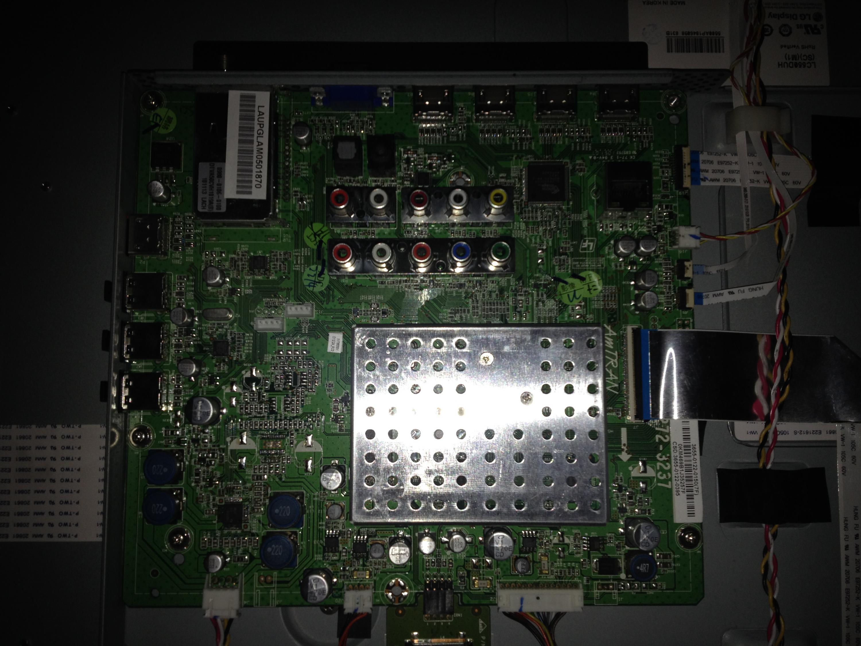

    Picked up a Vizio xvt553sv yesterday, it freezes on the vizio logo on startup... After about 3 minutes it reboots it self and does the same thing. I assume this is a firmware issue, and of course vizio does not offer a firmware update for this tv. I know the problem is in the main board. Its gotta be fixable without replacing the whole main board, Im getting tired of Vizio's "firmware problems".

    Can you post a full close up photo of the main board?

      Not the best picture, best I can do with the camera I have. Sorry its upside down/

        I'm working on the same TV right now with a main board problem but its probably not the same problem as yours.
        Can you do me a favor and tell me what is the serial is on the chip near the hdmi ports that read "silicon image"? Thanks
        Also, when you disconnect the power cable and plug it back in, does the vizio logo blink white and orange for a number of times?

          N2M674-00-1 serial.
          The vizio symbol flashing is exactly what the tv is supposed to do, mine does the same. It is rebooting itself and checking for any issues, I contacted Vizio directly about that issue. Flashes for about 80-90 seconds.
            Re: Vizio xvt553sv Freezes on splash screen
            What does it label above that? like it should be something like Sil...CTU or something
            hmm, yeah mine blinks about 90 times before I can turn it on but then itll freeze
              Sil9385ctu.

                      Usually the freezing of the splash screen is an EPROM issue on the main board. At least that's the case with the ones I've had.

                        Can you buy a eeprom and just install it? I see the trade in service for the XVT553SV and the XVT473SV mainboards on ebay so i assume that the firmware is available somewhere.
