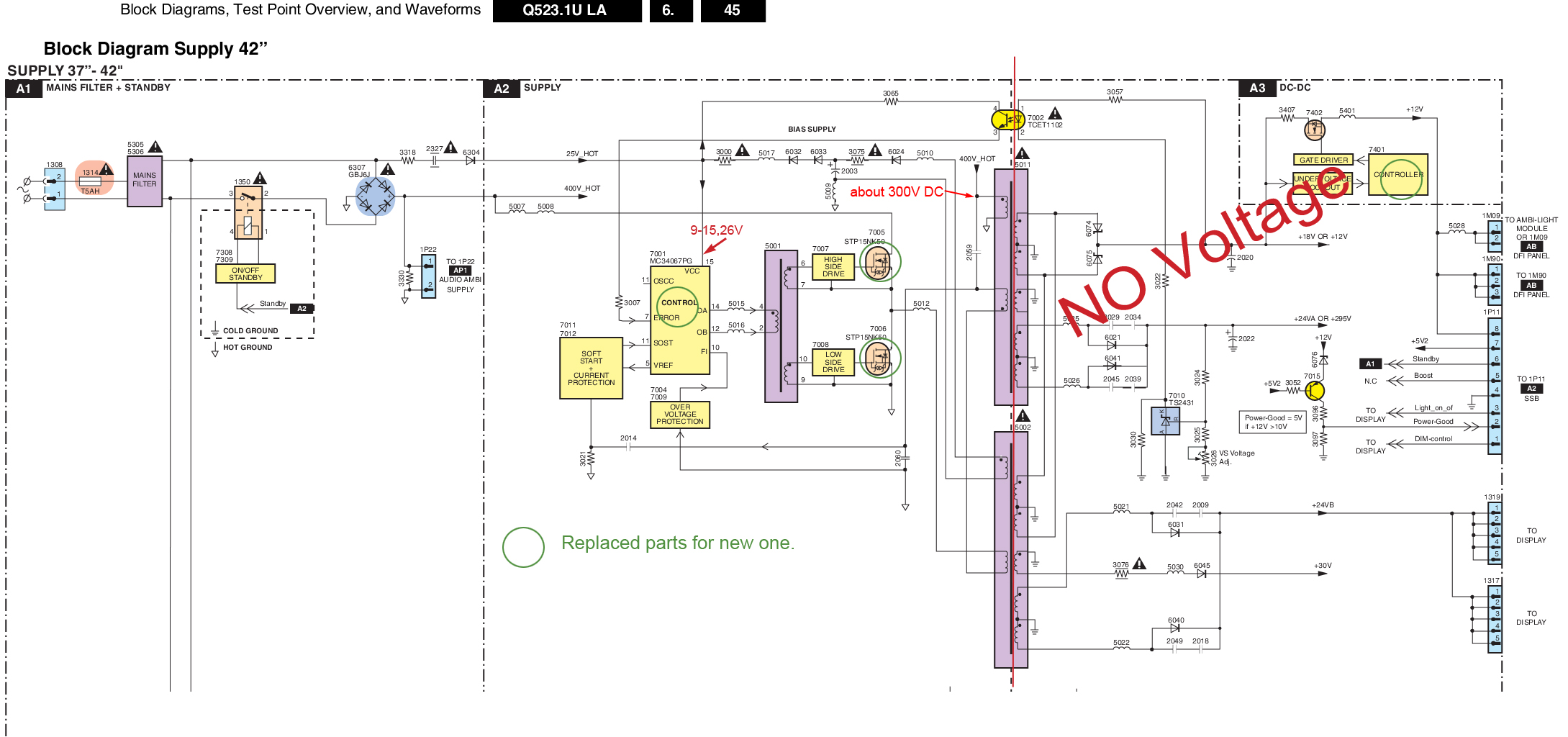

    Hi, recently I bought a broken Philips 42PFL7422D/37. I'm electronics hobbiest so I wanna try to fix it. If I try to turn it on, there wasn' t any sound or picture. There's heard only click.
    I replaced the parts which were bad (by visual) and some kind of diodes after checks. I was download manual service and then checks almost everything. There is only 120V AC out to main board (1P02); four big caps have about 152V DC; MC34067P on 15 pin there is growing and falling DC voltage (9-15,26V). I think it will be easier to show my measure on Block Diagram.
    Could You help me? What I have to check in this power supply?
    (sorry 4 my language)

    Re: Philips 42PFL7422D/37 power supply issue
    I'm trying to fix one of these myself. However, you may have different power board given you are in 220V/50Hz region (PAL).
    Everything, including my Philips TVs, are subject to birth, disease, old age, and finally death.
      Check R3318 to see if it is OK, that is the common failure component.
        budm I was check almost every part of Primary Side this board(resistor 3318 is good).
        PhilipsKSI I have a transformer from 220/110V.
        Are there any test points or any standard Voltages on this board which I should check to make sure that I go right way?
        I'm just a beginner so I'm asking...
        I have a question. I was connect this broken board on my table, giving +5V from LAB Power Supply to 7th pin of 1P11 connector. How can I simulate START this board? Which of pins I should cross/close ?
        Thx
