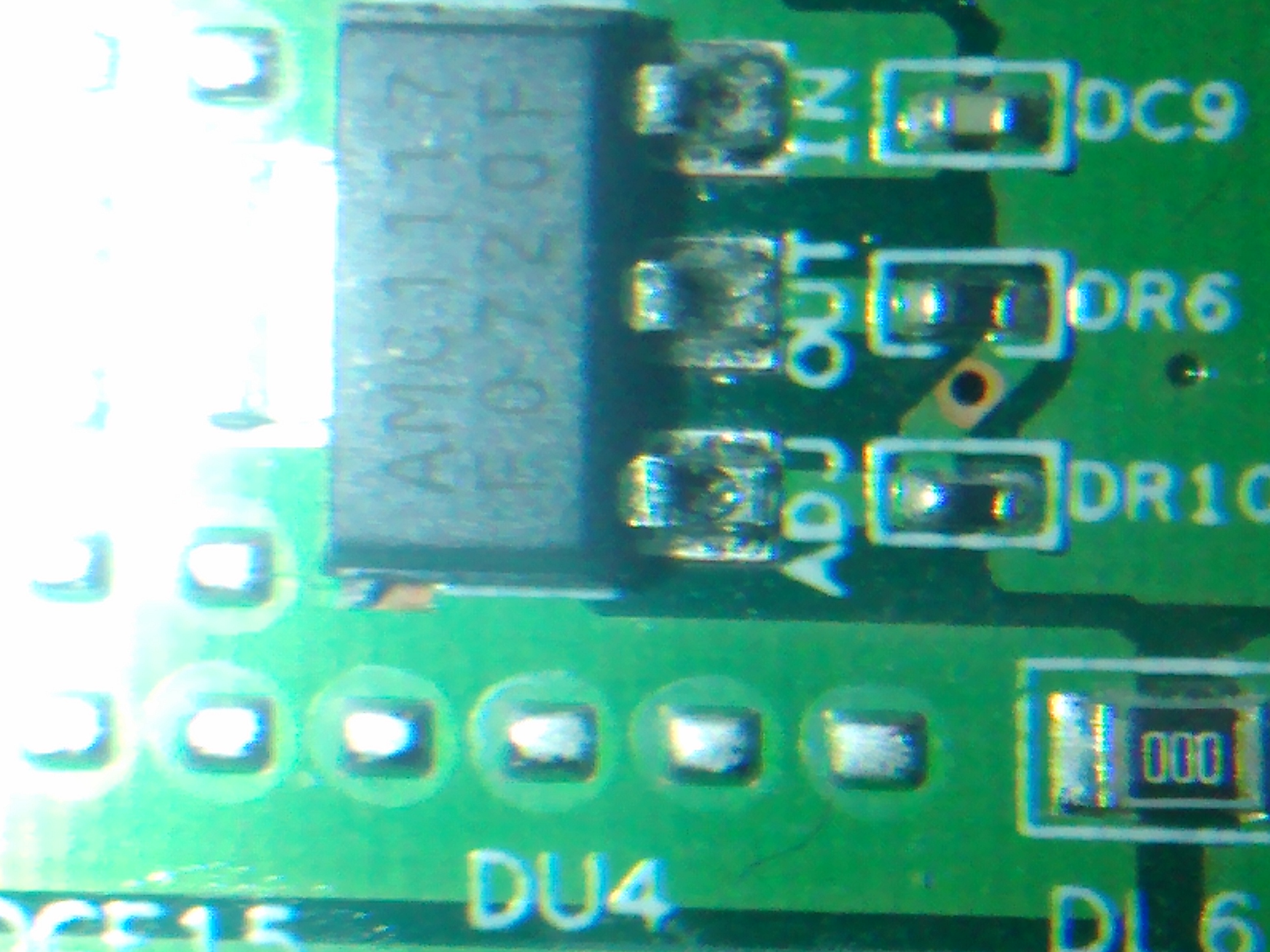

                  Can I get good closed up pictures of this DU4 so I can see how the 3 legs are connected?
                  Looking at this picture: https://www.badcaps.net/forum/attach...6&d=1454392483
                  The DU4 looks to be an Adjustable 1117.

                      Re: Vizio GV47LFHDTV10A No Picture No Sound Fix
                      Getting that picture was trickier than I thought it would be. Things sure do look different when under a magnifying glass. I also figured I would put DU1 on the list as well being that I left it out
                      DU1
                      AZ7805T
                      E1
                      718G70
                      PIN 1= 11.86
                      PIN 2=0
                      PIN 3= 5.06
                      I also rechecked the voltages on DU4 and nothing as changed.

                        My working set has the following readings for DU4
                        Pin1: 0.0v
                        Pin 2:1.24V
                        Pin3: 3.3v
                        Pin 2 is off for you. It doesn't look adjustable. DL6 and DCE11 are on that same 1.24 volt line. Make sure those are ok.

                            DU4 is an adjustable based on the two resistor network (one between ADJ and the Output pin, Resistor DR6, and another resistor between ADJ pin and GND, DR10).
                            The output Voltage can be calculated by knowing the values of those two resistors.
                              So are you thinking its the resistors or the regulator?
                                #55
                                The resistors are for setting the output Voltage, it will be the IC.
                                You need to get at least two adj type 1117 Regulator ICs (U5 , DU4).
                                Tricky part will be removing and installing the ICs without disturbing the resistors and caps closed by, so I hope you are good at surface mount repair.
