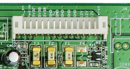

              Just curious but I know low voltage readings on a power supply board can cause issues, so could a higher voltage reading cause an issue as well? Here are the voltage readings off the power supply board as well as the main board.

                Re: Vizio GV47LFHDTV10A No Picture No Sound Fix
                No pin names for each pin to tell us what the function of each pins are?
                • bleed4me
                  • Nov 2015
                  • 122

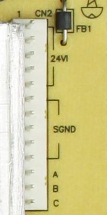

                  Sorry about that, was working on getting good pictures.

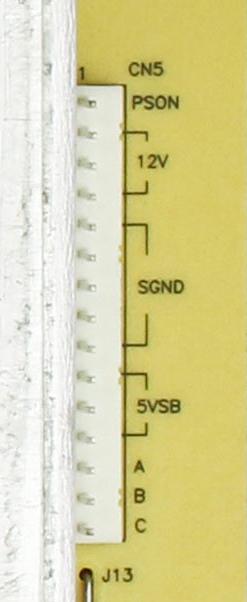

                    What do you mean by PIN 4?
                    You need to report in this format: for example
                    CN5:
                    Pin 1 (PS-ON) = xxxx V
                    PIN 2 (12V) = xxx V
                    PIN 3 (12V) = xxx V
                    https://www.badcaps.net/forum/attach...0&d=1454187031

                      Thank you Budm for showing me the proper format to write this so everyone can understand, it is much appreciated. Please let me know if I need to make changes to it. Sorry for the confusion
                      CN2
                      PIN 1(24VI)=27.2
                      PIN2(24VI)=27.1
                      PIN 3(24VI)=27.1
                      PIN 4(24VI)=27.1
                      PIN 5(24VI)=27.1
                      PIN 6 SGND=0
                      PIN 7 SGND=0
                      PIN 8 SGND=0
                      PIN 9 SGND=0
                      PIN 10 SGND=0

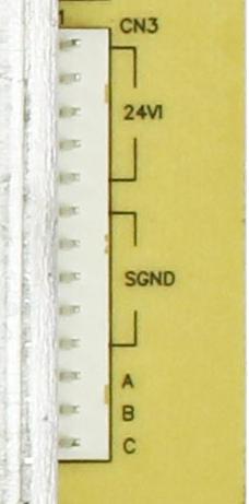

                      CN3
                      PIN 1 (24VI)=26.9
                      PIN 2 (24VI)=26.8
                      PIN 3 (24VI)=26.8
                      PIN 4 (24VI)=26.7
                      PIN 5 (24VI)=26.7
                      PIN 6 SGND=0
                      PIN 7 SGND=0
                      PIN 8 SGND=0
                      PIN 9 SGND=0
                      PIN 10 SGND=0
                      PIN 11 A=1.3
                      PIN 12 B=0
                      PIN 13 C=0

                      CN5
                      PIN 1 (PSON)=5.4
                      PIN 2 (12V)=12.6
                      PIN 3 (12V)=12.6
                      PIN 4 (12V)=12.5
                      PIN 5 SGND=0
                      PIN 6 SGND=0
                      PIN 7 SGND=0
                      PIN 8 SGND=0
                      PIN 9 SGND=0
                      PIN 10 (5VSB)=5.4
                      PIN 11 (5VSB)=5.4
                      PIN 12 A =5.4
                      PIN 13 B=1.2
                      PIN 14 C=0

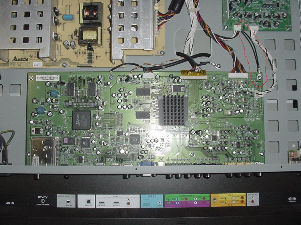

                      Incoming voltage to main board from left to right
                      PIN 1 L ON=0
                      PIN 2 PWDLM=1.2
                      PIN 3 (5VSB)=5.1
                      PIN 4 (5VSB)=5.1
                      PIN 5 (5VSB)=5.1
                      PIN 6 GND=0
                      PIN 7 GND=0
                      PIN 8 GND=0
                      PIN 9 GND=0
                      PIN 10 GND=0
                      PIN 11 (12V)=11.9
                      PIN 12 (12V)=11.9
                      PIN 13 (12V)=11.9
                      PIN 14 PWR ON=5.1

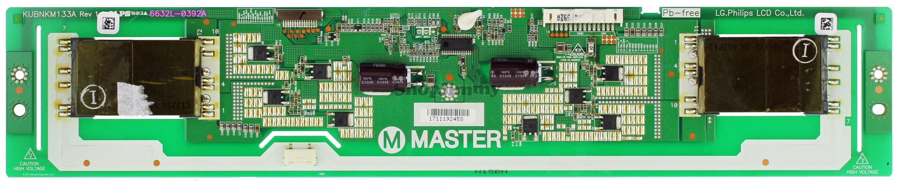

                        #31

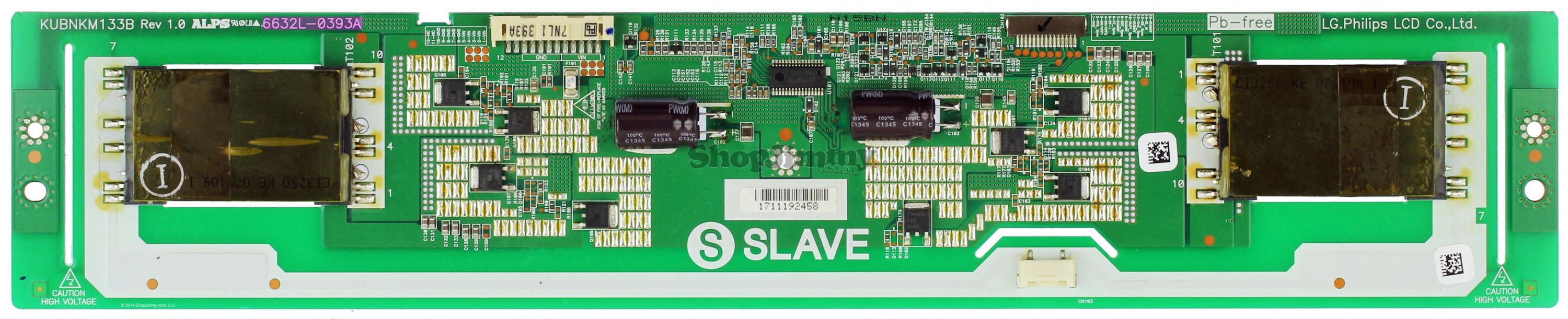

                        Can I see the pictures of the inverter board?
                        BTW, these must be your erro in the readings:
                        CN3:
                        PIN 11 A=1.3
                        PIN 12 B=0
                        PIN 13 C=0
                        CN5:
                        PIN 12 A =5.4
                        PIN 13 B=1.2
                        PIN 14 C=0
                        Pin A on CN3 is directly connected to Pin A of CN5.
                        Pin B on CN3 is directly connected to Pin B of CN5.
                        Pin C on CN3 is directly connected to Pin C of CN5.
                        So there is no way you can have different readings between the CN3 and CN 5.

                          #32
                          Here are the inverters, hopefully the pics turn out. As soon as I get home I will revisit those voltages and report back. Thank you.
                            #33
                            So far you readings look to be OK.
                            So you have MASTER/SLAVE Inverter setup.
                            Are the fuse on both inverters OK?

                              Thank you for catching that. I checked the fuses on the master and slave inverter and they appear just fine

                                #35

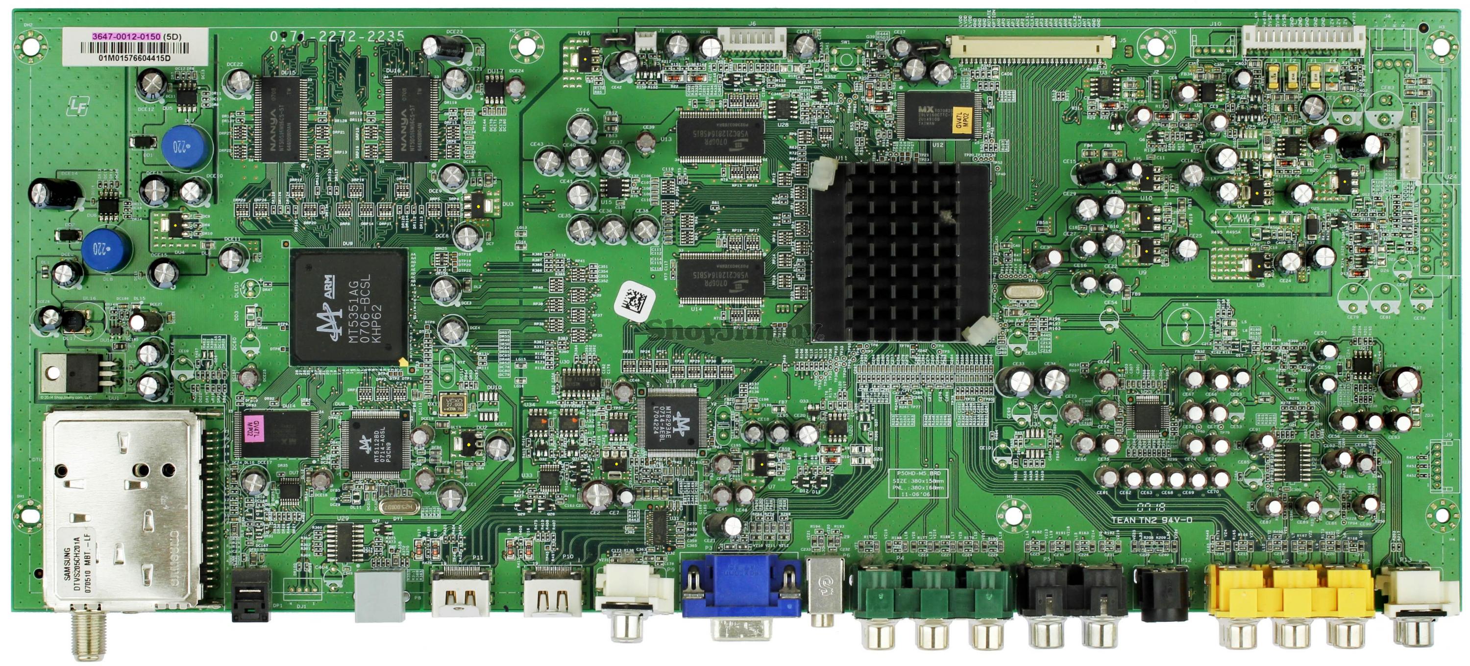

                                NickTV here is the picture you requested.

                                    #37
                                    Budm I just checked and rechecked then checked again it is indeed .03 and funny you mention pin 12 on the master because I was checking on this earlier and that voltage is 0. The voltages for the both master and slave are as followed
                                    Master CN1
                                    14 lamp st =0
                                    13 vbr_b=1.3
                                    12 on/off=0
                                    11 vbr_a=
                                    10 gnd=0
                                    9 gnd=0
                                    8 gnd=0
                                    7 gnd0
                                    6 gnd=0
                                    5 vin=25
                                    4 vin=25
                                    3 vin=25
                                    2 vin=25
                                    1 vin=25
                                    fuse shows continuity and has a voltage of 25.2 on both sides
                                    Slave CN101
                                    1 VIN=25.5
                                    2 VIN=25.5
                                    3 VIN=25.5
                                    4 VIN=25.4
                                    5 VIN=25.4
                                    6 GND=0
                                    7 GND=0
                                    8 GND=0
                                    9 GND=0
                                    10 GND=0
                                    11 NC=0
                                    12 NC=0
                                    fuse shows continuity and has a voltage of 25.5 on both sides
                                      #38
                                      OK, that is why the backlights are not ON, you still do not have BL-ON signal from the main board.
                                      So 'B' is the BL-ON pin on the power supply board.
                                        #39
                                        Next step will be to check all the DCV on all 3 pins of the 1117 series LDO regulator ICs on the main board to see if they are all OK OR NOT.
