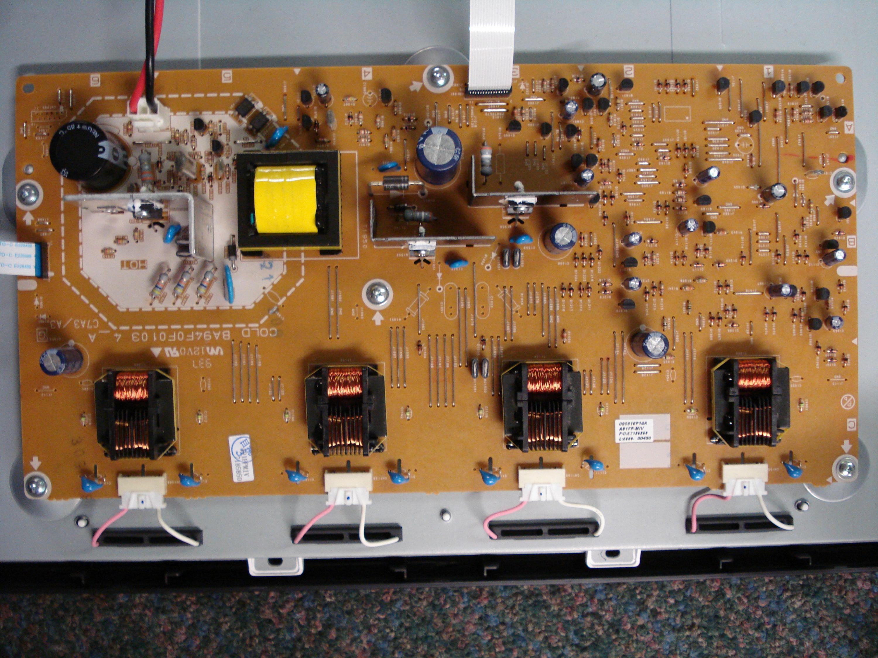

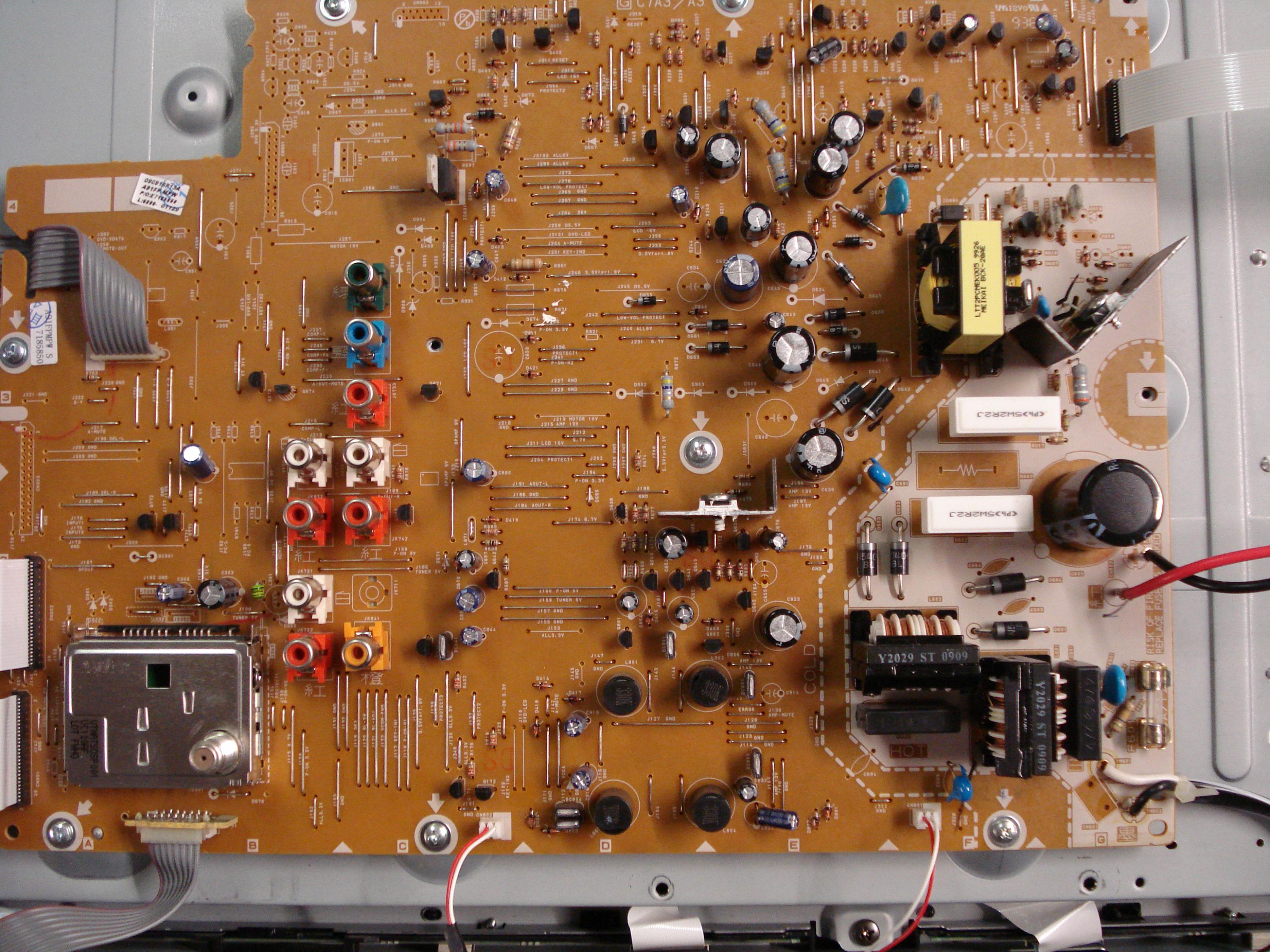

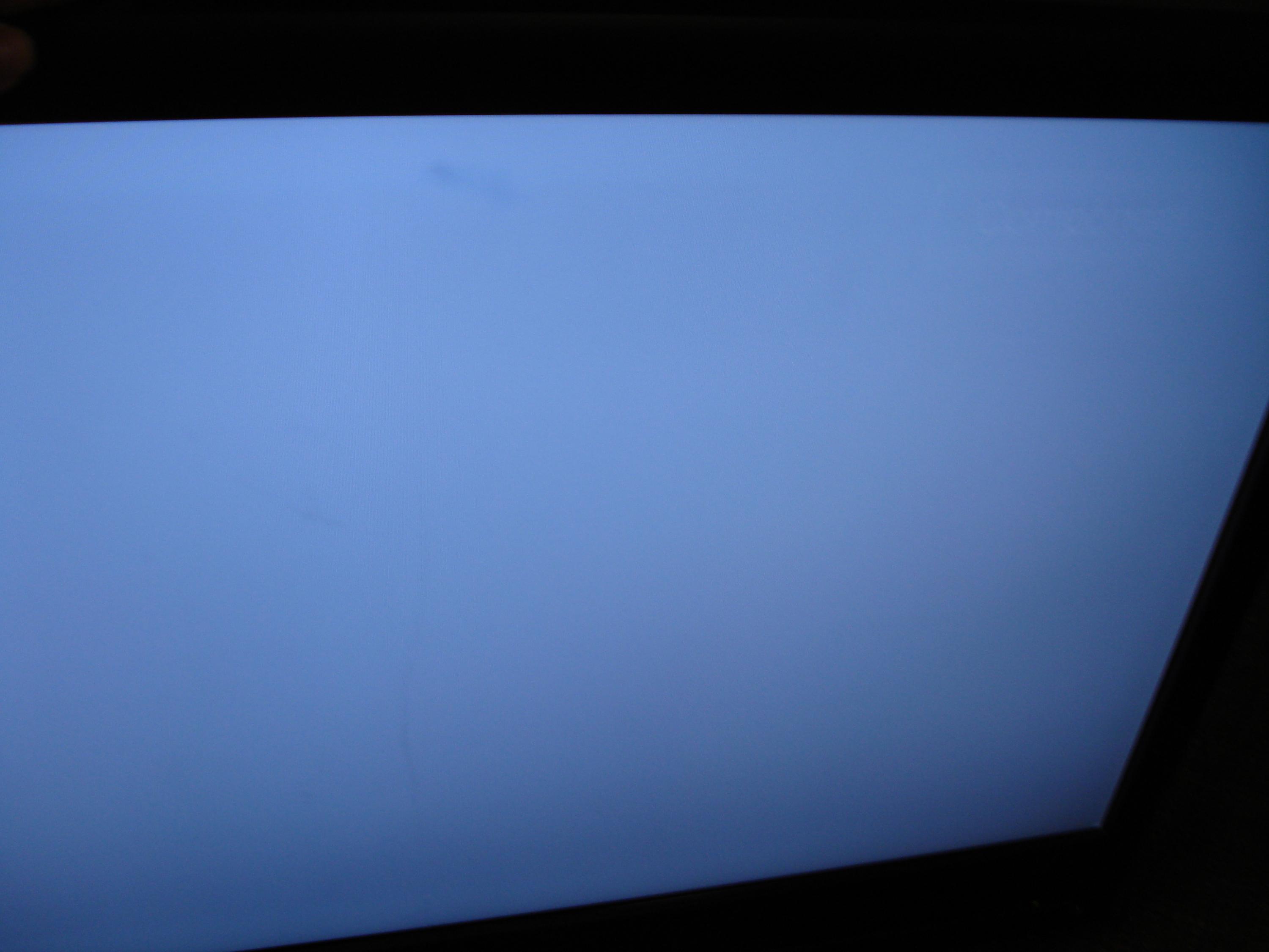

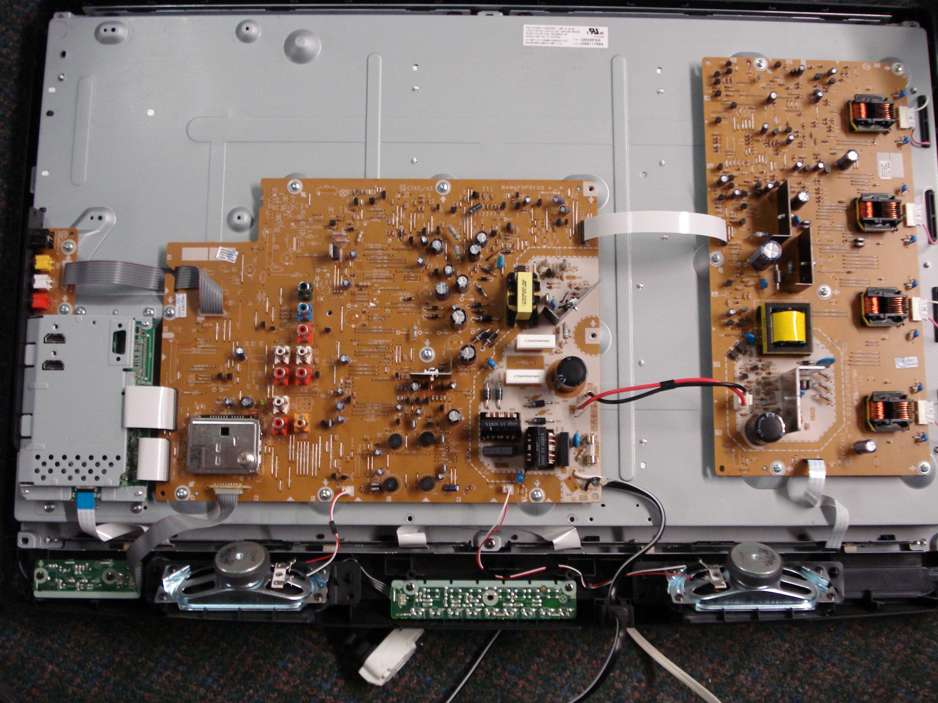

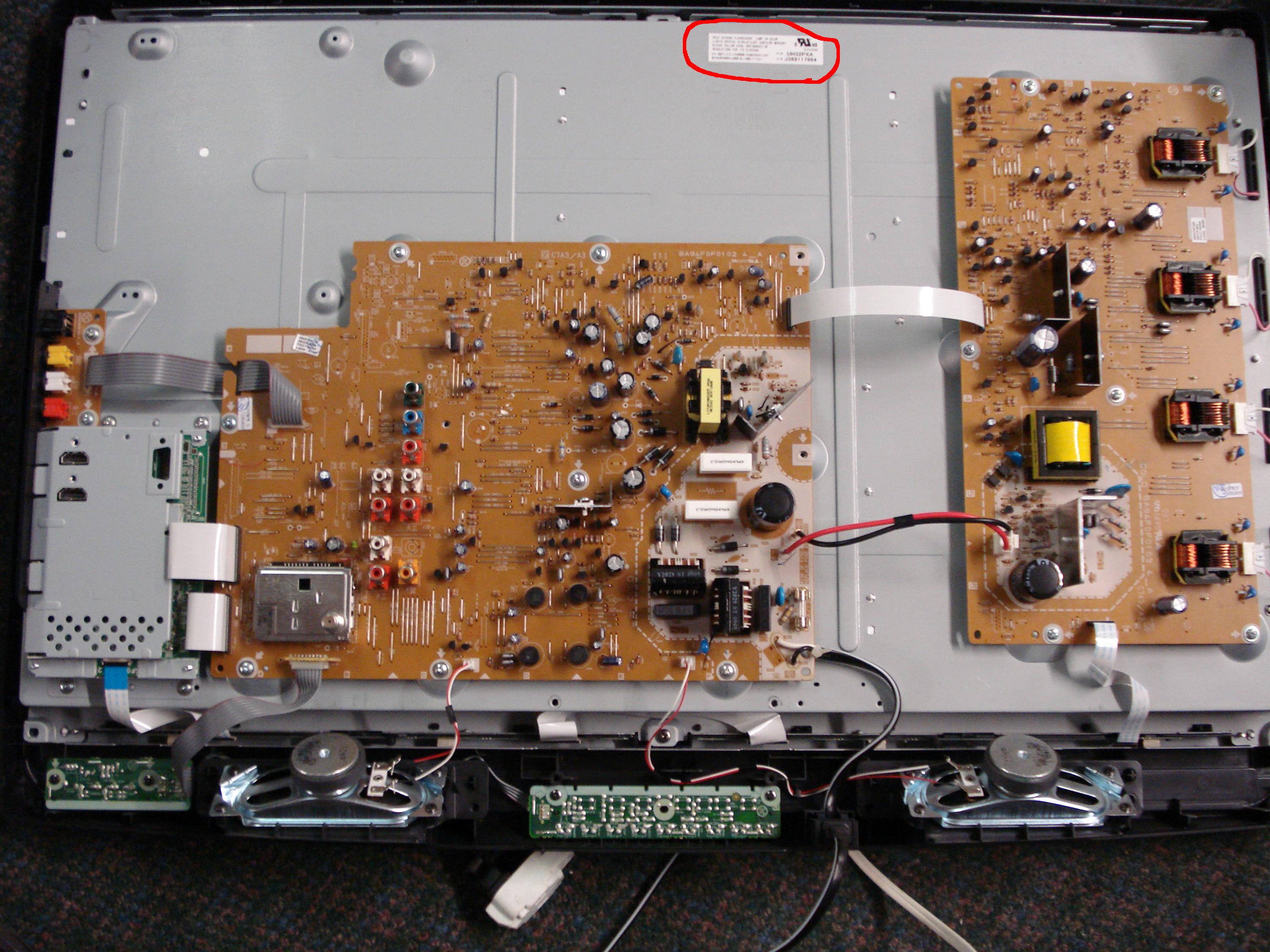

    Here is a couple of pictures. TV is on with white screen and stay white.
    Please help.

    Any sound? Can you see a picture behind the white screen?

      No sound. Control buttons don't have any effect.

        Re: White Screen on Emerson LC320EMXF 32" 720p HD LCD Television
        I had a monitor do this to me. It was the ribbon between the tcon and the signal processor boards dislodged.
          If yo have no sound and white screen I would start with voltage checks and look into mainboard beind suspect
            There's no t-con on this (built into panel) so possible causes
            • loose ribbon as mentioned above
            • bad LCD panel voltages (the PSU board generates the various voltages for the panel on these crap Funai sets)
            • blown fuse on t-con panel board
            • bad LCD panel

              I was looking for loose ribbon first thing I opened cover. Can't find one.
              Bad LCD should have sound.
              That make either blown fuse on t-con panel (where is fuse?) or bad LCD panel voltages.
              Tom, do you think change PSU board ($45 on ebay) can fix the problem?

                It might fix the issue, but I'd like to figure out what's causing the exact fault first. Cannot find a schematic for the LC320EMXF though.

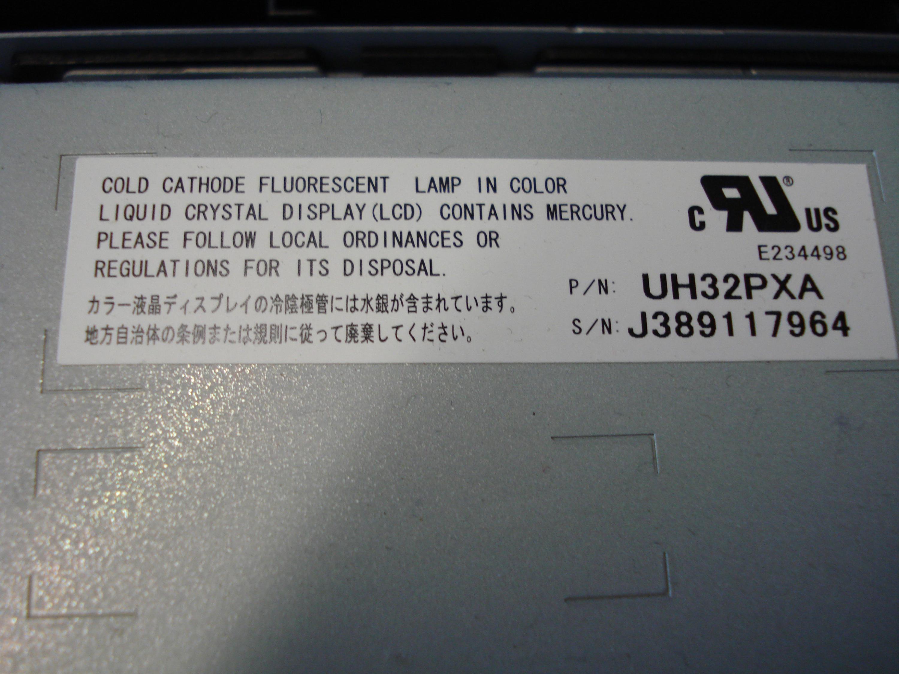

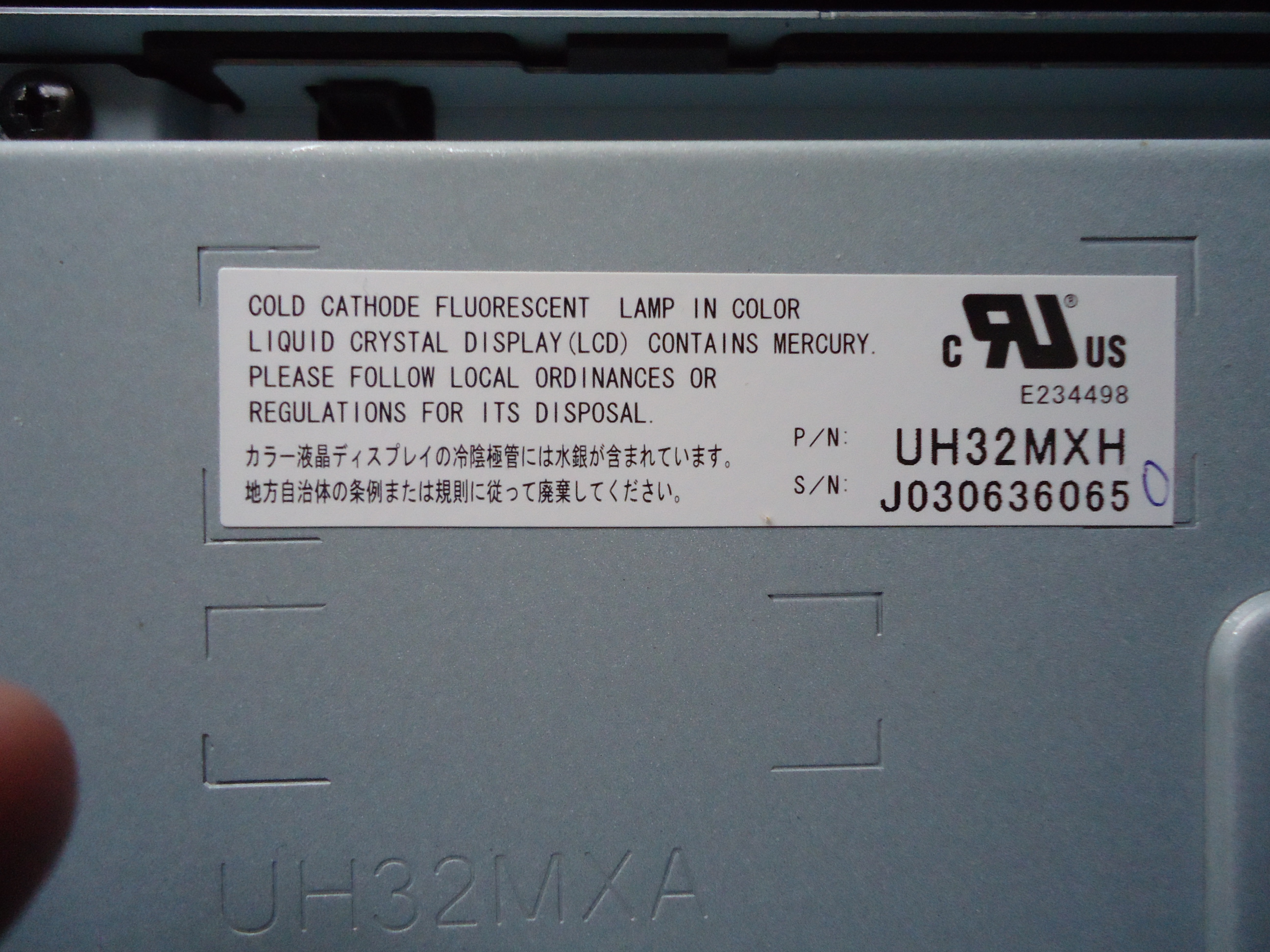

                  Can you post the panel model number? I can see the sticker on the top right but cannot read the numbers.
                  • jimmyking
                    • Sep 2008
                    • 32
                    Originally posted by budm
                    can you post the panel model number? I can see the sticker on the top right but cannot read the numbers.
                    ba94f0102 4_a
                        I found a working PSU board. It still gives white screen after exchanged the board.

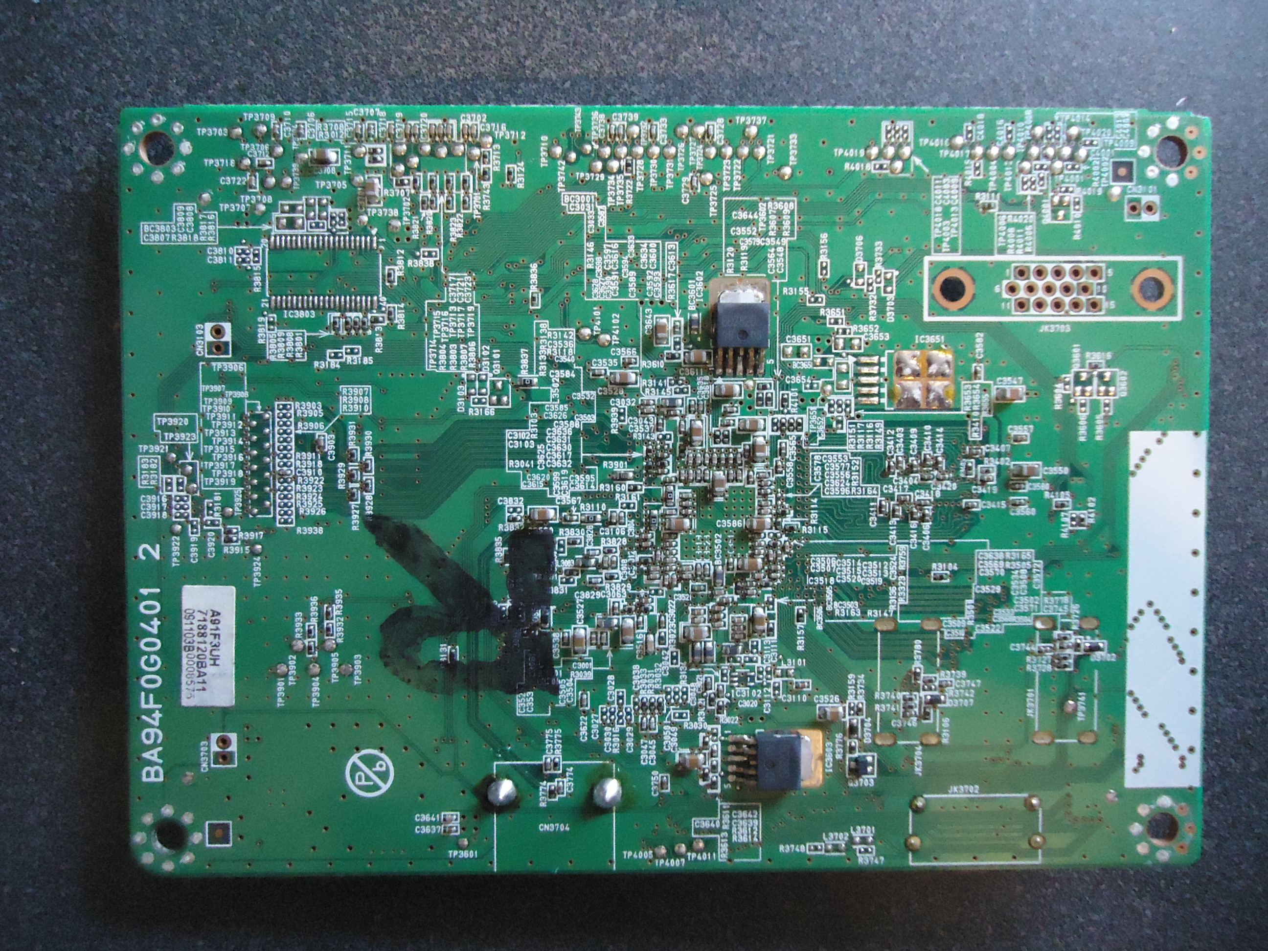

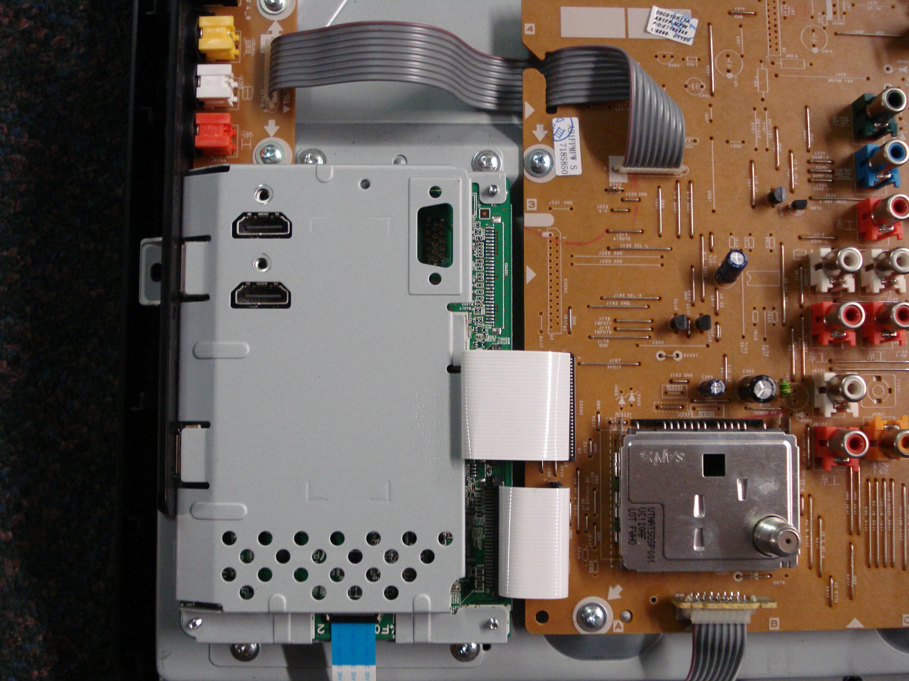

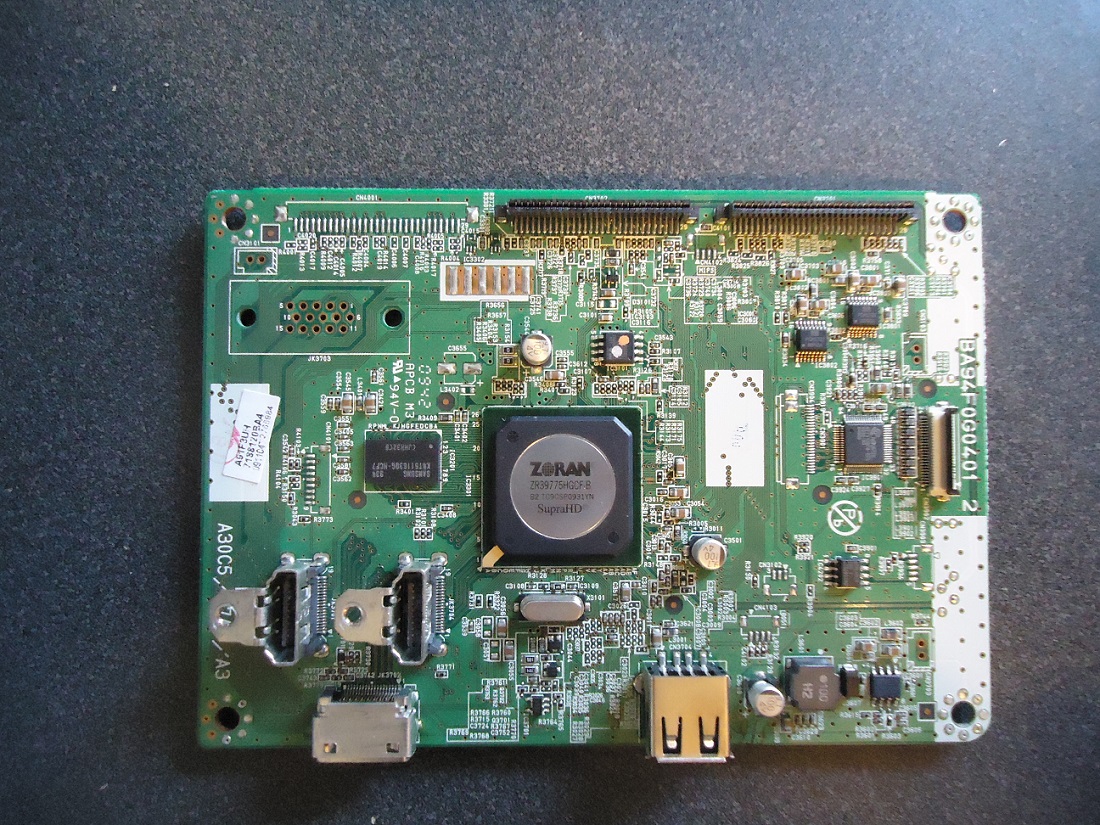

                          Here are a couple pictures of the so called t-com. I just don't know where or if it has fuses.
                            "ba94f0102 4_a" this number does not match the LCD panel.
                                Here is the model and panel numbers

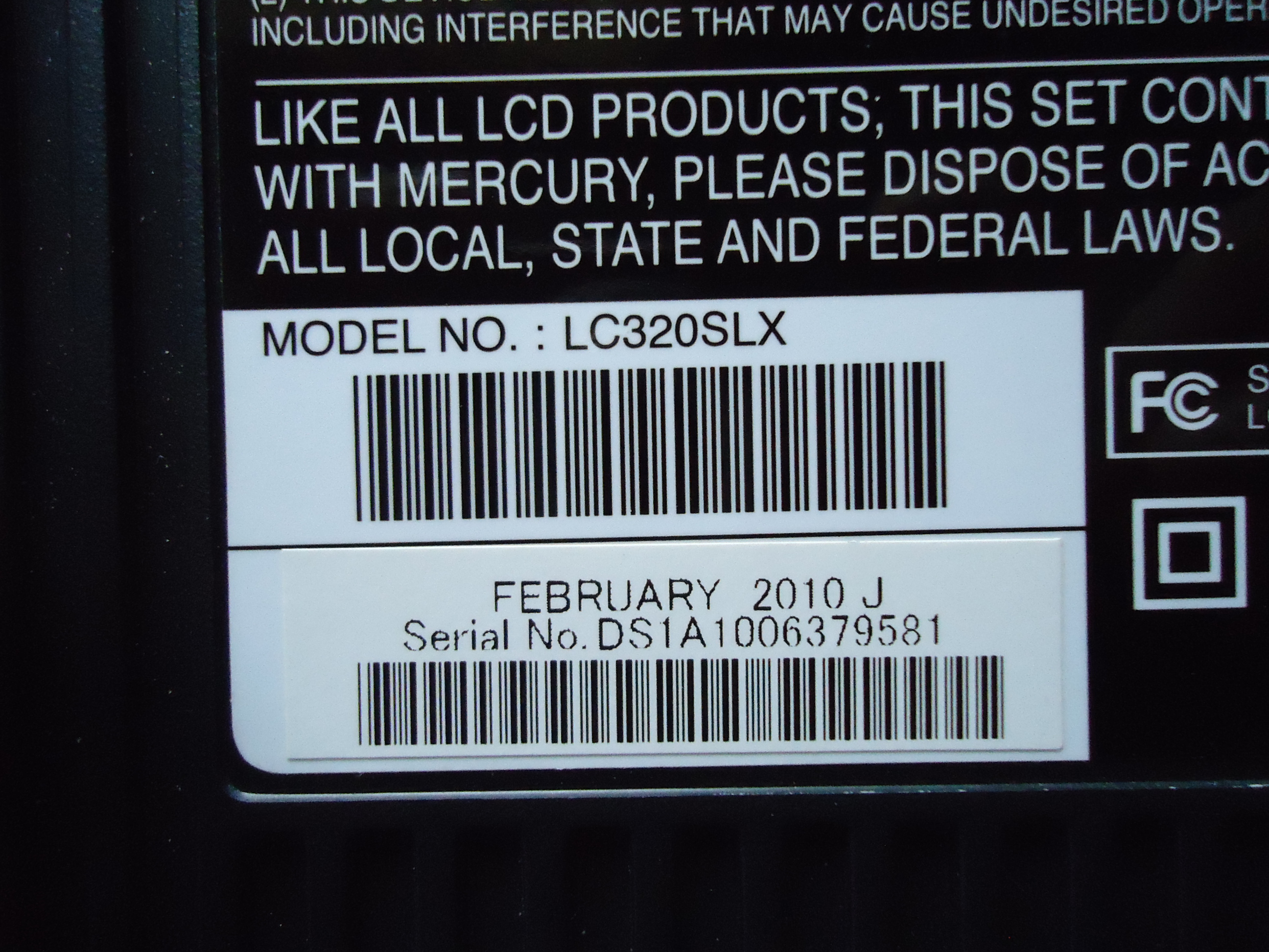

                                  LC320SLX Also has a white screen Mine is a sylv. model same inside different outside.

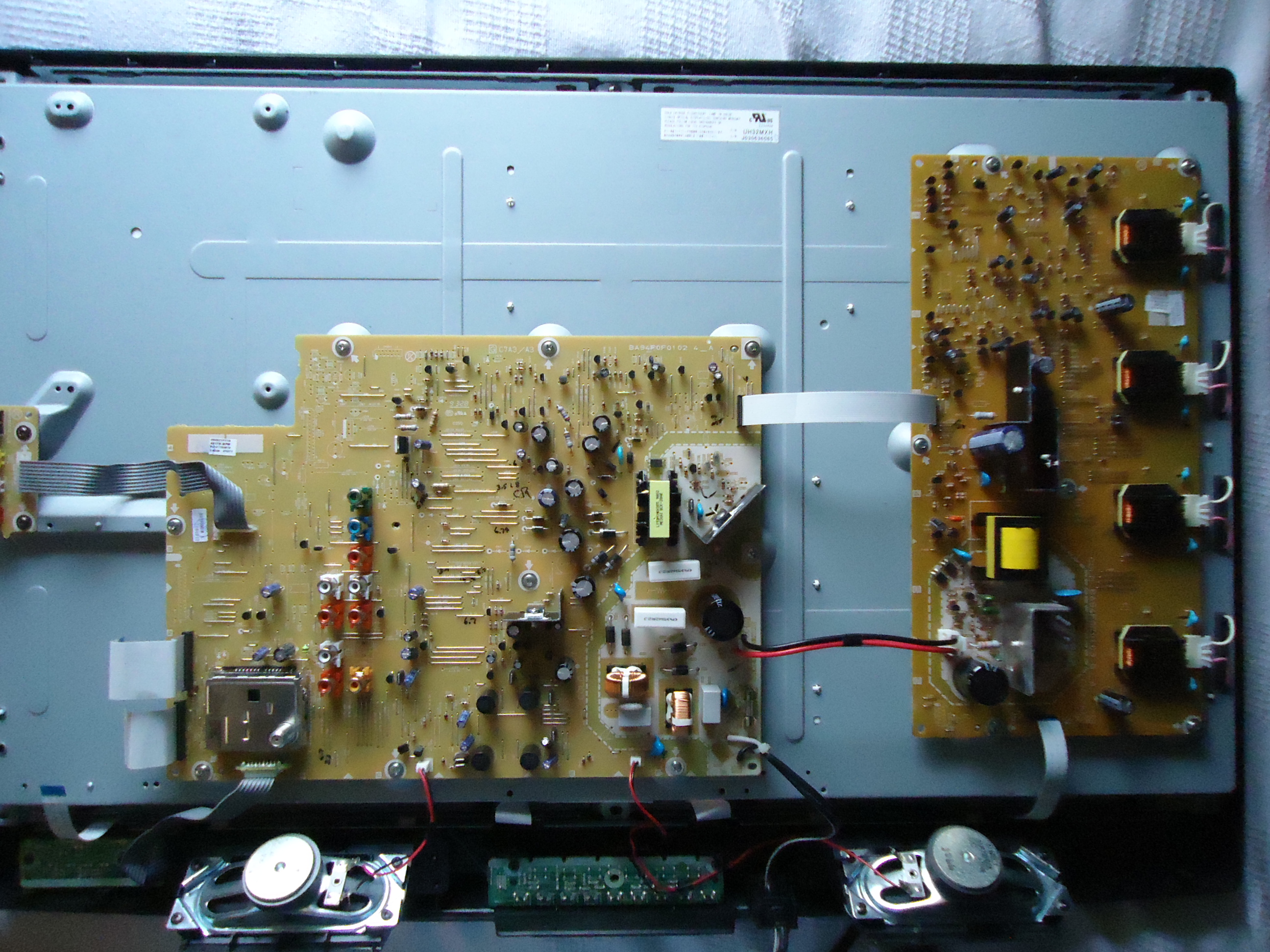

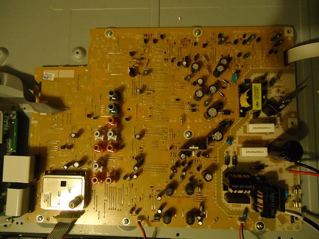

                                    More pictures of mine sorry same board I already posted .
                                    Last edited by splitcrete; 10-14-2013, 03:20 PM. Reason: different pic of same board
                                      So is there a fuse on the crap t-con
                                        Here it is.
