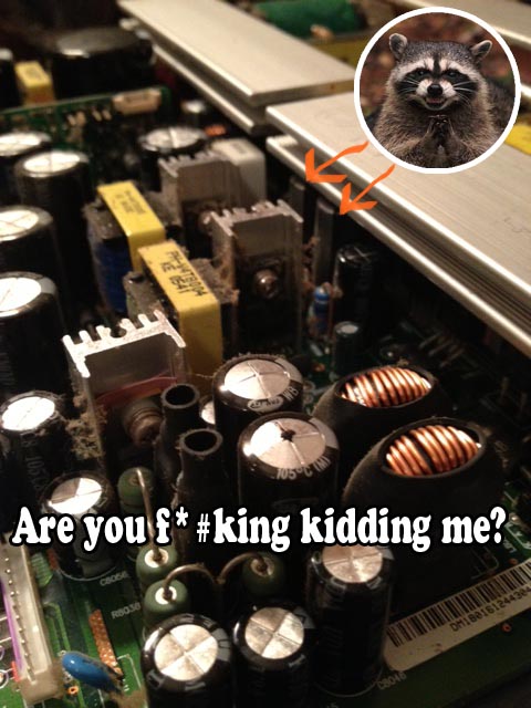

    My project of the week. A 50 inch Magnavox with the power supply problem. I'm a novice, but I'm starting to really like TV repair. Learn something new about it every day. I've fixed a handful of TVs with the same issue, and I've never run into this problem. 3 of the capacitors I need to replace are in a really tough spot!
    Of course the first thing I'm thinking is 'I've got to fanagel the new cap into a barely big enough space & bend the external wires 'just so' and try to move around things'. Then, I remembered I'm new at this, and there's probably a good way to do it that I don't know about yet.

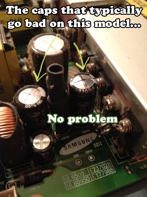

    The (2) 3300μf 10v caps that ususally go bad on this model, were bad. No surprise there.
    (2) Other 50v caps were also bad, still easy to change.

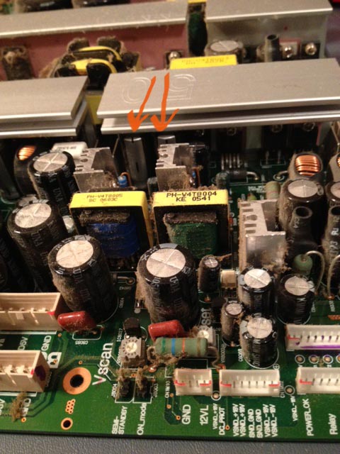

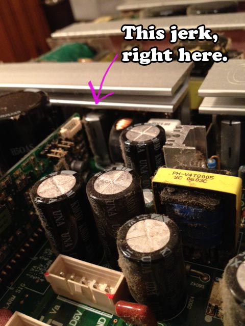

    Then, upon closer inspection, I notice (3) more gone bad, and they're sitting under heat sinks with a ledge. I can't even read them because of how they're turned, and all the crap in the way. How in the hell do you guys get to these?
    Take out obstructions like other caps in the way? I've never removed a heat sink, but is that what you have to do to get to them? The way it's set up is infuriating. I'm having another "I hate engineers" moment. Can anyone help a girl out? I need to fix this dustbucket this week!

    Big soldering iron on the heatsink legs after you have unscrewed the stuff attached to the heatsink ( good luck getting a screwdriver in there). Love the coon you may be able to rock them out from under the heatsink without removing it but its going to be a pita no matter what route you go

      Maybe you can bend the tabs on the heat sink up a bit to make some room.
        Re: Trouble getting to capacitors. Magnavox 50mf231D/37
        Just a note, if I ever were to encounter the engineer who did this, I'd be equally mad. It's a bad design from a repair aspect but also because those capacitors there will get a lot hotter than the others.

          I have replaced them before.Desolder the caps and they come right out. The problem. Is getting replacement caps that are not too tall. Take measurements of old caps and get close as possible. Observe polarity leave leads long and insert long leads through the PCB
          holes, solder and cut off the excess.

              I've done this on a similar model. First use a solder sucker and remove the solder from the bottom of the board. Then Loosen the wires with pliers and remove the caps. It's hard, but it can be done. Then measure the caps and find some high quality caps that will fit under the heat sink. Then replace the cap behind the other heat sink, keeping the long wires on. then the other one. it's hard but usually can be done. Otherwise you will have to remove the heat sink.

                BTY Tom, It was probably a bean counter that forced the engineer to do it!

                  Damn, I got all the caps out without too much trouble. I NEED one of those solder sucker things. Never used a desoldering braid before, but gave it a shot this time. Again, never before has the solder gone back in on me and closed the hole to where I can't fix it! I think this tv is just screwing with me, for real. Well, now I've got a few holes that are closed with solder, and the braid (for whatever reason) is giving me nothing but a headache. It was easier my way, wiggling the caps out while heating the solder. I should have just stuck with that. >sigh< just another learning curve I guess. This sucks. I tried pushing a small paper clip through while heating the surface solder and got two open, but damn.

                    A) replace ALL the caps, or you'll be back in there in less than a year.
                    B) Please tell me you aren't seriously considering using ANYTHING that Rat Shack sells as a replacement?!?!?!?
                    I wouldn't put anything less than UCC KY/KYA/KZE, Panny FM/FC, Nichicon HD/HE or Ruby ZL/ZLH/ZLJ under those heat sinks, the heat will roast anything else in a couple years.
