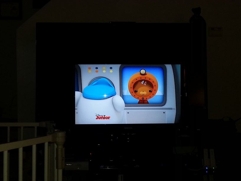

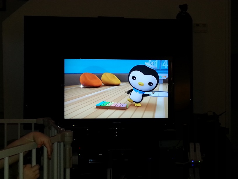

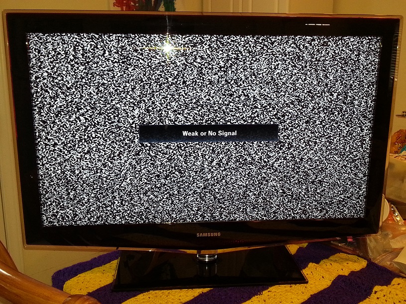

                          Re: Samsung LN40B650 Standby light on, won't turn on
                          New mainboard is in, and it looks *GORGEOUS*. My wife is already talking about wanting to replace the DLP with and LCD now. Speaking of the DLP, it's in the background of the second and third pics, and the third pic also contains the little hands that pressed the power button on the DLP for that last, fatal time. Now that I have the new mainboard, I'll tinker with pulling components off the old one and testing them to see what might have failed. Thanks again for all the help! If/when I'm able to figure out what went wrong with the old board, I'll post here and let you all know.
