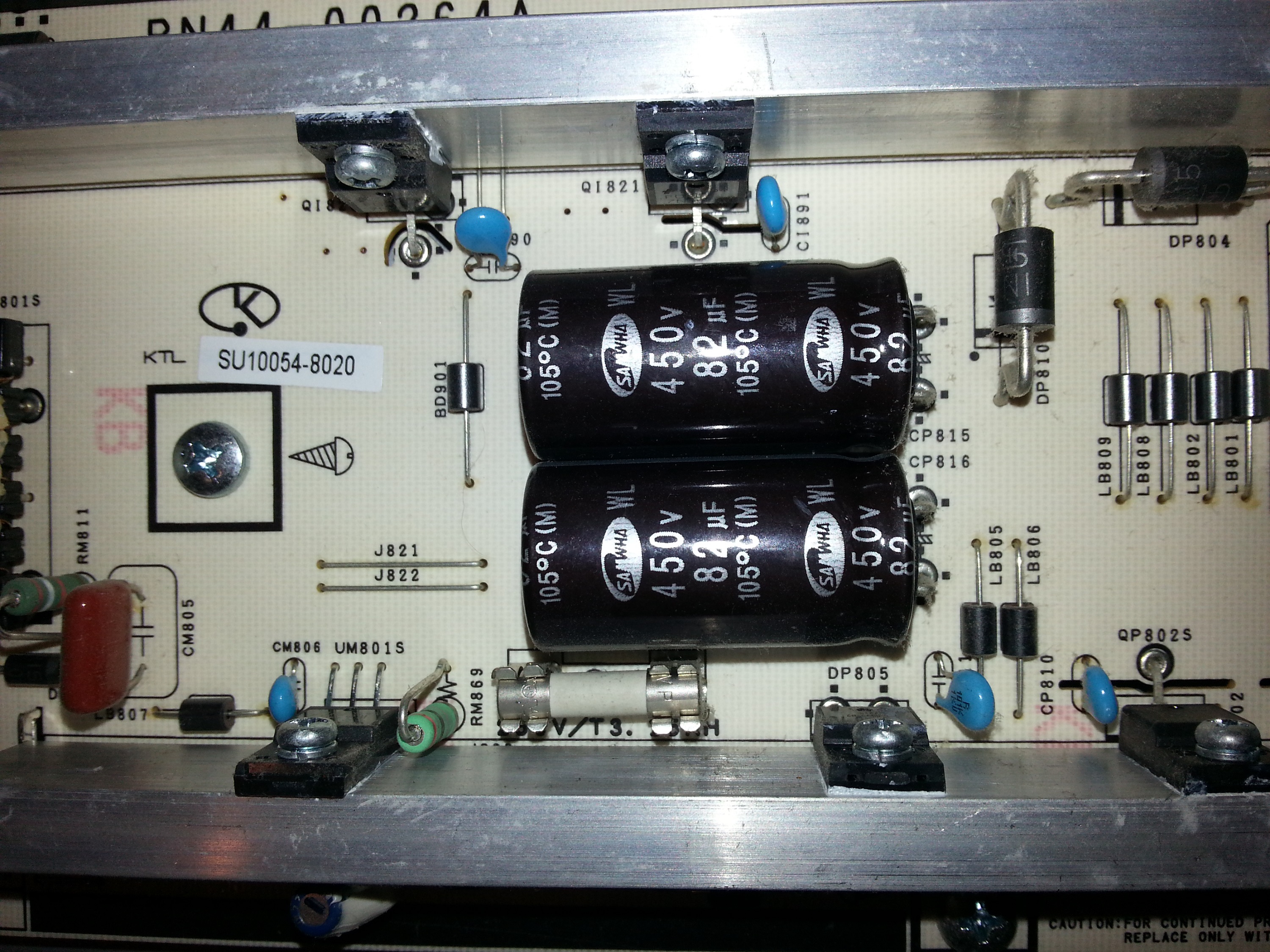

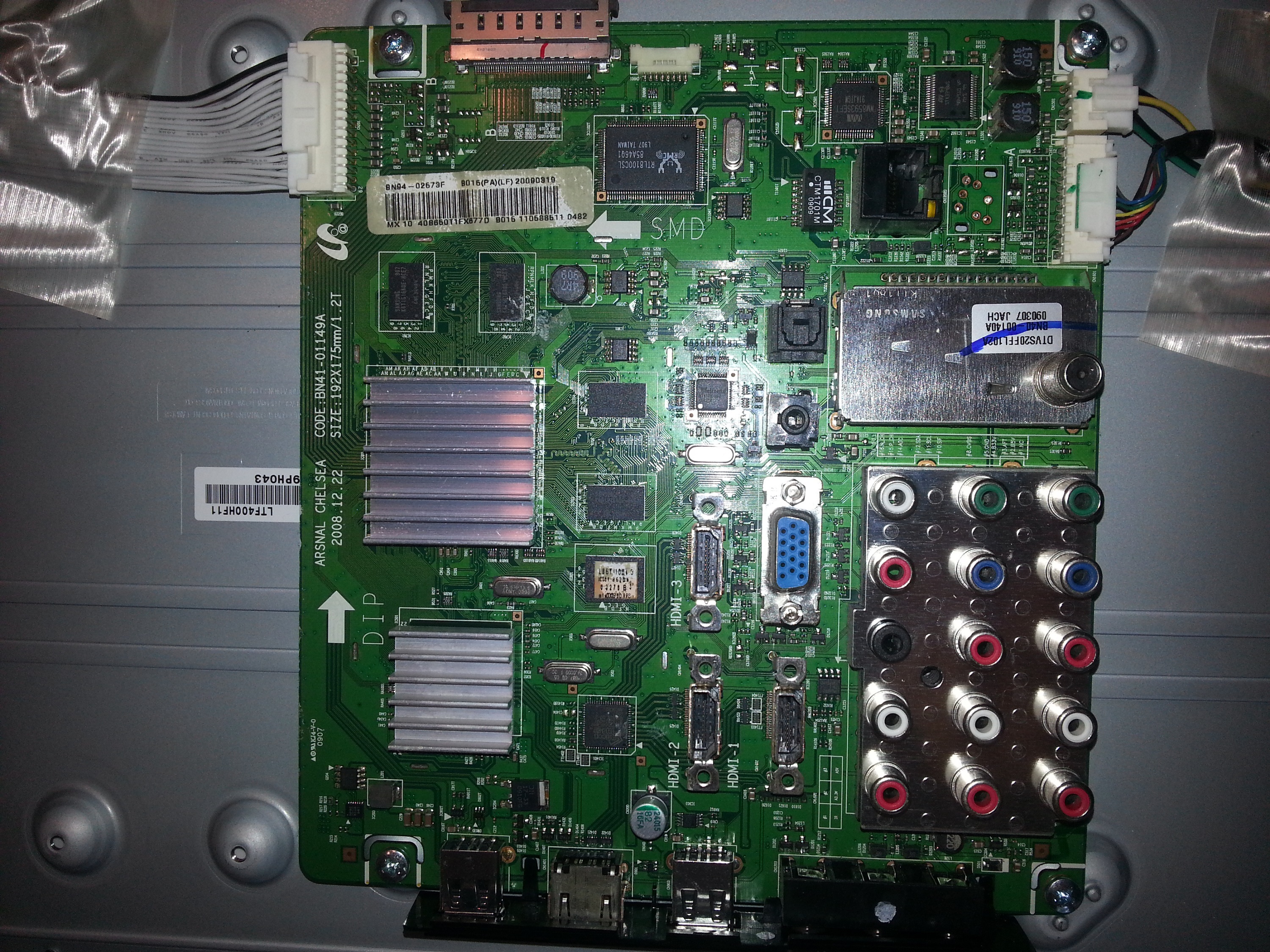

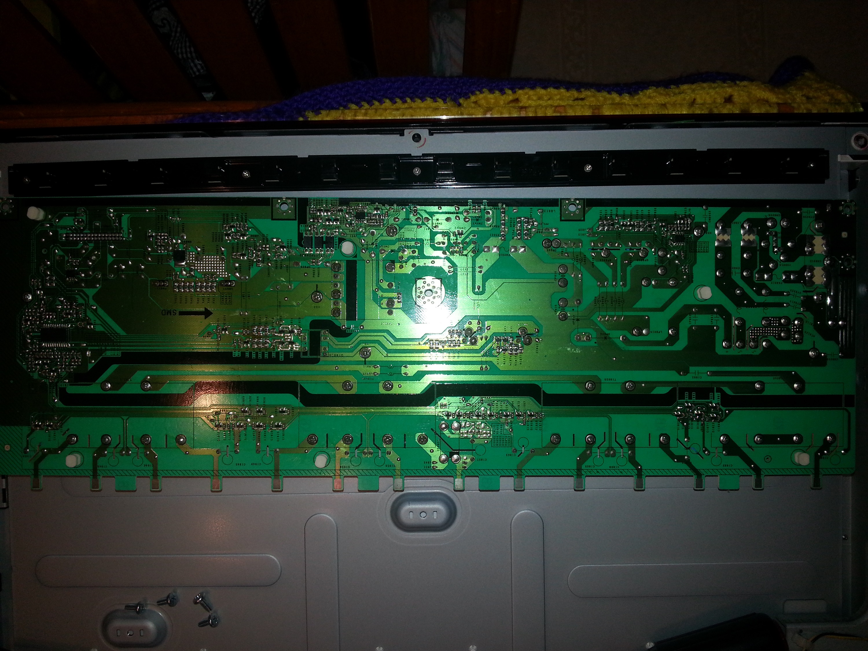

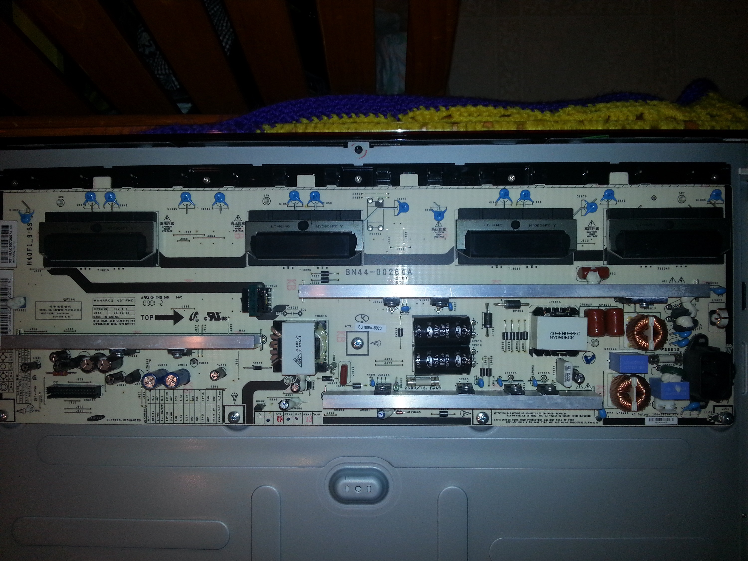

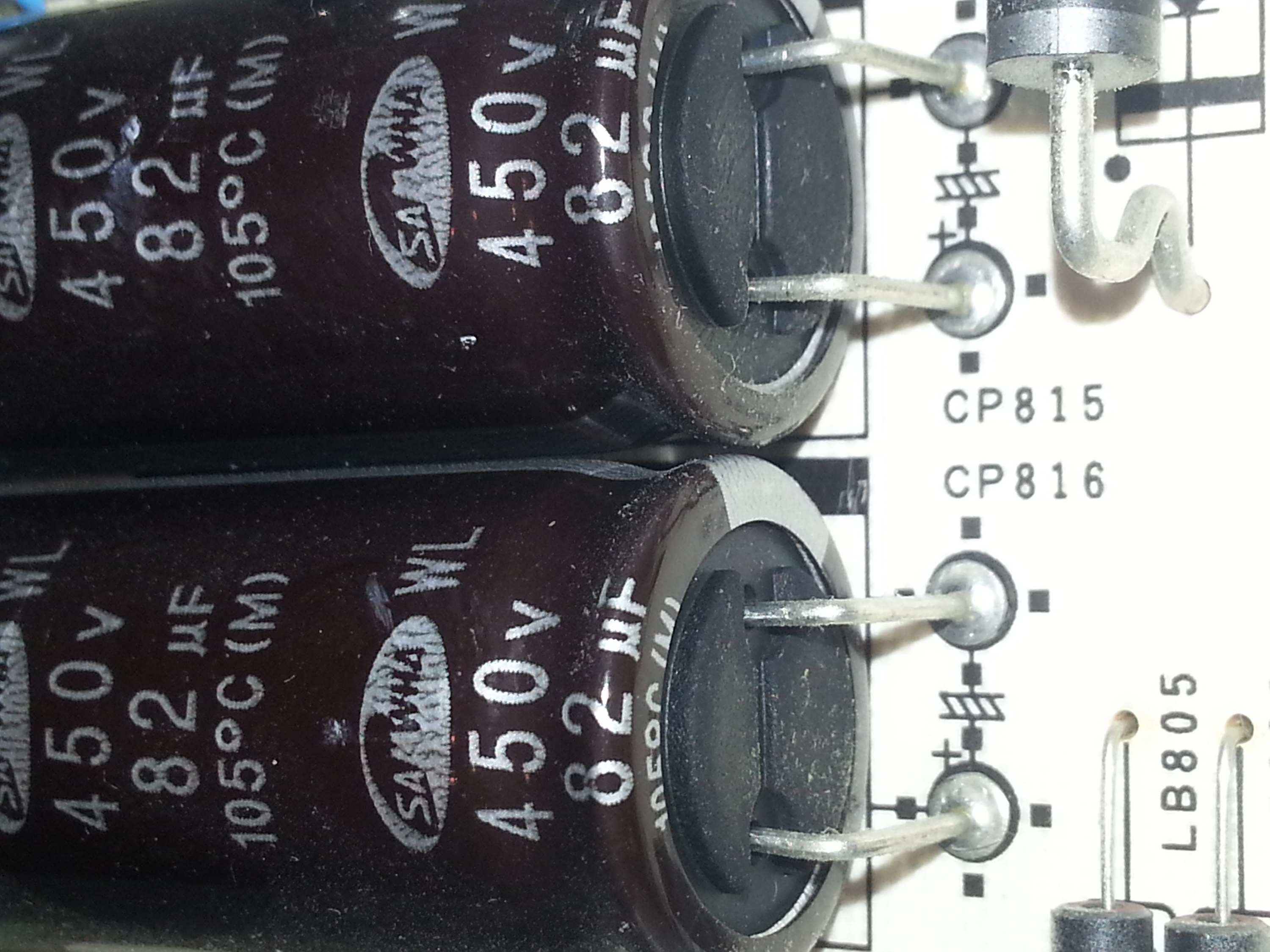

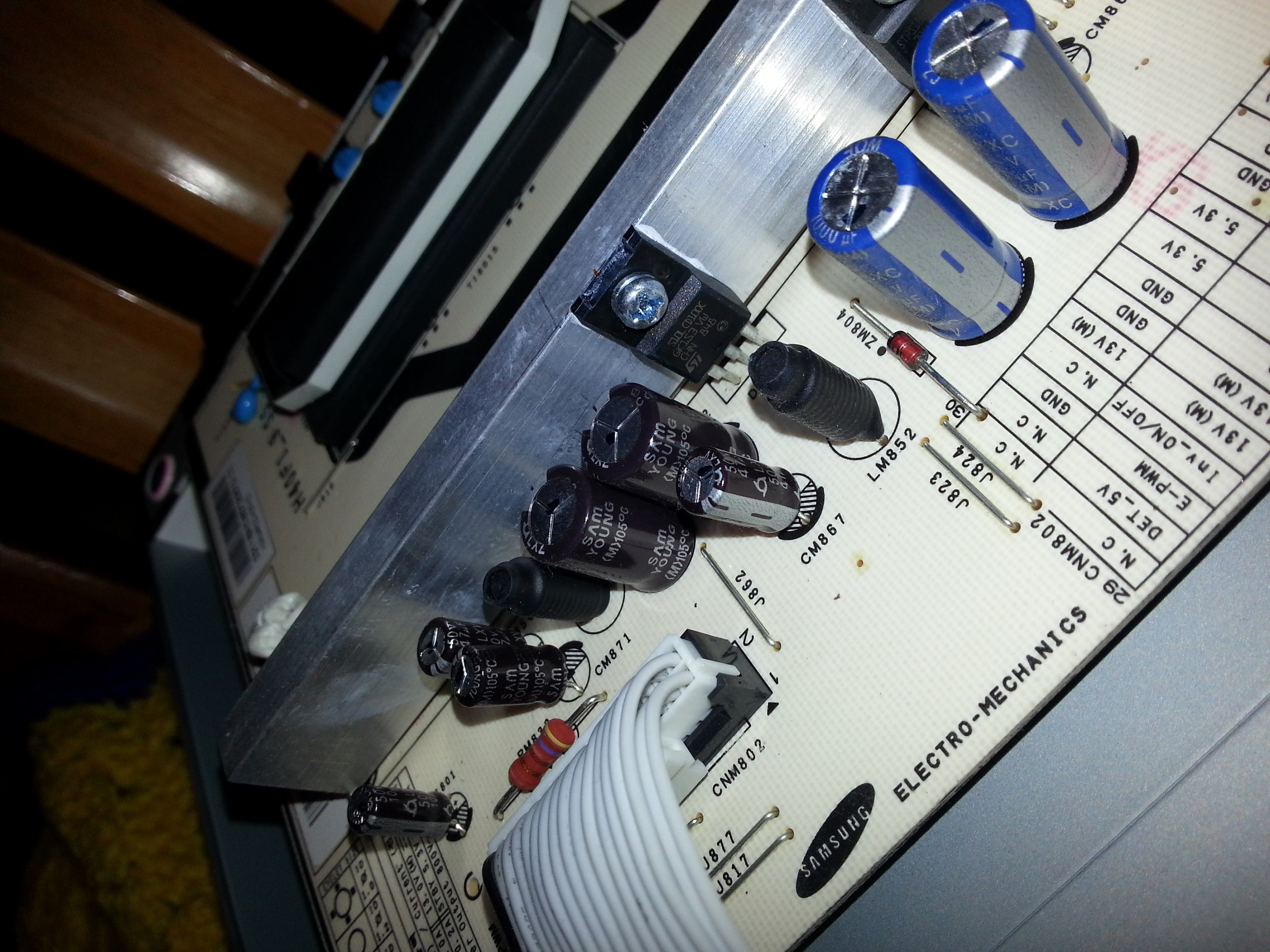

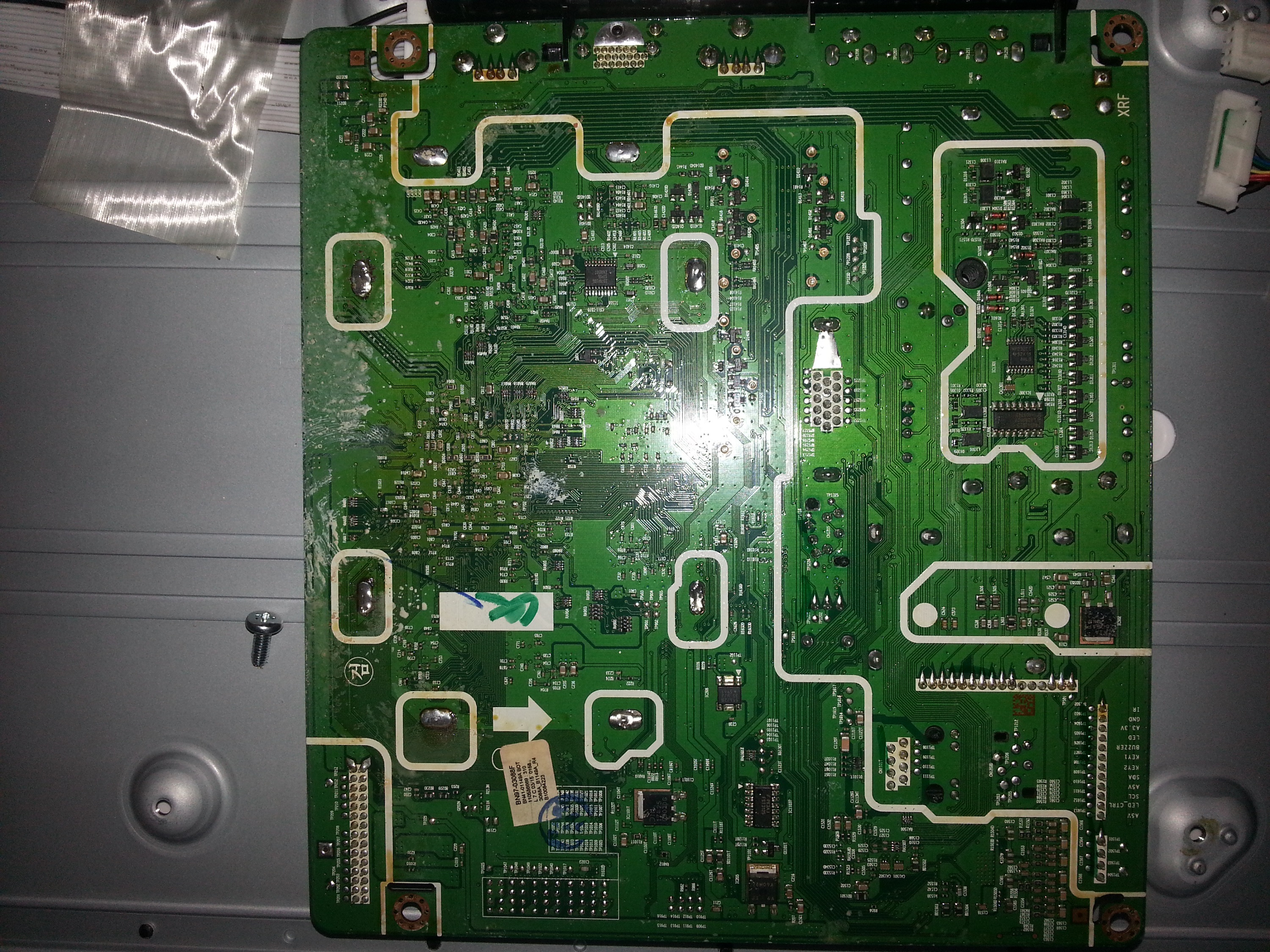

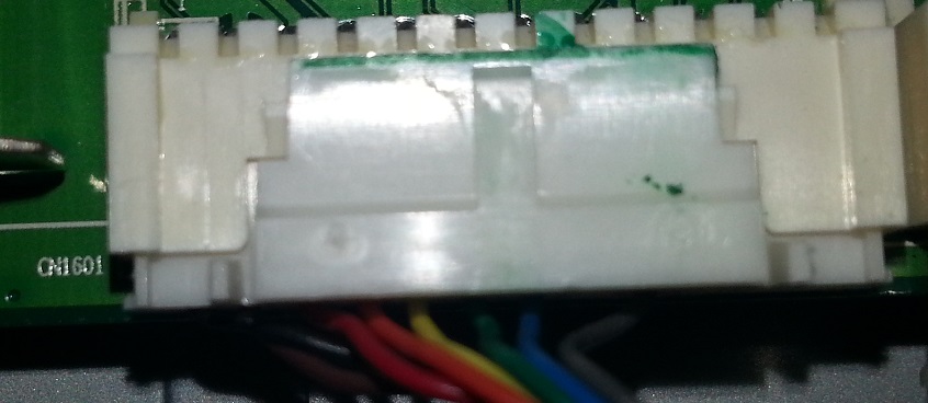

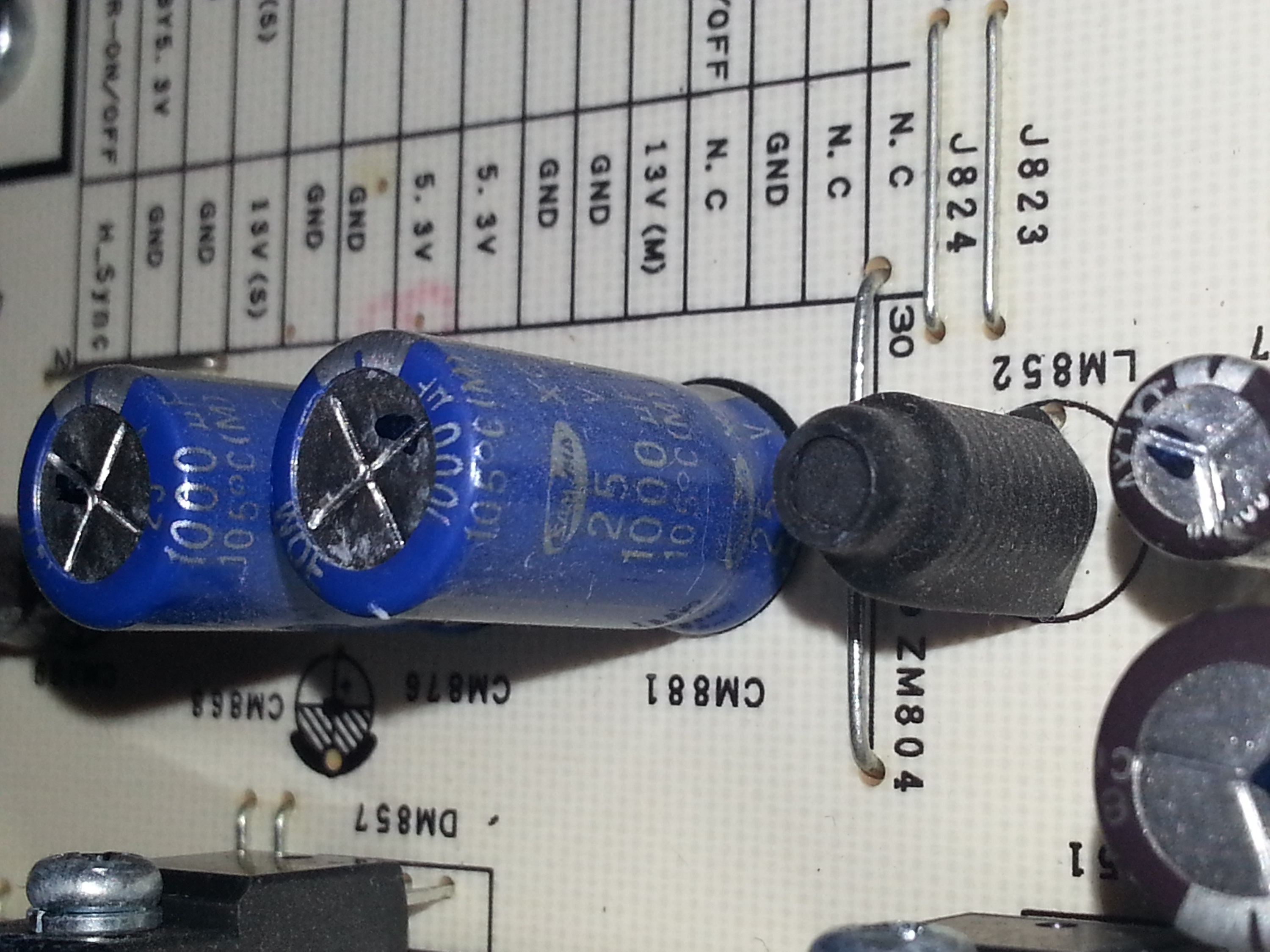

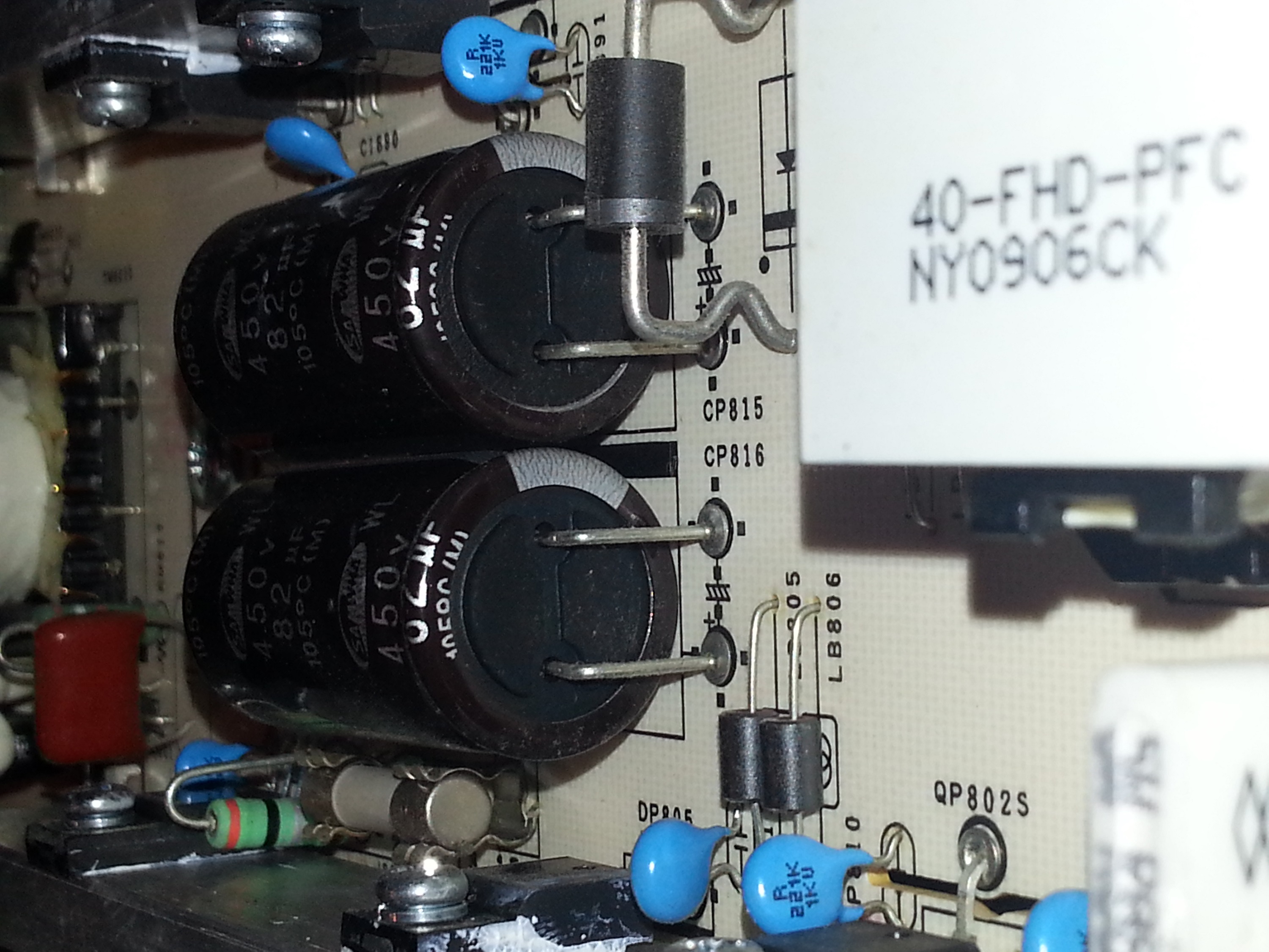

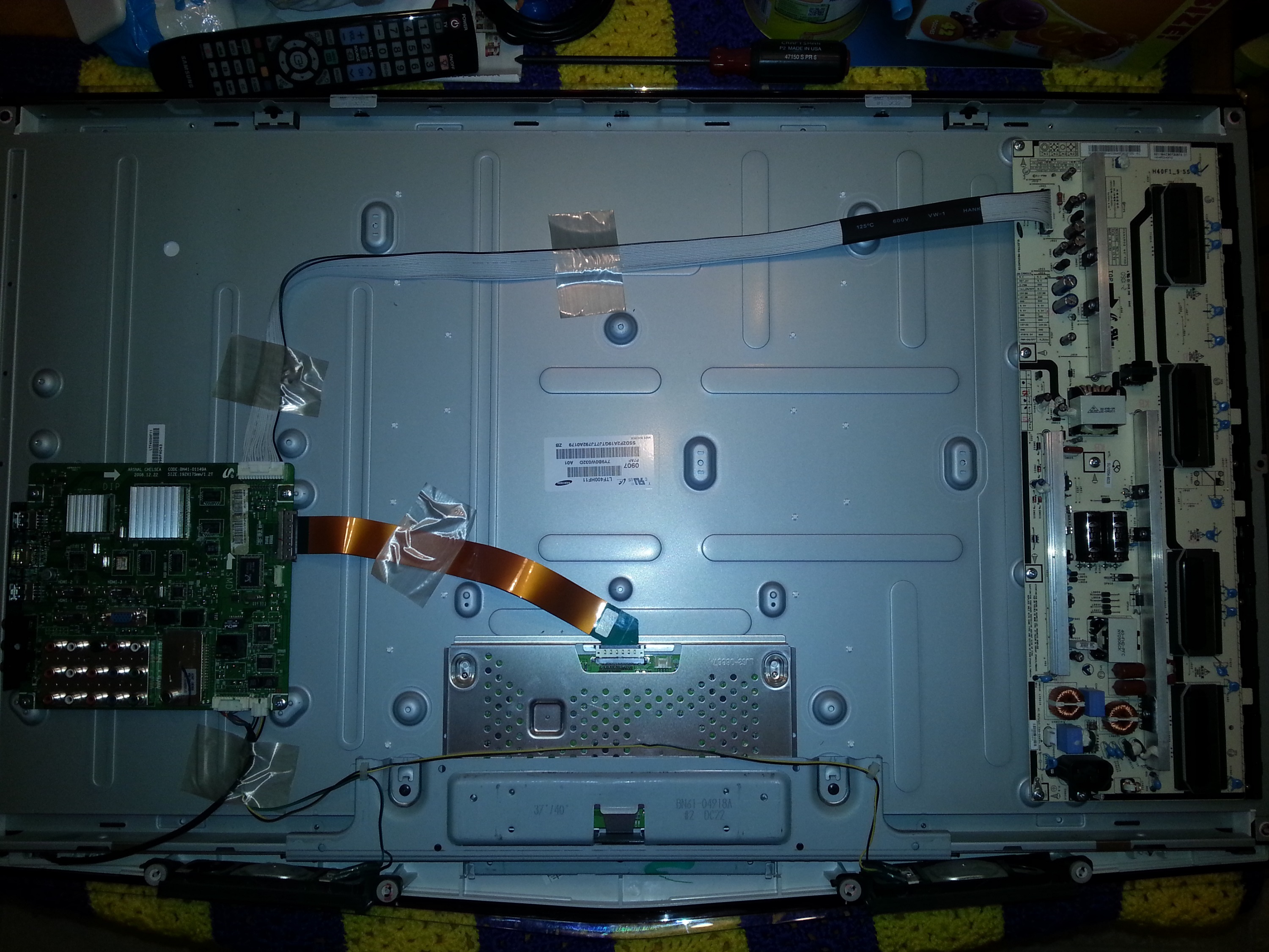

First time posting here. Trying to make ends meet for my family, and have some fun, so I started finding broken TVs on craigslist that I might be able to repair and resell. I picked up an LN40B650 that will not power on, the Standby LED comes on solid red when plugged in, and the TV does not respond to the remote or the power button. The guy who sold it said one day it just failed to turn on. I've opened it up and checked a few things, none of the caps are swollen as far as I can tell, but the bottom of the two 450V caps made me curious. I've checked both the fuses on the PSU and they are fine, I've checked all the diodes and resistors, and they seem fine as well. Since I am so new to this, I'm not really sure where to go next, but I'm open to direction
The power supply board is labeled BN44-00264A. I've included some of the pictures I've taken, please let me know what else you might want to see. I should also note, the only tools I have available are a digital multimeter that does not include a capacitor test feature, a soldering iron, standard tools like screwdrivers, my brain, and a willingness to learn.
