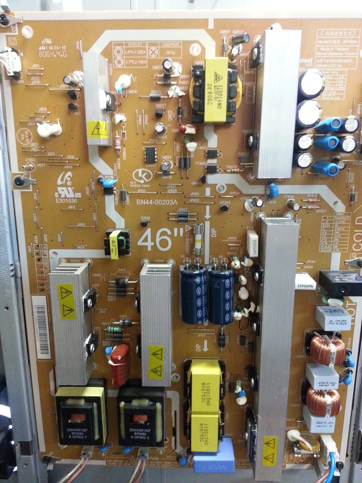

                          Today I have put a small(turbo) fan close to the main board and it did not turn off. There is another metal cover that should be over these boards and at one point there is a heat transfer sponge like material, but I don't think that it would matter that much.
                          I have took a picture with the board, still mounted.

                            384V stays on, when the picture goes out.

                                Re: Samsung LN46A650 backlight turns off after a while
                                Where is this heat transfer pad?
                                  Which one?
                                    PSU SCH
                                      I'm not home now, but I remember that there is only one small sponge like transfer pad somewhere in the middle of the cover which covers the PS and mainboard PCBs.
                                      I belive that the heat transfer pad is for the mainboard. I will ckeck it when I'm home.
                                      There are at least two processors that run around 55 *C and they don't have any heat sinks.
                                      • tibimakai
                                        • Jan 2012
                                        • 3680
                                        The main processor on the main board, has a heat sink on it and the heat transfer pad is between the heat sink and the metal cover.
                                        I have replaced that sponge like heat transfer pad, with the other "wet" type and it didn't fix the issue.
