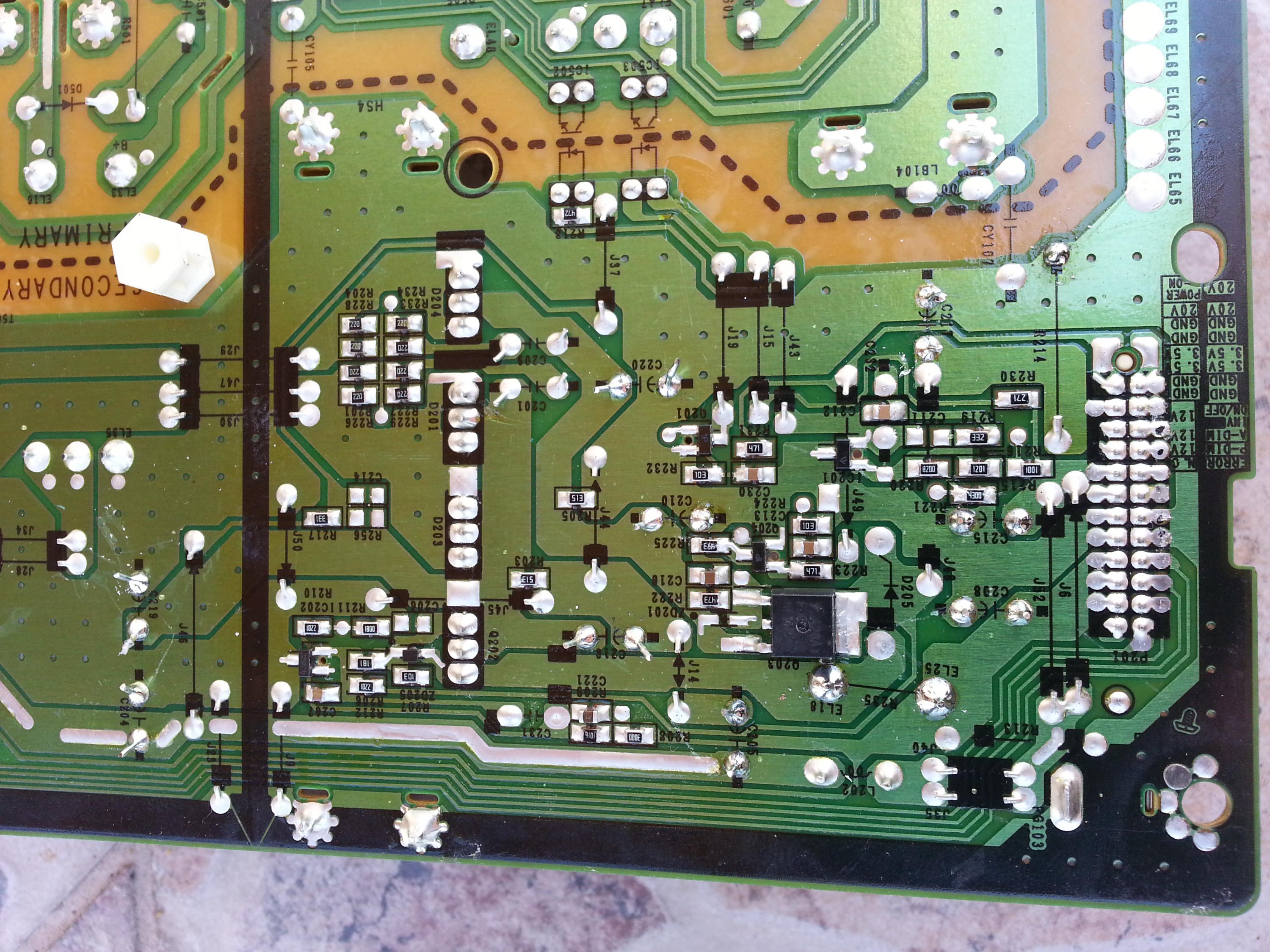

                  Re: LG 42" LCD 42LD550 will not turn on or turns itself off/on
                  Hi
                  Have problems with the power supply.
                  Burn safety!
                  A quick test I did locate a zener shorted the ZD503.
                  I do attempt to find the service manual of the power supply and can not find anything!
                  have no idea?
                  The code board is PCB: EAX61124201/15 REV 1.2
                  Thank you
                  edit:
                  hi
                  returns on the problem.
                  change the STRW6053N and the zener 5.1 volt.
                  not burn safety but now, than are measured at the terminal (CONNECTOR) board I only have 3.5 volts.
                  12, and 24 volts I have not!
                      Originally posted by tom66
                      Location of the zener - if it is on VCC pin of the IC, 5.1V is unusually low.
                      hello.
                      measurements on capacitors CONNECTOR exit, and see that I have measurements kanonika.gia example measures 12 and 20 volts.
                      c205=3,5v
                      c218=13,4v
                      c210=20v
                      c220=20v
                      c215=3,5v
                      c208=?
                      c217=?
                      c219+13,4v
                      c204=3,5v
                      But CONNECTOR not, count only the 3.5 volts.
                      I suspect that is the Q203(FDD5614P) shows up in photo
                      What do you think?
                      And one last thing
                      Domestic to make the measurements,
                      The PCB of the power supply must I connected with the main board of the television, or does not matter?
                          The one i am working on when turned on the red led will blink at slow rate and nothing else happens.
                          All voltages are ok appart from the 3.5V that appear to be 3.3V.
                          I suspect mainboard problem but again 3.3 is low...
                                        Had the same problem with an LG 32ld750 TV.
                                        The zener is not shorted, it has a 0.1 Ohm Resistor in parallel. Really!
                                        Changed the STRW6053N anyway and the TV is working again!
