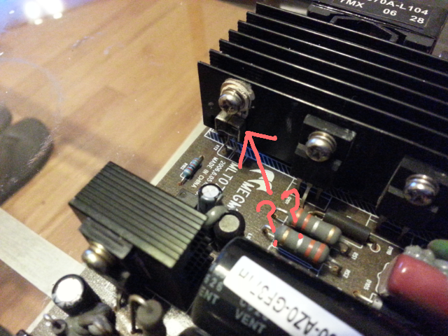

      i think 2 of the mosfets are shorted
      as soon as i get a dmm i will post readings
        Re: Polaroid flm-3732

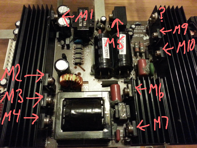

        Ok I tested every fet which I think is a fet
        I took 2 sets of readings
        1st set is with the negative probe on number 1 leg
        2nd set is with positive probe on number 1leg
        Basically i just reversed probes because i was getting different readings
        Here are the readings in diode mode
        M1
        1-2: 0.549 and continues to go up
        2-3: 0.152
        1-3: 0.000
        Test leads reversed
        1-2: 0.152
        2-3: 0.152
        1-3: 0.000

            So what DC voltage do you get on that large cap? That will be the first place I check after checking to see if it has blown main fuse first.
            Some pictures here:
            http://s807.photobucket.com/user/bud...?sort=3&page=1
              Both fuses on psu are good
              Which is the main cap?
              Is it one of the large caos on its side?
                The two big one laying side way, measure right at the two legs.
                If you do get 160~170vdc, then check and see if you do have 5V STBY at the 5V pin of the connector.
                  Ok so the tv powers on and panel comes on
                  I did get 167v at both caps
                  Im guessing either the spilled over solder from the previous repairs was causing it not to power on or there was an improper connection somewhere

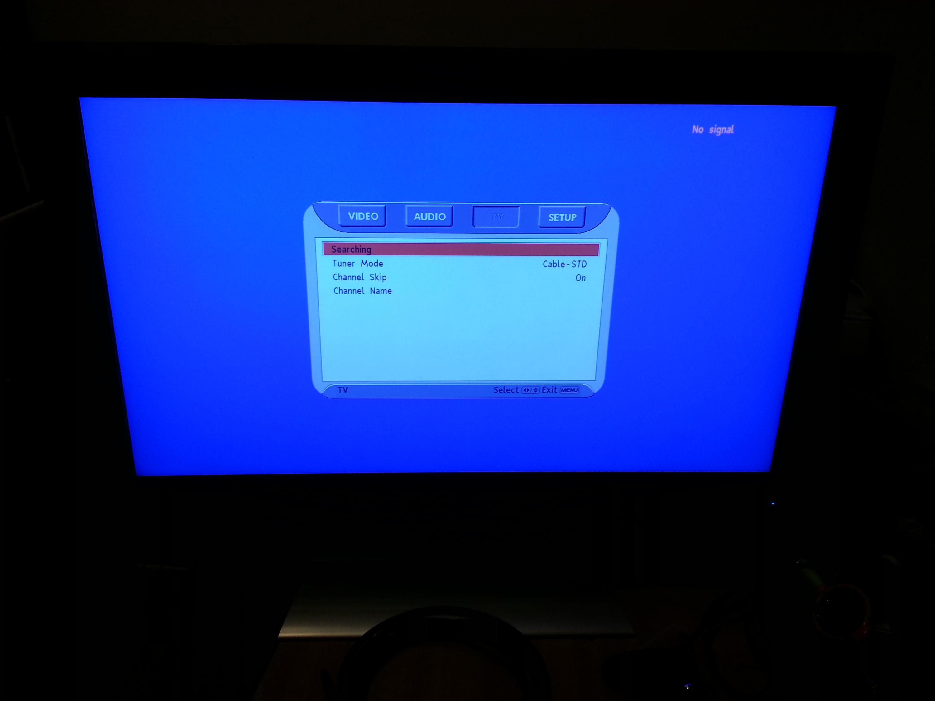

                  1. When I do the auto search it goes into search mode but it does not find any channels
                  I tried both "tv cable" and "hd cable" connection and auto searched both and I dont even get one channel

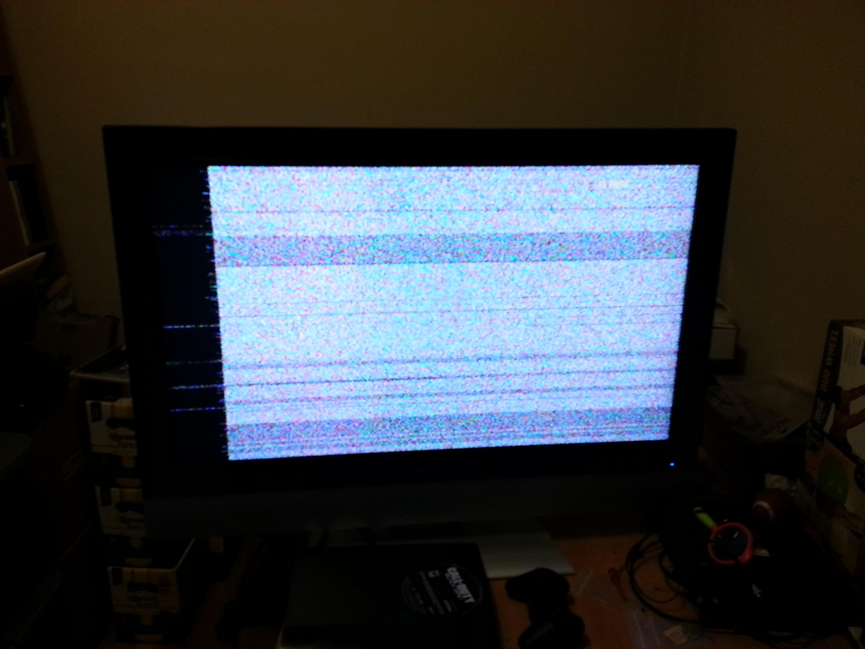

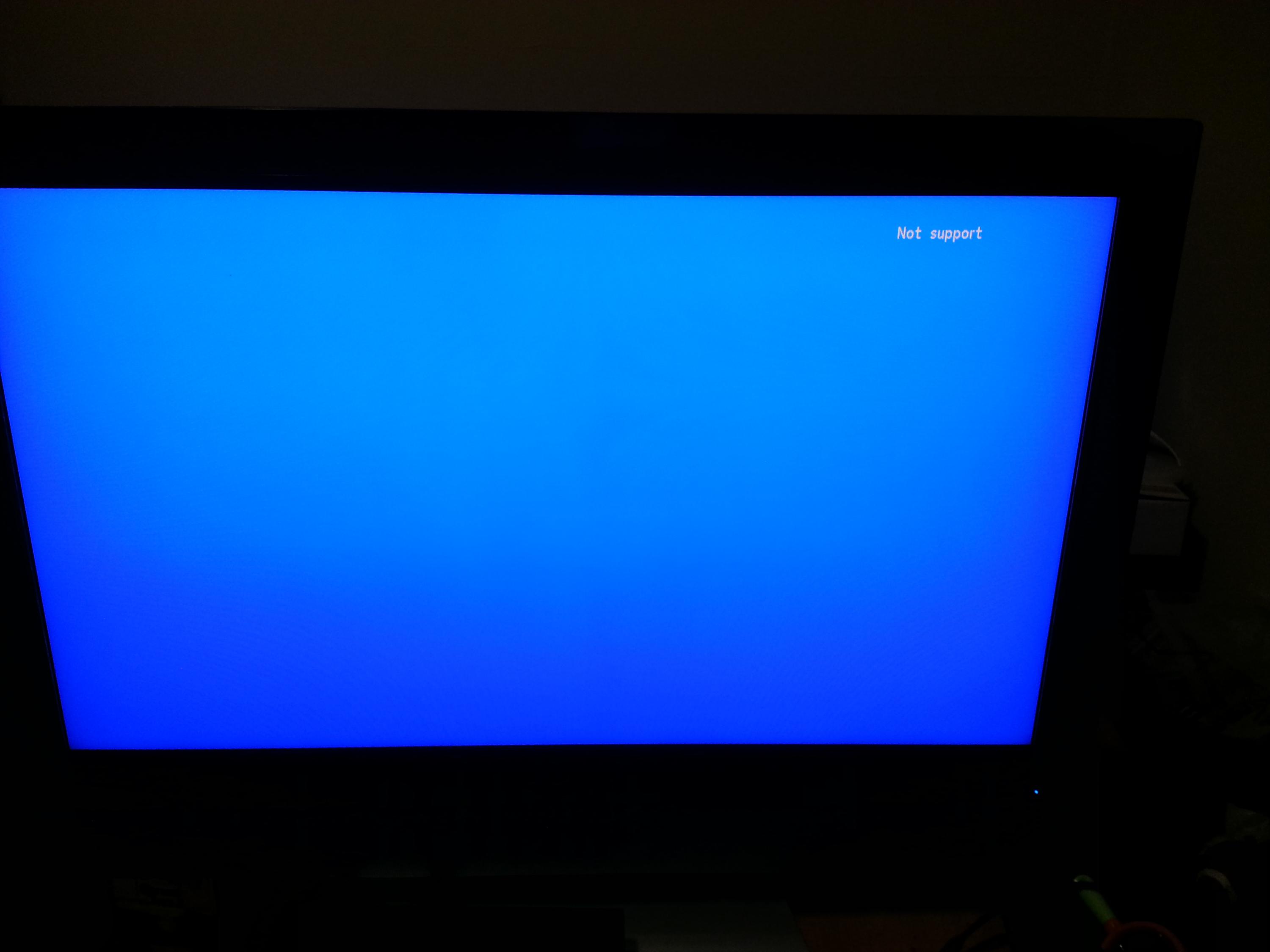

                  2. When I connect my sons ps3 via hdmi cable it does not recognize it. At first it would show a bunch of distorted colors then it the screen blacks out and goes back to the distorted colors then finally just went to a blue screen and the top right corner said "not supported "
                  I did hook up my sons xbox 360 slim via hdmi and rca cables and it worked just fine
                  So what should I check to fix these issues?
                    #29
                    "not supported " That means the resolution setting of PS3 is too high for this TV to display (same kind of thing with PC monitor if the video card resolution is set too high).
                    I am not if this TV has QAM tuner to pick up the Unencoded HD signal or not, the analog signals are take away by cable companies months ago.
                      #30

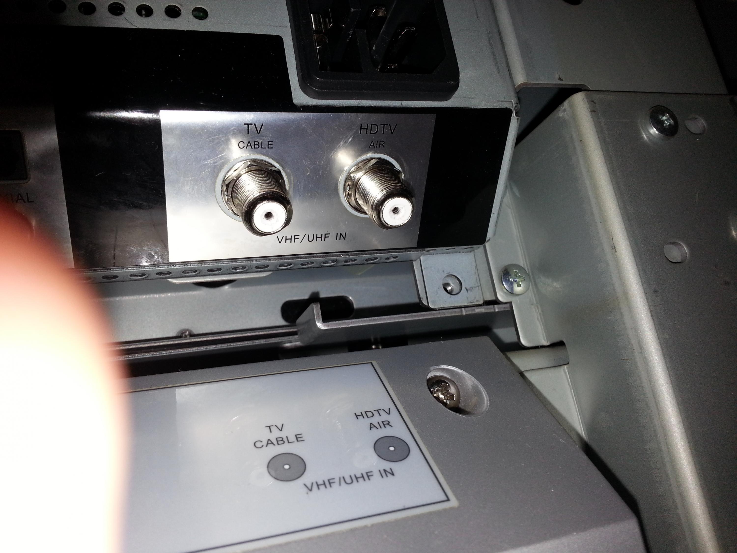

                      This tv has 2 cable connections
                      I tried both auto searches and got nothing
                      So does that mean I can only use this tv just to watch movies with a dvd/ bluray player only?
                      Or do I need a converter box?
                        #31
                        It does not have QAM Tuner, it only has NTSC, and ATSC (Over the air Digital). You need the cable converter box.

                              So what is the HD air connection for?
                              Im a bit confused
                              Does that meani cant connect a cable box?
                              Because I was just running the coax cable to the tv like my other tv
