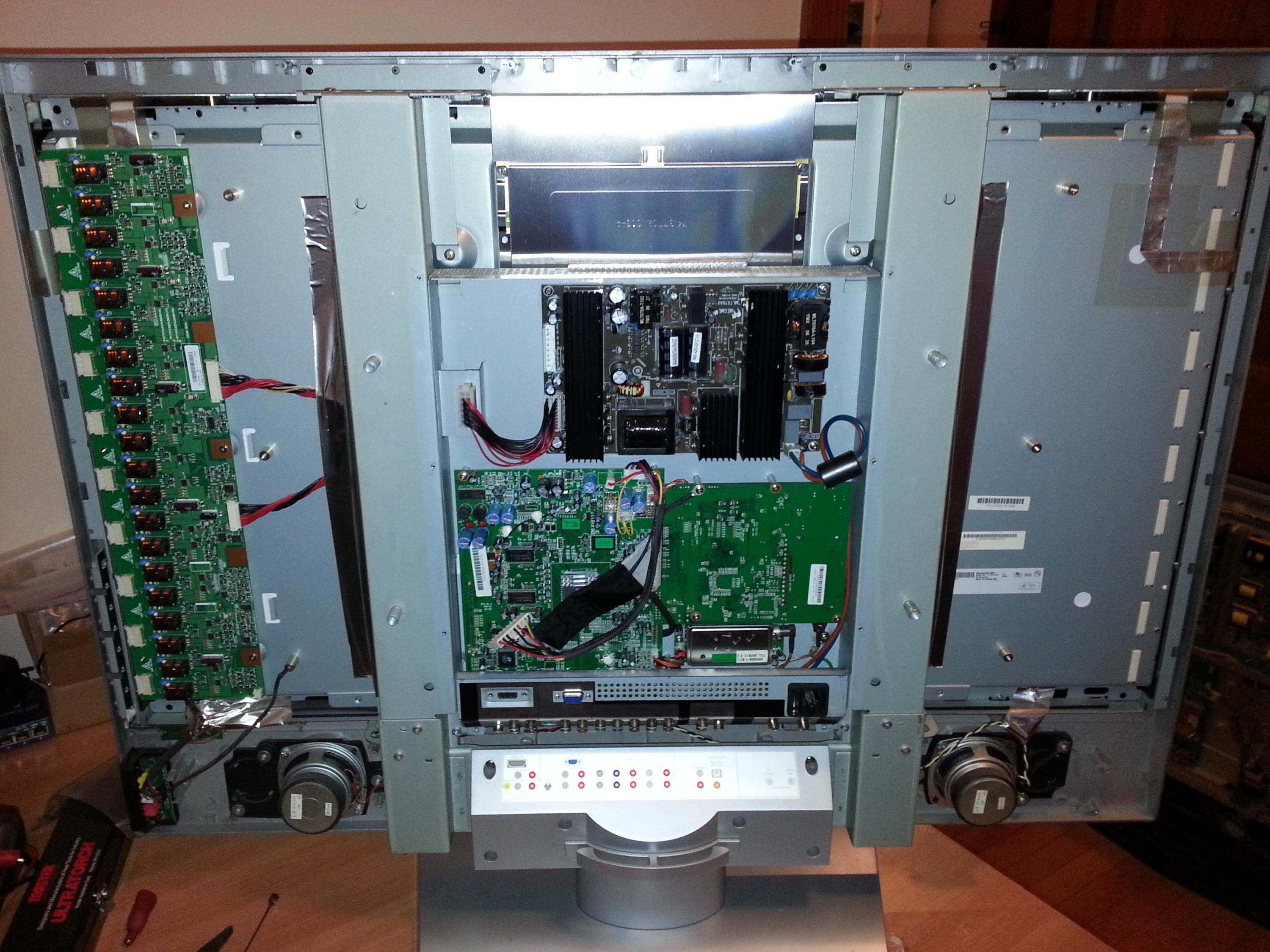

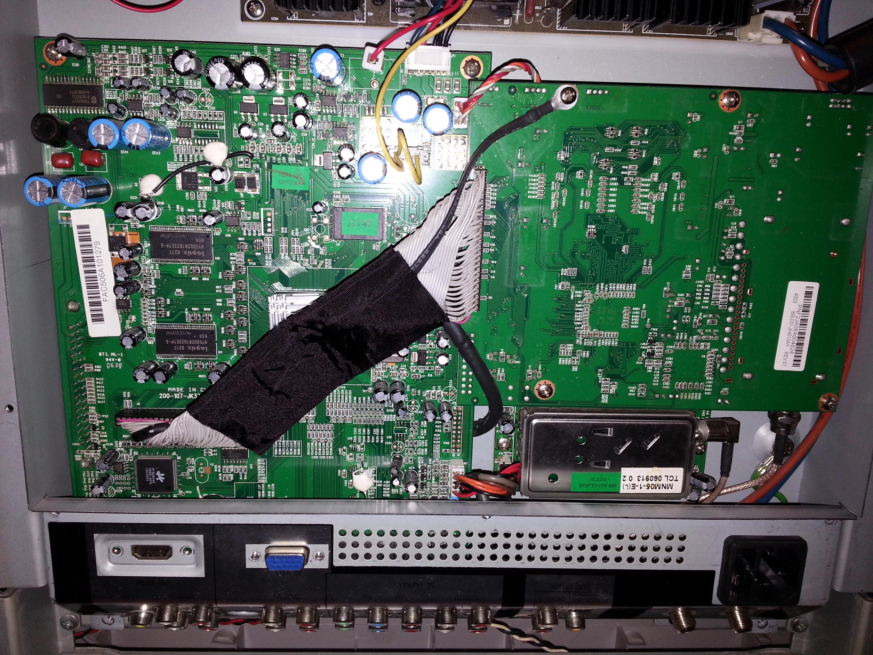

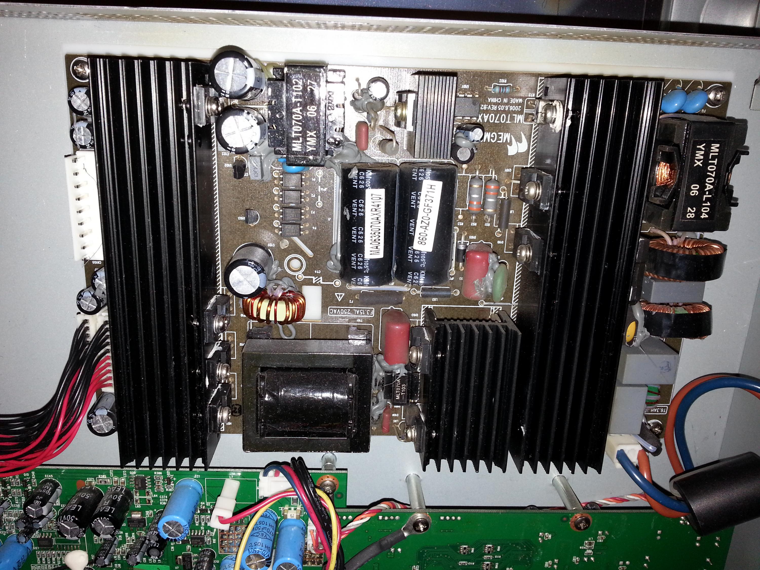

                              Here are pics of the tv
                              Currently there is no power at all
                              The guy I bought it from said he replaced caps on the original psu tv worked
                              Then the tv went out so he replaced the psu
                              Tv went out again and he didn't want to fix it again
                              No physically blown caps
                              Also there is no label for Va or Vs

                                Caps seem to be an issue with this PSU, so you may have a repeat failure. Did the previous owner replace the caps on this PSU, also? You should add an ESR meter to your shopping list, since you seem to be repairing TVs more frequently

                                  This is an LCD TV. Va and Vs are plasma voltages only.

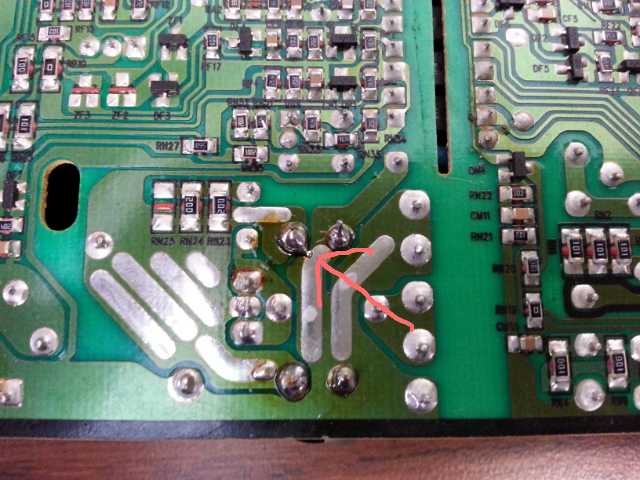

                                    so i spoke with the previous owner again regarding the repairs
                                    he only replaced 2 of the caps on the psu
                                    i can see there are 2 Nichicon caps and the rest are CapXon
                                    he never replaced the entire board
                                    he did buy a an extra board but he found out later he just needed to replace the caps so he sold the extra board and never installed
                                    so he says its the original board with the 2 new caps
                                    i did notice that he left an excess amount of solder on the caps
                                    and that a small drop of the solder "spilled" over onto a trace
                                    would this cause an issue?
                                    either way i am going to resolder the legs

                                      Unless it's just the angle of the picture, it looks to me like that extra solder would have shorted that cap entirely. I don't know that the set would have worked at all like that.

                                        the previous owner said it worked for a while then it went out
