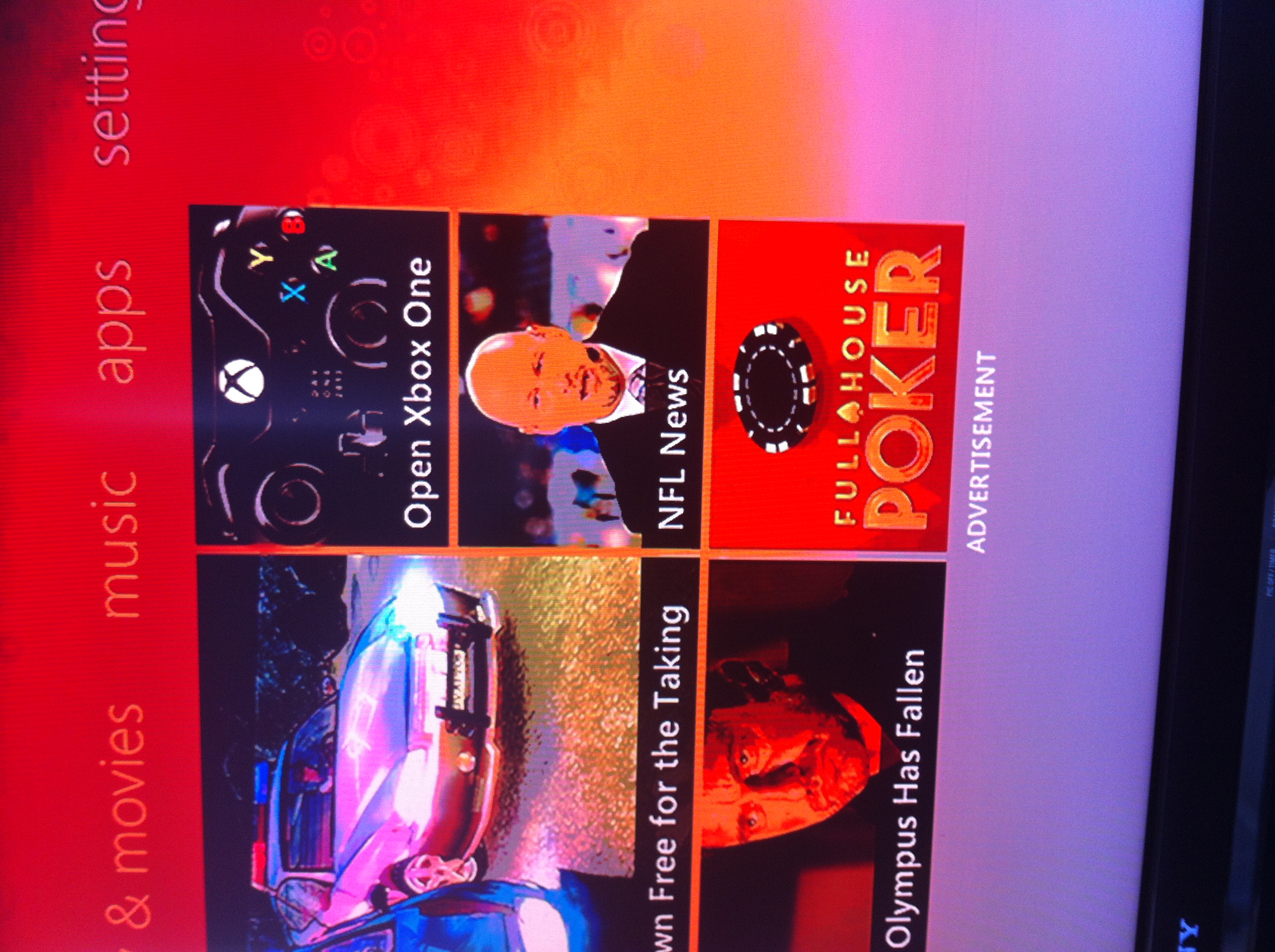

    Hello all!
    Last night I was watching a movie on my Sony KDL46z4100 and midway through the movie the picture coloring went 'dark'.
    - Didn't touch any settings
    - Was watching the movie through the XBOX, but the problem persists even with other inputs / when the XBOX is turned off
    - Yellow looks orange, Orange looks red, people look orange / red, whites look more gray / dark, blues look purple... etc...
    - Tried to play with the settings to turn up all brightness settings. Even at max everything looks very dark
    - Didn't hear any 'popping' noises when the picture failed
    - I had a similar problem with an 'old school' computer monitor a couple of years ago and it was because one of the tubes was bad. However, I don't know anything about the guts of an LCD TV, but my assumption is that they don't use tubes
    - Since this happened mid-stream it would suggest to me that something failed and that it didn't have anything to do with resetting to factory settings. Regardless, I did go an try to reset all of these without any results...
    Anyone have any idea on what part might have gone bad, and what that part might cost? I am willing to get this repaired if it is economical, but if it's going to cost $1000, then I'll just get a new TV!!!

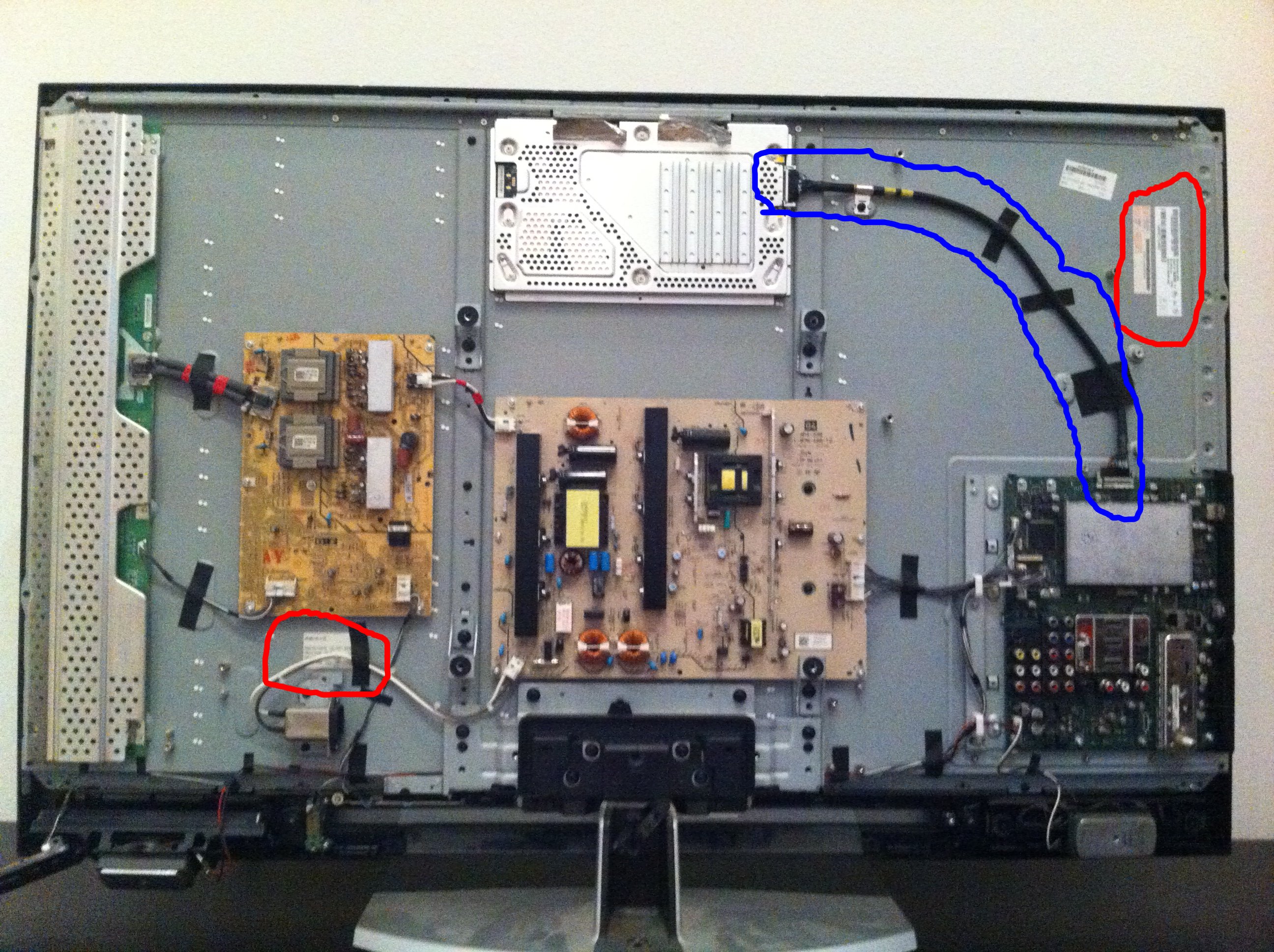

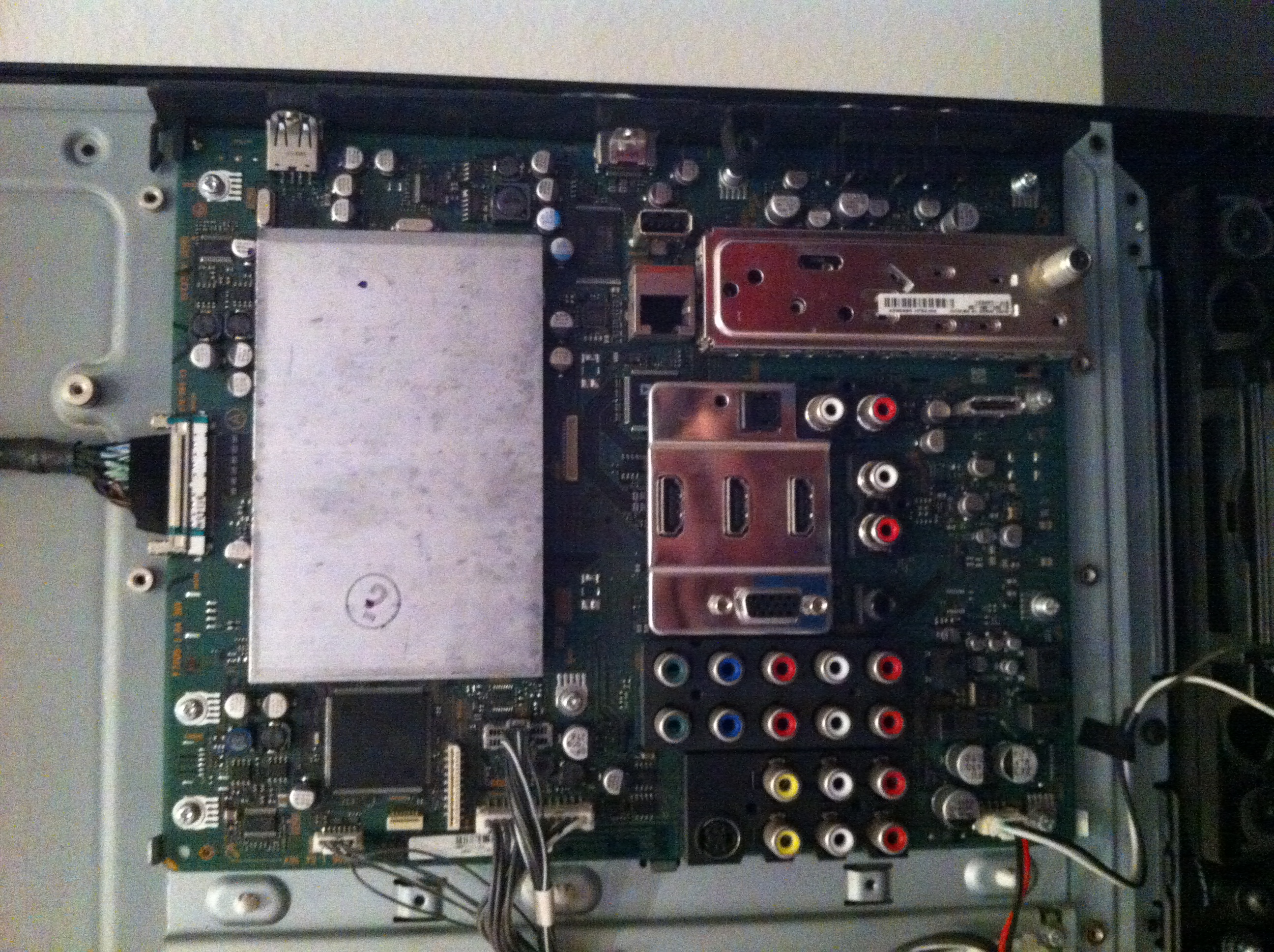

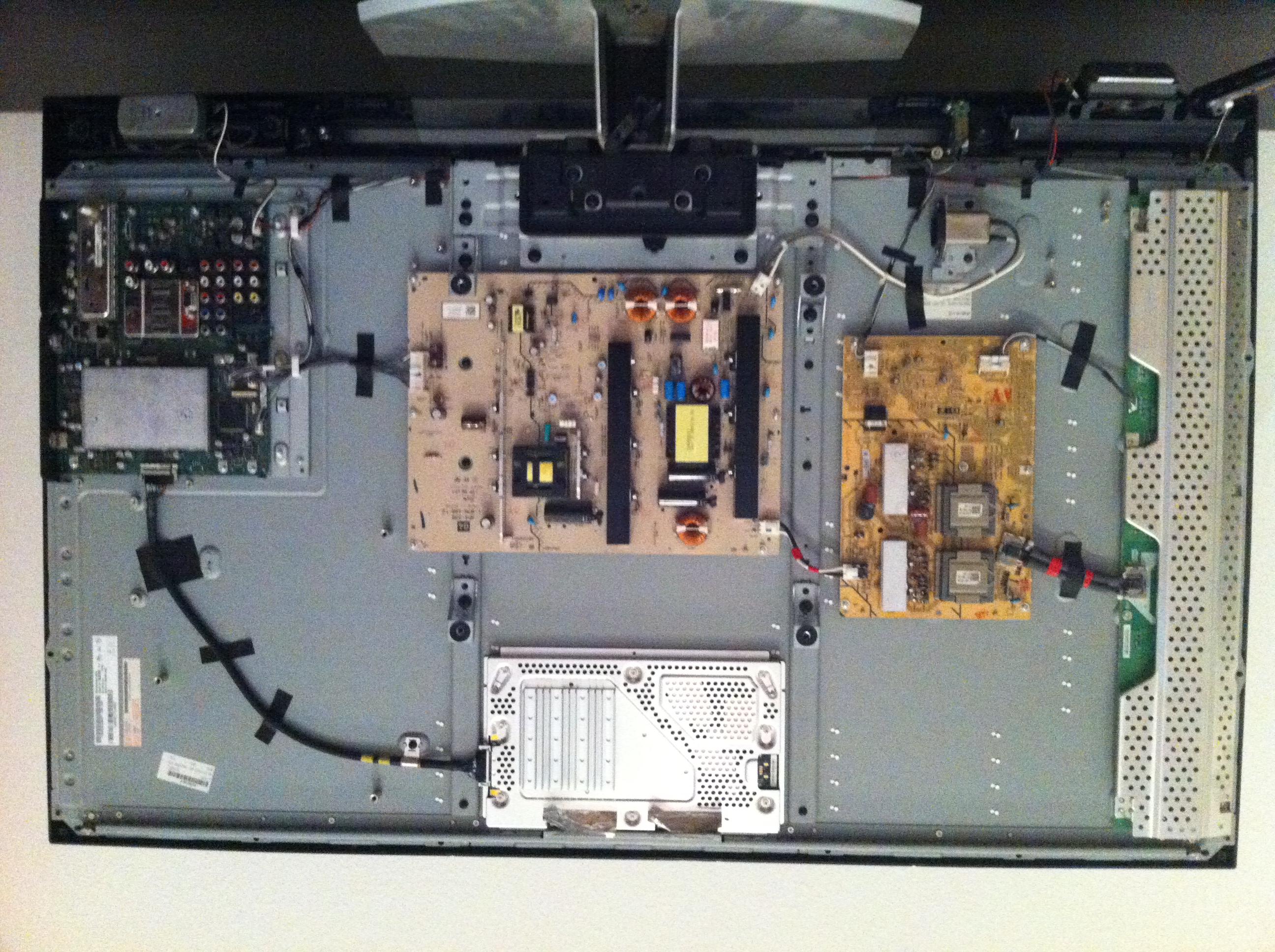

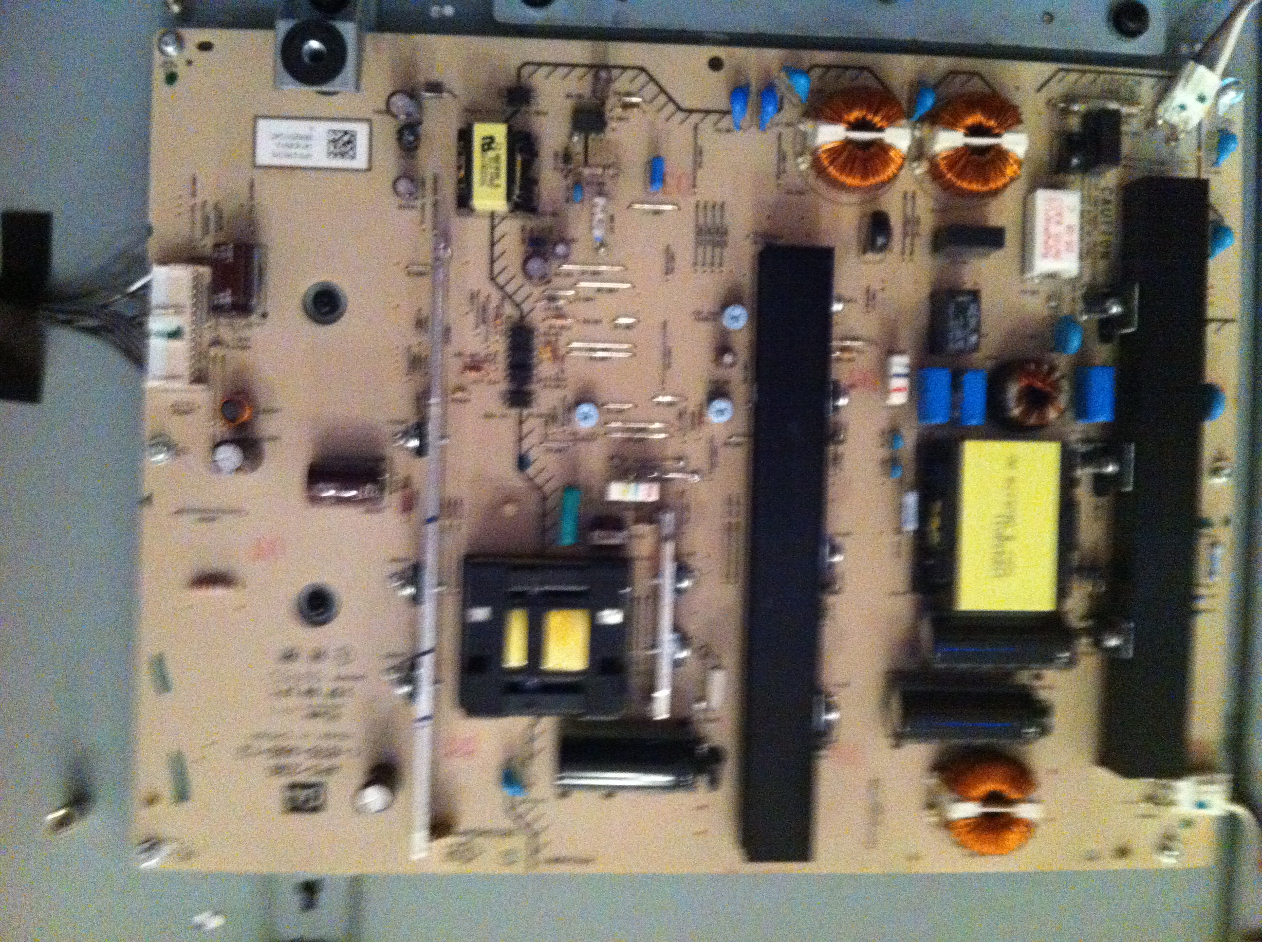

      Re: Sony KDL46z4100 red hazy picture
      Hi, thanks for the response!
      I have attached pictures of the backside panel along with close ups of the components. I didn't take a close up of the tcon board, but it's just like the one at this link
      If I can give you any more information to help narrow down what the problem might be, happy to post as many more pics as required!
      Thanks again!!

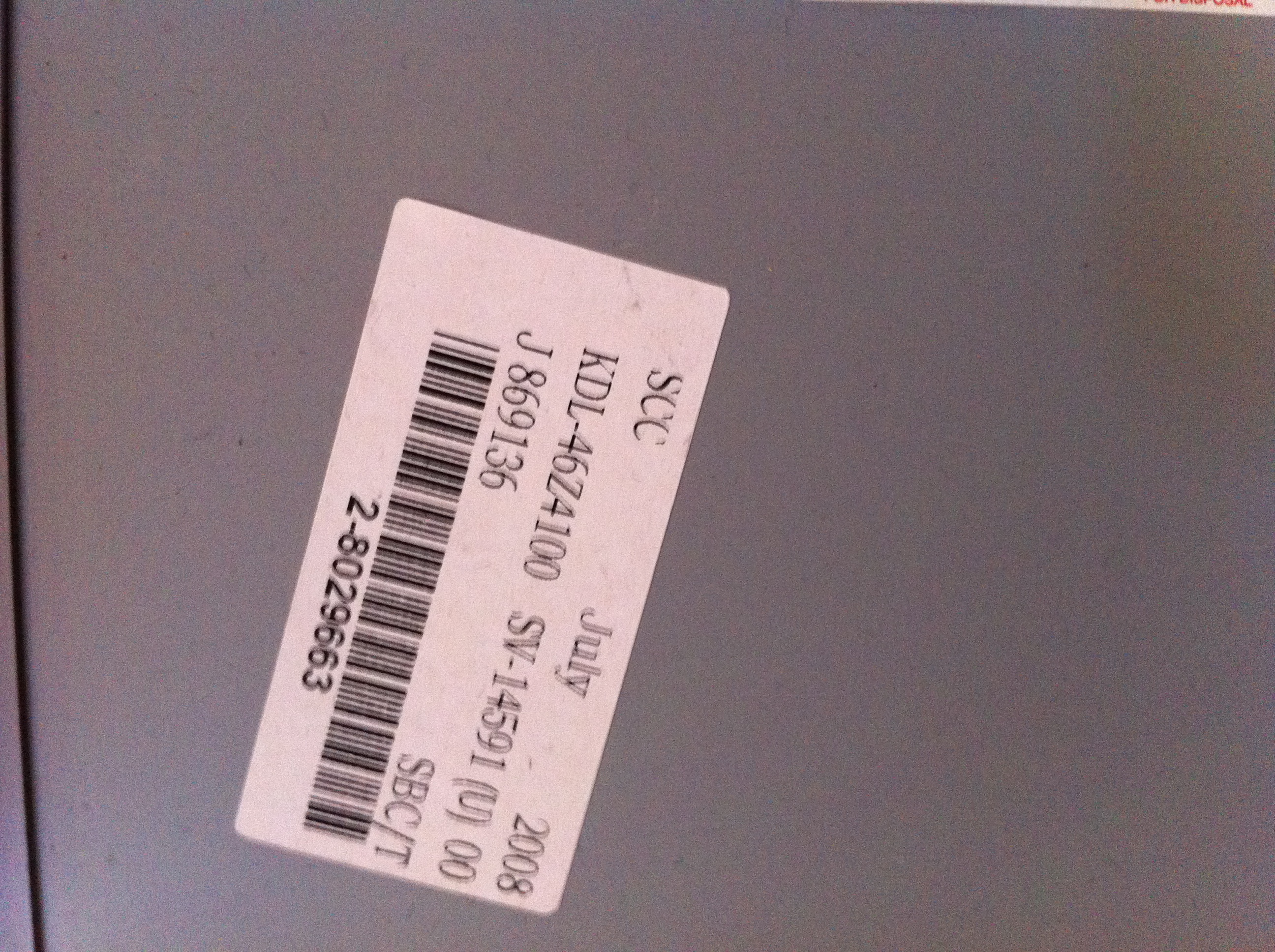

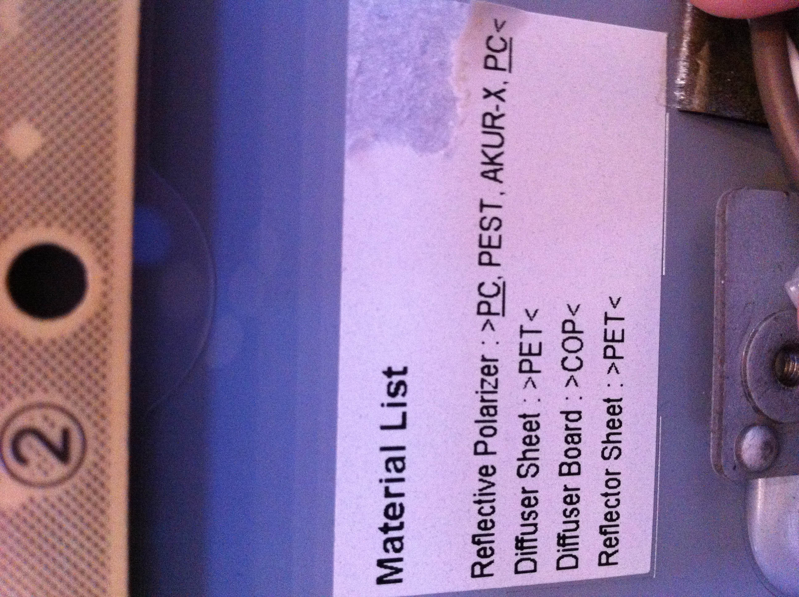

        I've highlighted three things.
        In red, I've highlighted some stickers, can you get a picture of these?
        In blue, there is a cable from the main board to the T-con board. Please unplug this cable, then plug it in again, and see if the problem is resolved. Try both ends.

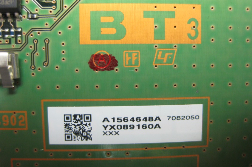

          I got two this model TVs, same t-con problem. I ordered one (Part#: A1564648A) to replace, the tv power on and I saw the logo on the screen for a second then power off itself with 14 led blinks.
          When I unplug the cable from main board to t-con, TV can stay on power, no picture of course.The T-con is expensive and not easy to find, and I suspected I bought a bad T-con.
          I would like to go the way to fix the t-con, but no schematic or more info. Any one?

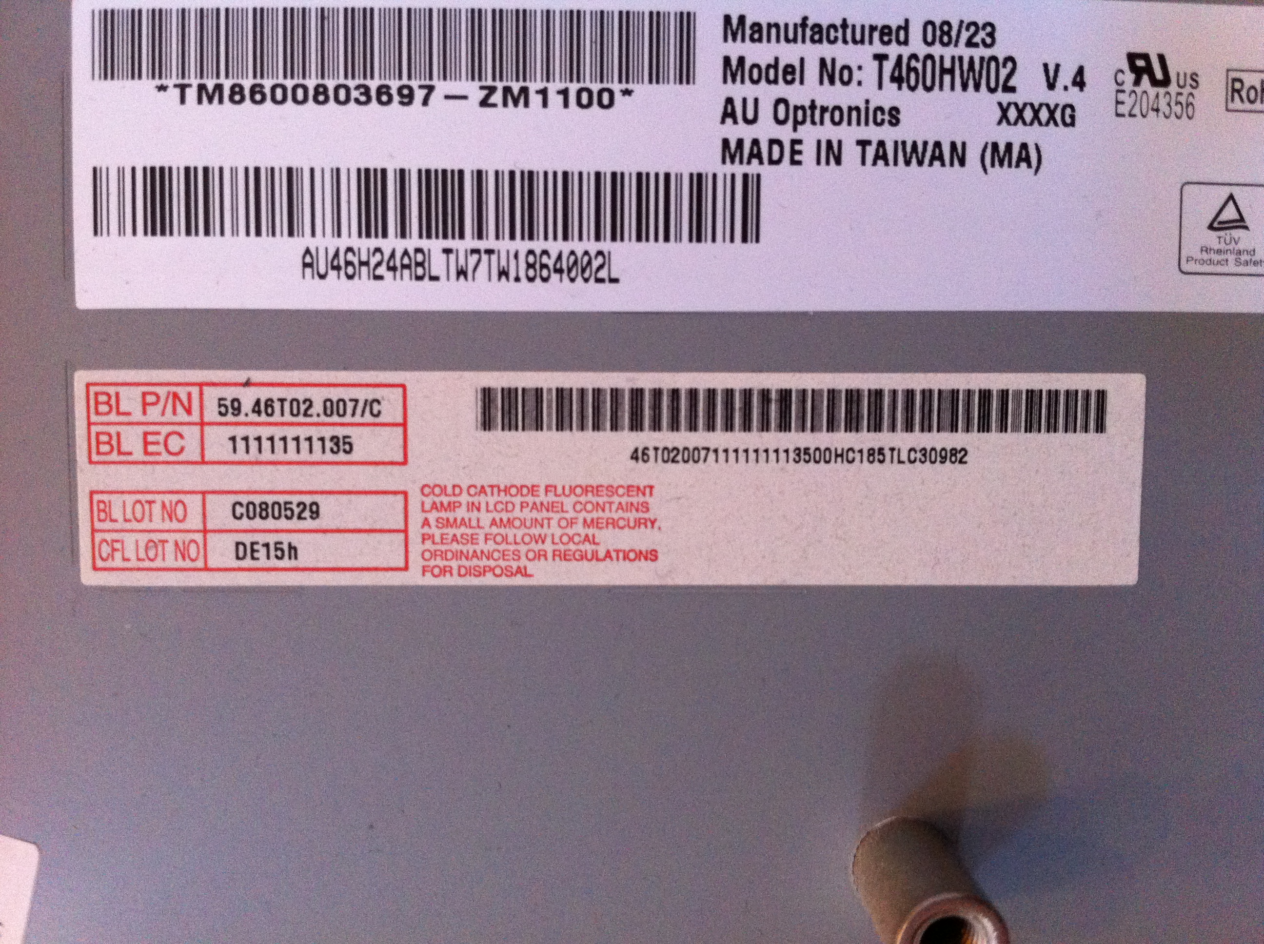

              OK, AU Optronics LCD panel... that's what I needed to know... These have a common fault with the "AS15G" chip on the T-con. I believe they can cause a similar fault when they fail. Basically every T-con or other TV part you buy will be used, a pull from a smashed screen TV. You have a 5~10% chance of picking up a dud board, but otherwise they are usually fine with minimal usage on them.
              If you want to try diagnosing the T-con please take the shield off and post closer pictures of it.

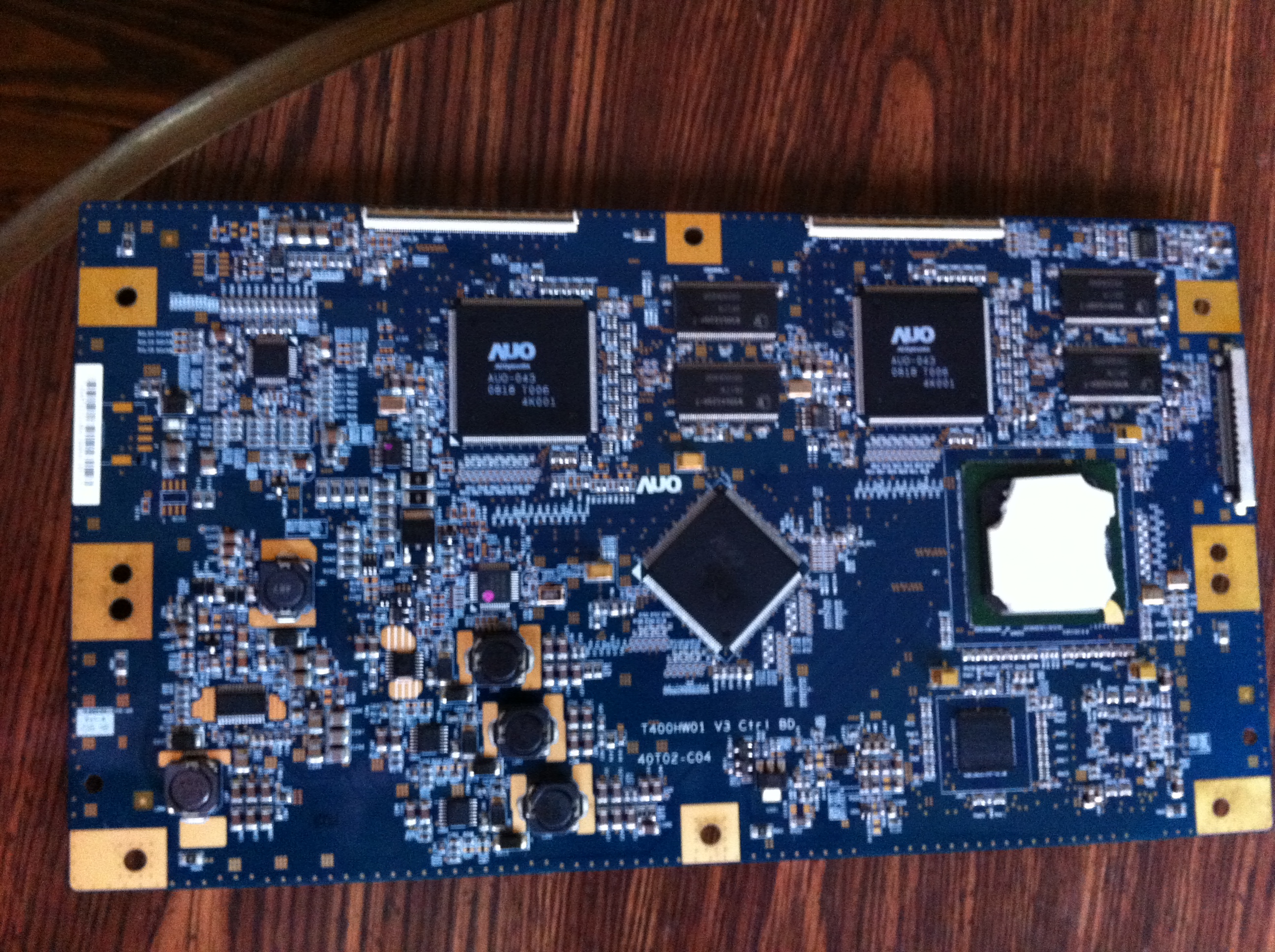

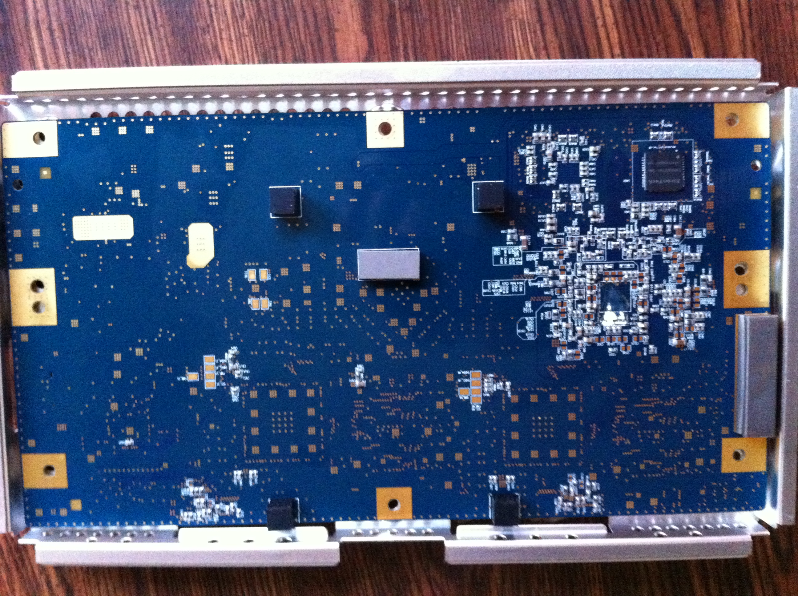

                If you are willing to look at it further, I have posted pics of the tcon board.
                Understood that I could just order the tcon and be done, but I am enjoying learning about this, so thanks for teaching me!

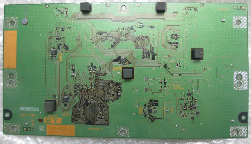

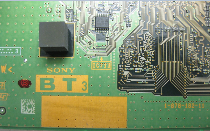

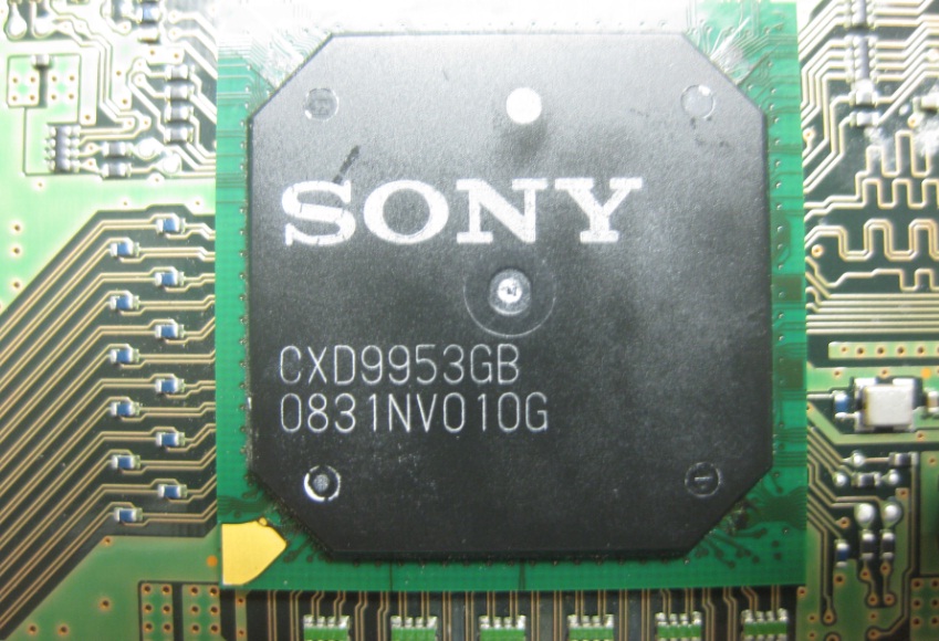

                • Sevenqi
                  • Jul 2011
                  • 292

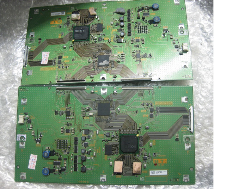

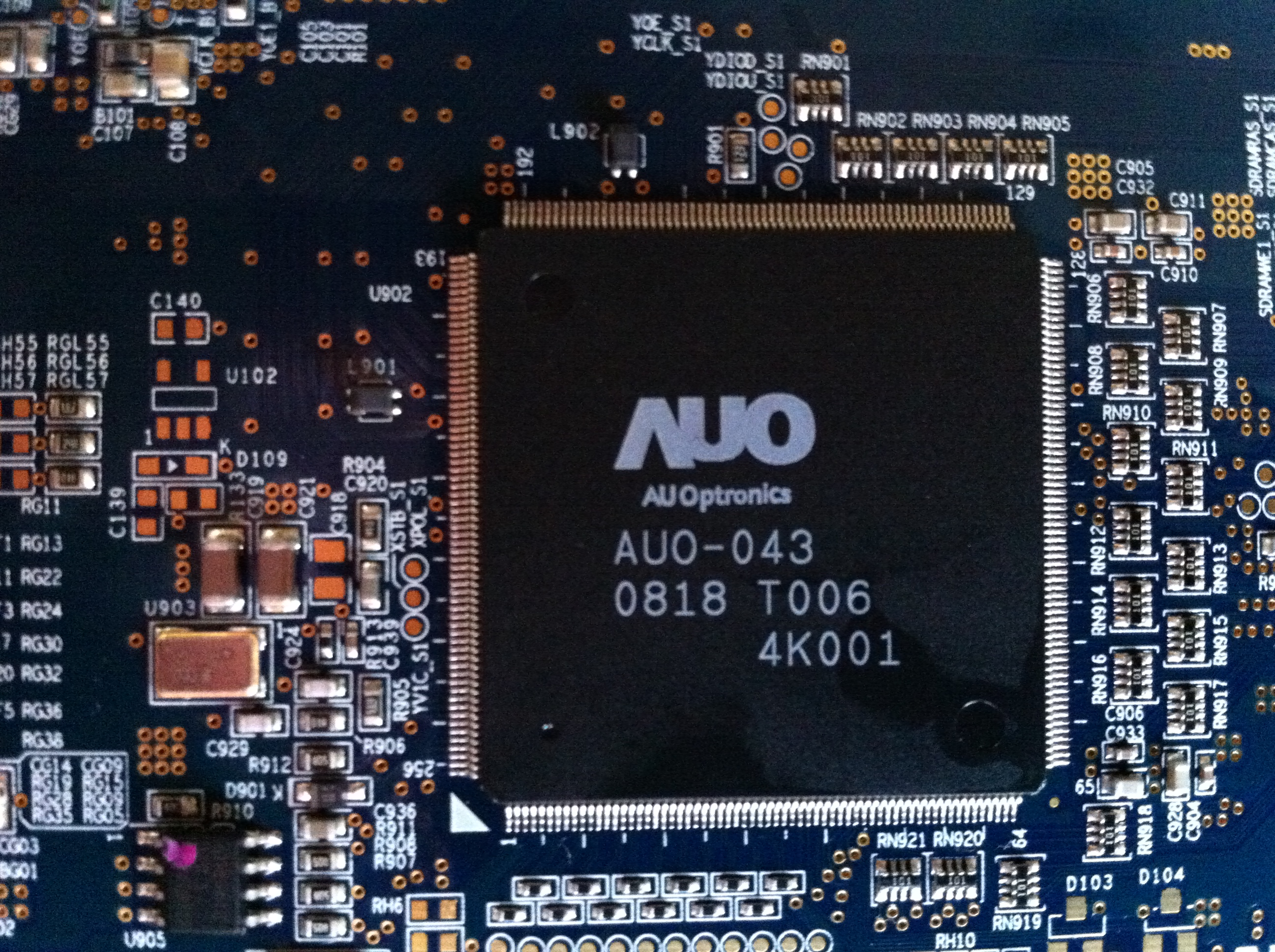

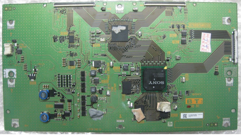

                  Yours t-con is different from mine, the TV model is the same: KDL-46Z4100.
                  Looks like this model used different t-con or even different panel, I have no chance to capture the panel sticker, but I post the t-con and the part number.
                  picture 1: The t-con front.
                  picture 2: the biggest IC.
                  picture 3: Part number.
                  picture 4: t-con back side.
                  picture 5: part number on the back side.
                  picture 6: two t-cons
                    Do you see a chip with "AS15" printed on it?
                      I don't see any 'AS15' on the t-con boards. other other ICs are Samsung make.

                        I'd still bet on the Tcon, that picture doesn't look at all like a bad panel.
                              I second that it is the T-CON board problem, something in the GAMMA/Voltage circuit. It may not use the AS15 REF voltage IC but it should use other IC with similar function. TI also makes IC for GAMMA Voltage ref. You may have to look at the ICs and look up the spec sheet of the IC to find out which one does the GAMMA function.

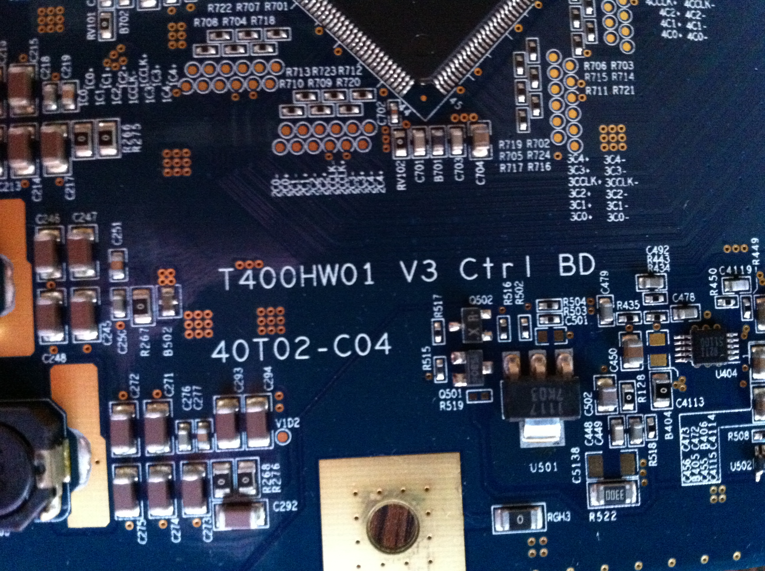

                                Got my T-con out....in one piece.
                                It is just like the one here previously mentioned and pictured in that link of Wisiny.com.
                                T400HW01 V3
                                40T02-C04
                                Gotta order one to see if I can get it back in order....
