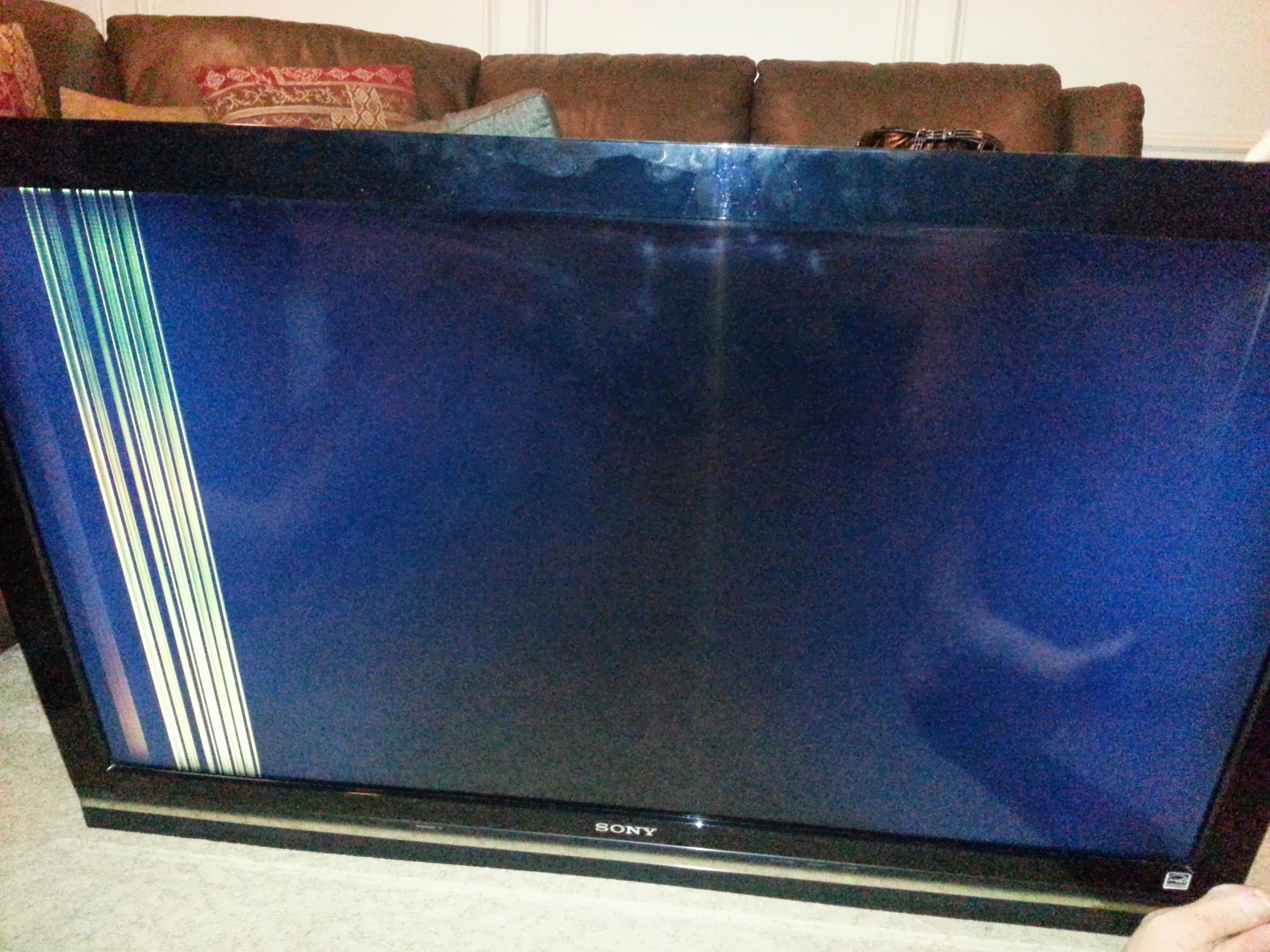

    I've got a Sony KDL-V5100. It very suddenly (soon after turning it on today), displayed colored vertical lines on the left side of the screen...as seen in the first pic.

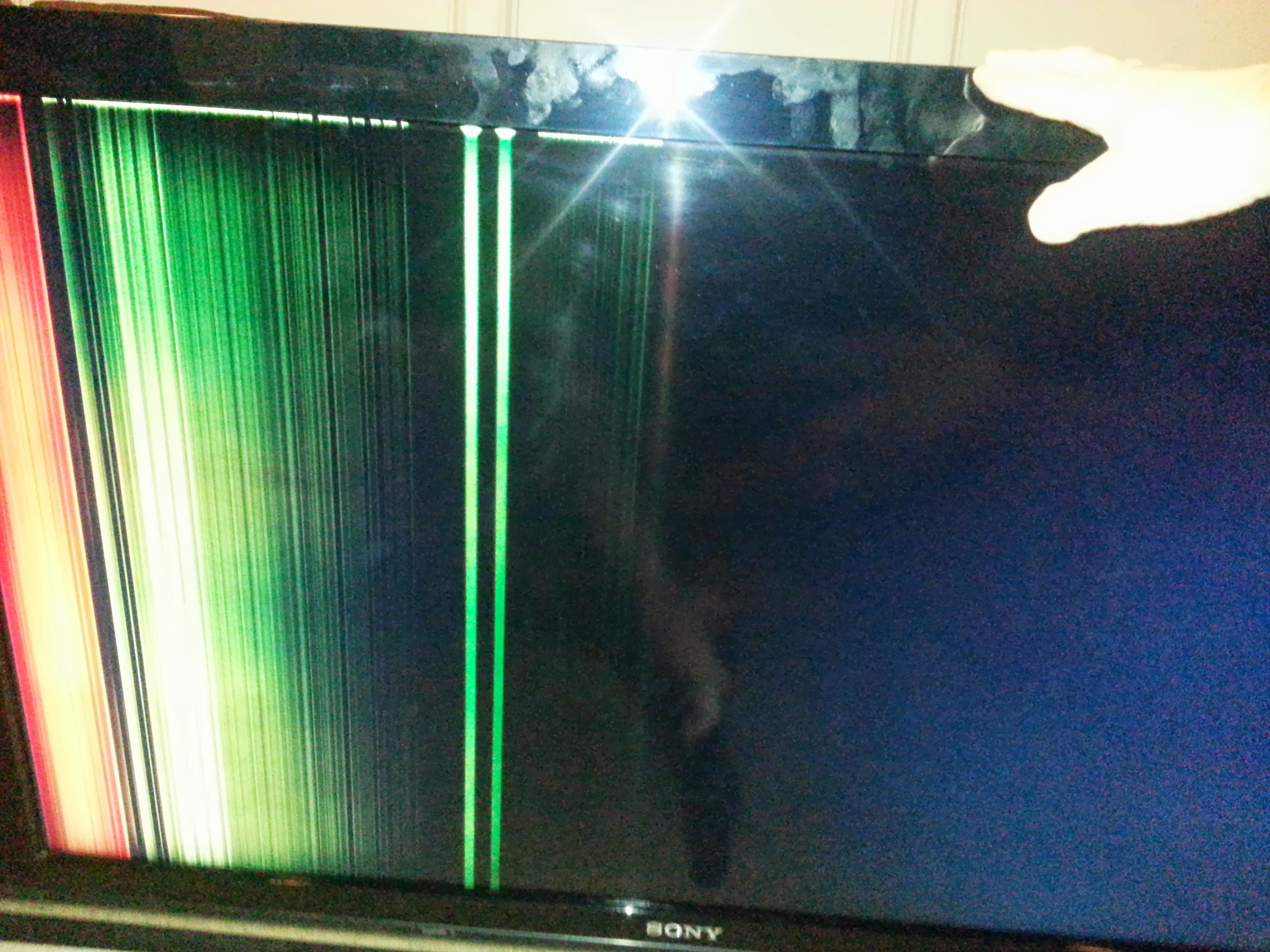

    When I press the menu button, the lines change to a wider pattern...as seen in the second pic.

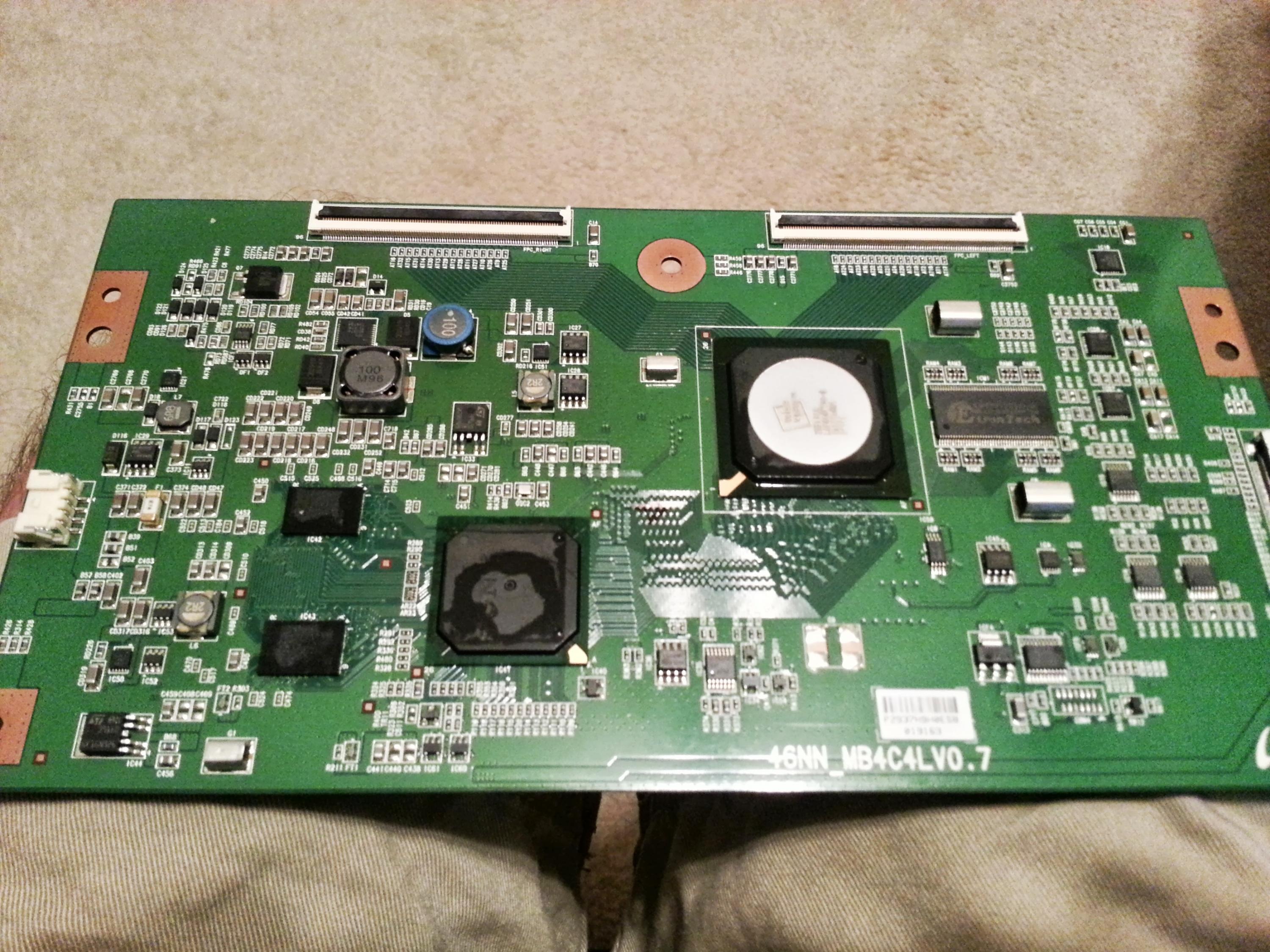

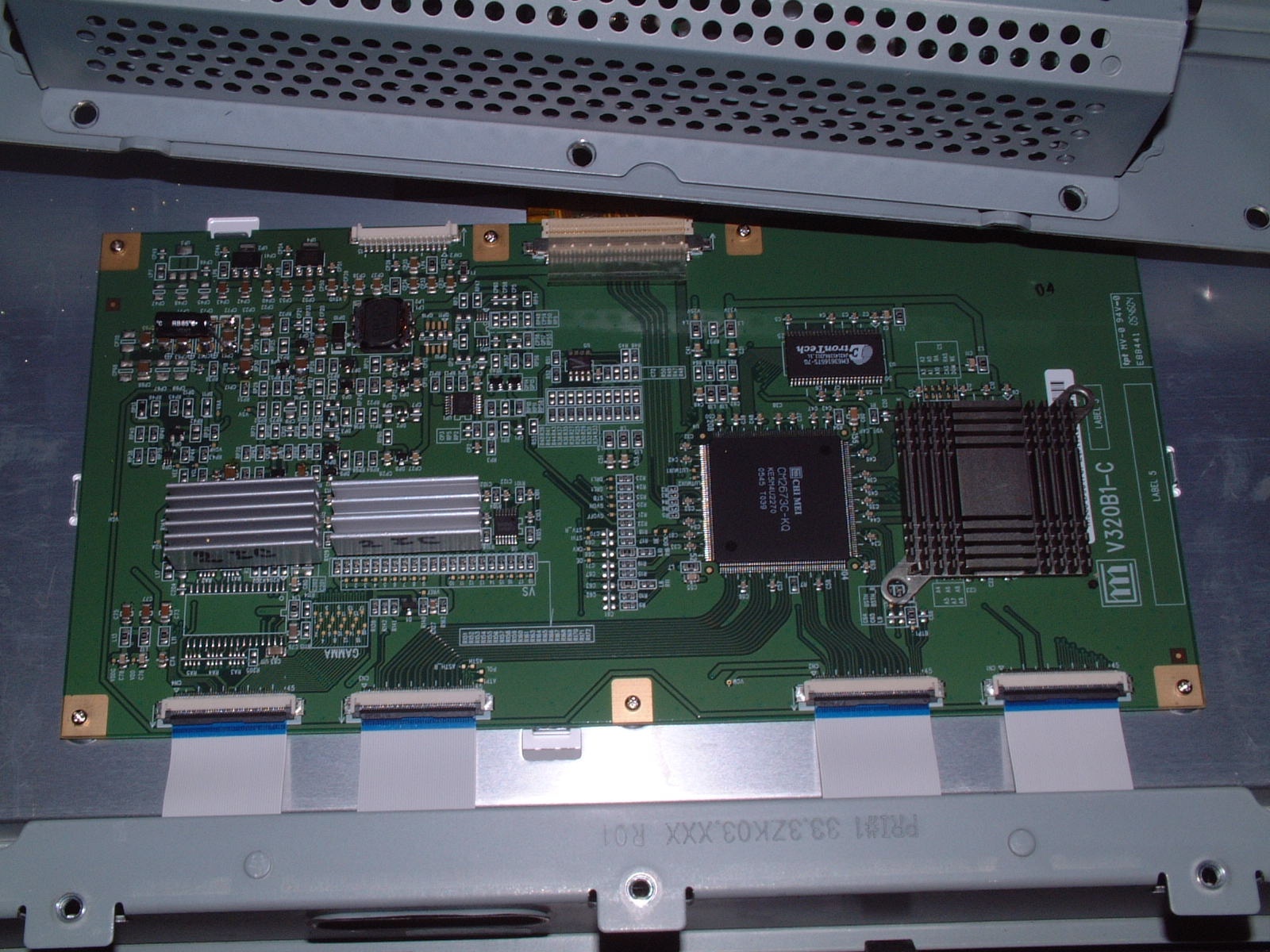

    I removed the back to check to see if the ribbon cables were seated correctly and everything looked fine, so I removed the T-Con...as seen in the third and fourth pic.

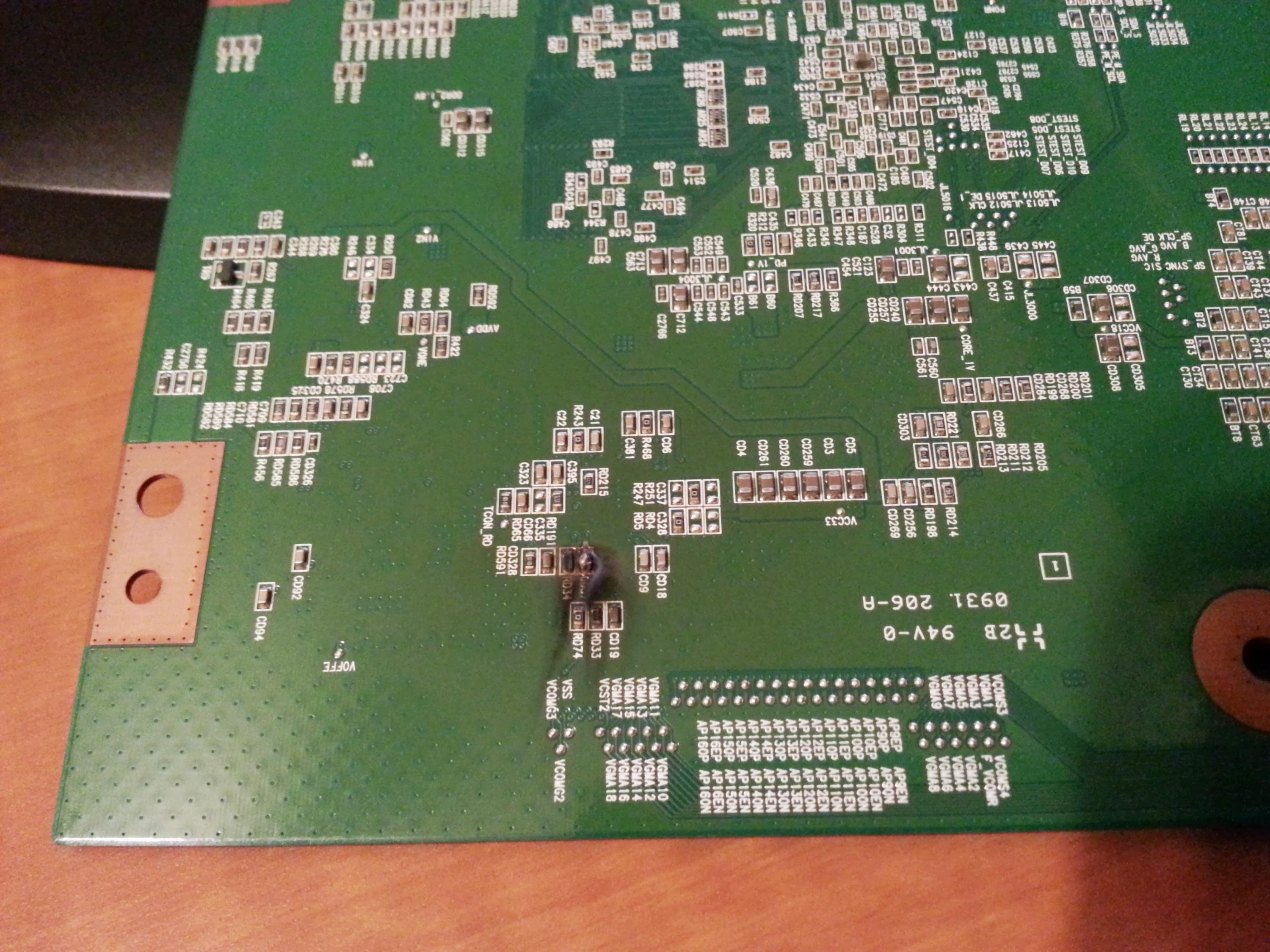

    The back if the T-Con revealed the culprit...as seen in the last pic.
    My questions are:
    Is this a result of something else that may need to addressed?..or is it safe to assume that whatever that little part is that burned up (I'm assuming some kind of tiny fuse) is the failure point. In other words, something like the main board or power board wouldn't cause this fuse on the T-Con to blow...would it?

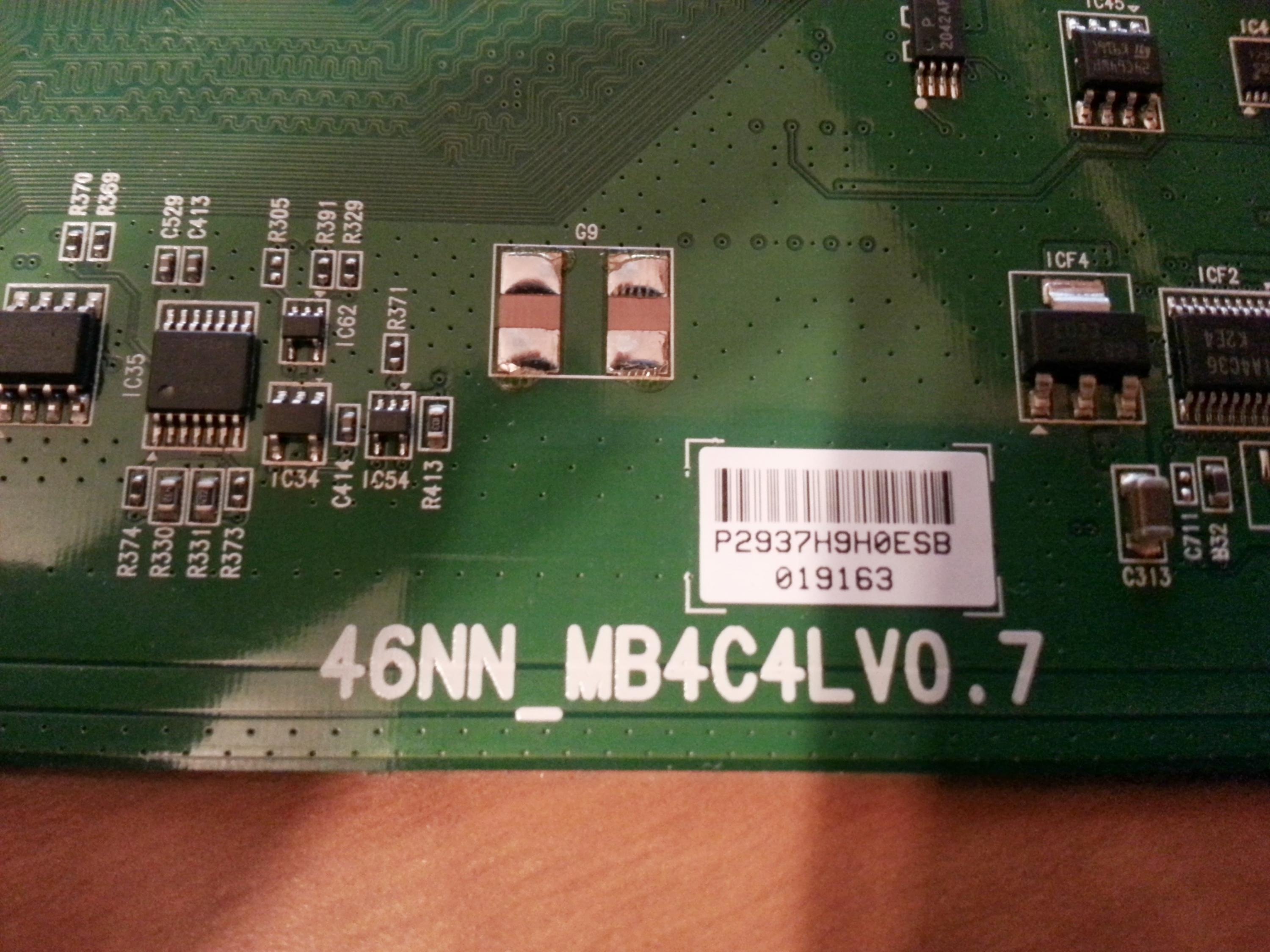

    I've searched for this part with the number shown in the third pic (46NN_MB4C4LV0.7) and I'm not finding anything. I believe it to be part # LJ94-029374...can someone please confirm the part number? The number on the sticker on the inside of the TV is LTY460HF07.
    Are there substitute parts?

    To replace the t-con the set should work. If not then the panel is bad, not repairable.

          Looks to me like an MLCC capacitor. They usually fail short circuit, like what probably happened here. My guess is that it could be partially shorted, pulling down a voltage rail and causing the screen to display a whacky image. However, it is just a guess...
          How would a bad panel cause an MLCC capacitor to short?

            Could have shorted a low voltage rail to a high voltage one (3.3V to 15V for example.) That would be rare though.
