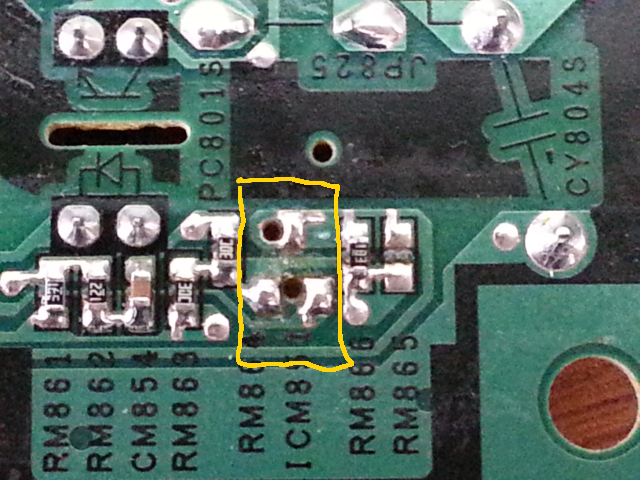

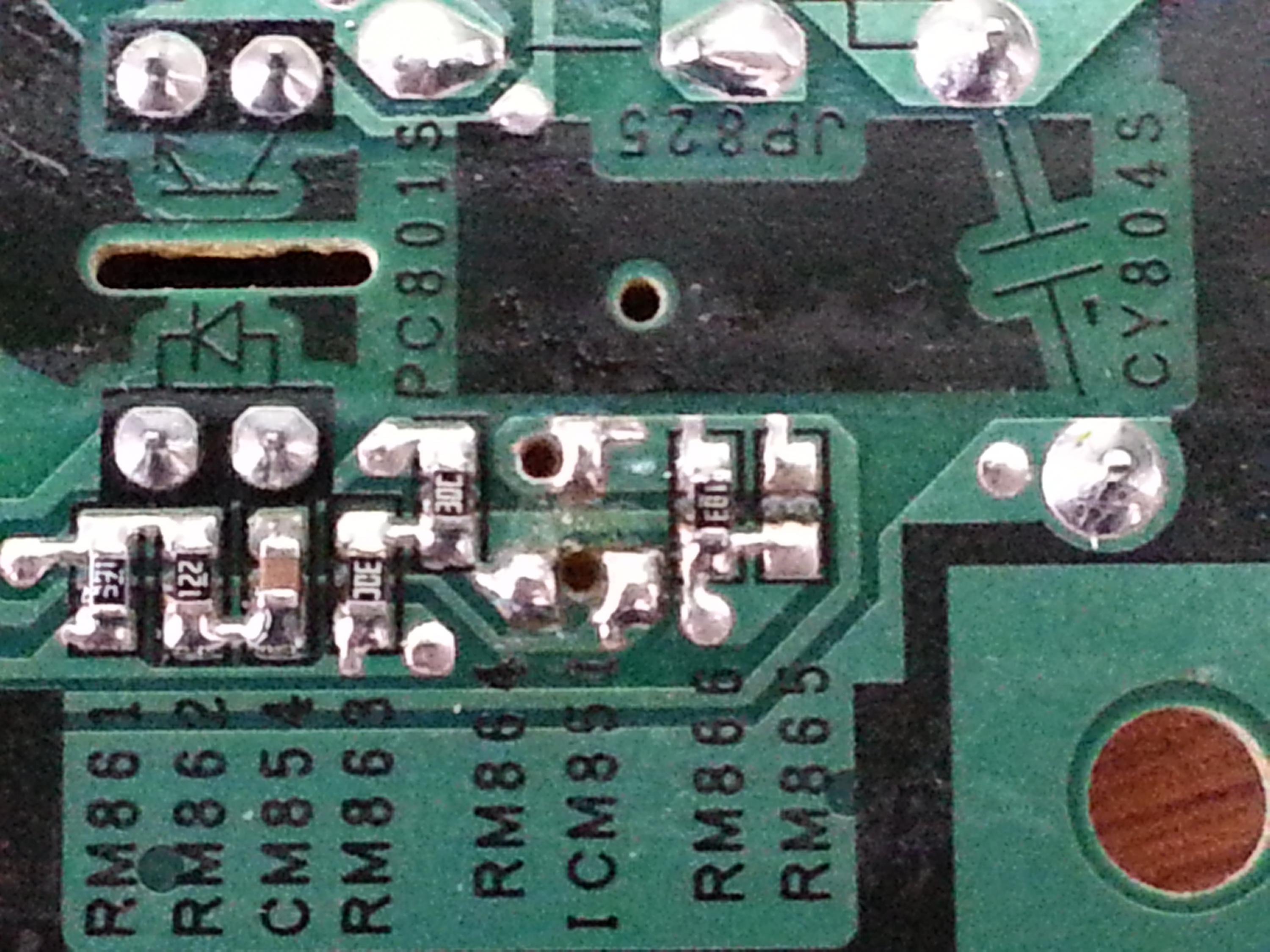

          Bud the pdf you attached is of the burned component on the backside?
          reason i ask is because the electronics guy at work removed it for me today and it doesnt look like the one in the pdf
          the one i removed is a surface mount with only 3 legs
          i attached a pic of it removed

            Yes, the SMD ref diode has 3 legs, something like TL431.

                  • 707
                  #48
                  Re: samsung UN22D5010 no power
                  im on the digikey website and there are several TL431
                  which one should i get?
