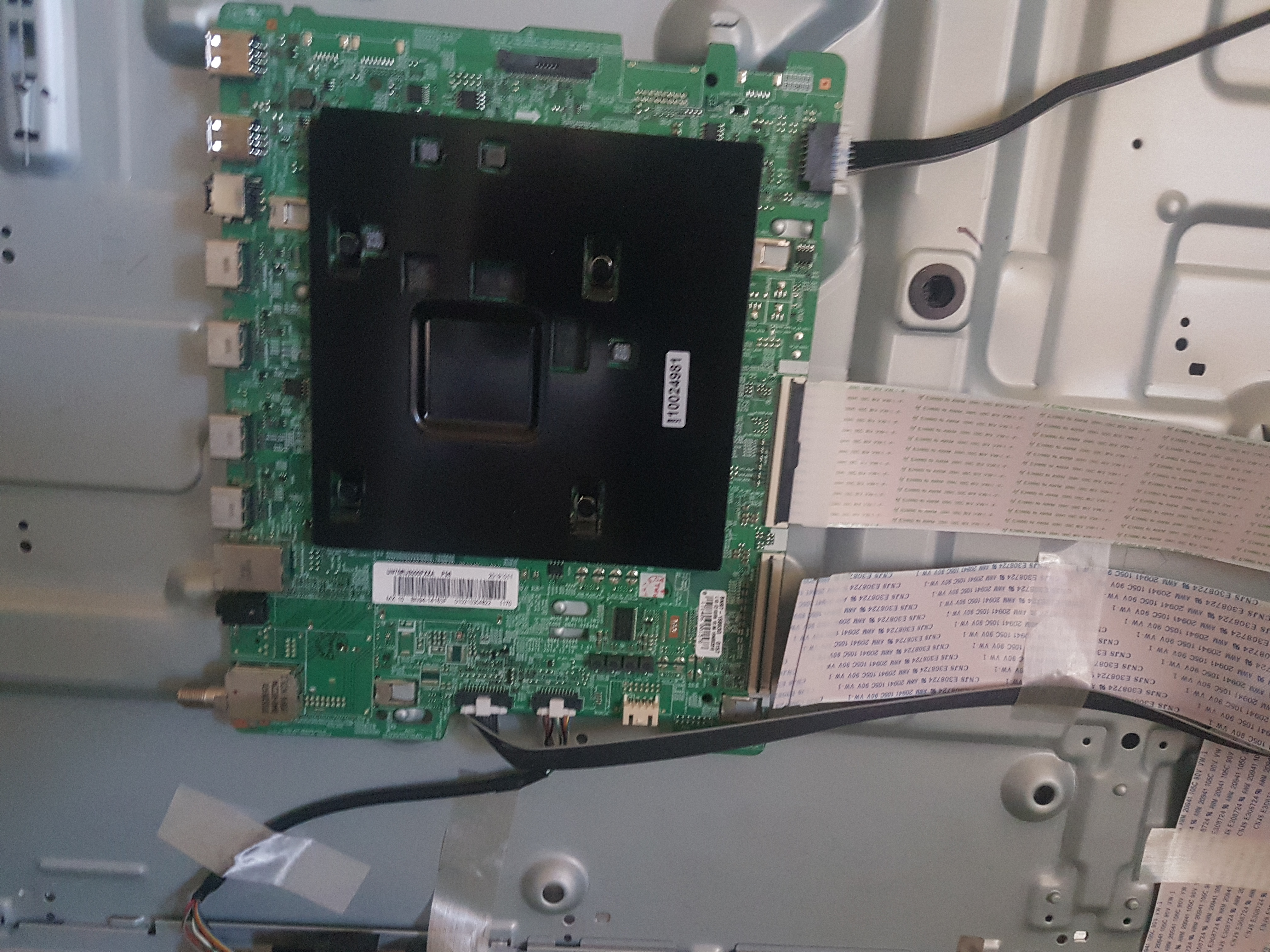

    I have a Samsung 75" LCD model UN75RU8000FXZA that I don't remember the original fault other than it wouldn't power up anymore.
    After it sat for many month's I decide to look at it again. The motherboard seemed to have power regulation issues. After much fussing I decided to just get a new MB.
    It came a few days ago and I installed it now just cycles the power relay on and off ... when on the backlights light up and then dim and then relay kicks off and the whole things starts again.
    Also no standby light. I saw a couple you tube vids with same issue and they just replaced MB and problem solved ... mine apparantley different story.

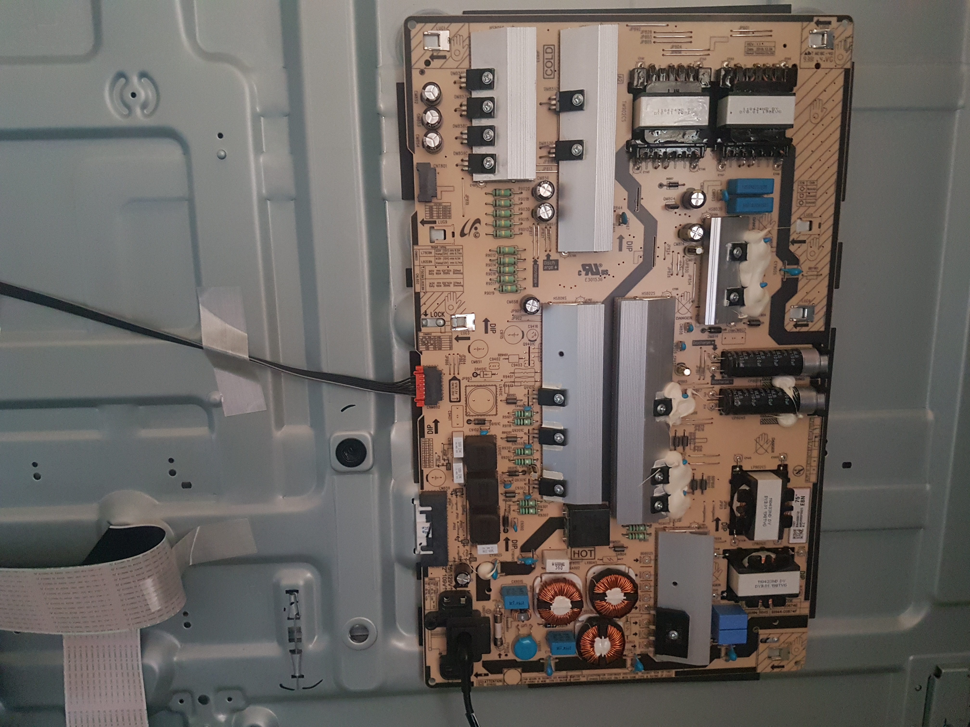

    That power button and LED plug into the MB. I rechecked the PS board for correct voltages and it looks good so I can't see where the problem might be.

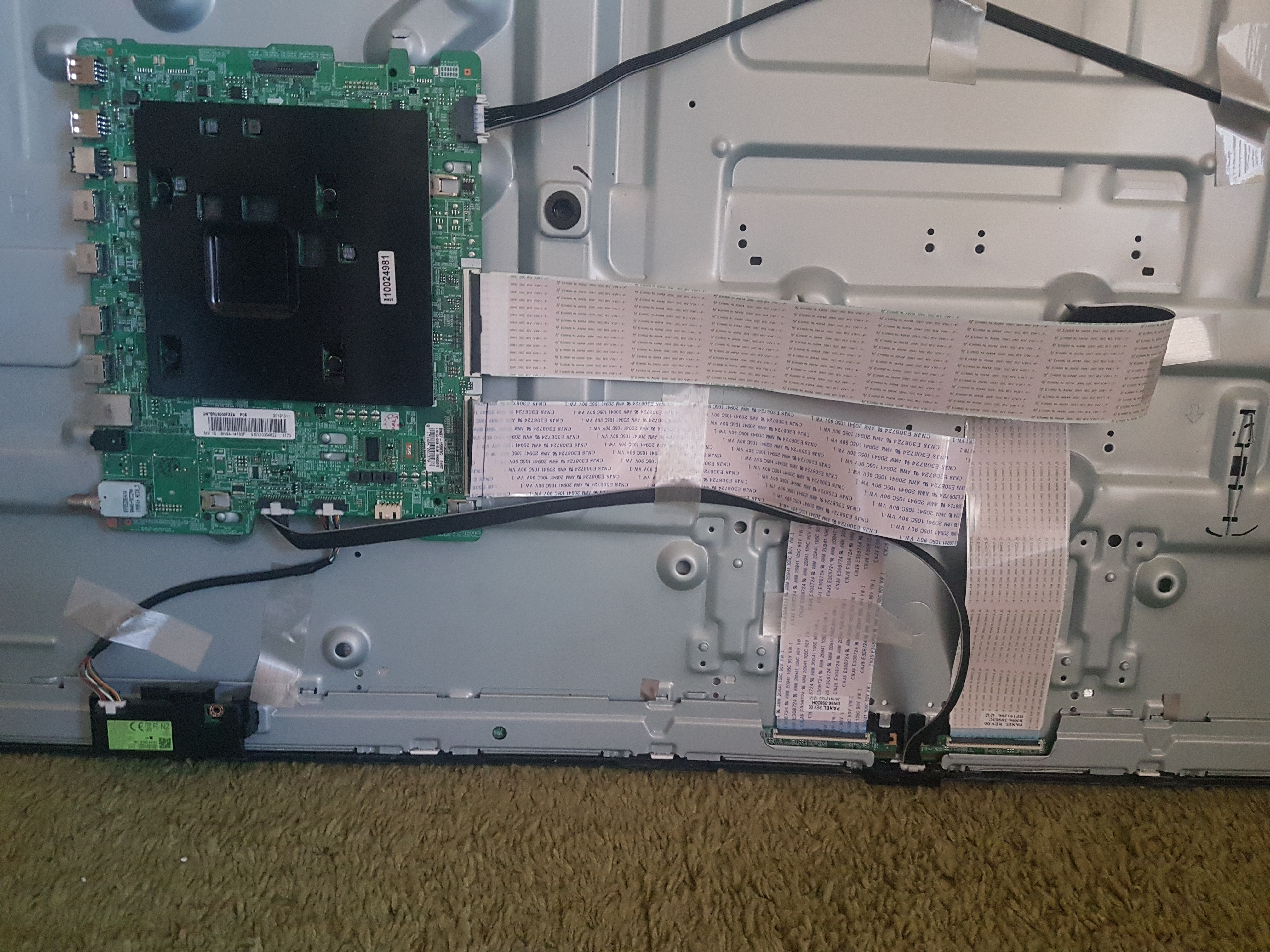

        Hello Reset,
        Well I tried your suggestion and something happened. First tried both ribbons discoed and lo & behold it stayed on. So then tried connecting just one ribbon and it stayed on. Both connected back to cycling on/off again.
        Then tried one again but the other side this time and it stayed on again. So the three times it stayed on there was only back lights on and checked the standby LED on the front and it didn't seem to be doing anything.
        Included are some pics of the rig. Click image for larger version

        So at 1st I thought the first disconned ribbon was a bad side of either the screen or the pcb that attaches to the screen and the ribbon. But that didn't hold up as the side I thought might be bad/toast was then connected and the other side not it stayed on. SO it's only when both ribbons are connected that it cycles again.

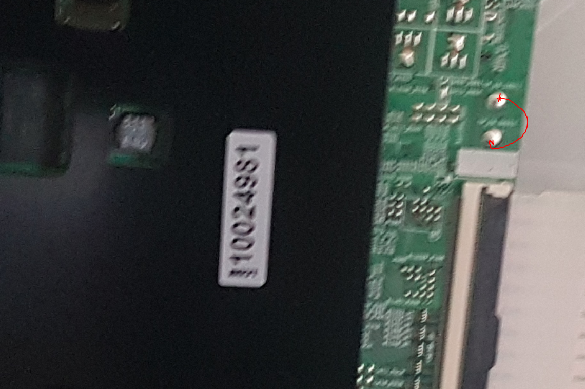

          You first need to install the jumper, and then experiment with lvds tapes.

            What's the jumper for or do and what am I looking to see or find ?
              The jumper creates feedback between the motherboard and the panel, when any lvds cable is disconnected, the connection between them is lost and the motherboard blocks the supply voltage for the panel at the t-con. When you install the jumper, you deceive the motherboard (as if the panel is connected) and now you can disconnect one cable at a time. check which half creates the defect.

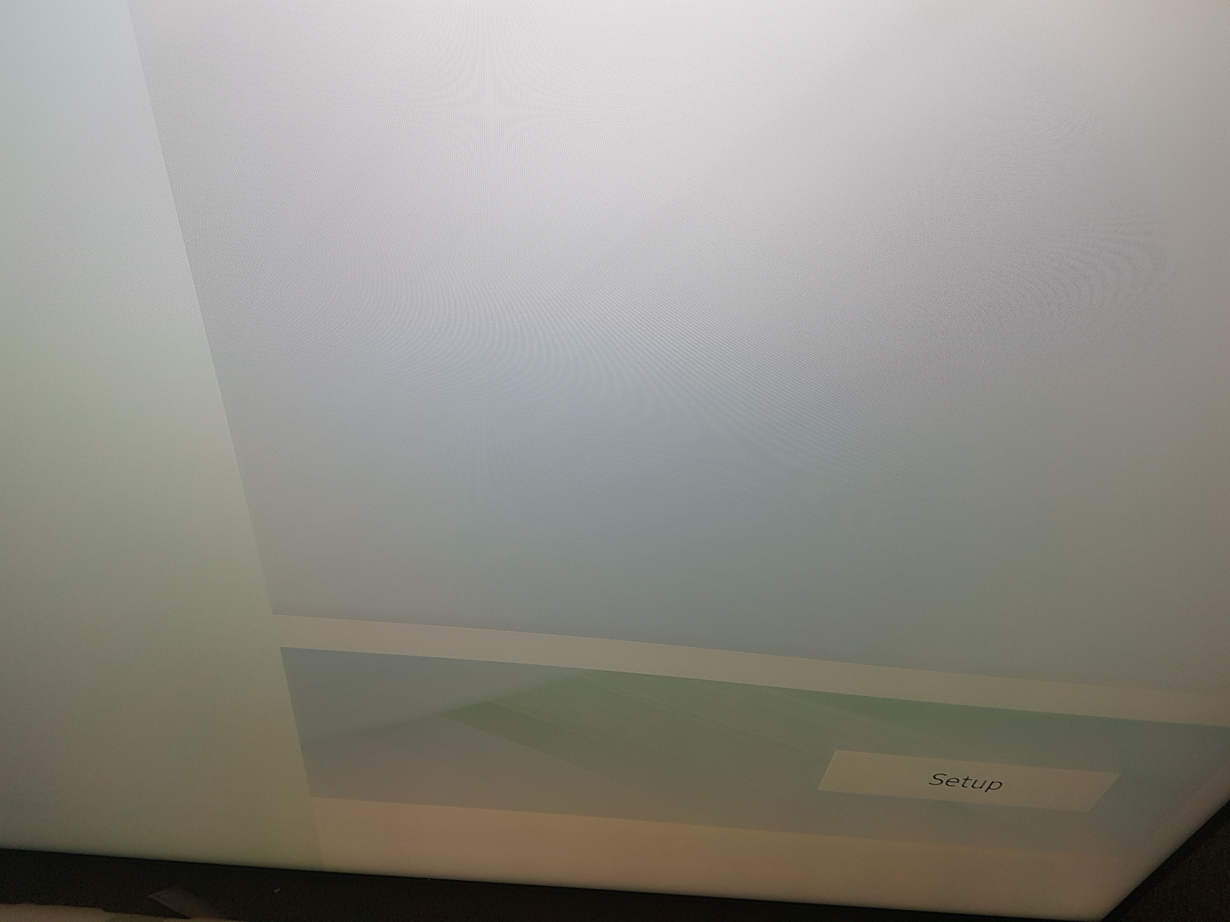

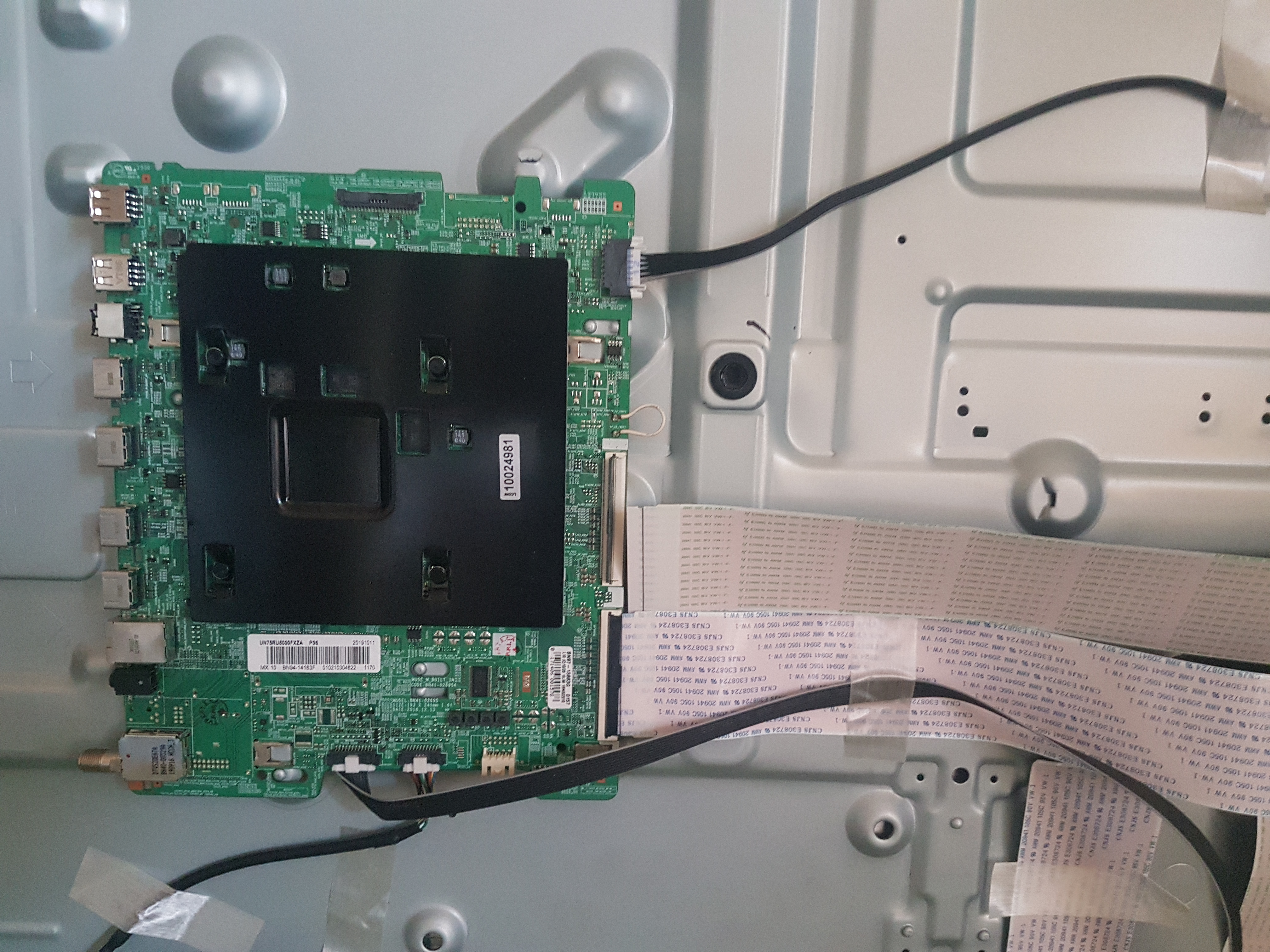

                    Hi I'm Back,
                    Well did the jumper trick and got one side of TV to display (Right side) When left side connected I get darkish screen backlit but no image. I'm guessing the screen is shot ?
                    Remember no separateT-Con. Or is there a component that can be isolated on the long pcb strip along the bottom of the screen the attaches to the screen ?

                        Can you post some good clear pics of "long pcb strip along the bottom of the screen" maybe someone can help from there.
