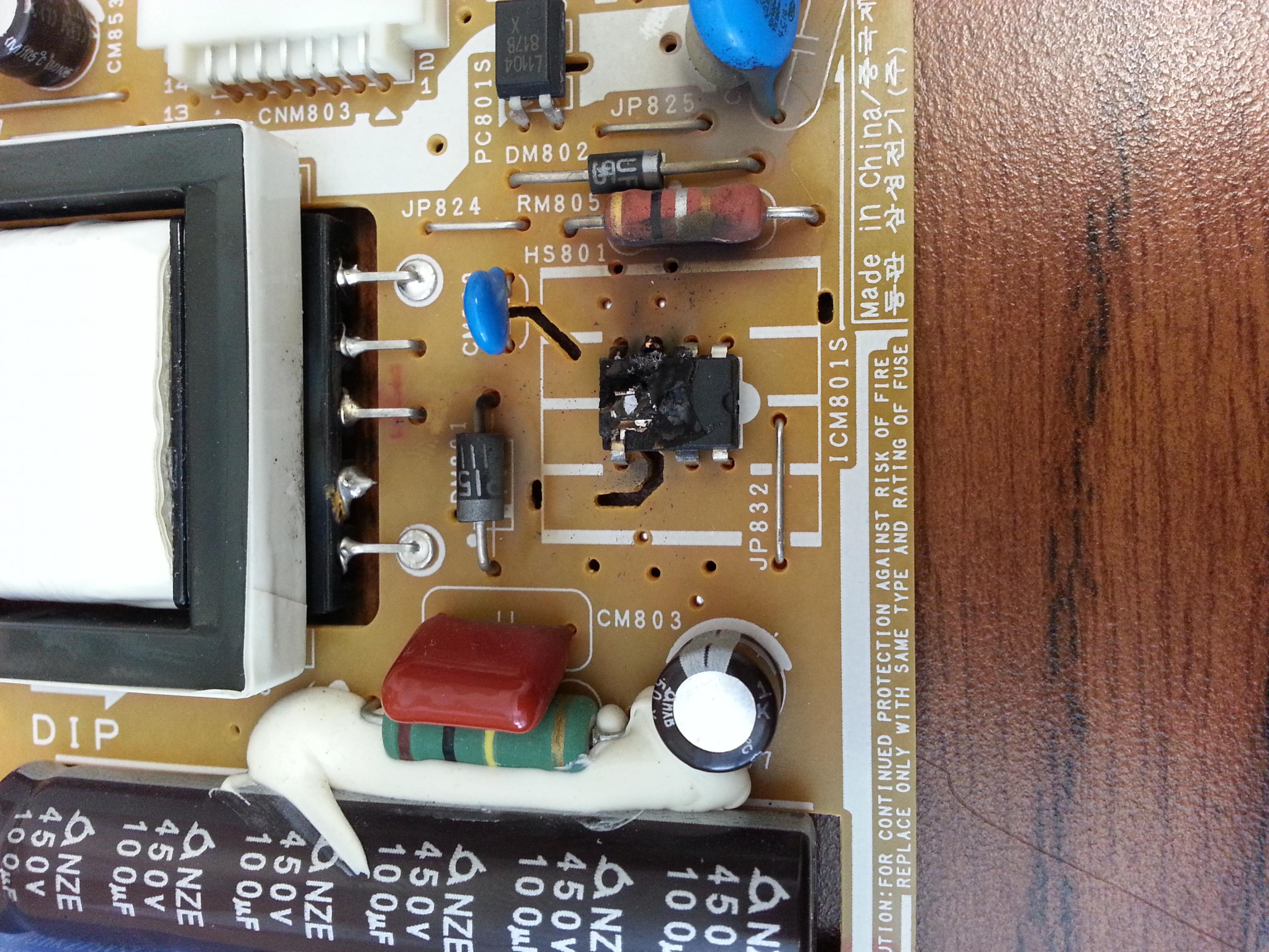

    I just bought a 22" samsung from craigslist
    The person I bought it from said that 2 of his tv's went out during a storm
    So he got his 42 inch fixed said it was a board but didn't know which one since a tech came out and fixed it
    He didn't want to spend anymore money fixing the 22inch
    So im hoping it is only a power board issue and not a fried panel
    So as of now there is no power at all
    I plugged it in and there is no led to indicate power

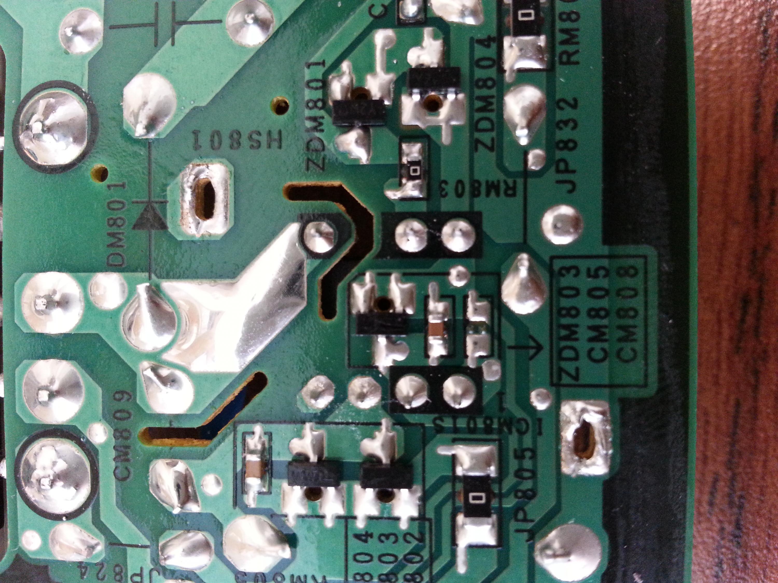

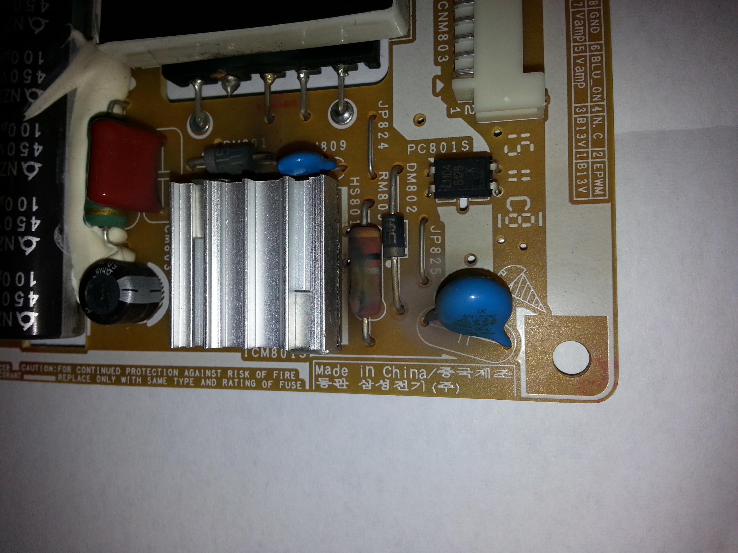

    As I suspected there is a blown fuse on the ps
    There are no visible blown caps
    Should I replace the caps?
    There are some burn marks on one of the resistors and 2 diodes
    I did check these with my ohm meter and I am getting readings but im not sure how to test these
    So how do I test these before I replace them or should I just replace them?

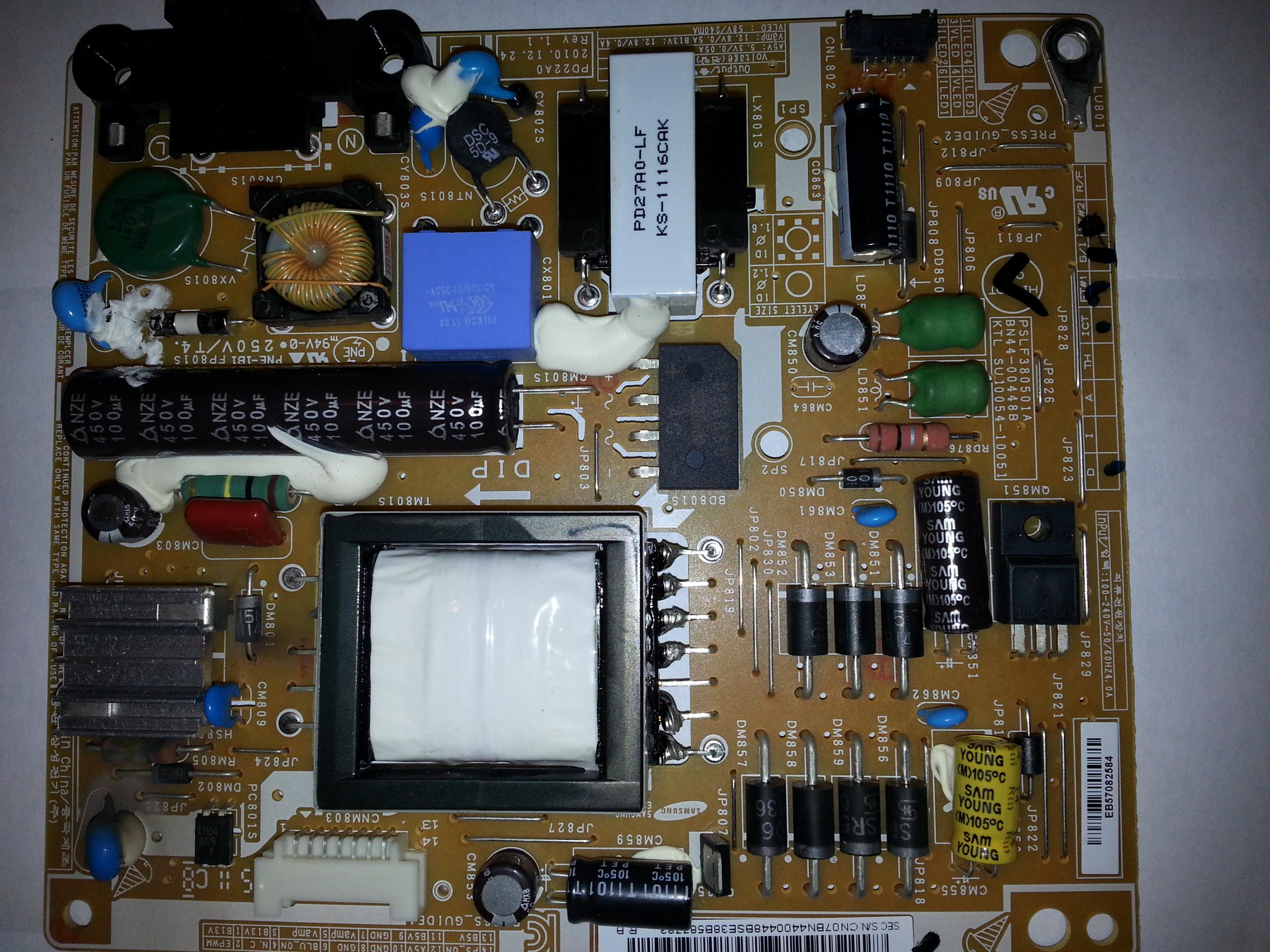

    I'd check the power supply for shorted FETs.
    • jose6326
      • May 2013
      • 707
      Re: samsung UN22D5010 no power
      How do I test these?
      Do I just ohm them out?
      What kind of reading should I get?
        Yep -- just measure all three combinations 1-2, 2-3 and 3-1 (arbitrary numbering; but be consistent with each device.) A reading below 30 on diode test, or below 100 ohms is indicative of a potentially failed device. Suspect devices should then be removed and tested out of circuit to verify if they are actually failed.

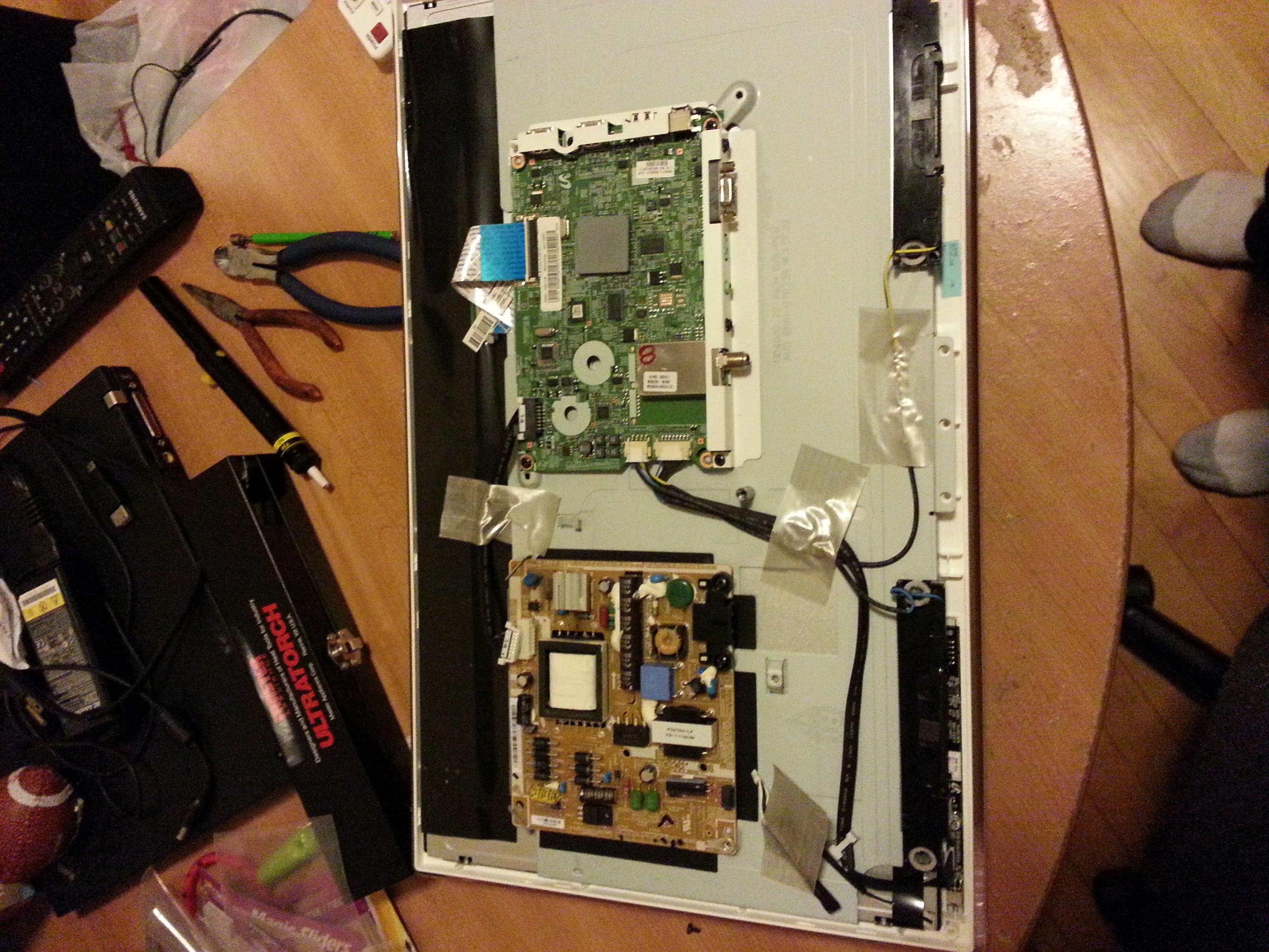

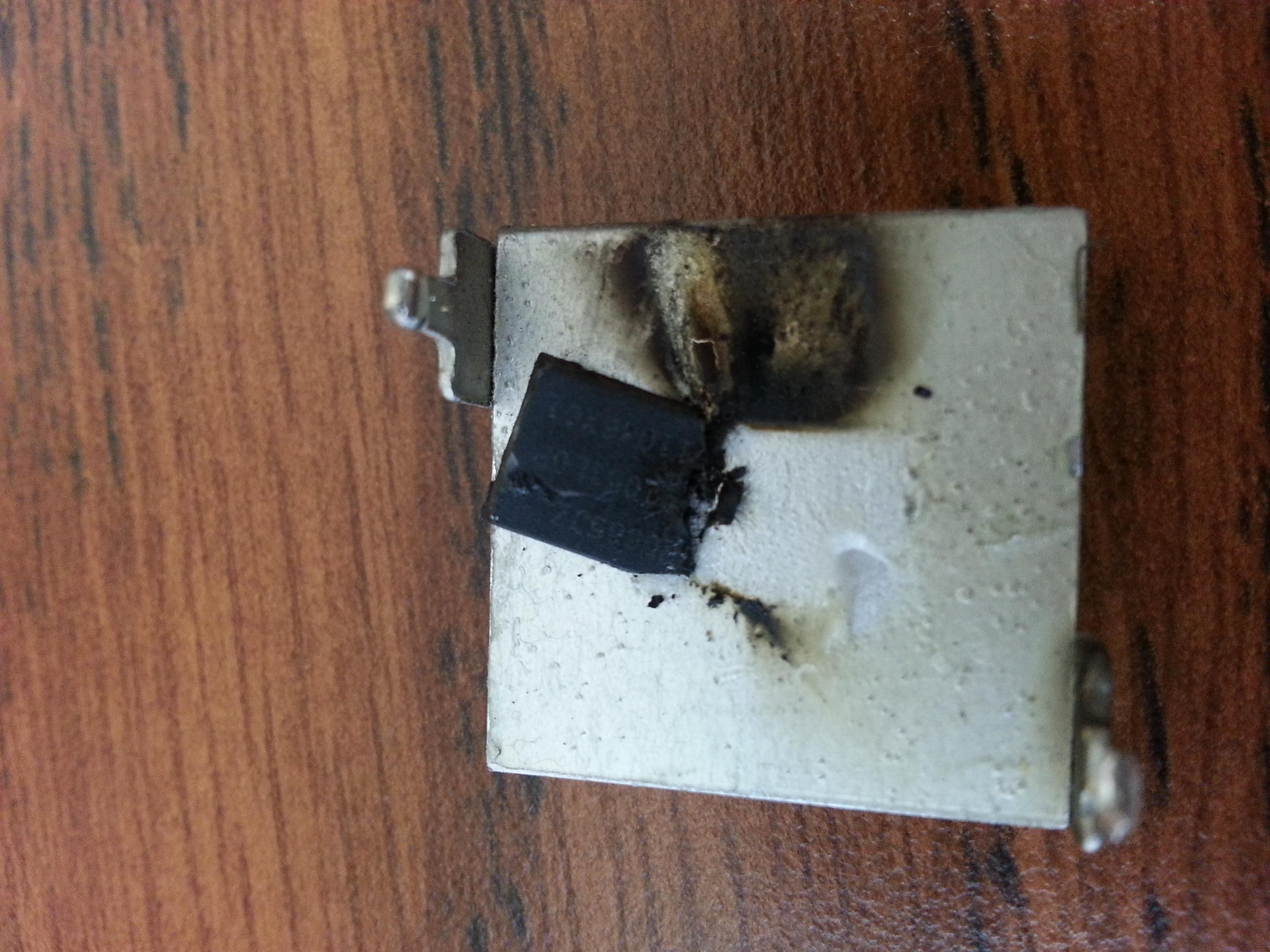

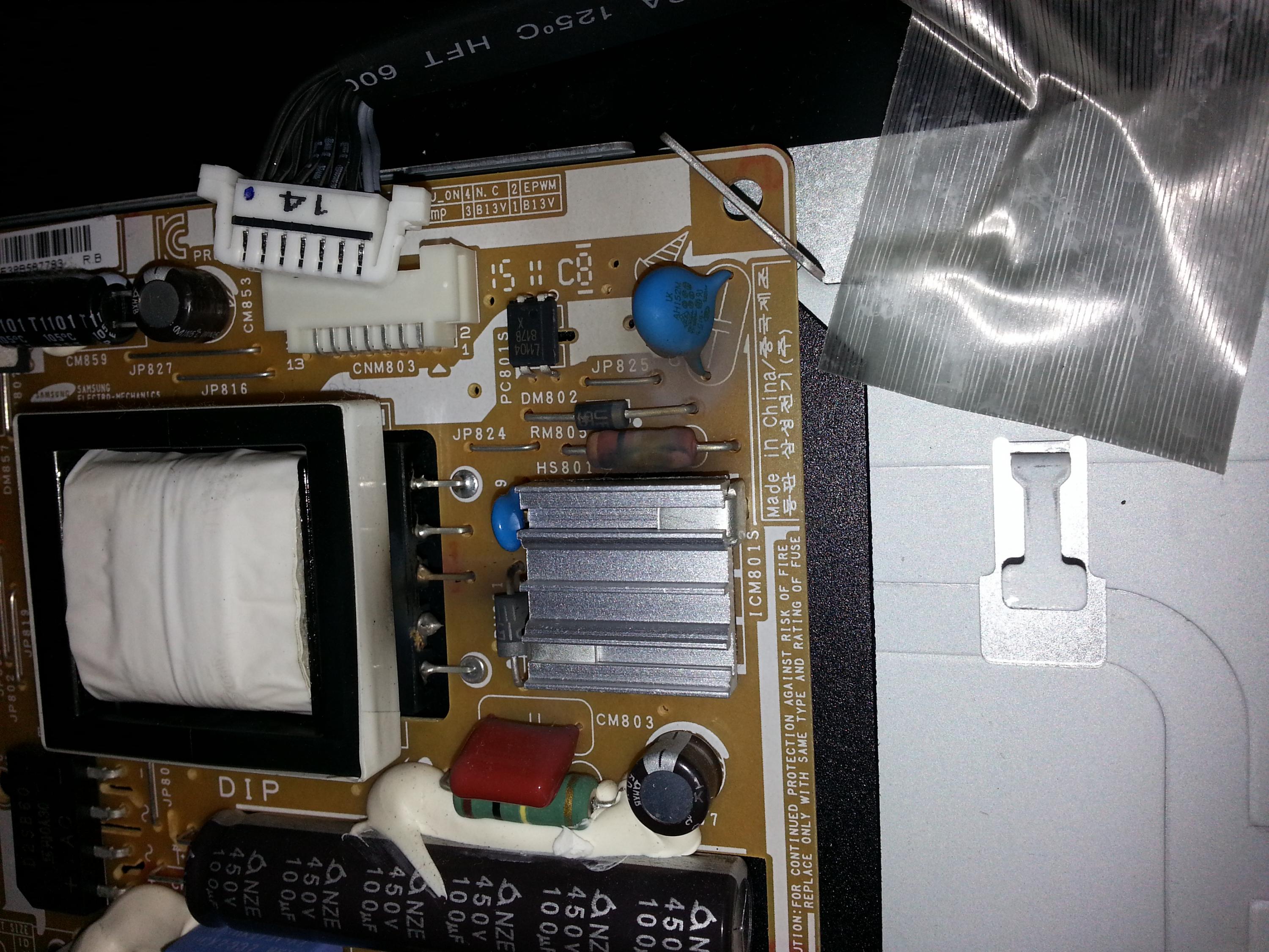

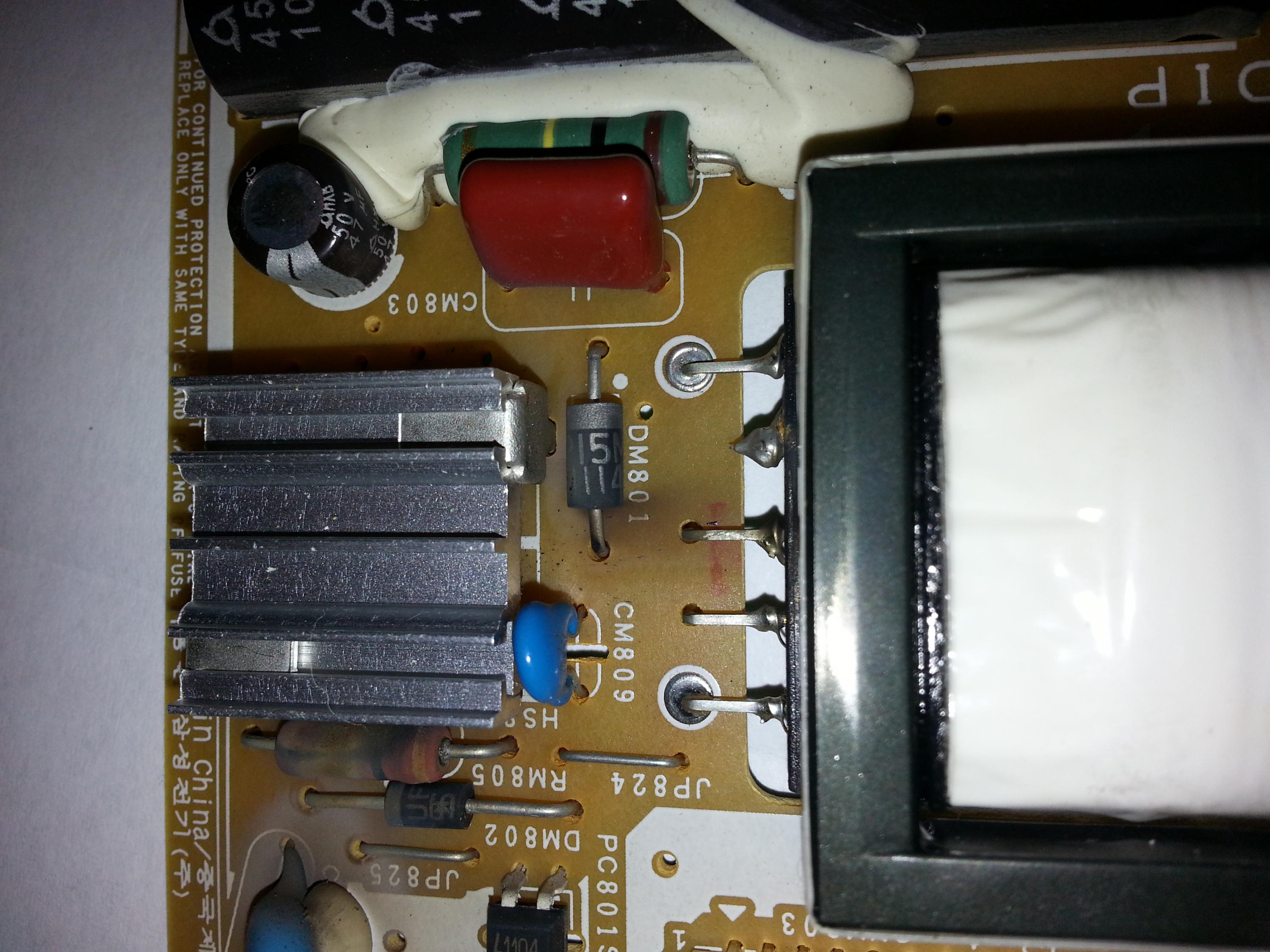

          tom i brought the board to work with me to show the electronics guy
          he says he does not see any fets on this board
          but he did say what the problem is
          he found a burned chip under the heat sink
          see pics
          he said more then likely this is what took the hit and he is almost positive the other parts should be ok
          only problem is it is hard to identify the chip
          see pics
          we were able to get some numbers off the chip that melted to the heat sink
          asterisk indicates possible missing characters
          **RU665JZ
          ***1051L0P
          ***11046X01
              That is probably your problem. Those devices contain an internal power FET. It looks to me like you'd only need to replace that device as it is an all in one power switcher. The part number is burned to the heatsink -- you'll need that.
                      I have seen this SMPS IC before, ICE3BR0665JZ
                      Verify that the snubber network is OK also.
                        thanks for the help budm
                        i actually put the burned part back on and i was able to read the rest of the numbers
                        which is what you said BR0665JZ
                        where can i buy this?
                        how do i check the snubber network?
