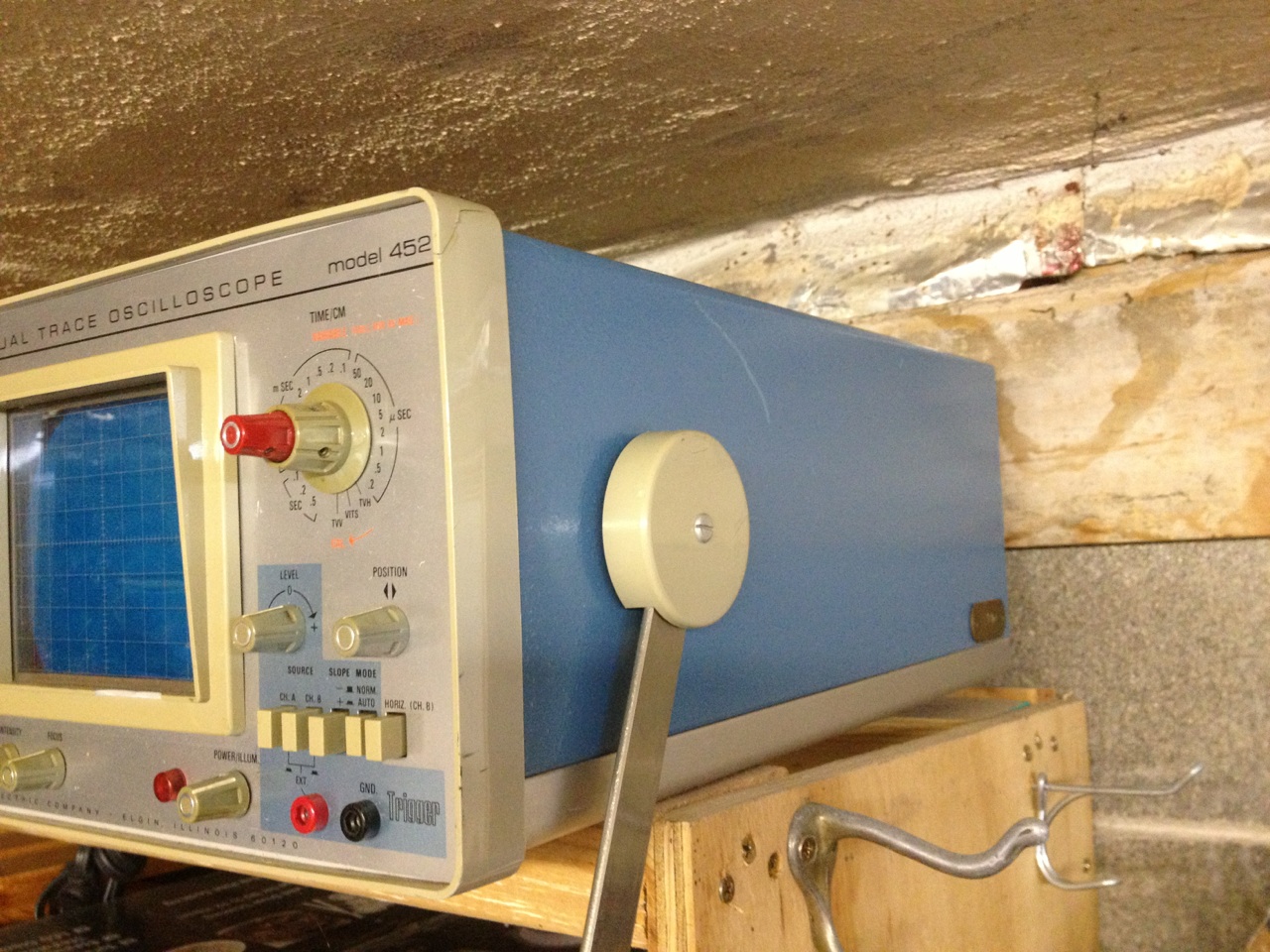

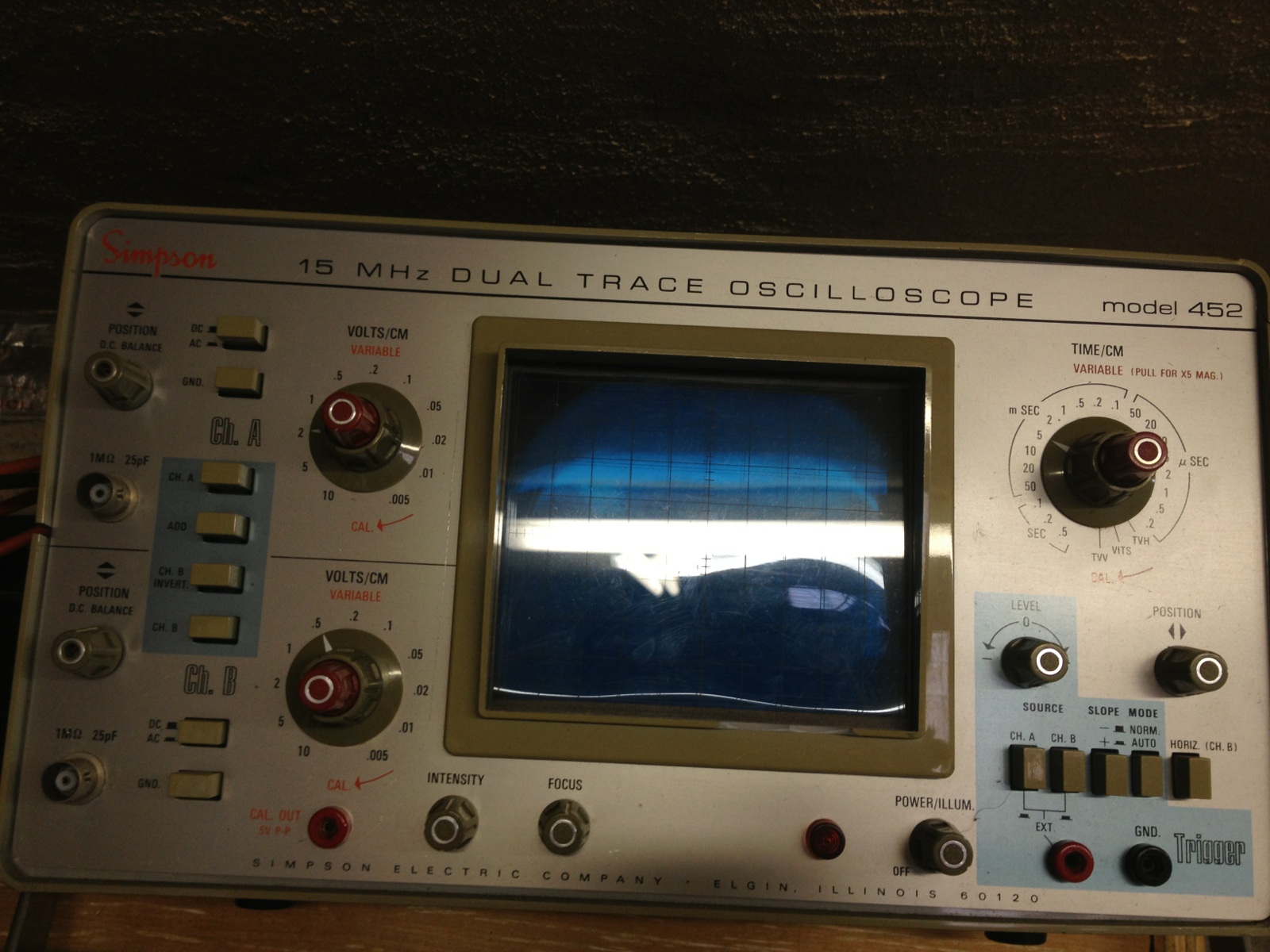

            hey tom im thinking of buying this o scope
            do you think it's worth buying for diagnosing issues on lcds and plasmas?
            it is a simpson dual trace o scope model number 452
              Re: samsung UN22D5010 no power
              It is probably only just about good enough for most uses, but how much will it cost you? I would pay up to $30 for that, because it would be useful for most repairs, but may struggle on some types of diagnosis.
              • jose6326
                • May 2013
                • 707
                he was asking 75 but i got him down to 50 bucks

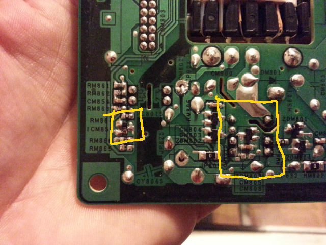

                      Here is a pic of the surrounding components
                      New Ic is under heat sink
                      How should I test each component?

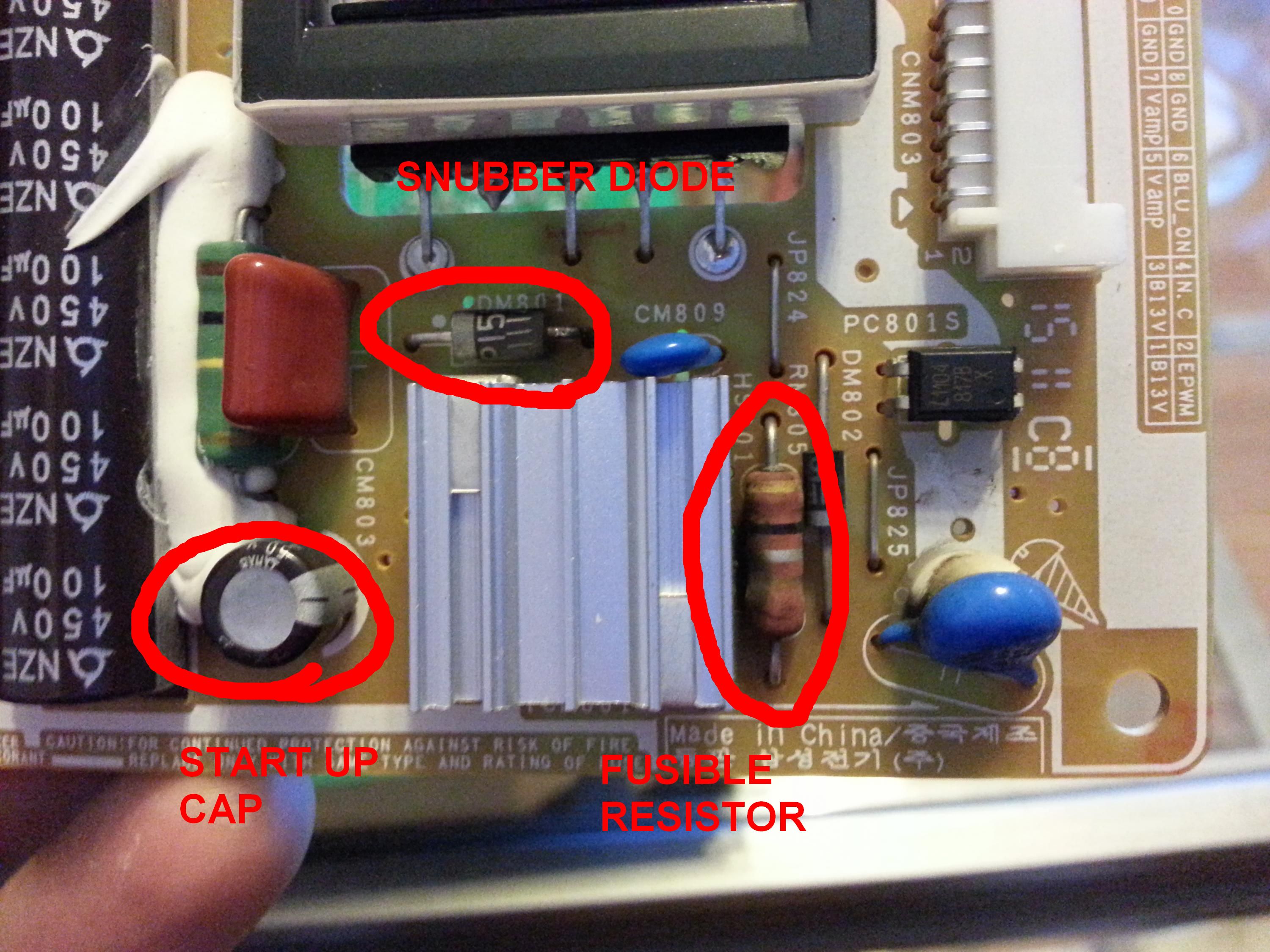

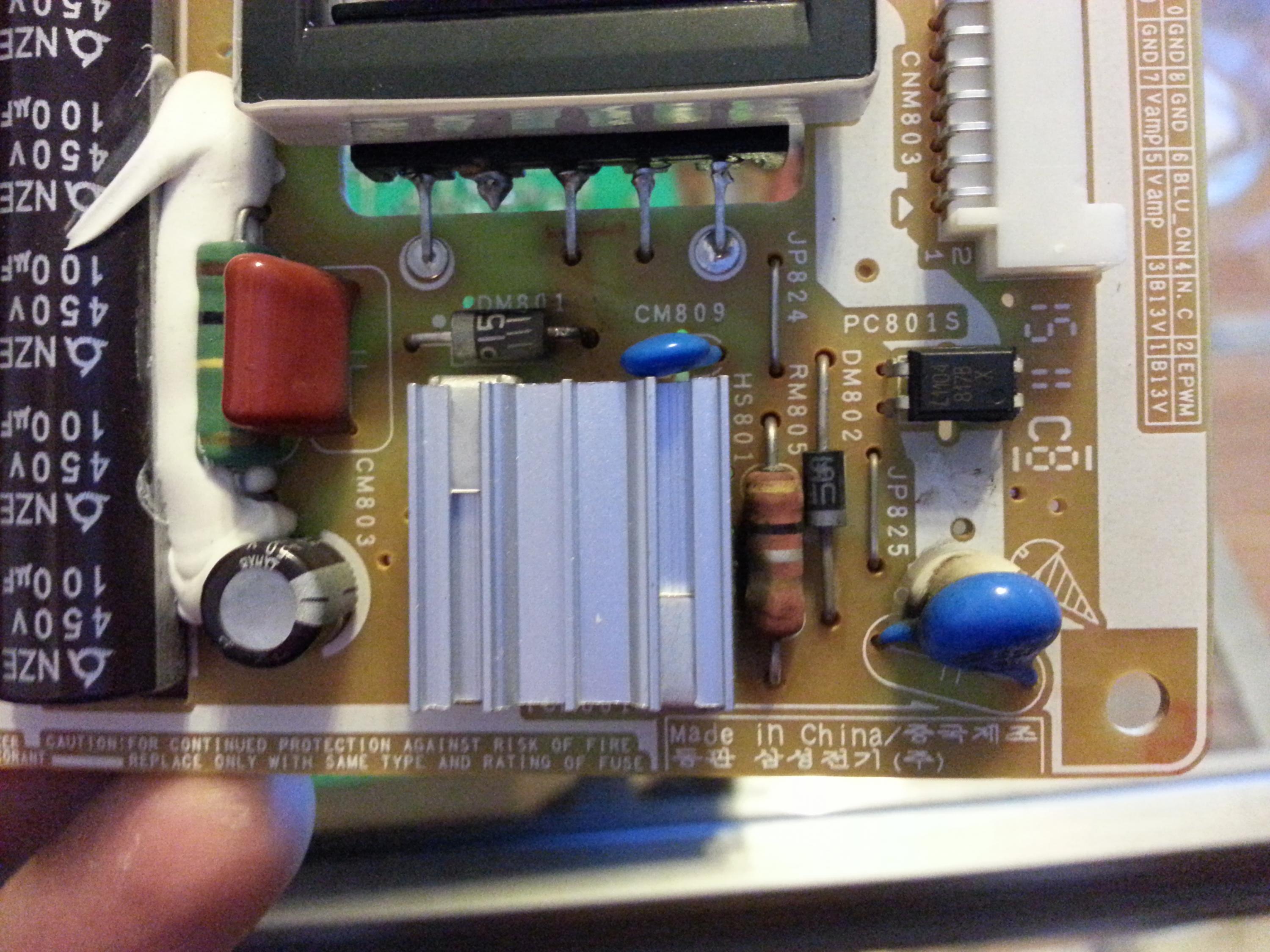

                        It looks like the IC mostly blew out to the right, but I'd test these components. You may have to de-solder one of the leads on each component if your readings are questionable:
                        - Resistor (RM805): Ohm scale on meter.
                        - Diodes (DM801 and DM802): Diode mode on meter. Place your meter leads on each lead of the diode, respectively, record the reading, then swap your meter leads. You should get a reading in one direction (something like 0.5V) and no reading in the opposite direction.
                        The blue cap to the right of JP825 appears to be fine. I'd also flip the board over to look for components in the vicinity that could have been damaged.
                            It actually blew out to the right and forward towards the transformer
                            I think I found a shorted diode
                            DM801: 0.470
                            Dm802: OFL
                            RM805: 0.5 ohms
                            CM809: 6.95 ohms then it starts to go down
                            Blue cap next to JP825 reads OFL on ohm setting
                            • jose6326
                              • May 2013
                              • 707
                              #34
                              I just found a blown component
                              Its one of the extremely small chips
                              I dont know what its actually called
                              Is this difficult to remove and replace?
                              How am I suppose to figure what part number this and order?

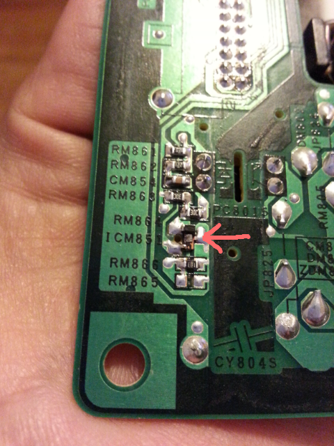

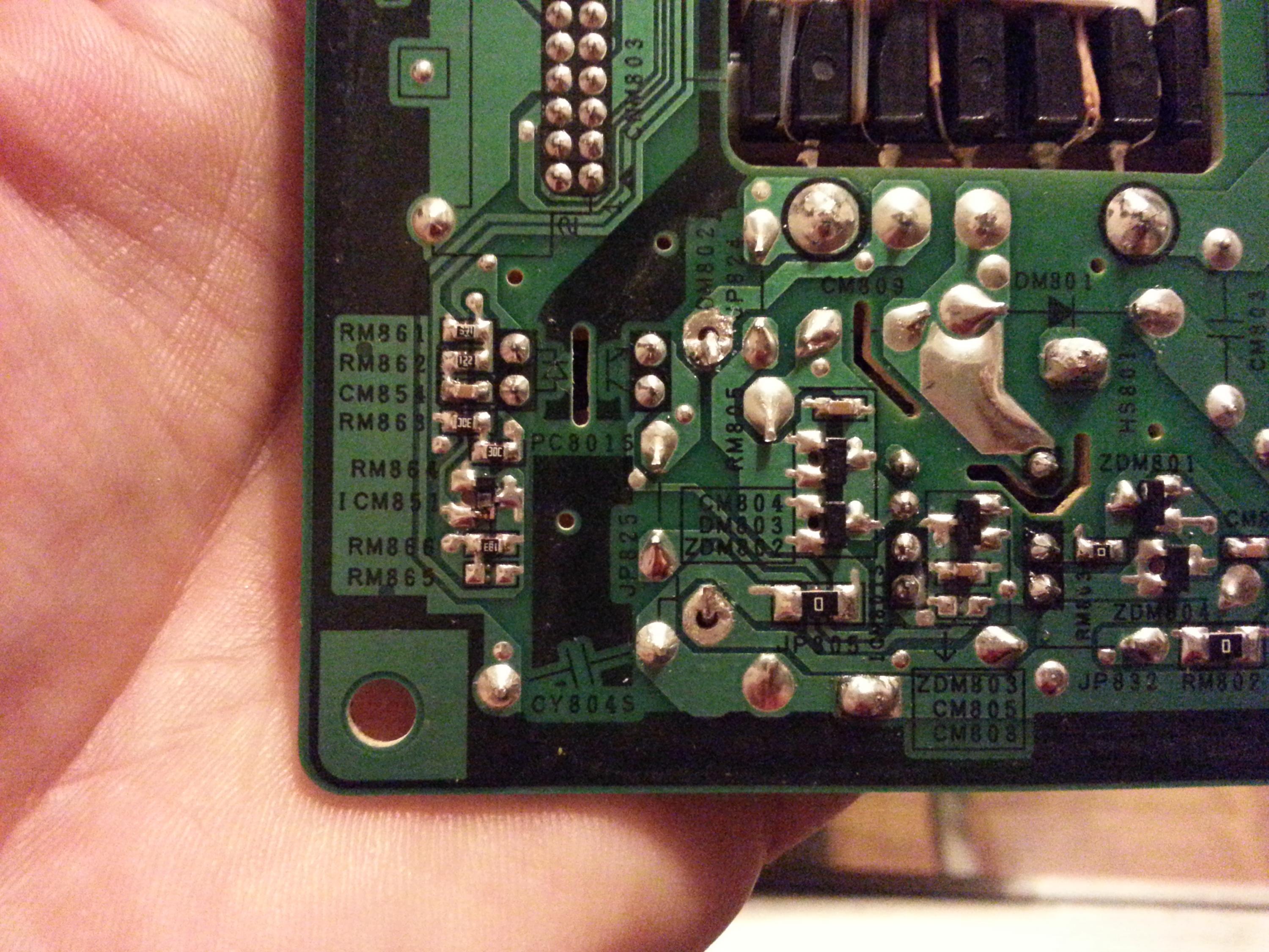

                                  #36
                                  Can I see the bigger picture on on that back side so I can see how that blown IC are connected to the blown part? Make it JPEG.
                                  That blown device ICM851 is going to be hard to know what it is.
                                  • jose6326
                                    • May 2013
                                    • 707
                                    #37
                                    Yes the burned component is near the newly repkaced ic
                                    Bud I am taking pictures with my note2
                                    So im not sure if I can make tbe pics jpeg
                                    • jose6326
                                      • May 2013
                                      • 707
                                      #38
                                      I hope the pics are good enough
                                      They are both the same I just boxed the location of the new ic and the burned component in yellow
                                      If you need more pics let me know
                                      Thanks for all the help
                                        #39
                                        OK, that part is more likely to be the ref Diode which is part of the regulation feedback. Since it burnt so bad, that means the surge must have come through the Cold secondary side of the circuit, so more likely you will have more damaged parts in the power supply and the main board.
