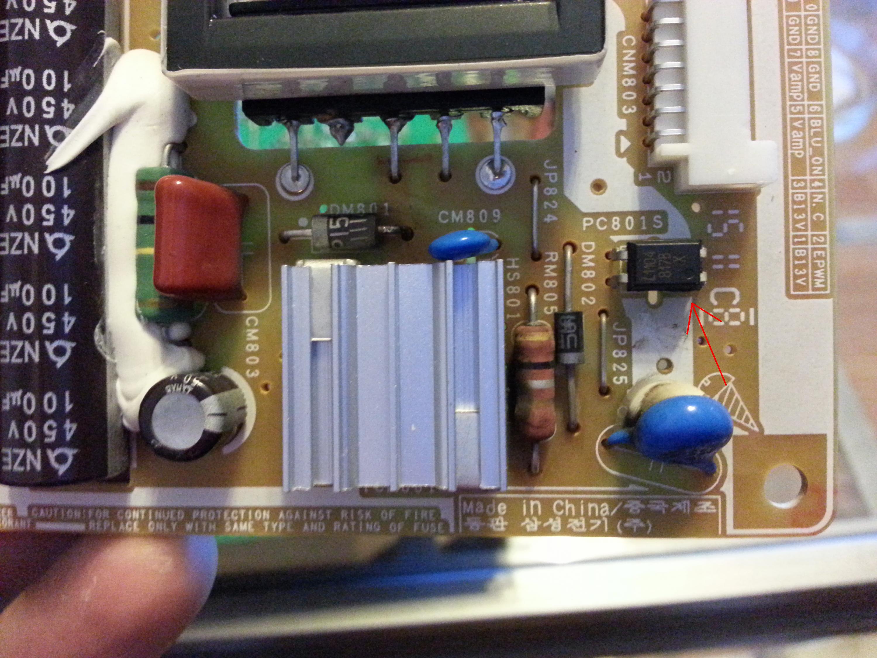

            i did a search on PC801S and i just kept getting data sheets that led me to other electronic components i dont need
            i went on digikey to see if i can find it
            there are numbers on the opto but i dont know which one is the part number
            here is what it looks like
            1104
            817B
            there is what looks like the letter L before the numbers 1104 but i think it is the logo of the manufacturer
            i typed in the numbers in different ways and the closest i found was this on digikey
            http://www.digikey.com/product-searc...rt=LTV-817B-ND
            there is no pdf on the lite-on opto only for the fairchild one
            the difference between the two is the fairchild opto has a 70V output compared to the 35V output on the lite-on opto
            i think the lite-on opto is the original one i need since it is out of stock and everything i have been needed has been out of stock
            i attached the pdf of the fairchild opto
            budm please let me know if this is an equivalent replacement
            thanks
              #66
              Re: samsung UN22D5010 no power
              It is a PC817.

                    • jose6326
                      • May 2013
                      • 707
                      #70

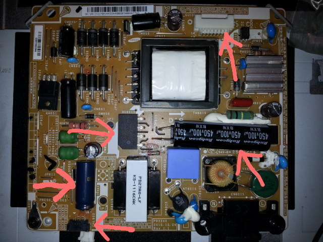

                      Ok I replaced the opto, all the caps and the really small chip on the back side and still nothing
                      I am getting the 120 line voltage
                      I checked voltage at the large cap 171.1v
                      and medium cap .595
                      I also checked voltages at both connectors
                      White connector is 0.000 at every pin
                      Black connector is .6 at every pin
                      So im guessing there is something else that is defective and not letting the power come thru
                      What else should I test?
                      Not sure how to test rectifier

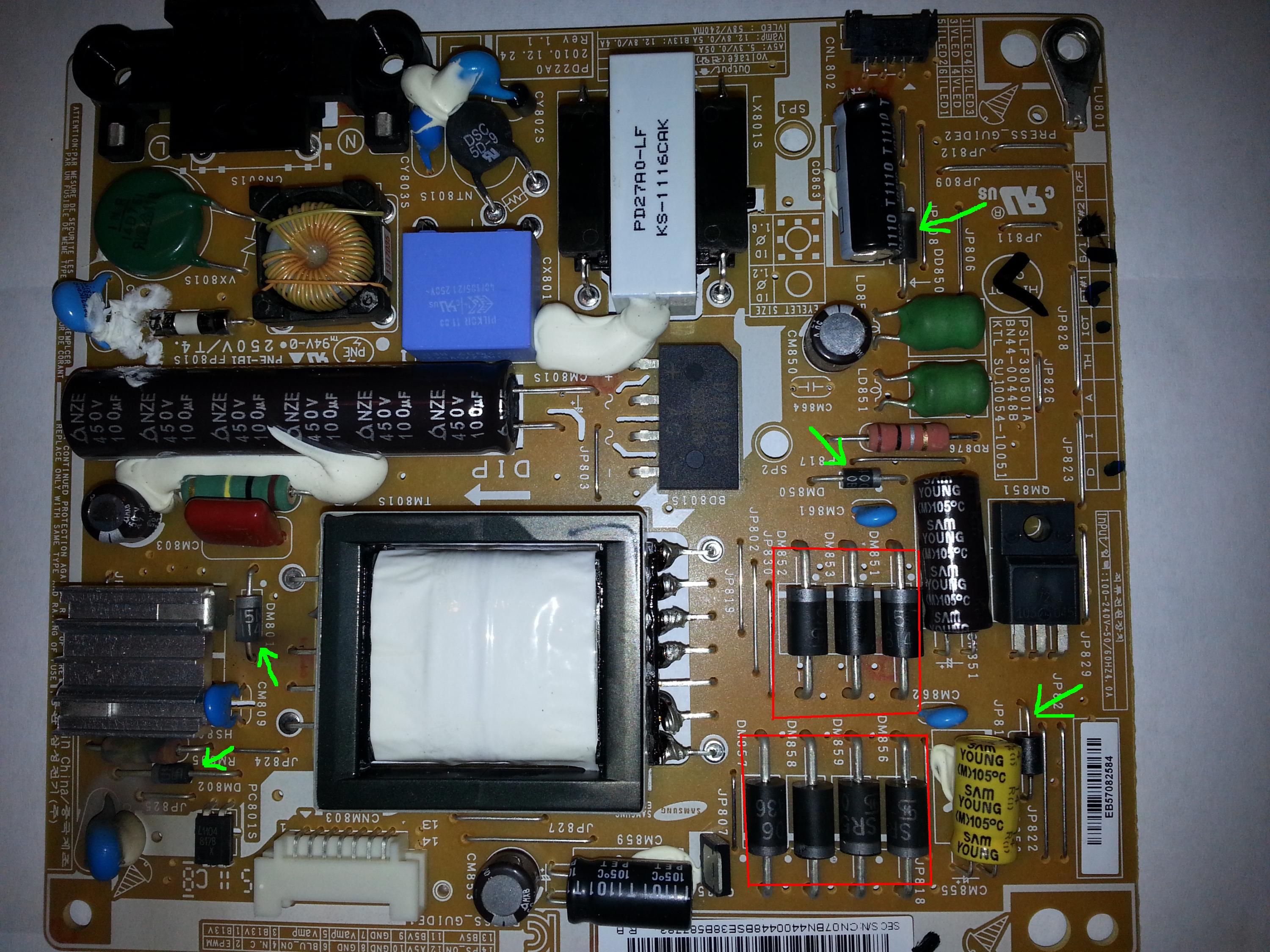

                              #74
                              i forgot to ask
                              when i installed the opto does it matter the postion i install it?
                              i figured i would install it the way the original was installed but it may be pinned differently
                              also i tested the diodes on the board and the ones in green tested good
                              i got readings one way and not the other
                              but im not sure about the components in the red boxes
                              are these diodes?
                              i tested all of these and i was getting readings both ways
                              i will retest again
                                #75
                                Yes, the Opto has the LED emitting side and the Photo transistor side.
                                Those are Diodes.

                                  • jose6326
                                    • May 2013
                                    • 707
                                    #77
                                    retested the diodes according to the youtube video
                                    http://www.youtube.com/watch?v=_3G8t-cV1d8
                                    All 3 diodes in the red box read 0.000 whether i change the leads positive to negative or vice versa
                                    The other 4 diodes in the red box I get 2 readings
                                    If I put the negative probe on the leg of the diode with the silver line I get 0.132
                                    And thats for all 4 diodes
                                    When I put the positive probe on the leg of the diode with silver line I get 1.435 and it continues to go up to 1.644 and slows down but still continues to go up
                                    This is for all 4 diodes
                                    Are all of these diodes defective?
                                    https://www.badcaps.net/forum/attach...&d=1377709100I

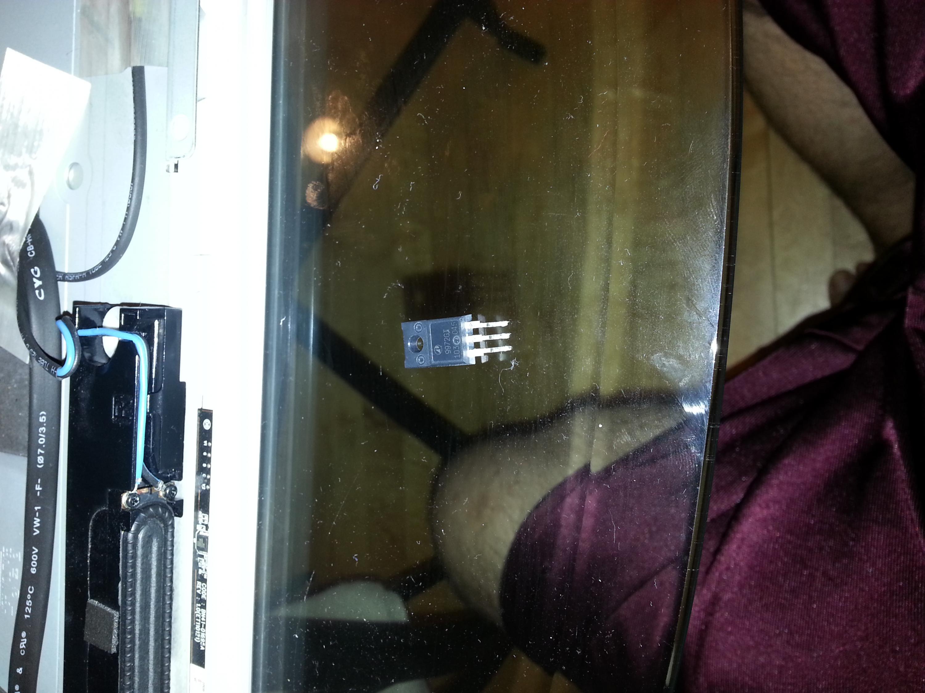

                                      I also tested the mosfet off the board
                                      Here are the readings
                                      Starting with positive probe
                                      1-2: OFL (open)
                                      2-3: 0.000
                                      1-3: OFL (open)
                                      Starting with negative probe
                                      1-2: OFL
                                      2-3: 0.486
                                      1-3: OFL
                                      Not sure if defective or not
