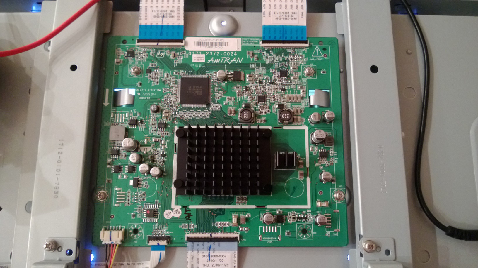

    Was watching my Vizio XVT473SV when the screen began to flicker and make a high pitched chirping noise. It looked a lot like interference with a signal (from the old analog days) and the brightness of the screen fluctuated quickly. This happened for about 3-5 seconds over the course of 30 minutes in which I finally turned the TV off.
    When I turn the TV back on, the VIZIO logo turns on, the screen goes through its normal boot cycle, and then it darkens slightly. I can hear the sound of the input and can tell the remote is working (can hear channels change and can power on and off the TV).
    With my inspection I found no signs of blown caps or any visible issues on the board.
    I am hoping it is simply a regulator / board versus the whole LCD panel. Help!
    Most of the components are LG or amTRAN

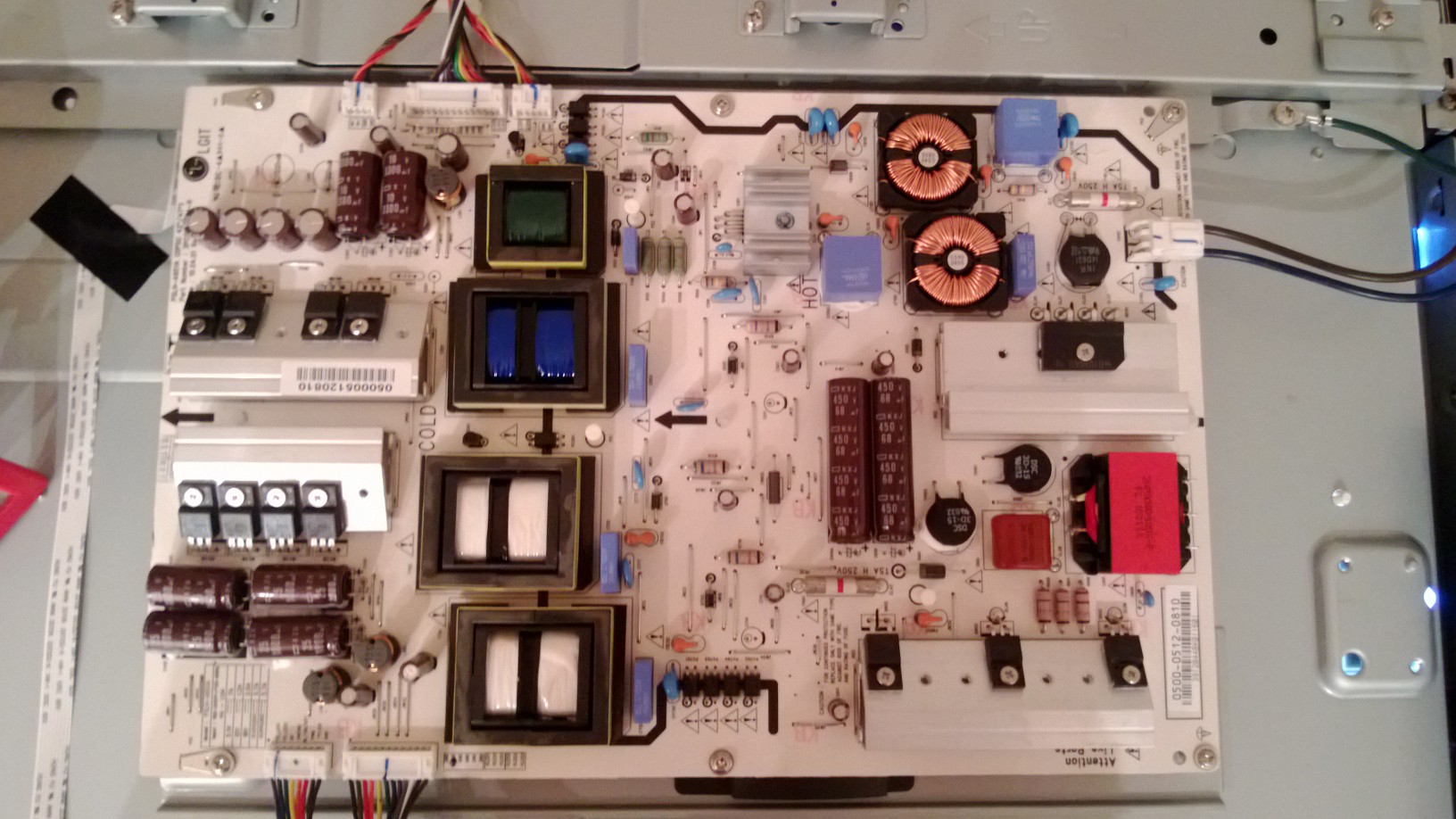

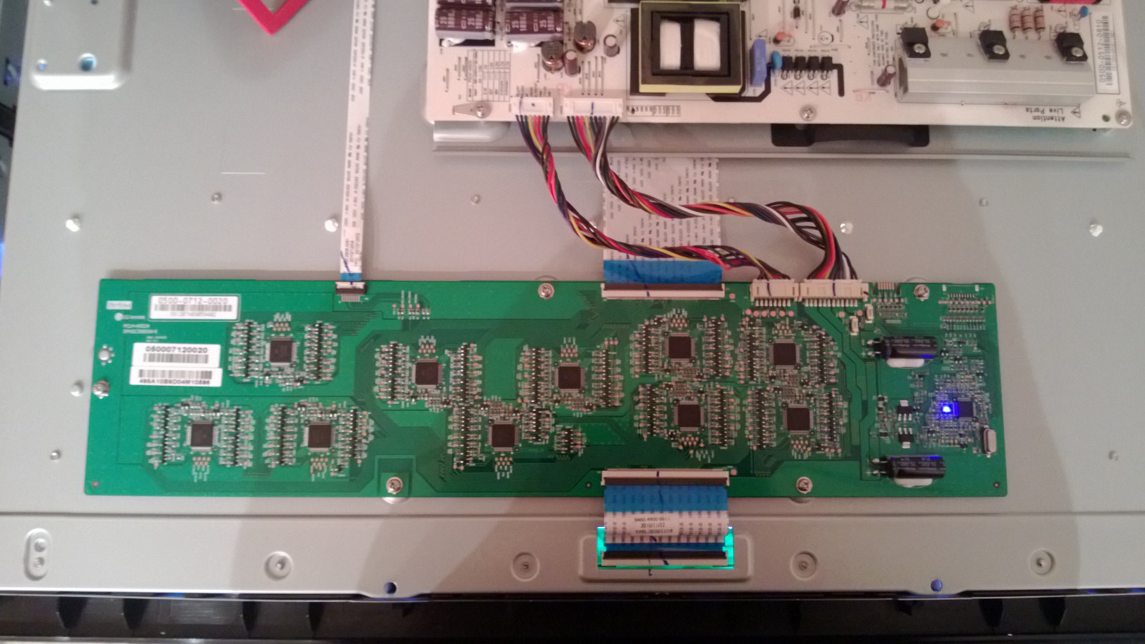

    1. Inverter board: 0500-0712-0020
    2. Power board: 0500-0512-0810

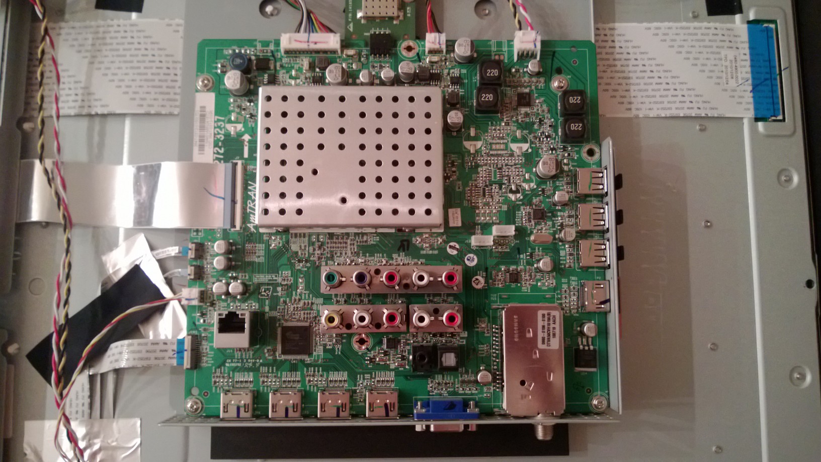

    3. Main board: 0171-2272-3237
    4. Tcon board: 0171-2372-0024

    I am getting voltage out of the T con board into the LCD panel. Does this mean it isn't the tcon board?

      Fired up the TV today to check it out and I got it to work...for about 5 minutes. The back light is still working (that means the inverter is good, right?).

        When it is not working, do you get all the correct output voltages out of the power supply?

              I believe I get the correct voltage from the power supply. I am able to read 12 and 5 volts in multiple spots on the boards.

                So I replaced the T-Con board and the TV worked for about 5 minutes (as it did before replacing the t-con board. I am back in the same place. Could it be anything else but the main board at this point?

                    I replaced the Main Board and it works like a charm.
                    I replaced the T-panel at first but that did not work.
