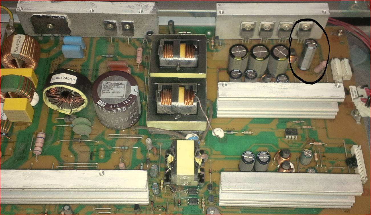

    Have a Vision Quest LVQ-47HLR-FHD, Model No. 126 (Rembrant) TV, that when powered on, goes to a test pattern screen that flashes a different test pattern aprx. every 5 seconds or so and will not respond to presses of any buttons, ie: Menu, Input, etc.
    The screen seems quite fast to come alive after power on, and also quite bright even in a well sun lit room.

              I did find a capacitor on the PowerSupply board that was bad. 1000uf35v
              I do have a meter that can check the caps so plan on removing them one by one to check if I can find any more.

                          I fixed it today!
                          The original 1000uF 35volt capacitor I showed earlier on the power supply board.
                          Their are 4 680uF 63Volt capacitors on the two sides boards....they looked a little bulged on the end....who would of thought all 4 measured badly with my meter. Replaced all four and it fired right up!
                          Took me a few extra minutes to figure out how to switch inputs without the remote.
                          1. hit Input
                          2. volume up/down until you have the right one sleected.
                          3. Hit both channel Up+Down at the same time to select.
                          Nice sharp picture!

                            I ran the TV 24hr/day since I posted above. Turned it off last night ......turned it back on this morning and same symptom of lines on picture.
                            Just when you think you got it all figured out.....
                              Re: VisionQuest LVQ-47HLR-FHD, Model No. 126 Stuck on Test Pattern?
                              I give it back to the User and he has now been using it for a couple of months ......says it works fine.
