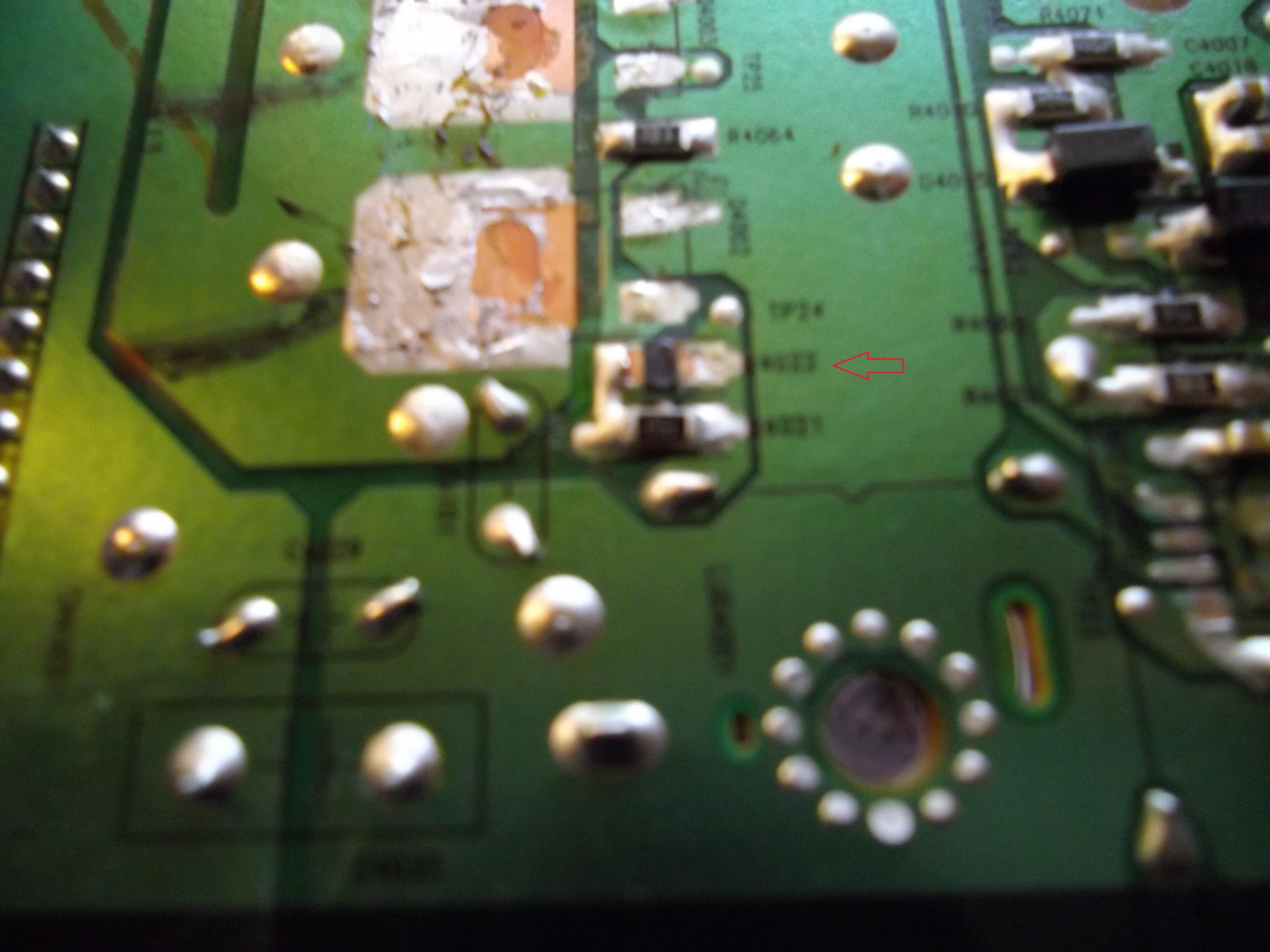

                          Hello All
                          I have this same model tv. I was removing one of the four fets that are part of this tv's x main board common failure. In the process I had a resistor pop off the board. Its board location is r4022. Its so small that I can't locate it. Perhaps someone here knows the value of the this missing resistor?
                          Thanks In Advance,

                            Re: Samsung model # PN43D450A2D Black Screen Red Light
                            It should be the same as the one next to it, (150) 15 ohm. You need to do a better job removing those transistors, you ripped the traces under them. that can effect their heat transfer during operation. Try adding flux and more heat next time
                              Hello RJ
                              I wondered if it had the same value as the one next to it. (150) 15 ohm. What
                              rating/tolerance would you guess it is? Size type? 1206 as an example. This was my first repair attempt using a hot air gun. I will take your advice though for next time.
                                The way to remove the surface mount fets is:
                                1. Add fresh leaded solder to both legs. If you have a thin tip, go behind the legs and heat the pad and pry up. You can use a pick also, just make sure solder is molten.
                                2. Then add some solder to the main pad and heat the crap out of it. Dont use a heat gun, you will only f#%@ things up. It will lift right off when hot enough.
                                3. To replace the fets, put some fresh solder on the main pad, and when molten, place new fet in place, using tweezers. Flow some solder over the tab, then solder down the legs. This way you shouldnt rip off traces.
                                  Hello Again,
                                  (150) 15 ohm. What rating/tolerance would you guess it is? Size type? 1206 as an example. I just want to be sure before trying to source a replacement resistor.
                                  Take Care,
                                    You would have to measure the size, I can't, I'm sure 1/4 watt or 1/2 watt would be fine
                                      It's 1206, I've repaired a few of these now
                                      If the resistor popped off the board it might be bad, so check its cousin is not open circuit
                                      If that's open circuit you'll almost certainly have to replace the driver IC for them. In fact I'd generally recommend it anyway unless you can be sure its OK as it might just pop the new IGBTs again.
