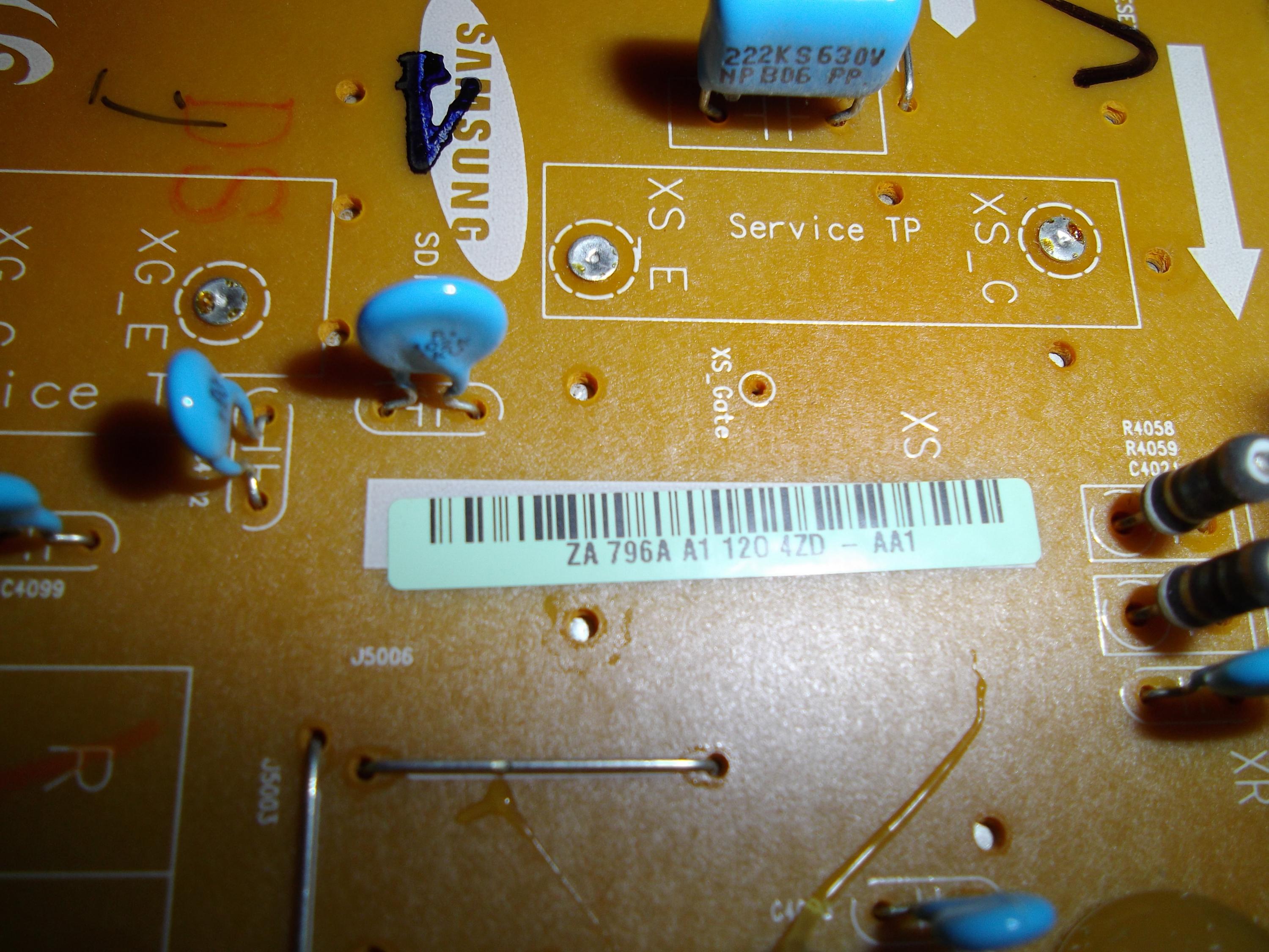

    I'm attempting to diagnose a 42" Samsung Plasma model # PN43D450A2D with black screen red blinking light.
    When I plug it in, it exhibits the typical relay clicking a few times and nothing on screen, nor any sound.
    Visual inspection shows no signs of bad caps leaks or bulging or any other visual overheat issues.
    If I dis-connect either the x or y board it makes the "samsung" sound and responds to remote turn on / off, but still nothing on screen.
    I checked the single ceramic fuse for ohms with power off and it seems fine.
    I pulled the y board to inspect the back for visual issues and see none.
    I'm fairly new to this tv stuff, so was hoping for someone with the time, to walk me through this in terms of where should i begin to test for voltages etc.
    I can provide pictures along the way if needed and have a couple of basic digital multimeters and a general knowledge of how to use them.
    Thanks for looking and hope to hear from someone soon.
    Cheers,
    TTT

      Forgot to mention before, that I also followed one of your guides on jumpering the controller board for test patterns and had no luck.
      I pulled & checked the x-main the number on it is LJ41-09478A LJ92-01796A R1.6.
      Found one on ebay for $30 that's the same except LJ41-09478A LJ92-01796A R1.8. I assume that is a revision number of one with better components?

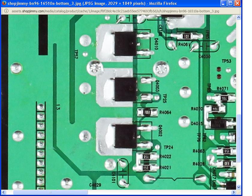

                          Hello All
                          I have this same model tv. I was removing one of the four fets that are part of this tv's x main board common failure. In the process I had a resistor pop off the board. Its board location is r4022. Its so small that I can't locate it. Perhaps someone here knows the value of the this missing resistor?
                          Thanks In Advance,
                          lcdman
                          • R_J
                            • Jun 2012
                            • 9625
                            Re: Samsung model # PN43D450A2D Black Screen Red Light
                            It should be the same as the one next to it, (150) 15 ohm. You need to do a better job removing those transistors, you ripped the traces under them. that can effect their heat transfer during operation. Try adding flux and more heat next time
                              Hello RJ
                              I wondered if it had the same value as the one next to it. (150) 15 ohm. What
                              rating/tolerance would you guess it is? Size type? 1206 as an example. This was my first repair attempt using a hot air gun. I will take your advice though for next time.
                                The way to remove the surface mount fets is:
                                1. Add fresh leaded solder to both legs. If you have a thin tip, go behind the legs and heat the pad and pry up. You can use a pick also, just make sure solder is molten.
                                2. Then add some solder to the main pad and heat the crap out of it. Dont use a heat gun, you will only f#%@ things up. It will lift right off when hot enough.
                                3. To replace the fets, put some fresh solder on the main pad, and when molten, place new fet in place, using tweezers. Flow some solder over the tab, then solder down the legs. This way you shouldnt rip off traces.
                                  Hello Again,
                                  (150) 15 ohm. What rating/tolerance would you guess it is? Size type? 1206 as an example. I just want to be sure before trying to source a replacement resistor.
                                    You would have to measure the size, I can't, I'm sure 1/4 watt or 1/2 watt would be fine
                                      It's 1206, I've repaired a few of these now
                                      If the resistor popped off the board it might be bad, so check its cousin is not open circuit
                                      If that's open circuit you'll almost certainly have to replace the driver IC for them. In fact I'd generally recommend it anyway unless you can be sure its OK as it might just pop the new IGBTs again.
