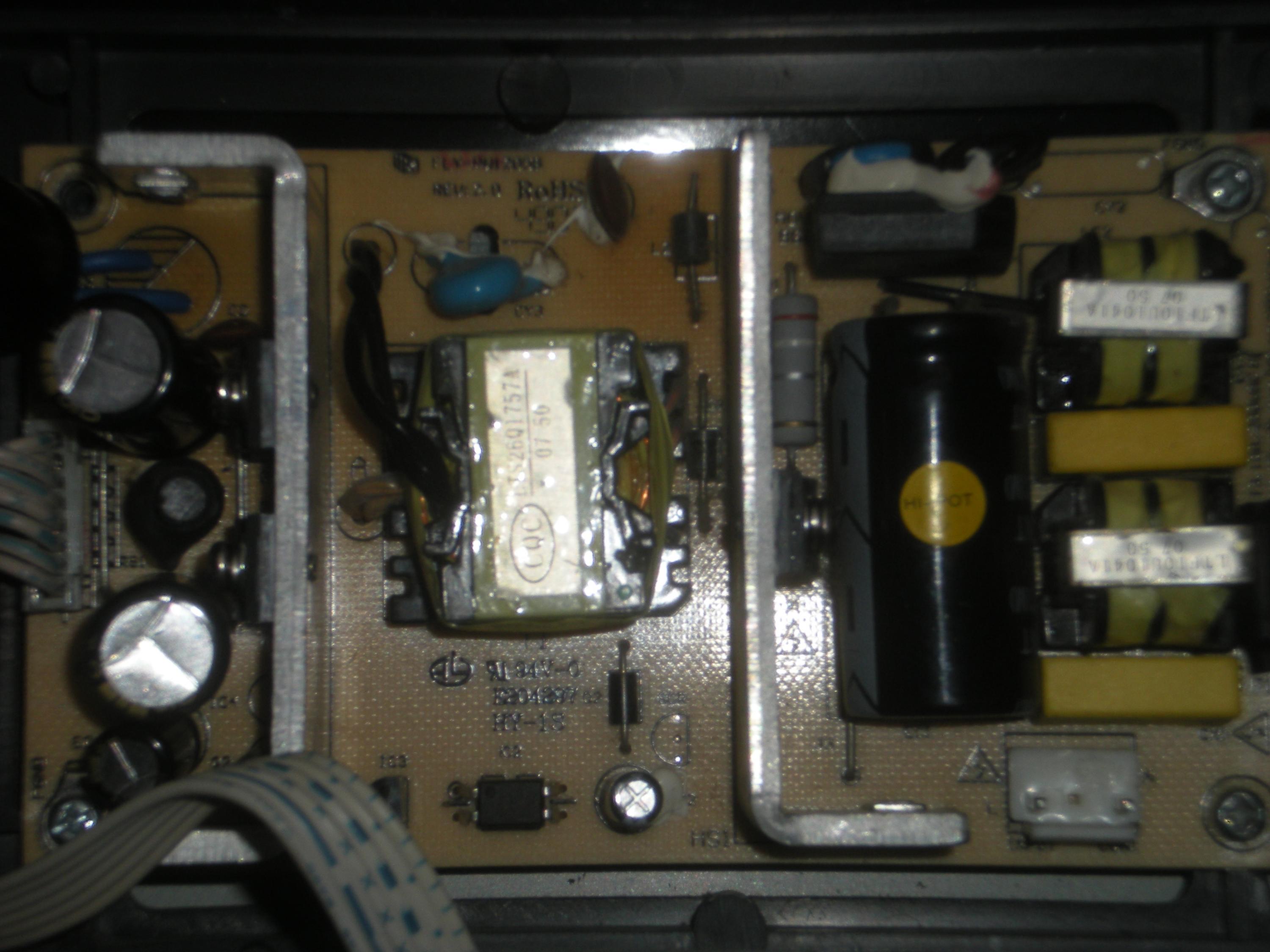

    Hello
    Re Technika - inexpensive non working 19inch dvd tv lcd combo ( I believe it is made by Vestel)
    I have a flat screen tv and thought that I would have an attempt at fixing it
    Symptoms - no life whatsoever except for the standby light which went from red to green when the power button is operated
    My naive diagnosis was that it must be the power supply,,, therefore rushed out and ordered set of capacitors ( all 4 of the output ones) 3 had been replaced a couple of years ago - but bought all 4 plus there are two on the inverter board and one of those appeared to be bulging slightly so bought those as well
    First repair attempt was to replace all those capacitors, 6 in total ...... result no more signs of life than before
    So next checked output from power supply.....4 outlets 12v and 4 gnd I get 12v from each of these terminals ,(this may have been the case before replacing the caps as I did not check) there are no 5v outputs from the PSU board
    I have discovered that there is 5v on the main board on some of the outlets
    I have tried inserting a DVD disc into the player on the set – but no activity whatsoever
    There does not appear to be image – however dark – on the screen, and no hum or anything from the speakers
    The only sign of life is that the neon on the front goes from red to green when the power button is pressed
    (I do not have the remote for this set at the moment)
    Any suggestions or help would be greatly appreciated as it becoming a bit of an obsession!

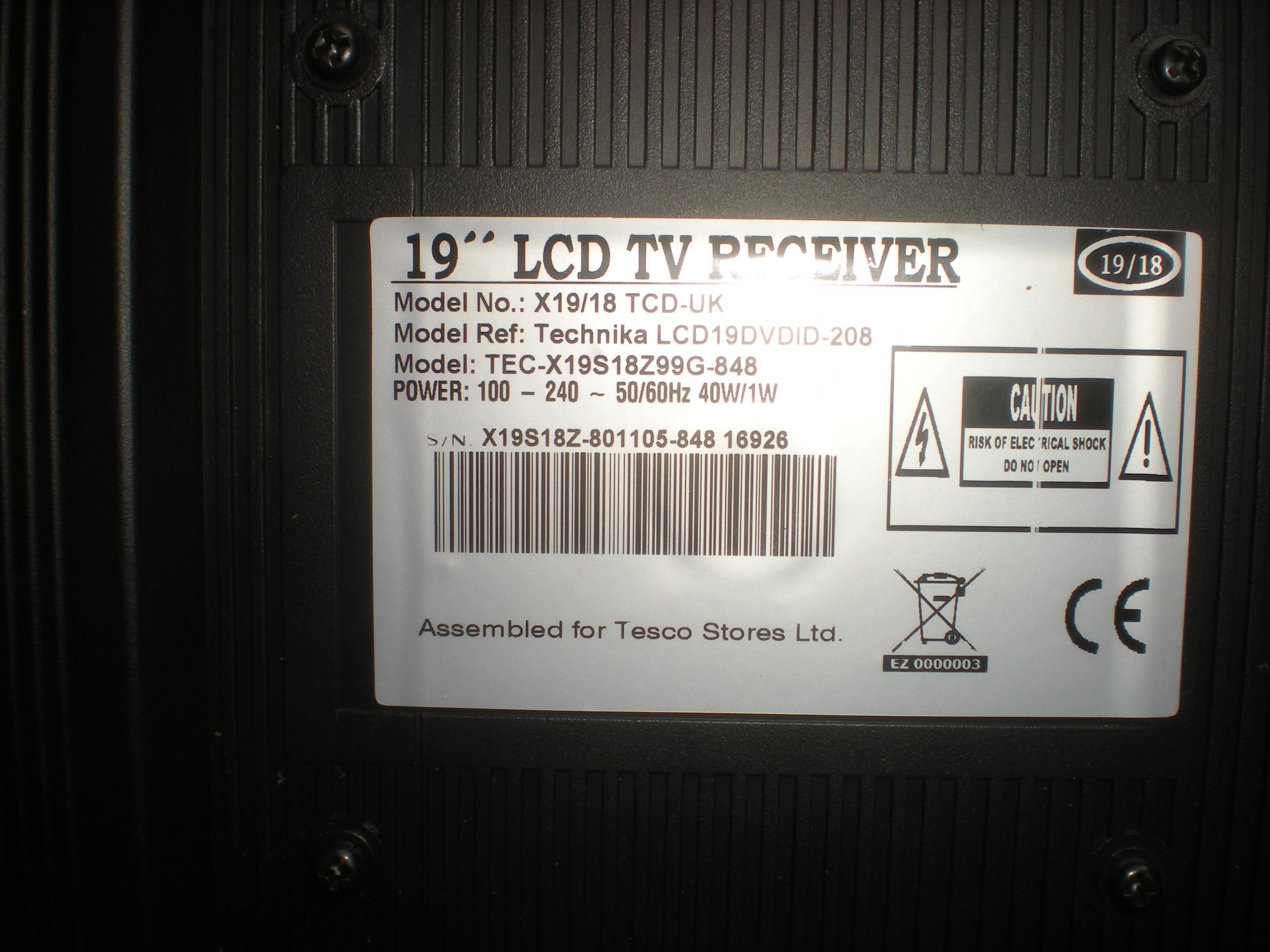

    19" LCD TV RECIEVER
    Model x19/18 TCD-UK
    Model Ref Technika LCD 19 DVDID-208
    Model TEC-X19S18Z99G-848

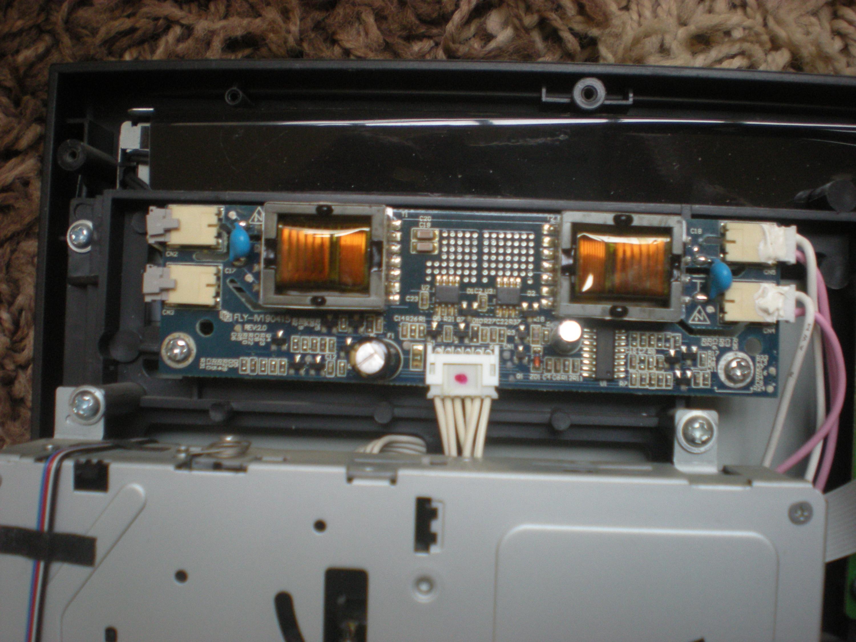

    INVERTER FLY-IV190415

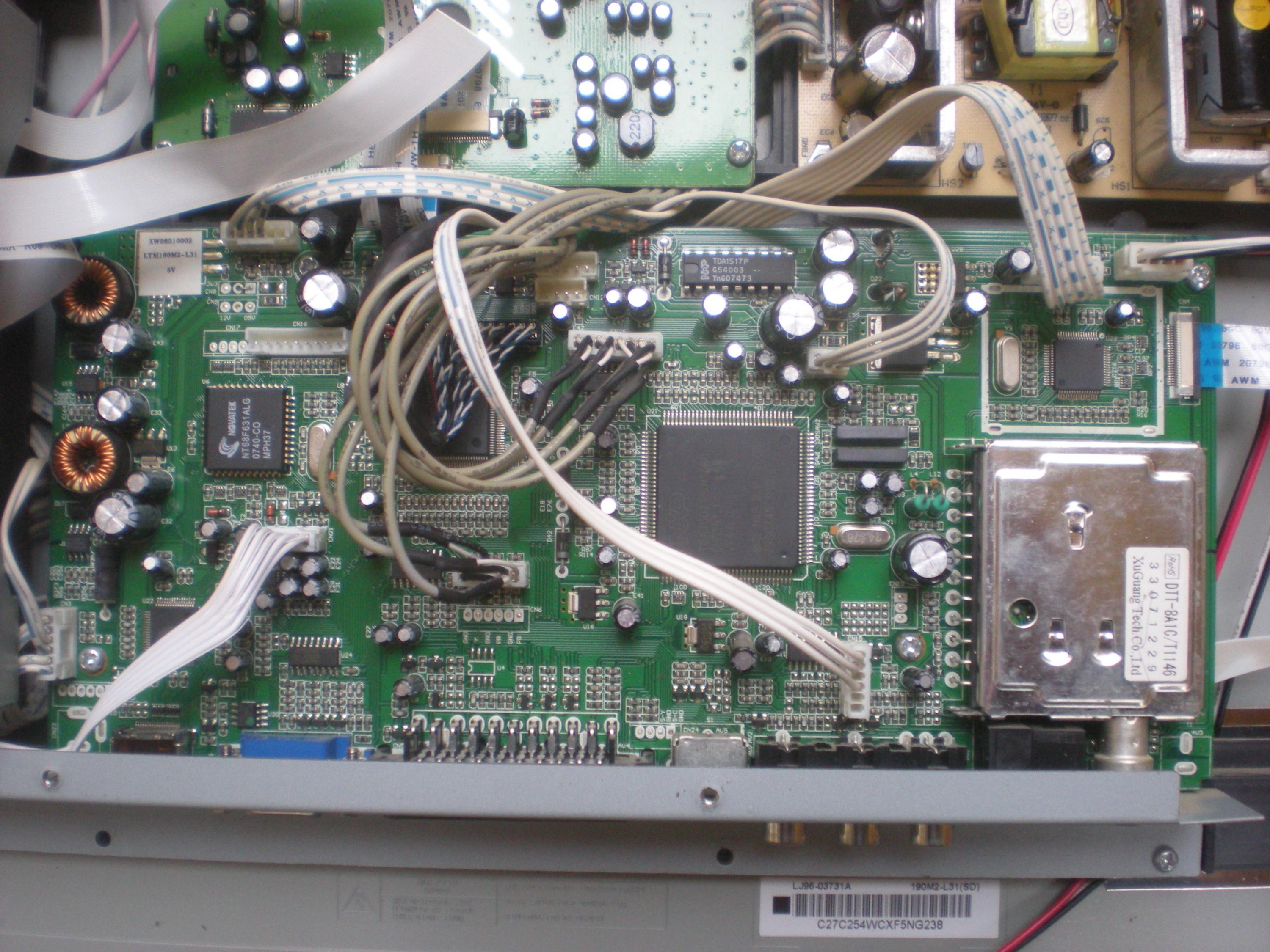

    MAIN (LTM190M2-L31 XW08010002) B TD707C 7462
    The MAIN part number breaks down to LTM190M2-L31 - this is a Samsung LCD
    The B TD707C 7462 refers to the AV board made by Swisstec -

    Make sure you have all the connectors back in the right place.
    Make sure the caps are the right way round
    In Pic 2 next to the connector there is a small fuse with a T on it.
    First test to see if it is open then check the voltage on each side of it.

      Re: Technika LCD 19 DVDID-208 (Vestel)
      If you are getting a steady 12 volts from the power supply ( have you got a 12 volt car sidelight to see if produces 12 volts with a load) then you need to look at the main board.
      I can see a few voltage regulators - perhaps check them. This helpful guide by retiredcaps
      shows how to find, test and post the results.
      https://www.badcaps.net/forum/showthread.php?p=261329

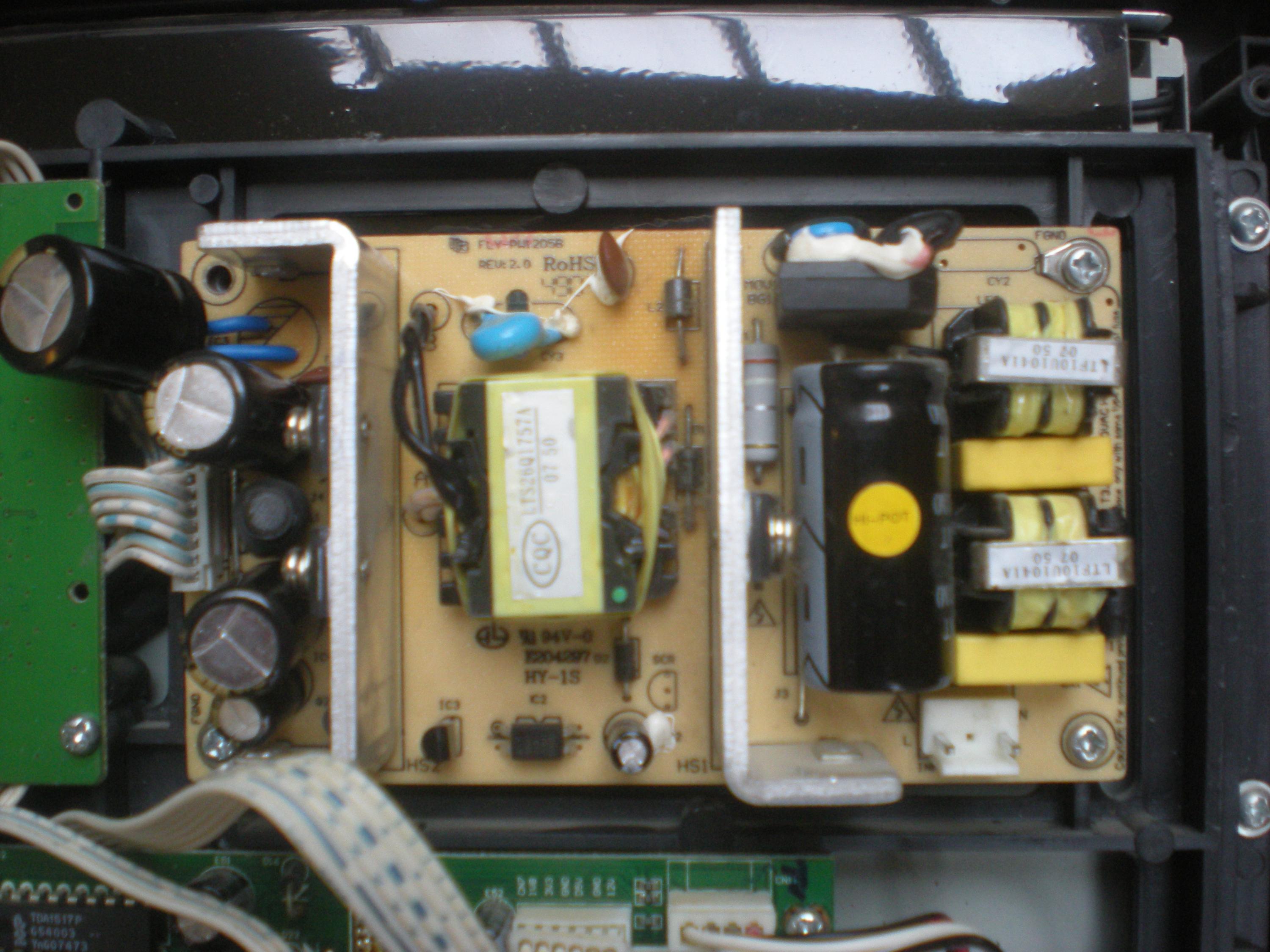

        Thanks for your very quick reply, I am fairly happy about the polarity of the capacitors as I was very careful when fitting
        The leads I believe that they are in the correct sockets, as I had thought of this and for the ones that I have taken off there does not appear to be another option - but any suggestions appreciated
        BUT
        I have just tested the fuse and it is open and there is 12.2v on one side and (obviously I believe) 0 on the other
        Suggestions?
        Thanks again
          Read this thread - its probably a 5amp 24 or 36v.
          Any 5 amp fuse will do for testing some have wired in a car fuse before now
          but take care - one fell off with disastrous results.

                Hi Guys
                I had a similar fault to that above but with no standby light either.
                I found the output from the PSU was 4.8V, although when I diconnected the output plug their was 12V available...?
                So, I initially thought it might be a fault on the main PCB dragging the output down, but gleaning what I could from the posts above and trying the car bulb test (fine with a 3W but nothing with a 21W), I then saw that two of the 1000uF electrolytic capacitors were 'domed' on their tops, whereas all other similar capacitors were flat.
                So off I sped to my local Maplins and bought 2 replacements (74p each!), thinking that for only £1.48 it was worth a try. And, hey presto the TV is now alive and kicking! The CD player also works and I have gained many Brownie points from 'er indoors! Result :-)
                                      ignore the text and try to work out why response is slow - that's probably the key to it.
                                      there is atleast 2 switching psu circuits on the logic board that may have bad caps - that should start you in a good direction.
