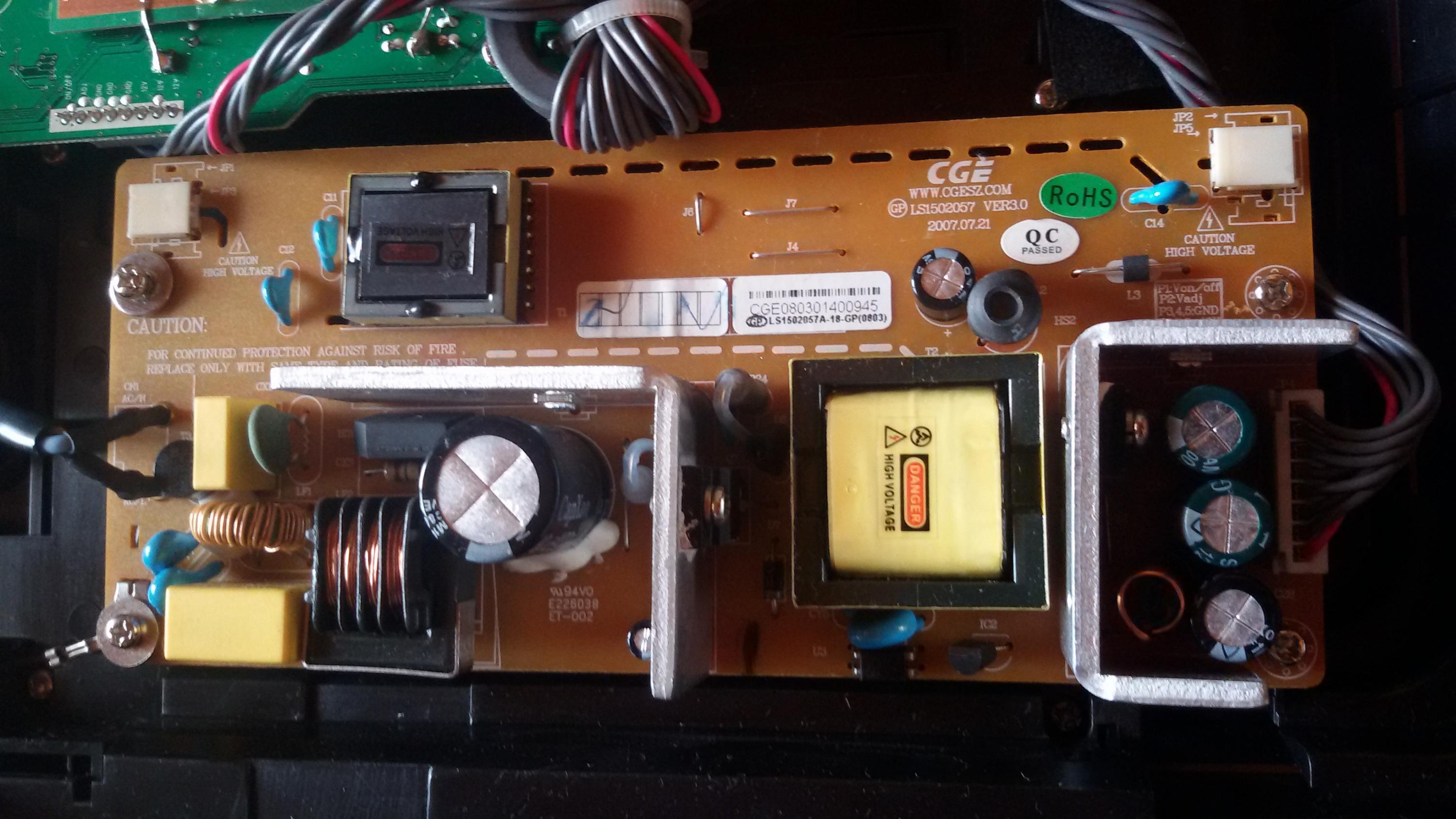

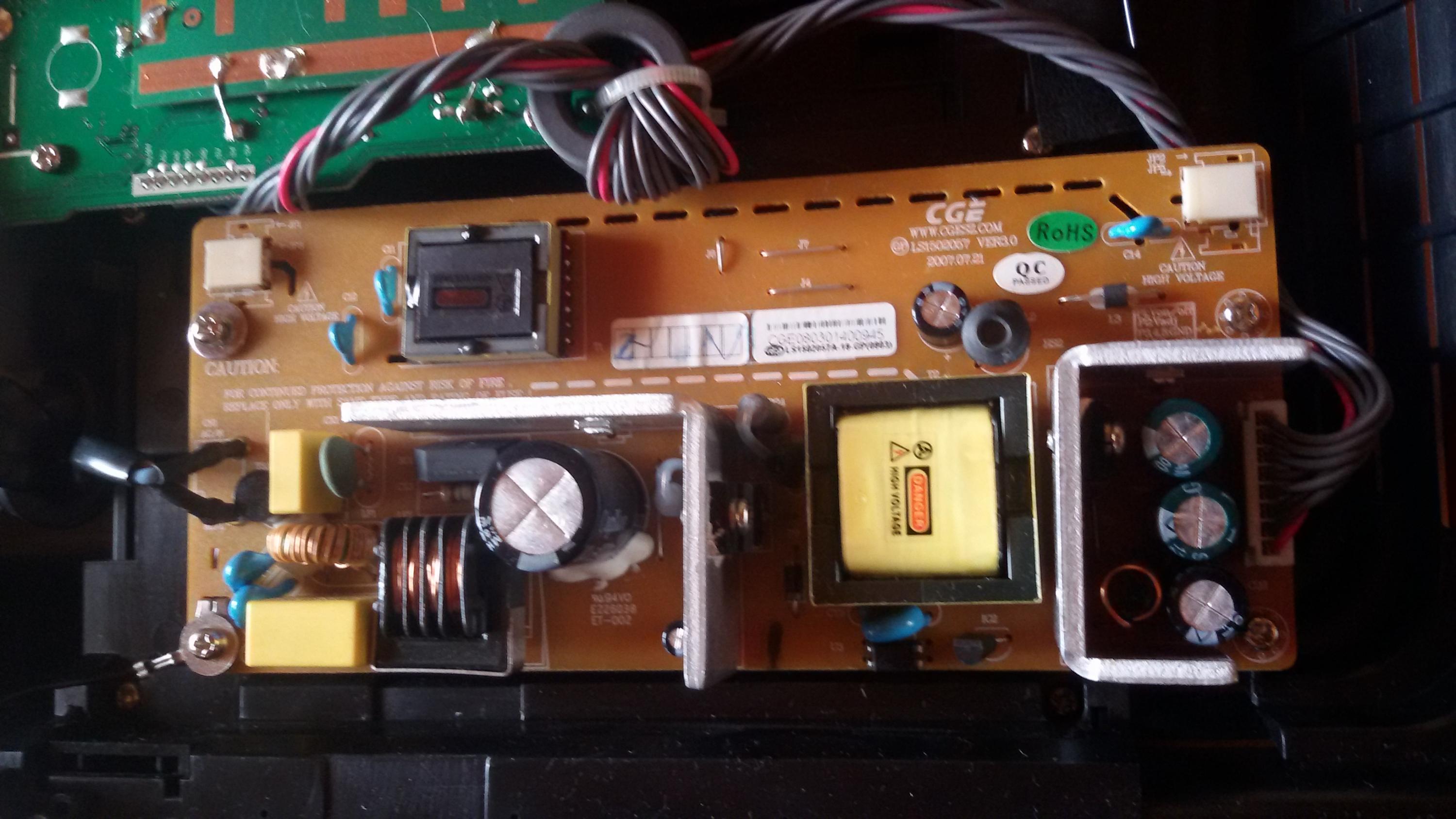

Hi there, I'm fairly new to DYI tv fixing. I got a TECHNIKA LCD19DVDID-108 and suddenly while trying to reprogram the channels it stopped working. The screen went off and the red standby led started blinking every time I turn it on. No sound no signal and no screen light. Reading over the internet I read a common fault is a blown PSU so I bought a replacement. Surprisingly when I opened the TV set, the TV's PSU seemed ok. Nevertheless I connected the new one, (without the lamps, the new psu came with different molex connectors), however it still did not work. I'm attaching a some pics of the original PSU. Any help would be greatly appreciated!Comment
Re: Technika LCD 19 DVDID-208 (Vestel)
This sounds like a mainboard issue rather than a power supply issue can you put the original power supply back in and take the dc voltages from the large wiring connector has the wiring connector got any writing by it too say what each pin does/is for? and Dont try too measure the smaller lamp connectors as these are High Voltage and your meter may not survive.Comment
