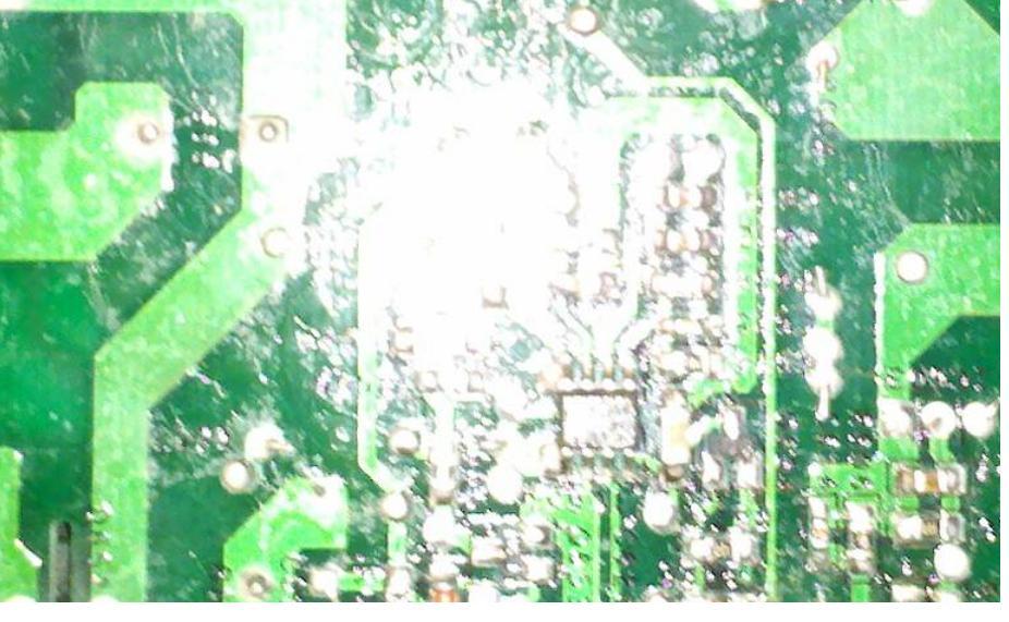

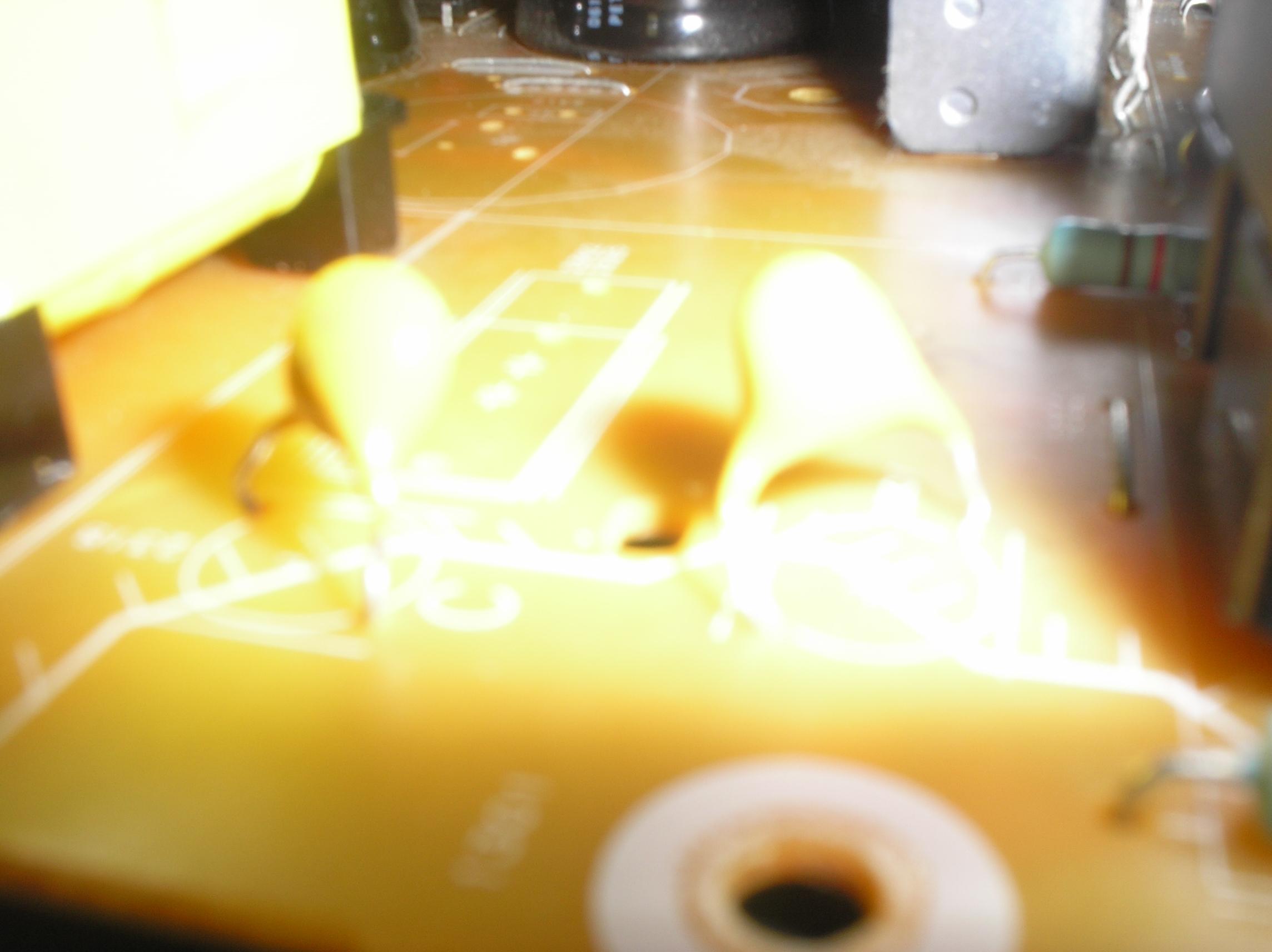

                              Not sure what your board numbers are(can you post them and maybe nice close ups?), but there is a mod from LG. see attachment.

                                The boards are the LC420WU5 that have cropped up in other threads, sometimes listed as PNEL-T707A and -T708A. I have reviewed all the other threads on this forum that came up under any of those numbers.
                                There are two different mods for this pair of boards, one ex LG and the other from Philips. They are intended to limit recurrence of failure of the BD9897FS controller chip. In this set neither board has a failure as such, just the master won't start unless something is warmed up. There is little point posting a photo as the boards have no visible degradation or damage whatsoever. Anyone who is curious what these boards look like can find pictures of them all over the net.
                                  No disrespect, but you are asking for assistance, so telling people to go search and find pictures of your boards isn't gonna help your cause. Good luck with it.

                                    Steady on Marty. Did you read the whole thread - Pedro is a pro tech and has been a member on here for along while. It is fairly obvious he has read all the threads and the LG
                                    fix has already been mentioned and commented on. There is also a pretty good picture of the slave board posted by Pedro which clearly shows the part number so your request was maybe less valid than you thought?

                                      I said "no disrespect" I'm sure Pedro is a fine tech! However that doesn't change the fact that the most helpful users here(you included) are probably quite busy. I have followed the thread from the beginning and the pic you mention is not good quality.
                                        Haha - youve not been on here as long as I have I was going to start a library but it was too depressing
                                        here are two fine examples

                                          The pics I posted were for identification purposes only and not for diagnosis as I stated in the accompanying description at the time. I do believe that there is nothing that experienced eyes can determine from looking at pics of the board in question. If someone *really* wants a pic I'll post one although I sincerely believe it will be a waste of my time. But ask away.
                                          Yes, I *am* welcoming help or I wouldn't have posted here at all. I don't take offence at criticism, but I must admit I do get a bit short when people ask questions that have already been answered earlier on - and that's not you Marty. At the moment I'm still trying to find a leakproof way to heat *only* the caps or *only* the BD9897FS, as I don't like working on SMD chips with 0.8mm pitch if I can avoid it.
