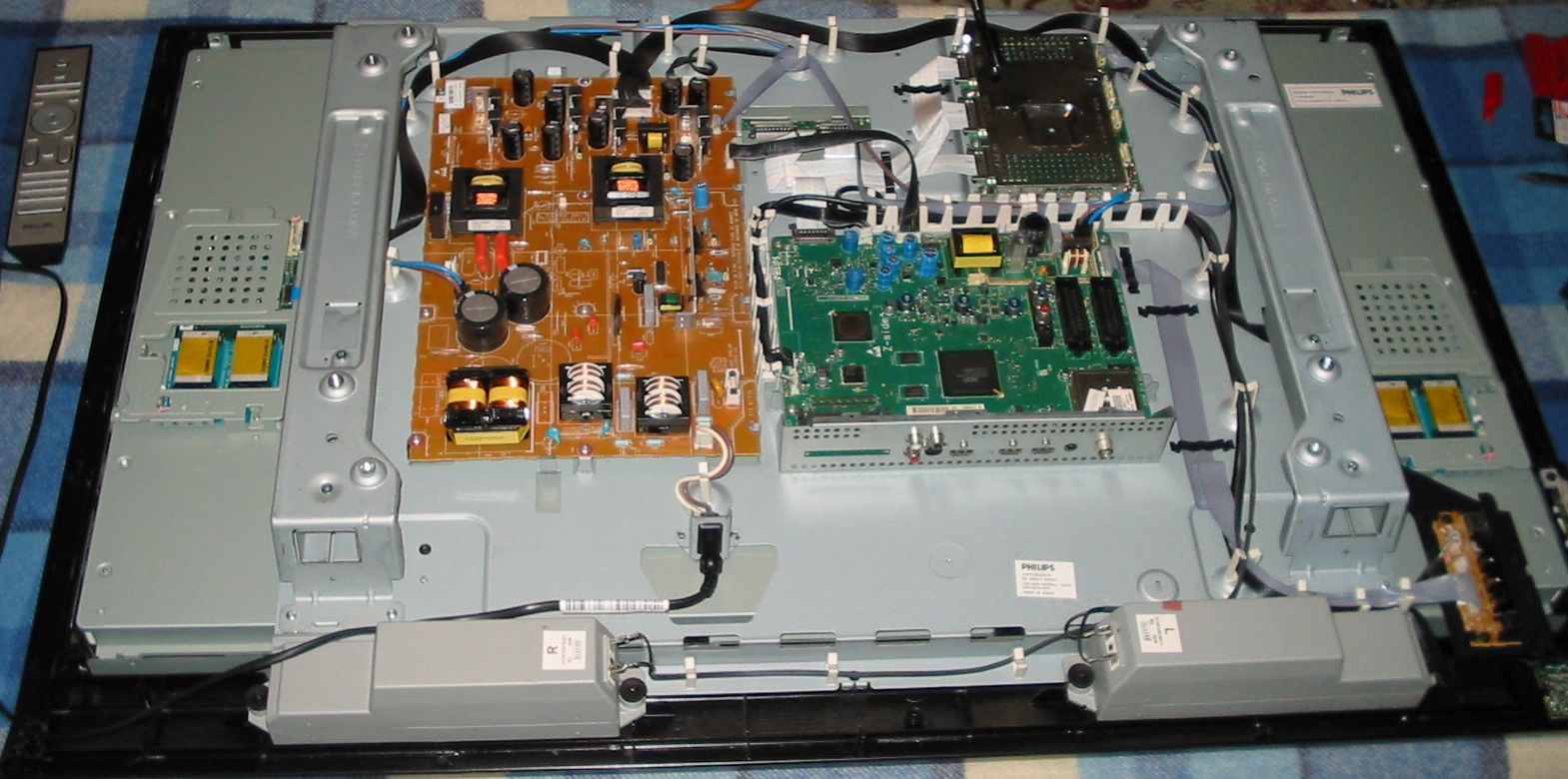

    I have a fair history on repairing LCD (ccfl) monitors, but gave it away over a year back to reclaim some time for other pursuits. I was recently presented with the above TV for investigation. Chassis is Q528.1E.LA (not .1A.LA although the significance of that is unknown).
    After the usual 8-10 secs of system wakeup (aka nothing) after turn-on, the screen lights with "no input" or similar message in a banner across the top, then after a couple of secs the zzzzzzzt sound starts and then the total backlight system shuts down.
    These are sets with two separate inverters for backlights, the "master" on the left and "slave" on the right (as viewed from the rear of course) - and that wank ambilight system tacked onto the rear case. Trying to locate the source of the zzzzzt is a problem - seems like BOTH inverter boards are doing it, which is odd given that the reported failure mode was "one day, when I turned it on, this is what it did".
    Have had no joy locating a service manual or schematic for this monster. Google did show this as a not uncommon problem (and a number of threads about replacement inverter boards). While I know the general approach from my monitor repair days, a schematic would help a lot.
    Anyone know where I might locate one? (Elektrotanya only has a four-page assembly part# listing from various models of this family).

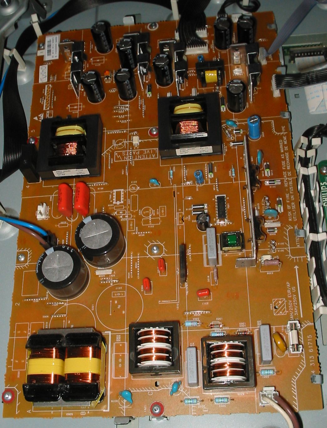

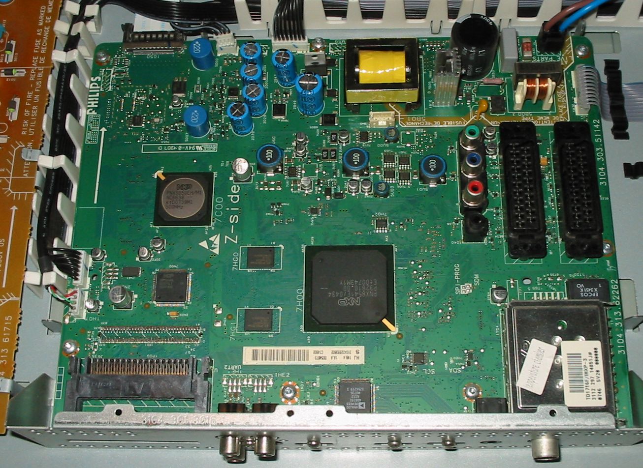

            Philips/LG seem to have set out to make these as painful to service as possible. There are NO legends near any connectors, just a connector label. So far I have accounted for +3v3, +5v0 and +12v0 supplies, no sign of +24v at this stage.
            - See if the power LED blinks an error code
            No it doesn't. After the B/L shuts off, the power LED stays on.
            After working on monitors for quite a while, there are a number of things about this device which are alien to me (although maybe commonplace to more TV-oriented techs):
            - The number of boards/subassemblies - five apart from the t-con and front/side panel. (See attached quickie pics which are for explanation/identification only and NOT diagnostic quality.)
            - The lack of pinout legends near any connectors.
            - The inverter board arrangement - dual boards (master/slave) each with two transformers but only two conductors to the lamp assembly.
            As a further description of what transpires when an attempt is made to turn it on, the LED on the master inverter lights when the B/L system first fires up, then when the zzzzzt starts the LED dims progressively over a couple of seconds until the zzzzzt (and B/L) stops, returns to full brightness for about a second and finally extinguishes as a relay clicks elsewhere.
            No components show any signs of distress. Subject to my guess(tm) that the transformer terminals nearest the lamp connector are the output(s), all secondaries measure as <0.1ohm! You can see why I hanker for a SM ....

                                    I don't know where my posts are right now but I had put together instructions for fixing these sets with faulty inverter boards. I will sum it up again in this post.
                                    1. Check the caps on inverters. 2 each.
                                    2. Check the driver chip visually for pin 26 burning off - common failure.
                                    3. Measure the resistance between the two soldered leads of each of the four fets on both master and slave boards and post the results here. You should find that they should all measure the same ~ 8.5k ohms I think. If there is one reading lower, that means the driver chip (32 pin surface mount) needs changed.
